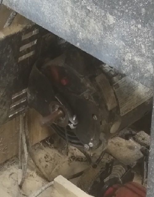

  18. I think Gene Howe will remember a Texas Bandsaw...that Gary gave me a long time ago....well. the current motor has started having "Issues".. and will need replaced.. IF you can get the breaker in the motor to not only reset, but STAY that way..it might run for a while....but.the next time you try to start it up...run, CLICK..DOA for the day So...the hard part will be getting this motor out...last time, I needed a floor jack... I do have a "spare".. That will need cleaned up and oiled up...test drive? If you didn't have your foot on top of the motor, you'd never know it was running....nice and very quiet... We'll try it out....while I save up for either a new 1hp motor...and walk into Harbor Freight the first week in January and buy a new 14" model... First, need the Gumption to work ON the floor of the shop, to drop the old motor and lift the replacement into place.. We'll see...
