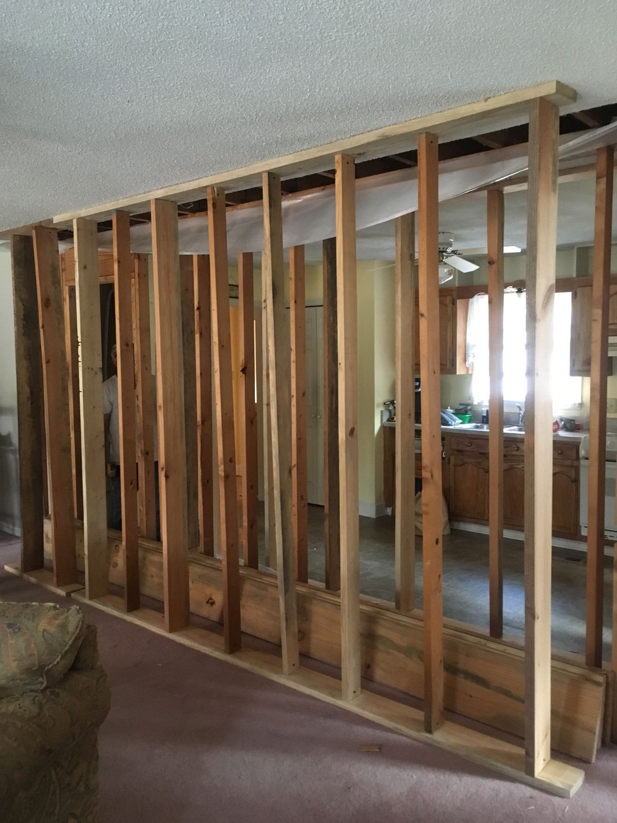

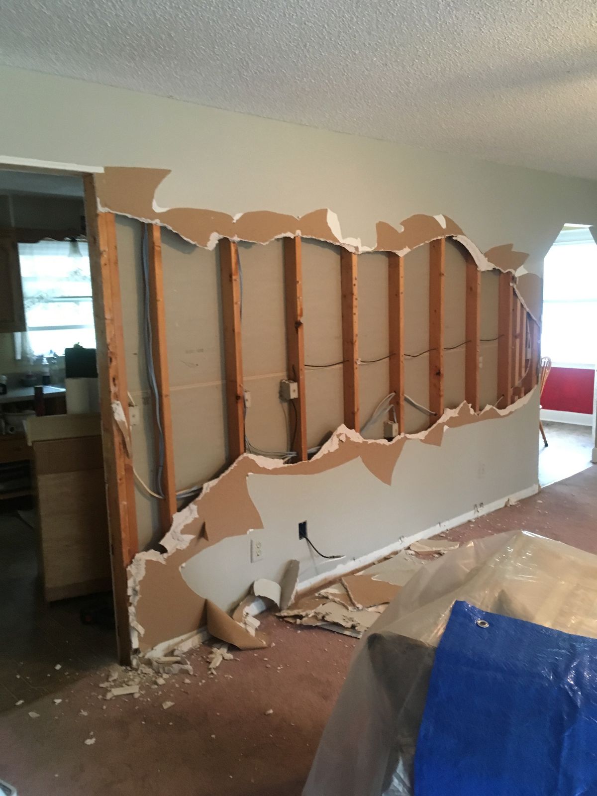

In 2016 that wall was removed, and I built an island to replace it.  I did some rough calculations this morning; after the island was in place, lower cabinet and countertop space were the same.  Upper cabinet space, of course, had been cut in half.

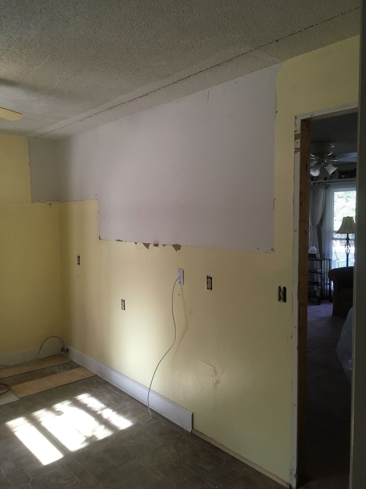

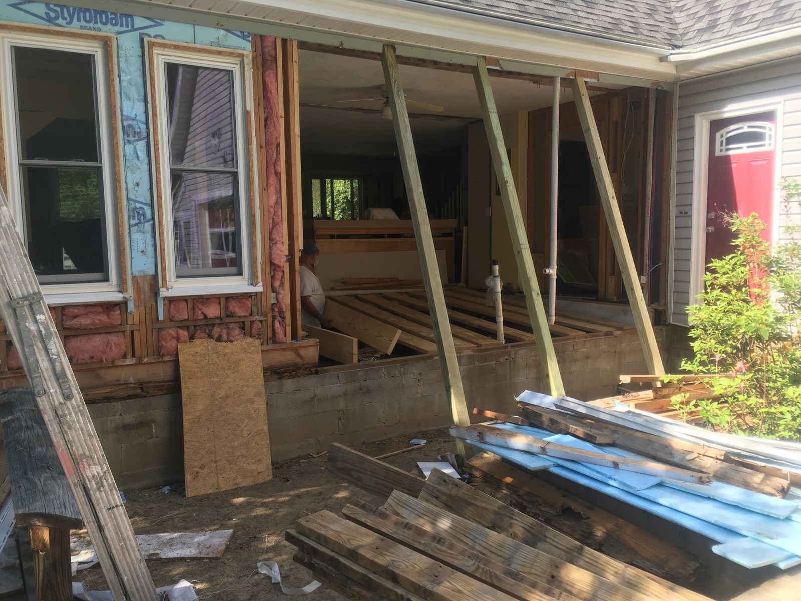

I started at the end of January 2019 by pulling up the 30 year old carpeting in the living room to assess the flooring situation.  A little wavy from the particle board underlayment that had suffered moisture damage in years past.  And there was a very noticeable dip in the kitchen floor.  Reasoning that I needed to address the kitchen floor as part of doing the living room, I pulled up the underlayment and subfloor on that end of the kitchen.  At this point my plan was to still just level that end of the kitchen, put the stove back and let the kitchen idle until 2020.  Unfortunately, what I discovered would change all those plans...
The house had been built with an attached deck (a big selling point to me) on the back.  That deck was above the block foundation height of the house.  To further add insult to injury, the rim joist was neither pressure treated lumber nor was it flashed.  Every time it rained over 30 years the water would have soaked the rim joist and floor joists.  At this point my plans for 2019 shifted to a kitchen remodel.
While I have done most of the remodeling alone, I pulled in the big guns on the rim joist situation.  Having the experience to know what to do and the ability to get in and get the house closed back in had to be taken into account.  That was the end of April.  Over the next six months I have been steady at it.  Oh yes, a half bath off the kitchen entrance area was remodeled along the way this year also.  A very tight 3' x 8'  area was expanded to take in a closet under the stairwell so that space went from 24 square feet to 33 square feet and utilizes dead space where a water heater had been located.

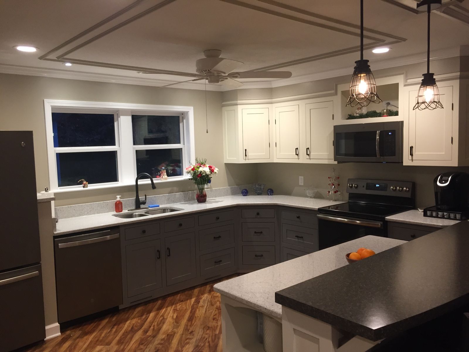

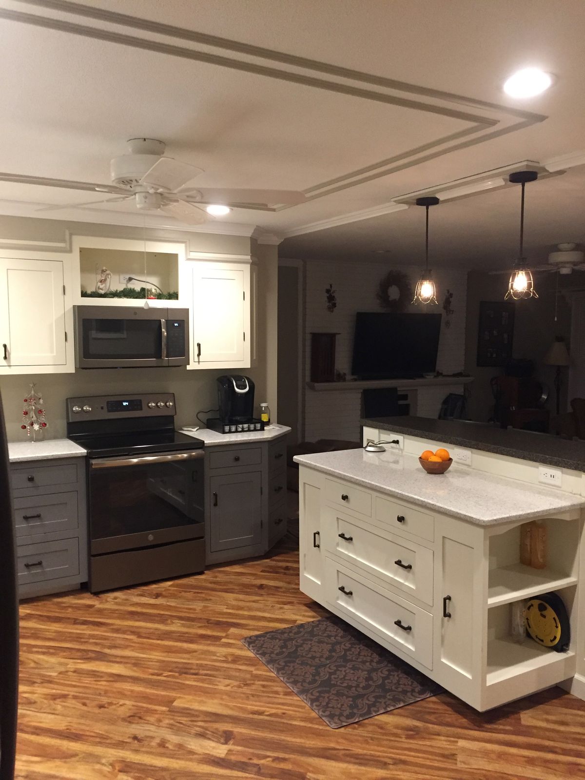

Julie (SWMBO) decided that she wanted painted cabinets as a change from 30 years of stained oak.  I had fought that over the years whenever she talked about painting the cabinets.  I did have to admit in 2014 that when she painted the oak vanity in the master bathroom that it really did look nice - and more modern - and a heck of a lot cheaper that a new vanity!  I was also ok with painted cabinets in the kitchen as I do not have a lot of experience with cabinet building.  The way I see it, close measurements, careful tool set up, caulk by the case and paint goes a long way.  And there is always moulding to hide what the aforementioned didn't!

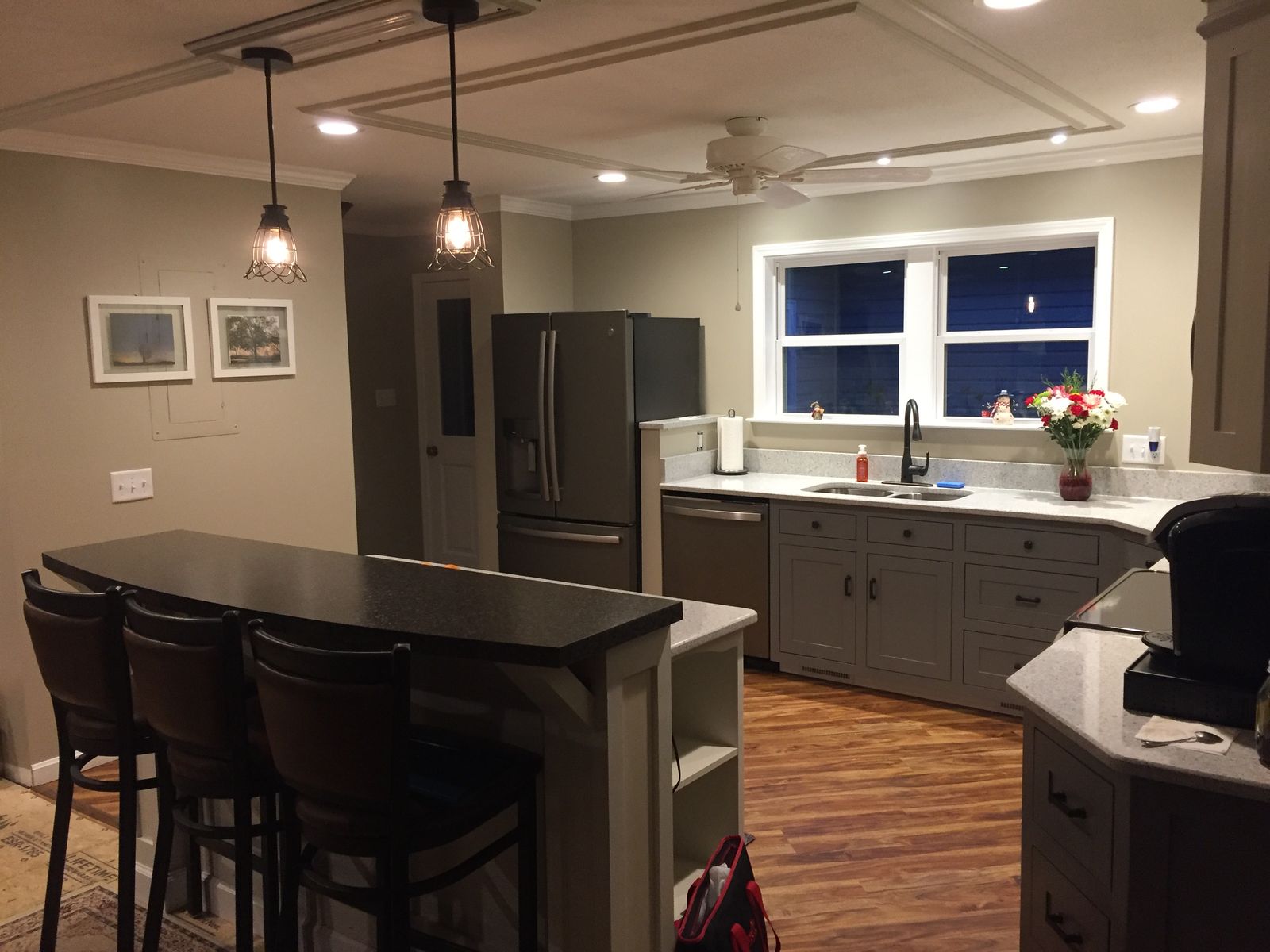

So here is where we at today...
Still have a few items to do, a pair of lazy susans for the upper corner cabinet, new beefier drawers for the island and a slide out shelf for the sink cabinet and a couple roll out drawers for the broom closet and pantry.  But, for today, we have a kitchen back in operation.
Utilizing the same space, but moving the 9 square foot pantry area we have changed up the space as follows:

Today:
lower cabs - 10.5 linear feet
counter top - 16.5 linear feet
upper cabs - 6.5 linear feet
Today's design has a huge amount of useable workspace added, and it is not chopped up into 1 foot spaces.  The upper cabinets are somewhat less in total length, but again is much more useable.
SWMBO approves!  And it's a year ahead of schedule to boot:BugEyeSmiley:

Just beautiful Cal.  Love it.
Fantastic, Cal! It is all so well laid out. I really love what you did with the ceiling!
Looks great. Long term projects are always a hassle but the results pay off.
You have been extremely busy.  This has a very expensive venture and labor intensive one.  But, it looks like a new place.  I love the arrangements and color.

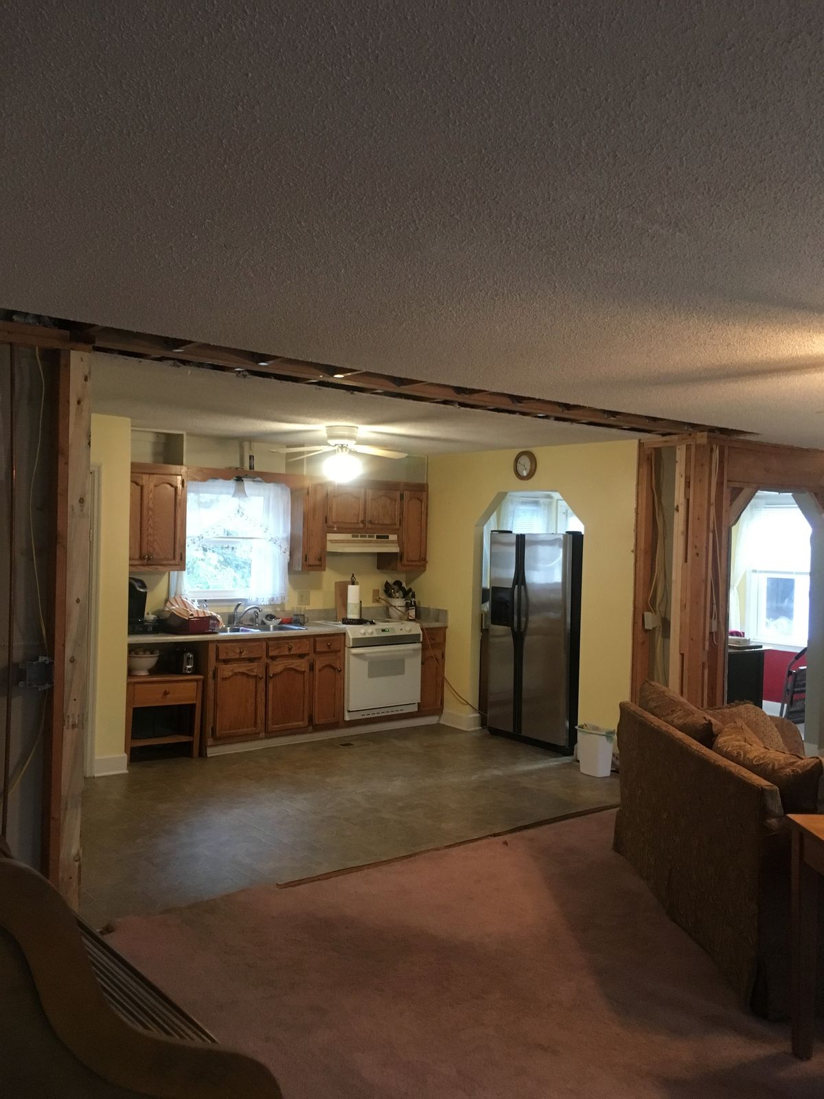

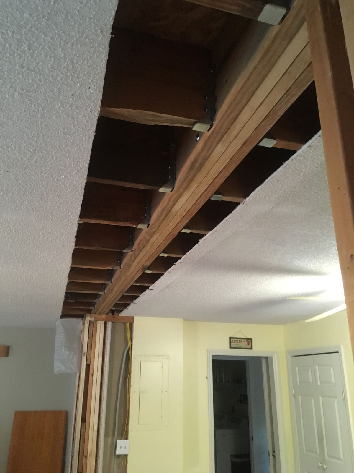

Looks beautiful, too bad they put the electrical panel where they did when the built the house. you mentioned that you removed a load bearing wall? I’m an electrician, not a carpenter, but I didn’t see a beam or post? By the looks of it, I’m guessing SWMBO is ecstatic.

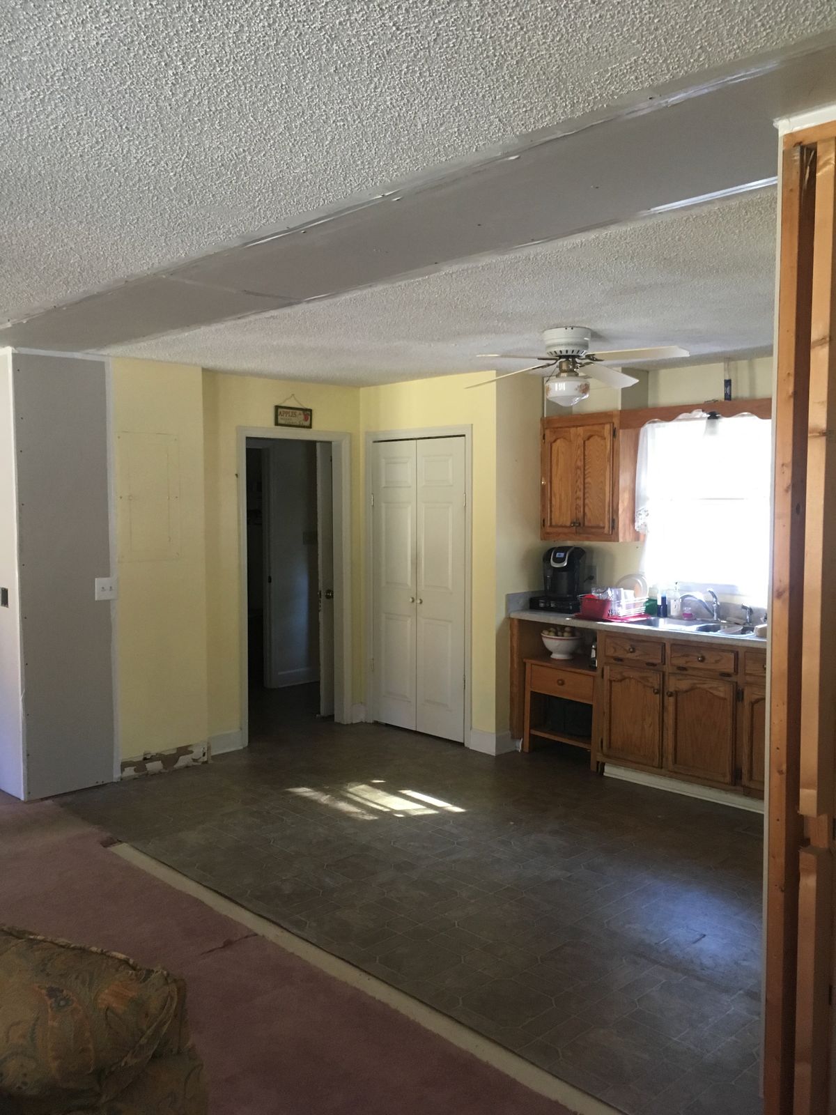

Thanks a bunch fellas.  @Artie, here are a couple more pics for you to show where the beam replaced the wall.
I should have offered up that last pic to show what that half of the kitchen area was.

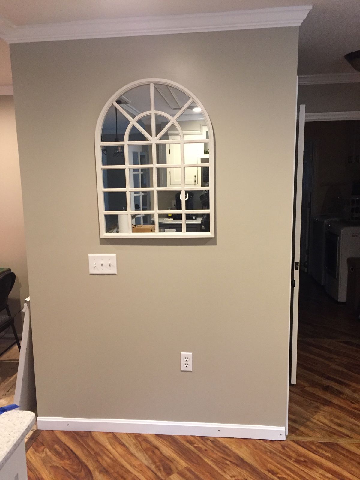

And you are totally correct on where they located the electrical panel.  But, I was at Lowe's the other day and found a large mirror in a clearance box and have convinced the young ones that it would b e a great Christmas present for their mother.  When she got home Friday evening she thinks the two pics there have been hung just to take your attention away from the panel box:D  She ought to know better...
It is a perfect fit and the hangers are already in place for when she gets it Christmas day;)

That was a LOT of work. The remodels I’ve been involved with, where they took out a load bearing wall, the beam was below the sheetrock, and visible, afterwards. Very nice work.

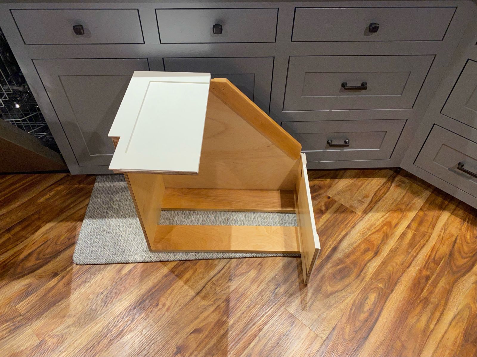

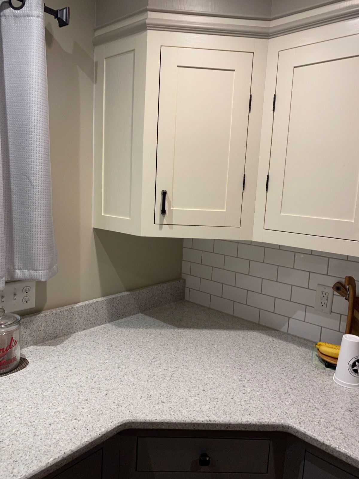

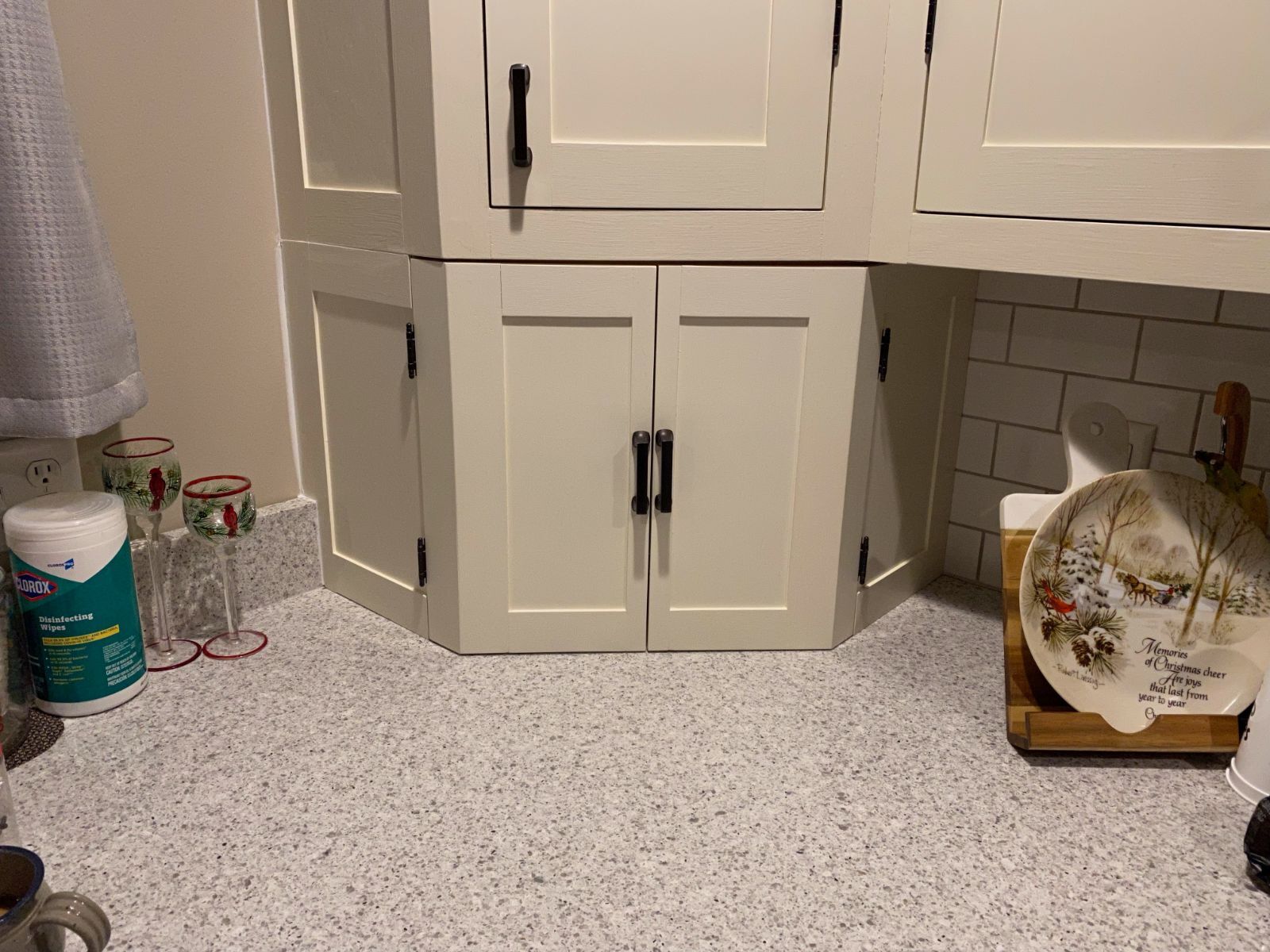

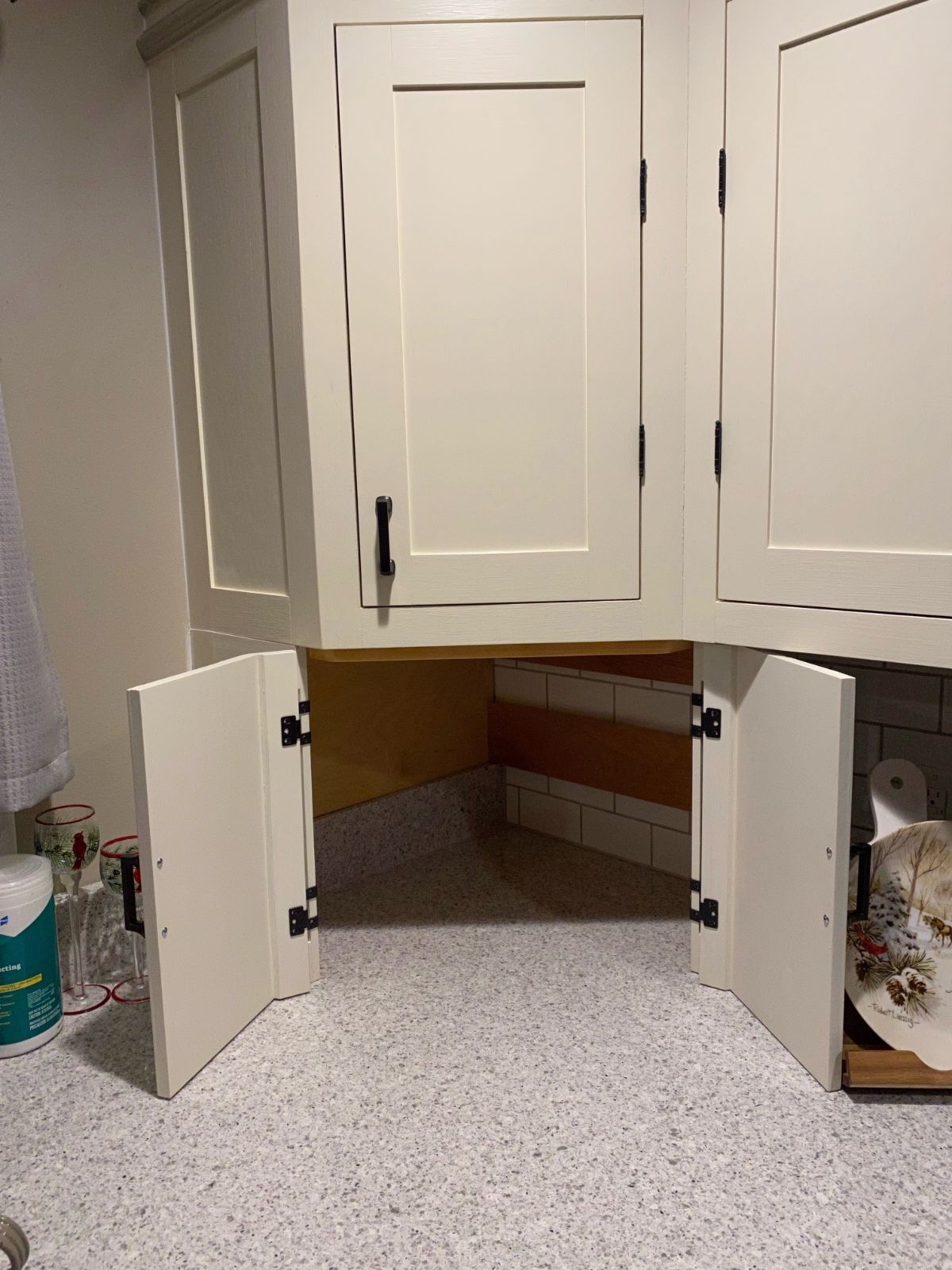

I had suggested to Julie that an appliance garage be placed under the corner wall cabinets.
So I built a prototype from scraps back in early 2020 and said I would do a nicer one at some future date.  Future date has rolled around...  I actually built it about two weeks ago and then it was in the paint shop for a few days and I started the table projects.  I did get it installed this past week.
I like it!  You tucked it right in there.

 Nice job Cal :TwoThumbsUp:well thought out. I like the way you put the bevel on the doors, gives it a wider opening.
