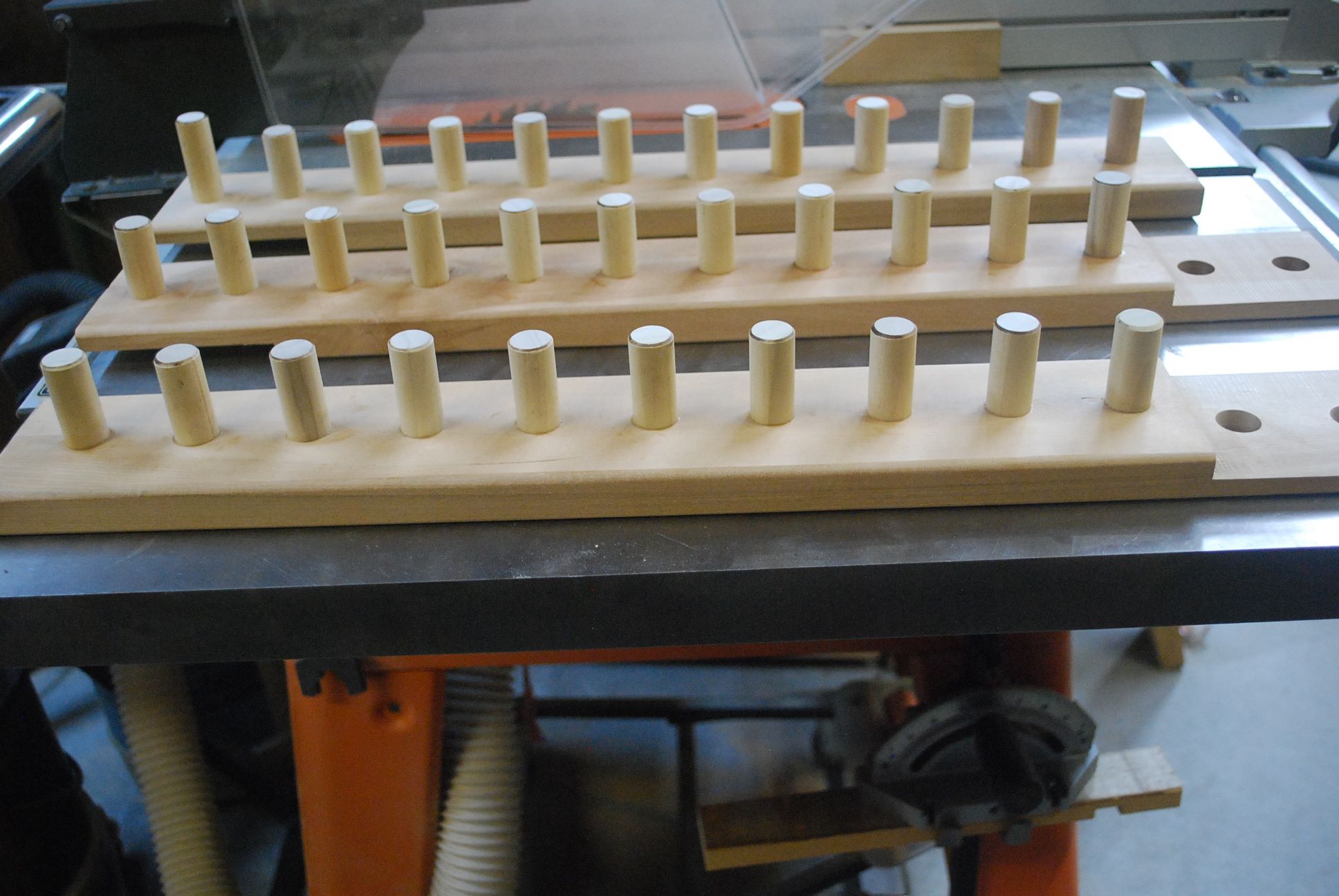

A friend asked if I could make her a "loom", at least that's what she called it. Basically, a long board with a series of dowels every 2" to hold the beginnings of a "bulky blanket". The "yarn" for these blankets is as big around as a finger, and is woven manually, so not really a loom in the usual sense.
The base is composed of three sections, with a 4" overlap, each held together by two removable pegs.
Had a problem finding 3/4" dowels that were actually 3/4"! :WonderScratch: Tried four places, and they were all undersized, with the ones at the big orange store even being oval instead of round! Her husband finally found two lengths of dowels in his garage, really old stock, that fit perfectly! Got 31 pieces out of those, but needed 33, so I turned down a short piece of 1" broomstick, and called it a day. I'll take the outfit over tomorrow, and see if she wants a clear finish on it.
Cool project!
Same problem here. I have to wonder if they are metric but labeled imperial.
Good on you @HARO50 John. Very nicely done.
So how does it work? Does mount to a wall or clamp to a bench or table?
BTW, great to see you working some projects too.
I've been wondering about that myself! I ASSUME it will be clamped to a table, since she didn't mention hangers of any type. I'll be asking questions when I take it over, and report back. :SaluteandRun:
That's possible. I should mention that the full-sized ones both had labels stating "Made in Canada". I didn't see any origins on the ones I tried in the stores. The oval ones at HD made me think they might have been turned when still green. Could that also account for the undersized ones?
I was just working on something yesterday and needed to put a 1/4" dowel into a 1/4" hole. That dowel was to large, I wound up re drilling the hole to 17/64" to get a good fit. It's very seldom I've seen current production f dowels be as advertised...kind of like 3/4"plywood that's really 23/32".
They make 23/32" router bits to compensate for the thin plywood, but I've never seen 23/32" Forstner bits!
Product delivered and accepted, no finish required. Apparently it simply lies on the table, but she will put non-slip shelf liner under it. It sounds (to me at least) as if this is more like macrame (Remember that?) than weaving. Further details to follow, as they become available.

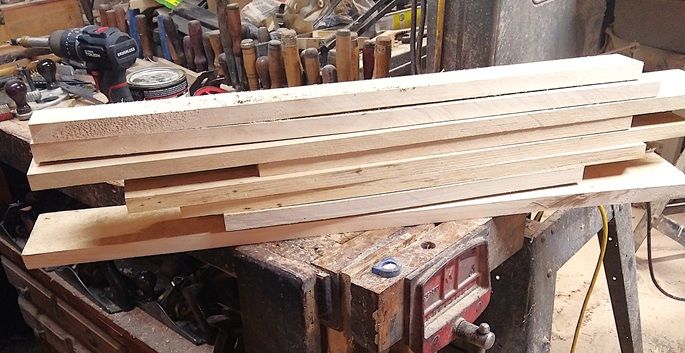

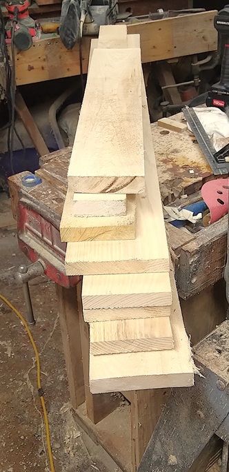

Currently sitting on my bench..June1Project4Maple4Ash.jpg.6cab241cc0014c44645dcde09d21c250.jpg
4 Maple and 4 Ash boards..
Apparently Soft Maple....this is after all the bad spots and all the wane has been removed.. Have nine more boards to "process" through...these are all 7/8" thick....will need to thin them down a hair...or 2...

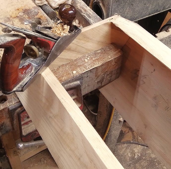

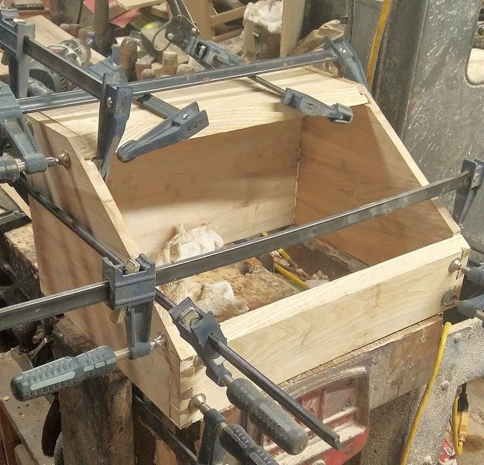

So, what is sitting on my bench, right now?
Just a glue up...
Had the tail end of a EF-0 go through the area Saturday evening....just now cleaning up all the twigs and branches it left behind....when you look out a window, and can't even see 20 feet from all the crap swirling around....yep
Went to check on the shop this morning, floor is drying out SLOWLY....decided to at least get things ready to fit a lid...
All clamps are put away...
Needed to level the 2 sides to the top and the front bevels...meant doing End Grain Plane work..
