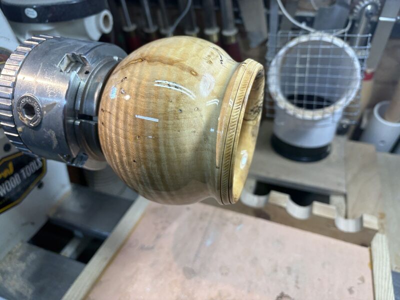

I was cruising the Internet a while back and found a vessel of illusion by Trent Bosch. The idea intrigued me and with more research, I decided to give it a try.
Things are not going as planned.
The first failure was when the vase collar was inadvertently undercut too far and the collar fell off. But pressing on undeterred, I decided to use the collarless vase- left side of this image-
The original, and current, idea is to have the "top" (rite in above picture" be installed inside the vase.
The "top" is larger than the opening- thus the "Illusion"
The top must be very thin
The outside profile of the top must match the inside profile of the vase. It takes some try and retry to get the profiles to match. Using a profile gauge and cardboard templates I shaped the top of the lid's profile.
Reversing the lid, to thin its walls, gave me an in-depth understanding why turners love their vacuum chucks. Now I wish I had one. But, a jam chuck, of sorts, will have to do.
Using double sided sticky tape and painter's tape to keep the lid in place allowed me to thin the wall to what I thought should be the correct thickness. A Vacuum chuck would have made removing, checking thickness and replacing really easy. Now, I wish I had one. The lid was just a little too thick. Remounted and, wouldn't you know it, now it's a little too thin

Oops; still gonna be very cool Lew. Love the spalting of the vase body.
We always seem to keep the funnel making craft alive and well.  Hope things go better next time.  Looking good though.

Actually, the lid will need to be boiled to make it flexible enough to be bent and fitted thru the opening. The vase part was twice turned so it is pretty stable. The vase still need lots of sanding before I can put things together. I want to ebonize the lid so it is a contrasting color. The lid is white oak so ebonizing and bending hopefully work out.

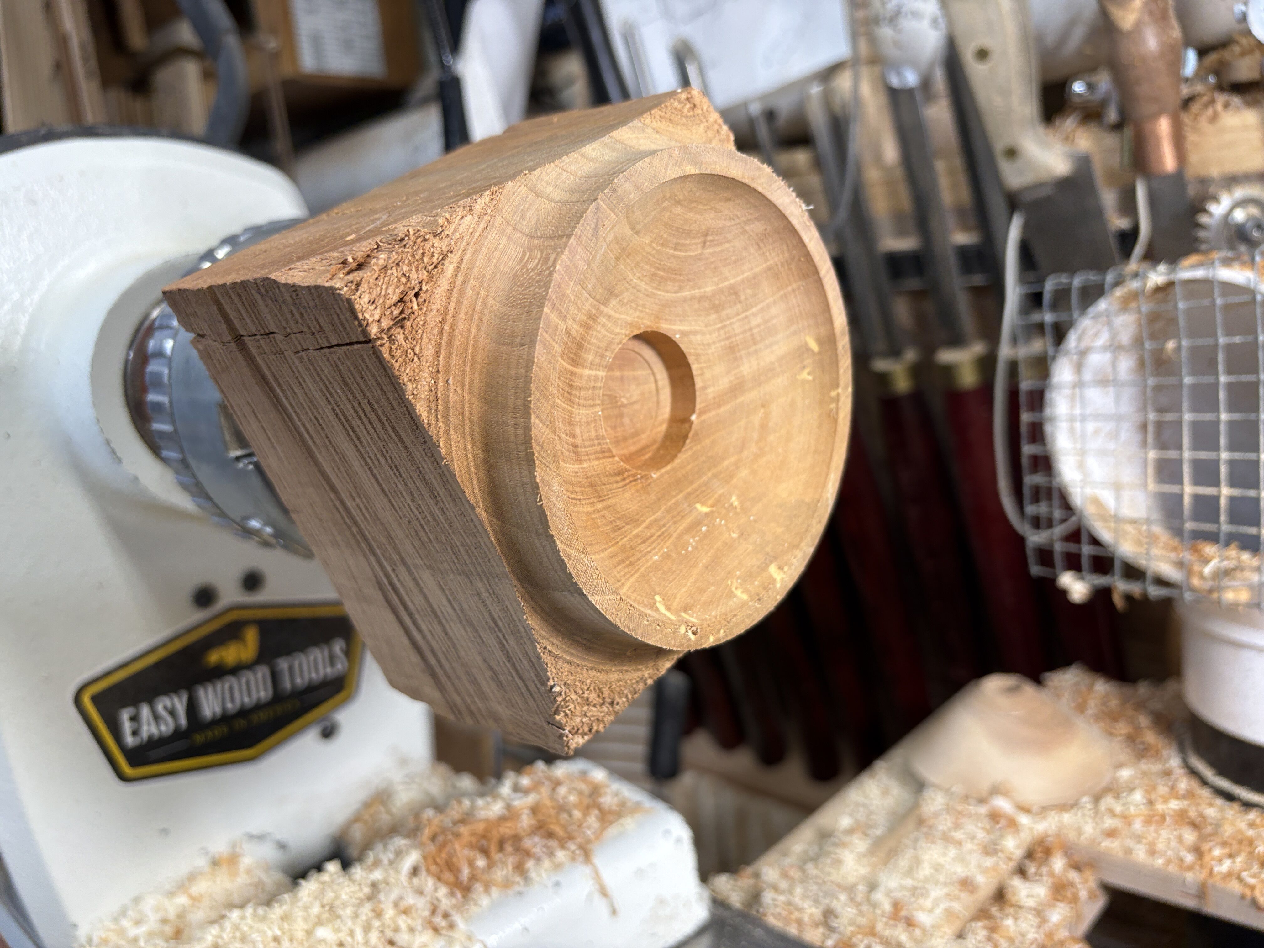

This piece was given to me by a teaching associate at the Vo-Tech school. It had been laying, exposed to the weather for a long time. The teacher is the Auto Body instructor and he was working in partnership with the Carpentry instructor to make natural edge tree rounds type coffee tables with epoxy tops. He was told the tree was flame box elder and one of the tables did have some red streaks. Most of what I got was badly rotted, punky and splitting.
I know that there is "Tiger" maple and "Ambrosia" maple but this is the first I've ever seen Tiger, Ambrosia and spalting together. Just wish it had some flame, too!
Still need to cut off the tenon and finish the bottom. Gonna give it to the instructor as a thank you for the wood.
