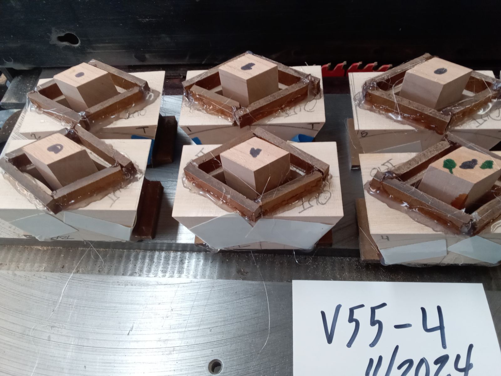

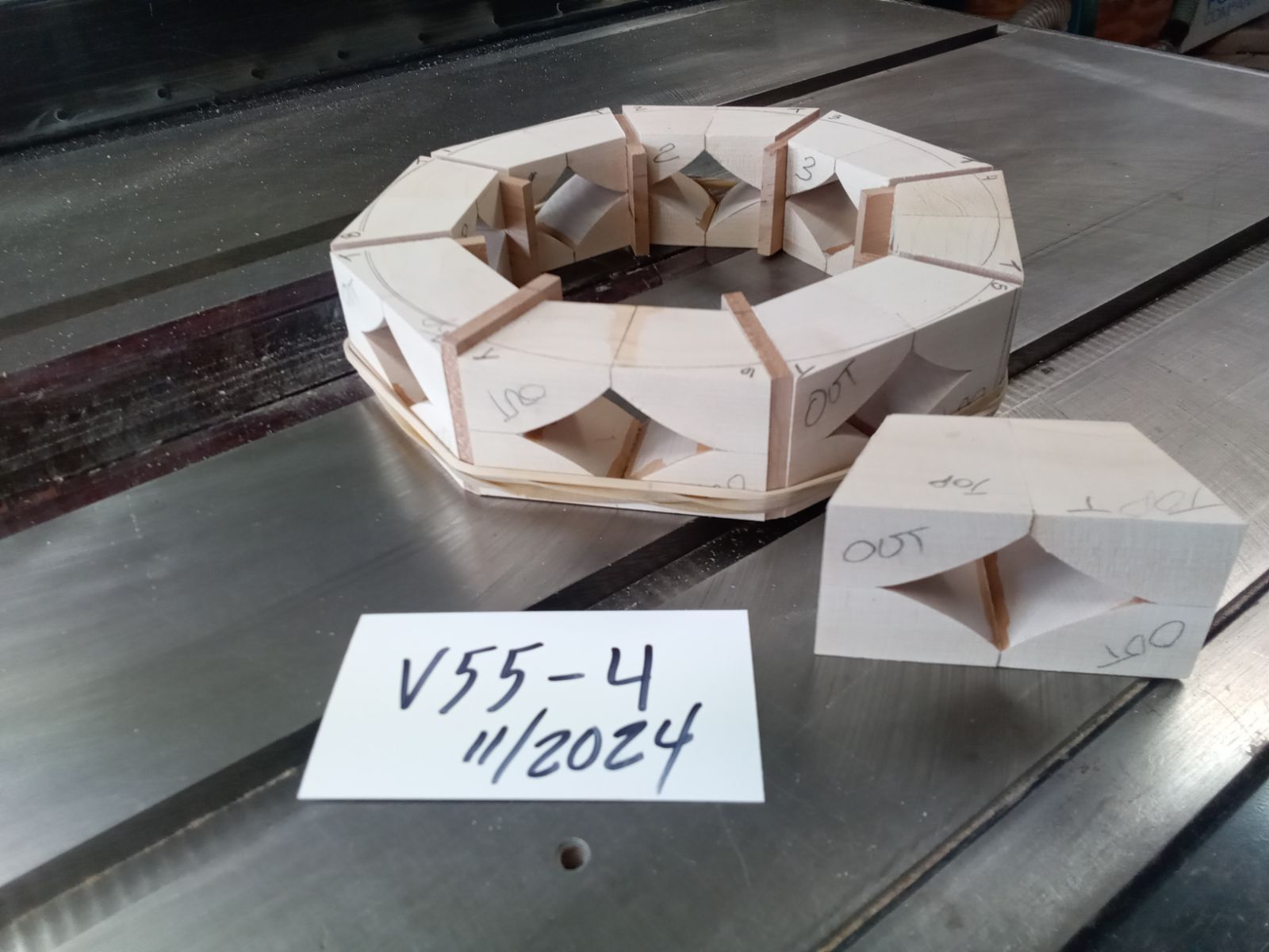

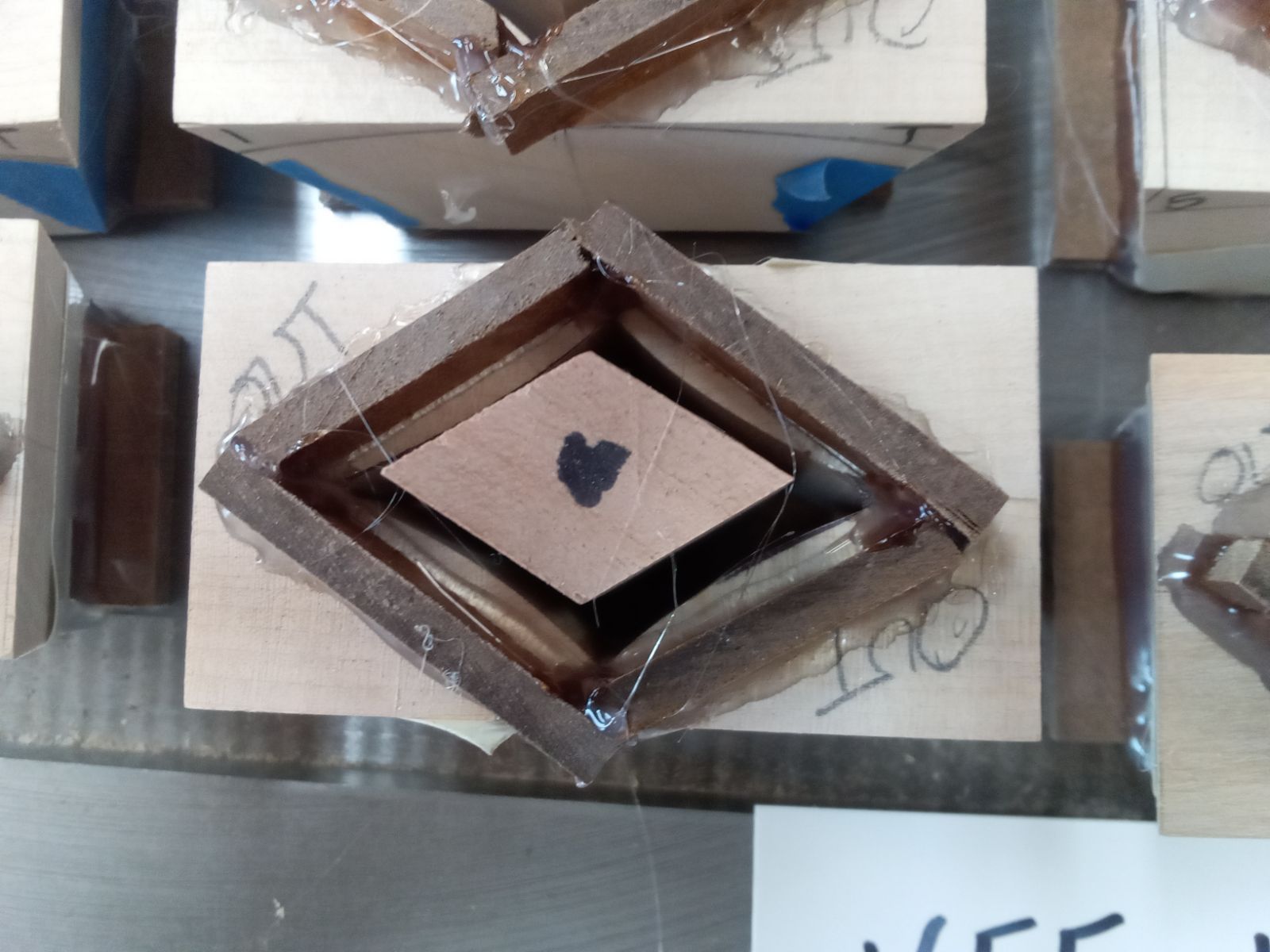

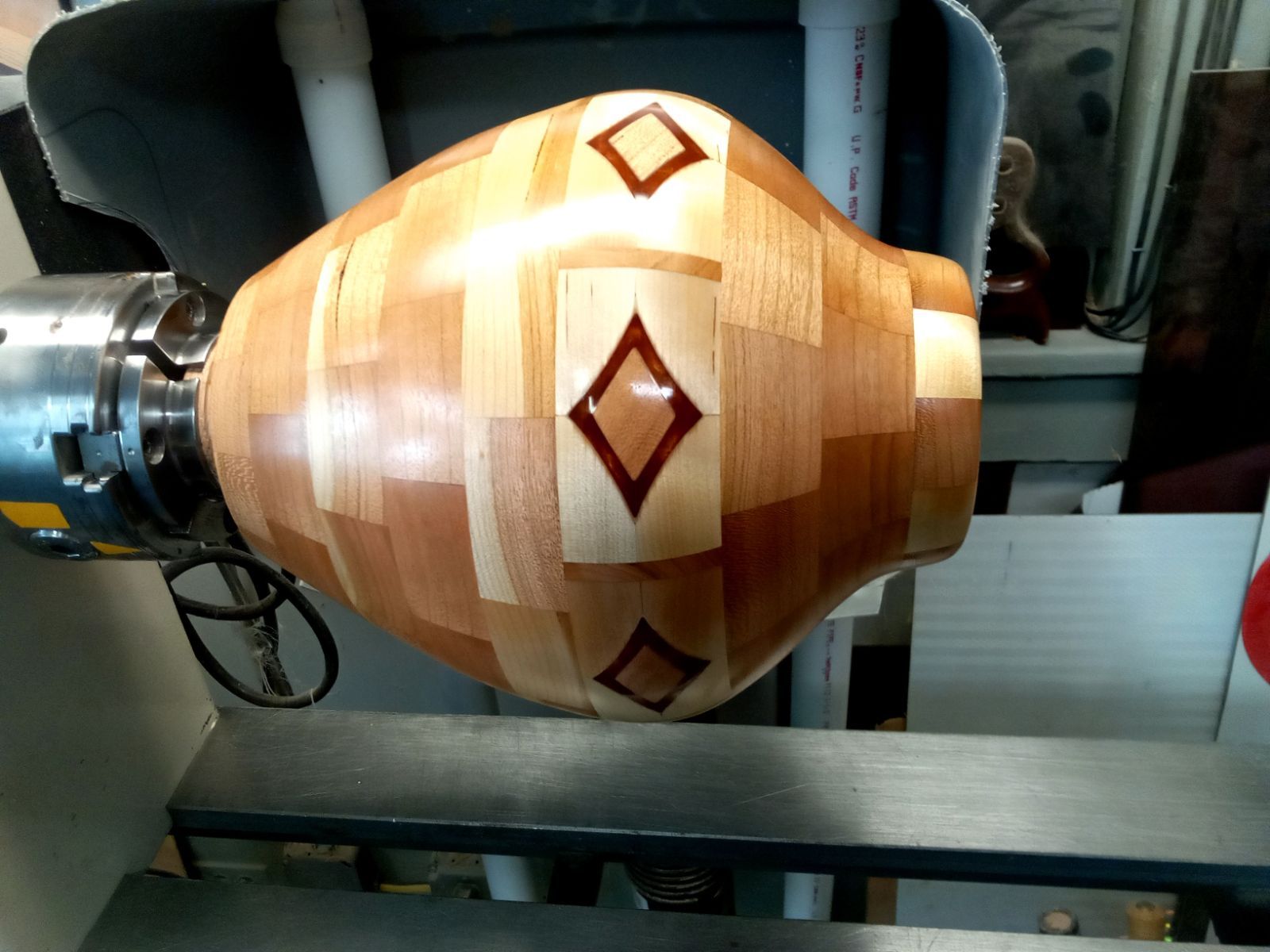

Well been awhile but finally got to the adding finish stage. The feature ring is my second set the first set drank too much moisture from my compressor tons of froth and bubbles so had to start all over again :BangingHead:. Little light on the mica powder so I didn't get the graining I expected but I will be happy just  to keep it in one piece :CoveringEyes:

That is Awesome!
That is incredible @calabrese55Mike! :Praise:

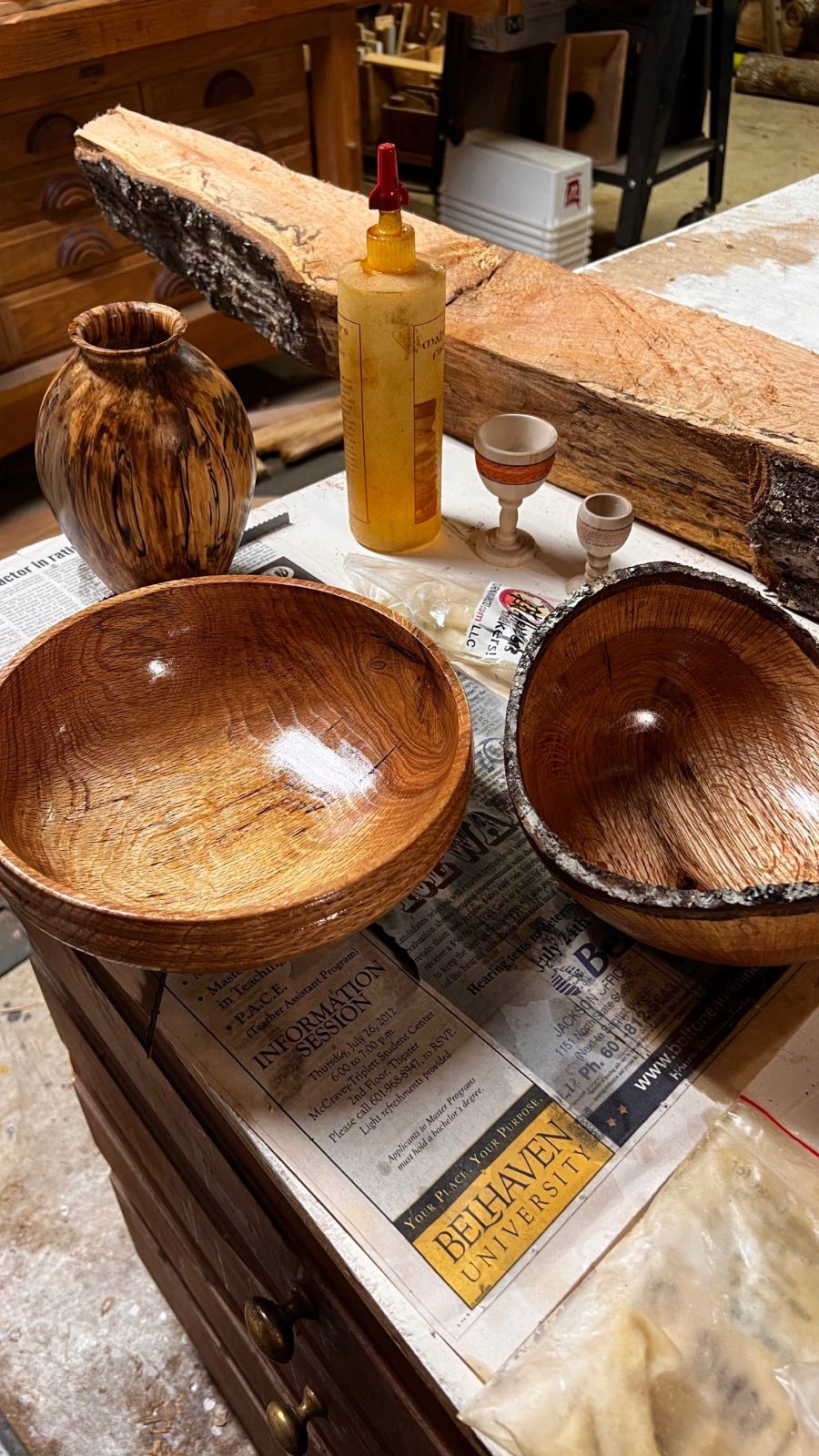

Put the first finish on these today.
All are very nice @Gerald but I really like that live edge bowl. Beautiful. That vase ain't too shabby either.:Praise:

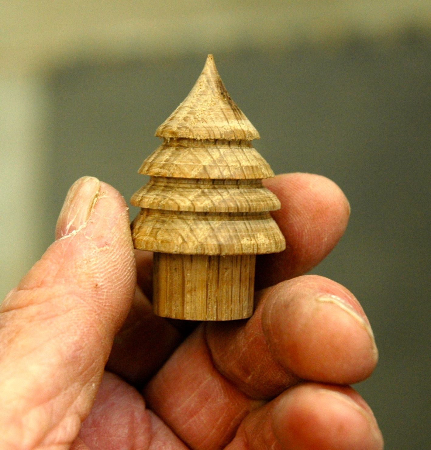

This isn't exactly on my lathe anymore, I took it off to see if I could get a threaded insert installed in it. I'm making a Kissmas tree and the flat work part is right up my alley. But the plan called for a lamp finial and I thought there must be some alternatives. This is a practice attempt at mine. I want to turn a small tree shape finial and the trick (for me) was figuring out the sequence of steps to get the hole for the insert drilled...and then put it in. So this was my second attempt. I couldn't get the tool positions correct on the first and had a catch that chipped out one of the limb rings. I wound up using a carbide detailing tool to do most of the final work given the problems I was having with the spindle gouges. I couldn't get the insert into the first one either. I drilled a 5/16" hole which isn't large enough for this very hard white oak, so on the second one I drilled 3/8" which worked (but not easily). I plan on making the final one out of a small piece of ebony so I wanted to get some practice in before I ruined it.

Neat idea! It's always fun to use the lathe for at least one part in every project!
Excellent @Fred W. Hargis Jr. That'll be a neat touch to the Kissmass trees.
Making the finial is best in my opinion.  Good thinking.
I remember Lew saying some time back how he tries to include some turning on everything, I've decided to try doing that as well. Plus it was another learning experience for me.

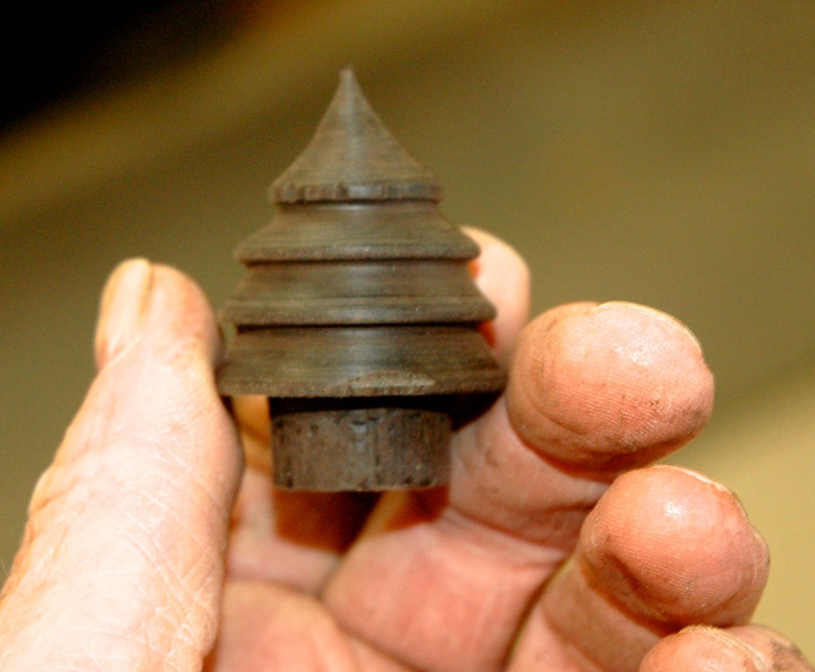

Well, I got one done in Ebony. Not shaped quite as good as I wanted, but it will do. I have to say, this was the first time ever I had something with ebony and it was easier to work with than the white oak I used for practice. Turning stuff this small takes as much skill (I think) as the big stuff....unfortunately I have none of those skills. BTW, I wanted the trunk to be smaller but there's a 3/8" hole in there for the threaded insert.

Fred,
I use 3/8"-16 all-thread for my Kissmas tree shafts. I drill the appropriate size hole in the piece for the finial and use a tap to thread it. Then I screw it onto a short piece of all-thread and mount it in a chuck on my lathe for turning.
Seems to work easier than messing with a threaded insert.
You may want to try this and see if it works for you.
