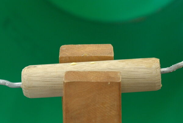

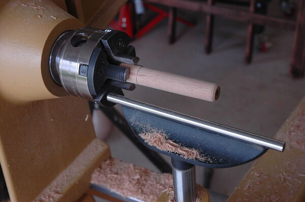

Go ahead, laugh at me, it's been done before. But I had a few minutes of time between doctor visits and starting dinner so this is what i did. I use a lot of 3 and 5 gallon buckets around the property for all sorts of things. But the plastic handles are not only uncomfortable when the buckets are filled with something heavy, they also fracture and break off easily. So I made some wooden ones on the lathe to replace them. Being an untalented turning guy, this gives me a chance to practice using some tools I find difficult (like a skew) and still produce something that's practical (for me) as well. So all I do is turn the handle (always white oak) and then drill a 5/16" hole through it. I then saw in 1/2 lengthwise on the scroll saw (thinnest kerf I have) and glue it back together on the bucket. So that's what's on my lathe at the moment......
Cool way to spend a few minutes of spare time. I like it.
Great idea and if you carve some finger grips in it even better, plus larger size means less fatigue.👍
I wish I had thought of that, finger grips would have given me some practice on coves and beads. I have a few more to make, I'll try that.
Hey Fred......come on man GET A GRIP !!!!!!🙃
