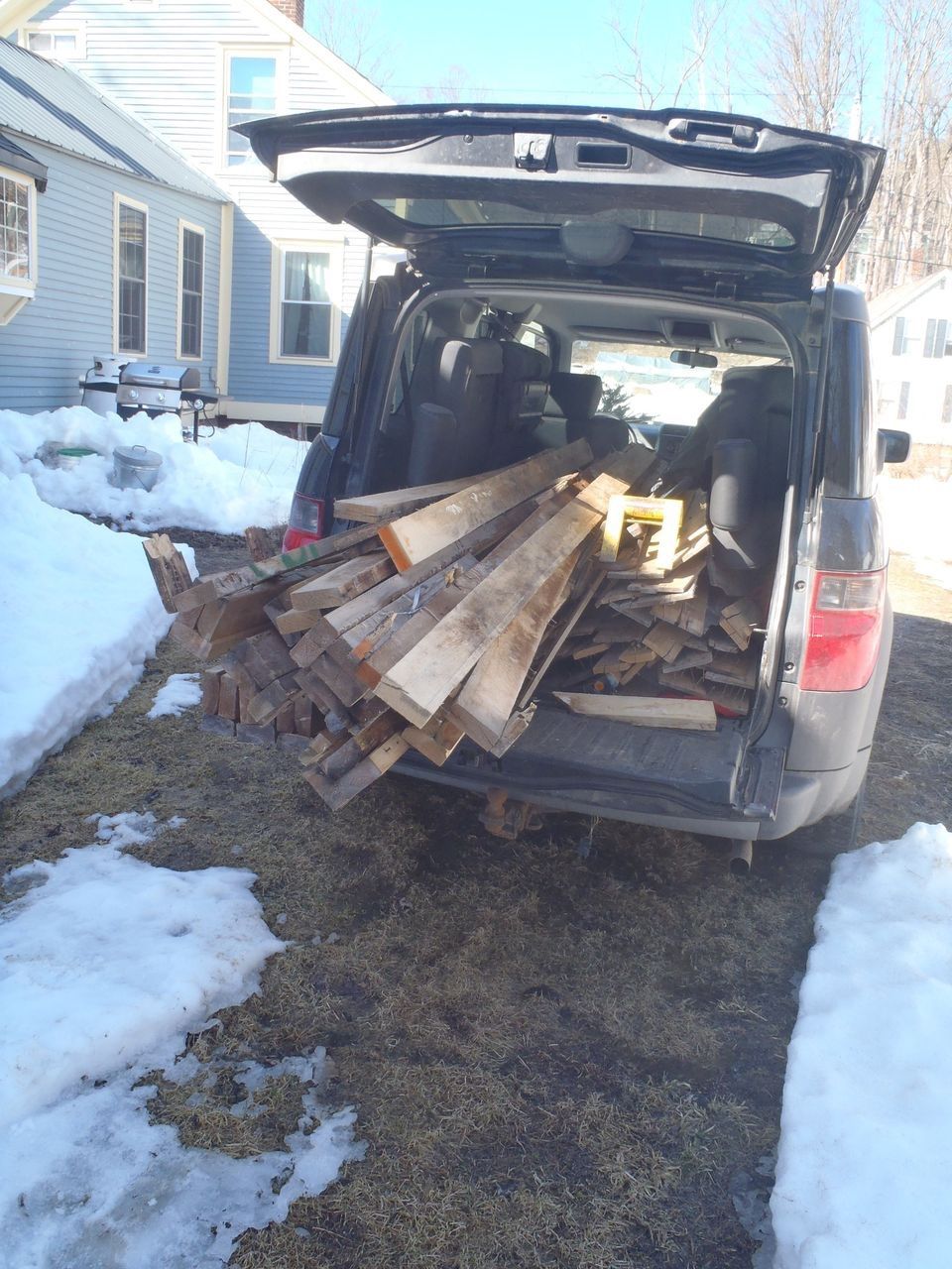

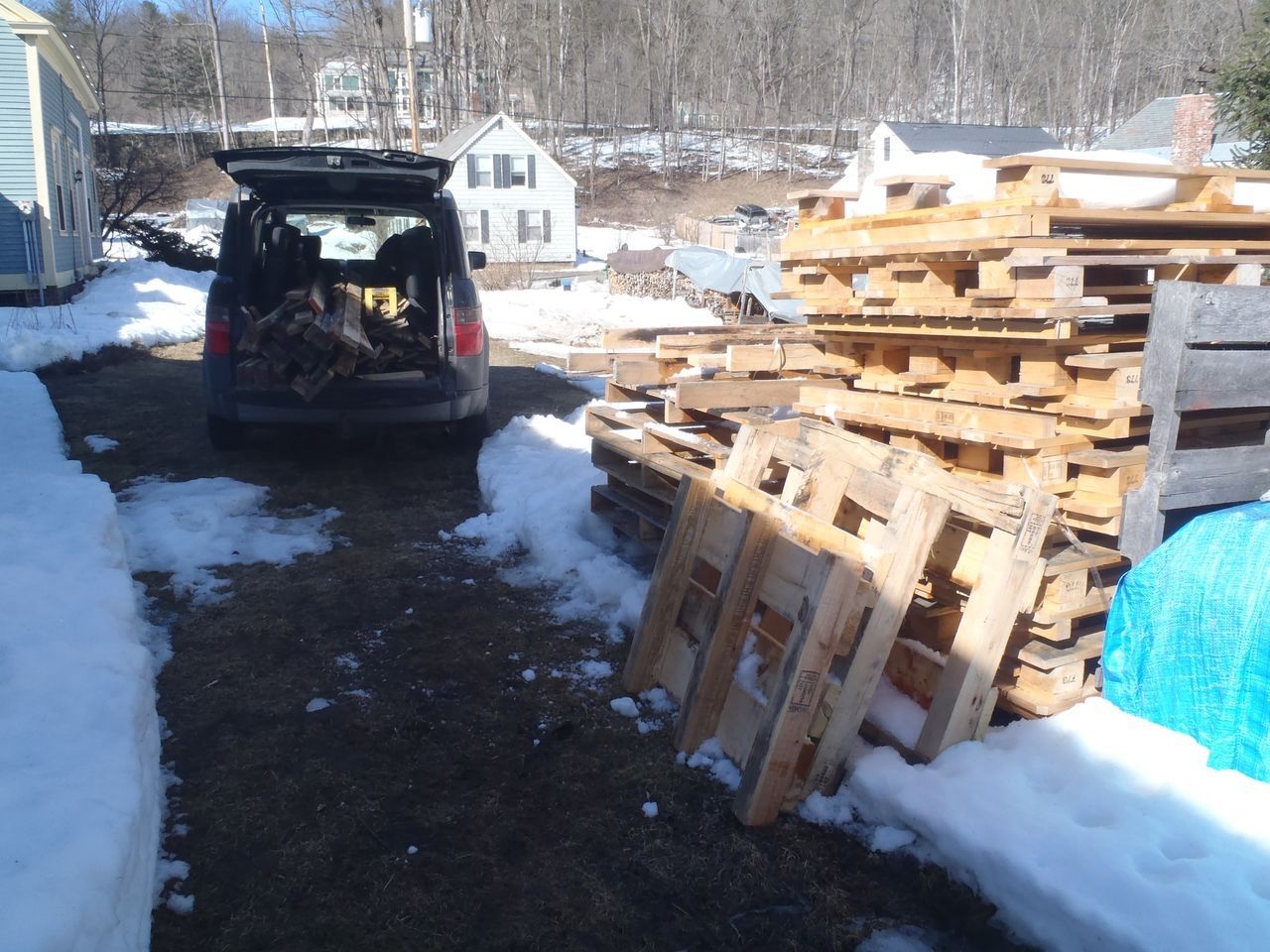

I was in town yesterday running errands and 3 people told me to get out and enjoy the day. When I told one of them I was going to try he said would be outside vicariously through me.
I was almost home when I stopped at the pallet dump and there were some very nice long hardwood pallets there but they were too large to fit in the car. I drove home, picked up my Pallet Bust'ah, and returned.
I think I've got enough to build another shed now.

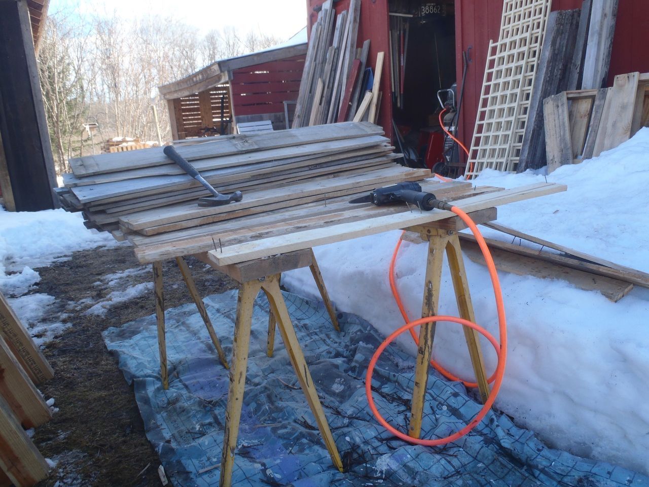

I broke out the compressor and my pneumatic de-nailer and cleaned up all the top boards.image.jpeg.8b51bd01693fb86cfe8de31de0af7636.jpeg

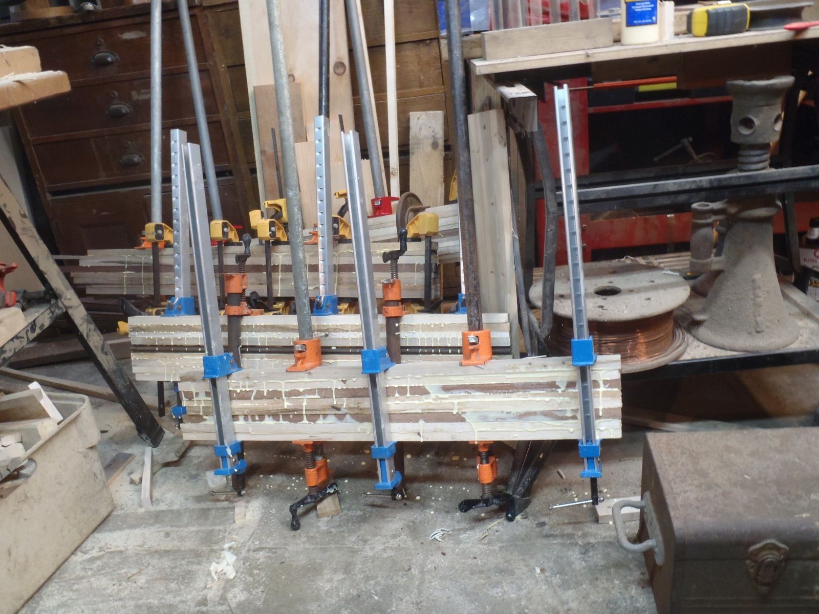

Today I figured I'd actually try to do something with all the pallet wood I scored yesterday. I started to build a small tabletop, it seemed like a nice easy project.
I ran the boards thru the jointer to get one straight side, then ripped them to 1 1/2" on the table saw, and glued them up into 5+" pieces so that tomorrow I can run those pieces thru my 6" jointer, then run the other side thru the thickness plane then glue the four pieces together. Almost 2qt of glue later, I somehow had prepped exactly enough wood.

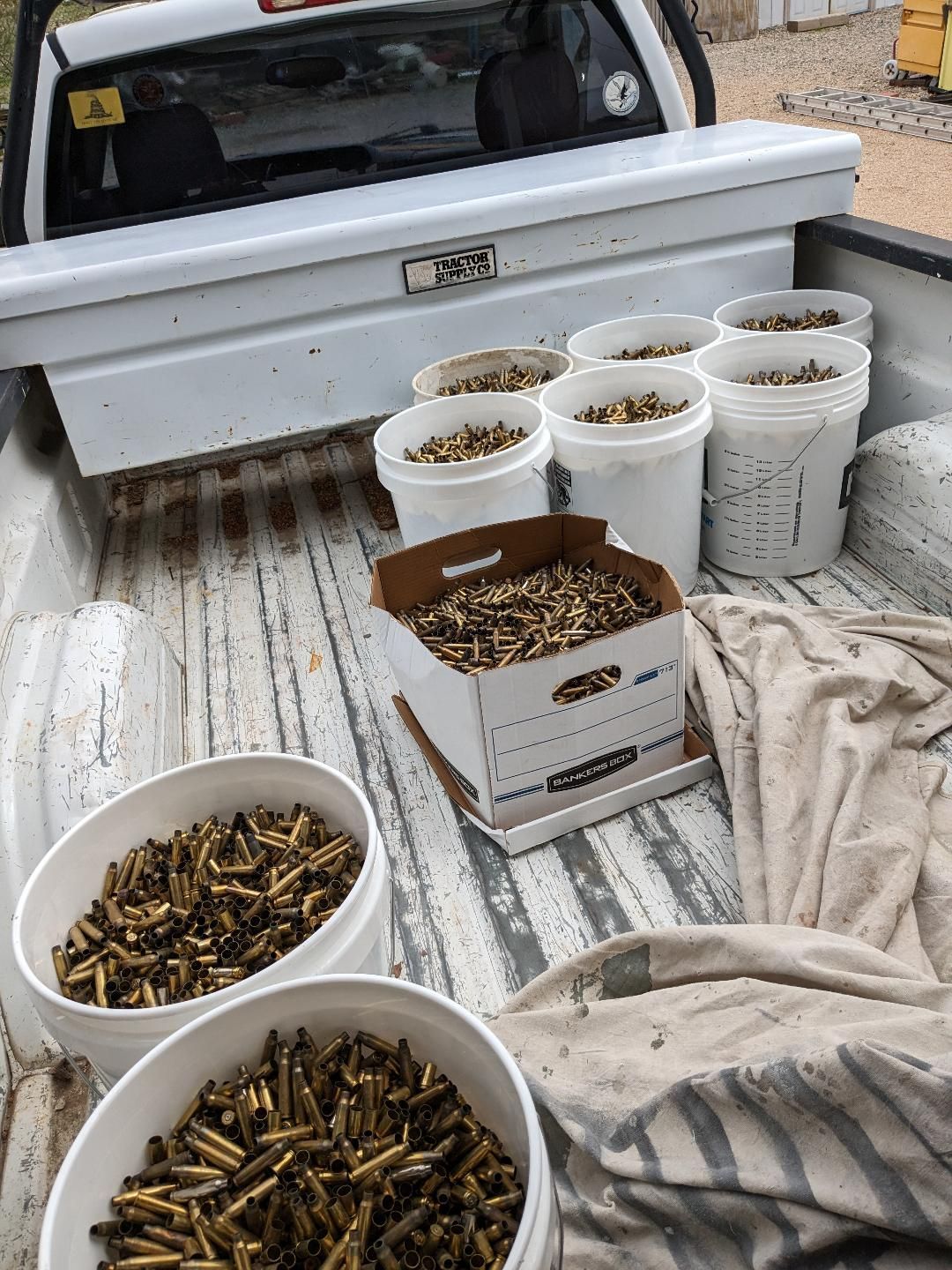

well this will be sorta on my work bench, spent brass from our machine gun shoot, had 21 buckets of 223, 556, and 9mm with a smatering of .45 acp, picked up on tuesday, from our guys, and have so far sorted only 5 buckets, once sorted throw'm in the cement mixer to clean them up and then dry them, for prep for reloading,
last year i reloaded over 50k rounds, this year, hmmm, primers are at a premium, so am minimizing reloading and using the cheapest ammo.
i have dillion reloaders, can do about 350 an hour if i get help can have three presses going and well you know ends up bing about 1k an hour, so not too bad if all goes right.

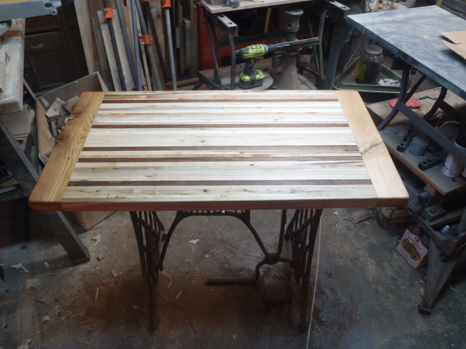

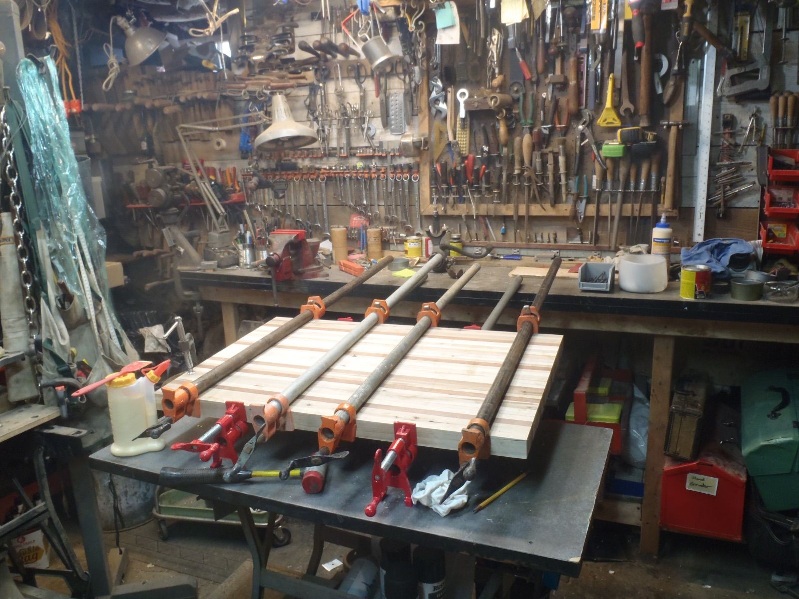

The four 5" pieces were jointed on two sides, run thru the thickness planer, run thru the table saw, cut to matching length, and glued.

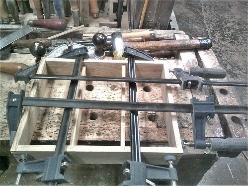

Saturday's bench top...

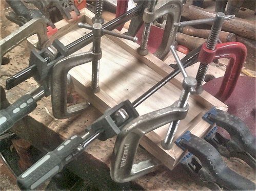

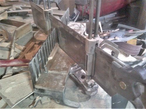

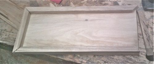

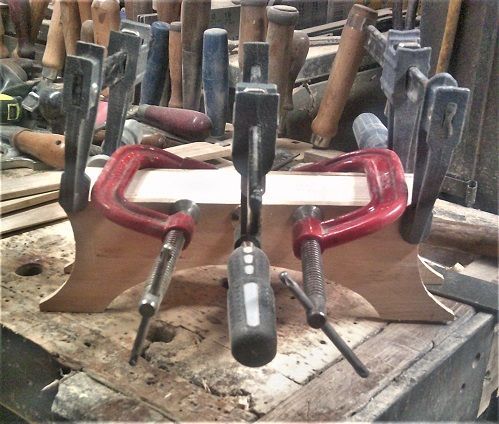

Lid gets a collar
Via the Mitersaw...
The Cordless Version...

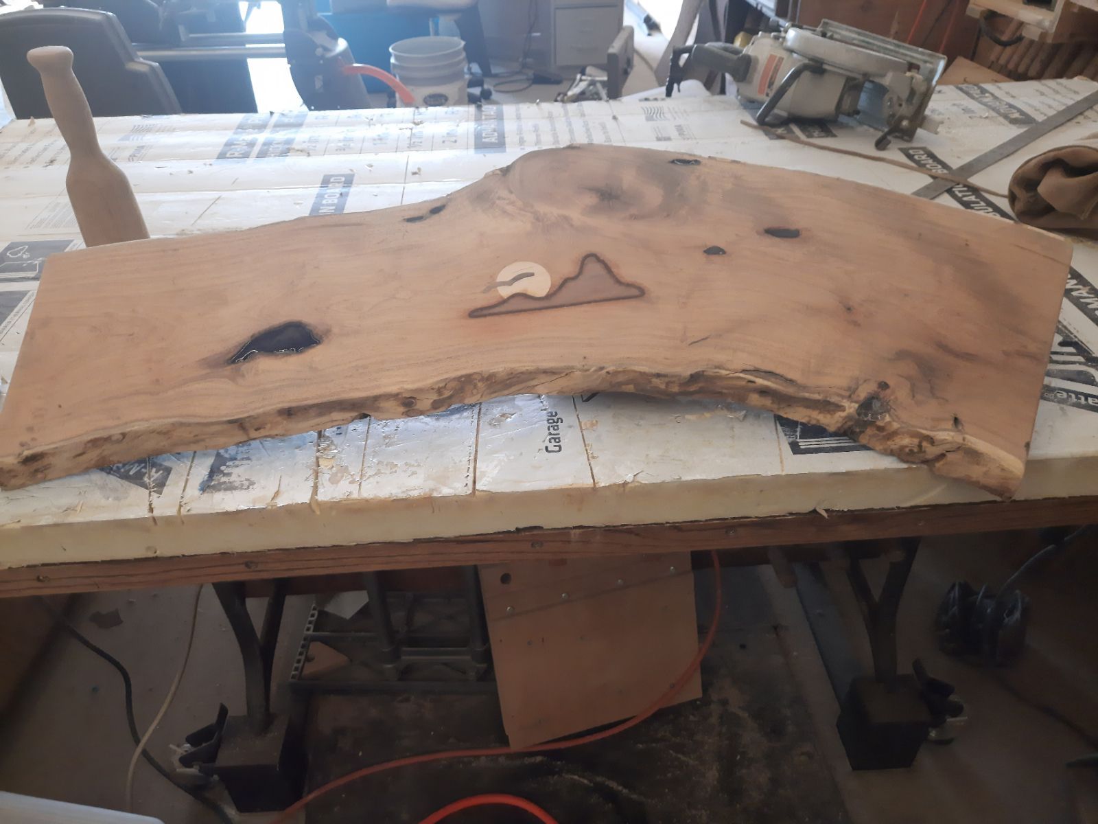

About to get this wrapped up. A couple flood coats of resin and install the legs and, it's  done.

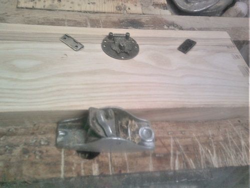

Well now..ain't it cute?
And..it is made from Aluminum, to boot....or than the steel cutter  #102...I think the Brass latch might weigh more?

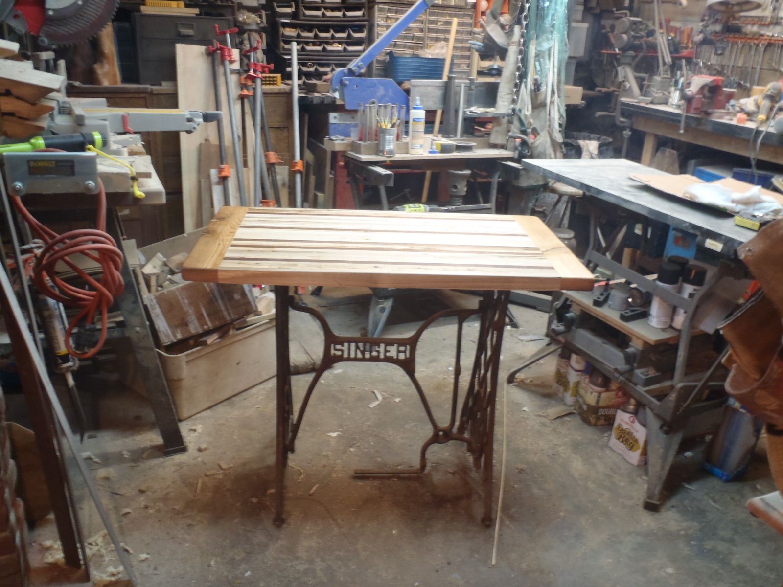

@frenchwwr. That's awesome Kevin. Love the look. Gives me an idea to consider for my Singer stand much like yours.
Thanks for sharing.

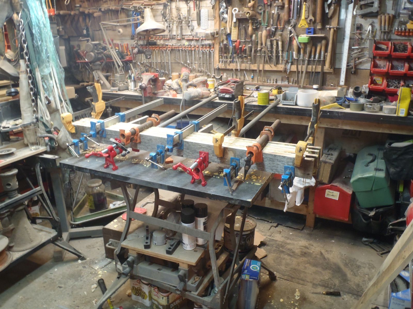

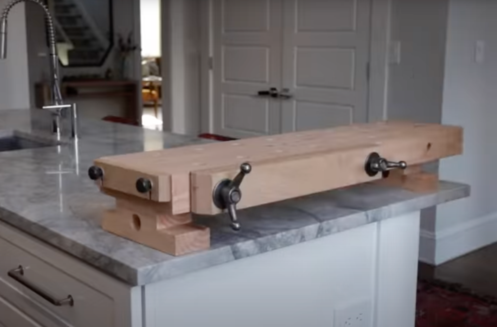

Tonight I cut up enough pieces of pallet wood to make this portable workbench.
I don't have a workbench and I don't have room for a traditional one so this mini bench might be a good workaround.

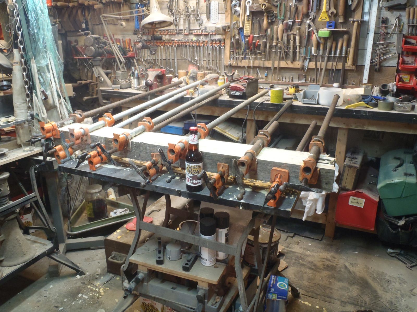

I found some more clamps so I started gluing up of two 5" wide pieces to make the workbench. I'm still working on how long the bench will be.P3130789.JPG.593b38f9d67301436d07ce4240eb0dc1.JPGP3130790.JPG.7263d1265b099241f9af160b08dc5c39.JPG
You know you have too many clamps when you occasionally find more. ;)
As you've got a B&D Workmate under there you should add a rib to the bottom of the mini-bench so you can clamp it onto the Workmate.
And I just ordered 8 more, I need shorter ones.
I have a piece of countertop on my WorkMate that I can Clamp to thru the hole in the foot but the rib is a good idea for using it on my WorkMate in the barn.
I have a bit of a screw-up. The one I am copying was made from 2 pieces of 2 x 10 laminated together, so I cut my hardwood into 3" strips. This thing is going to be HEAVY!
I think I'm going to mill it down a bit.

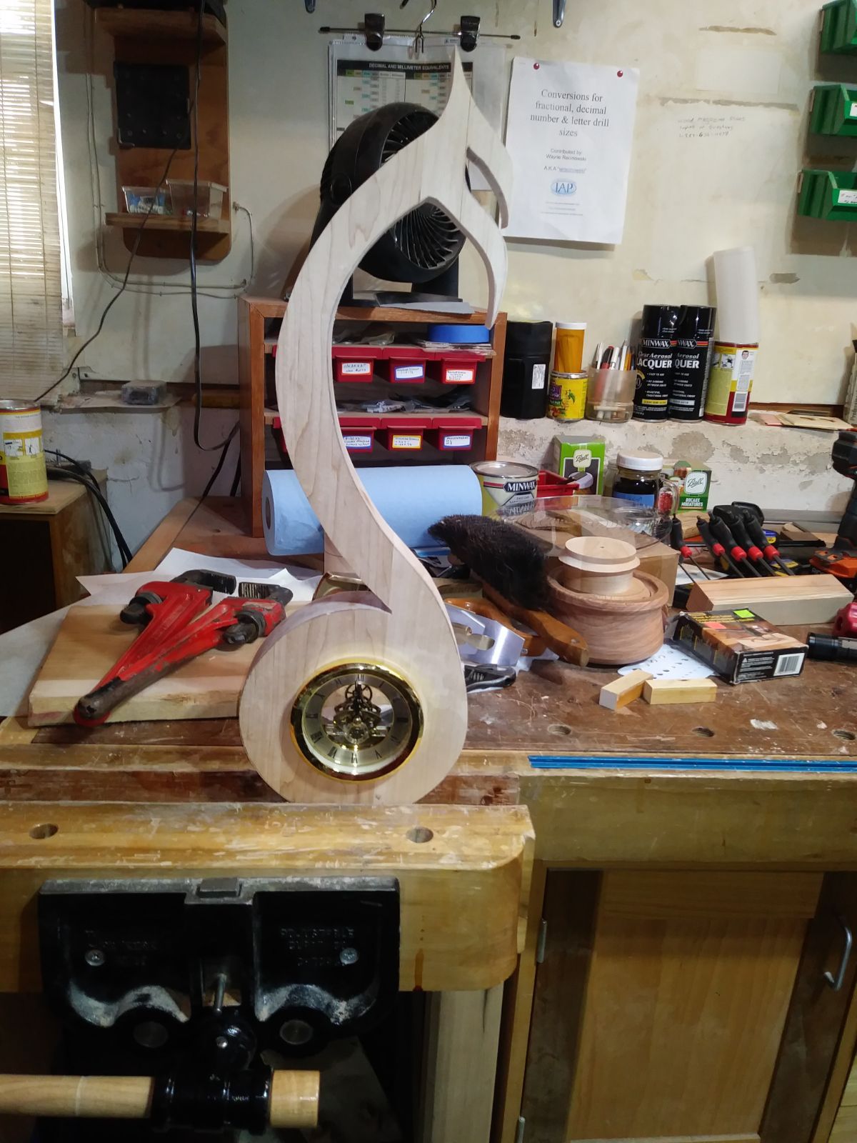

I've been working on a clock for my brother in law.  He lives in Lakewood CO, and plays in a cover band there.  I thought he would like a clock in the shape of a musical note, so that is what I've been working on.  This is my second try.  The first one came apart when I was trying to shape it using a flush trim bit.  I guess the bit caught some end grain, and pieces went flying.  Same thing on the second try, but the break was clean enough that I could temp glue it back together and then cut through the joint with my band saw to get a cleaner edge.  After regluing, it seems to be holding together.  It still needs sanding, the front edges eased, and finishing.  I tried black dye, and that looked great while wet, but when it dried, it turned a dark brown.  I settled on a black stain that is indistinguishable from thick paint.  I'll use that and top coat with semi-gloss or satin.  Haven't decided yet.  Hope the picture comes through OK.  I'll post more when it's all finished and ready to ship.
Looking great !
Very cool and creative @PostalTom. Looking forward to seeing this to completion. Thanks.
