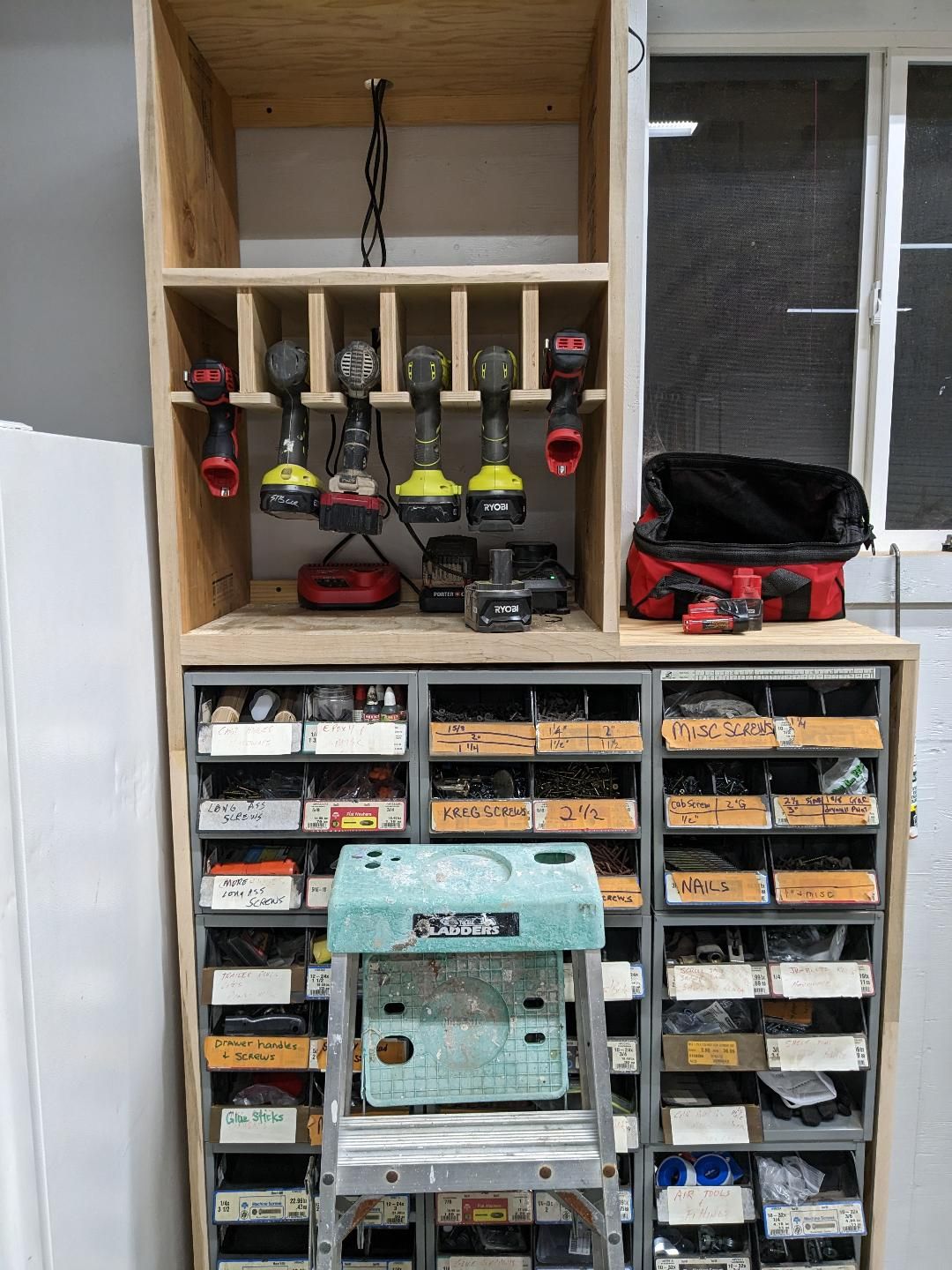

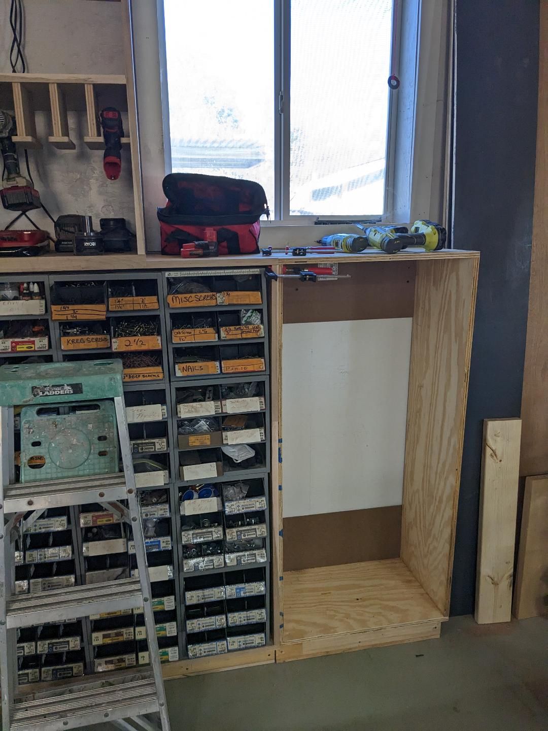

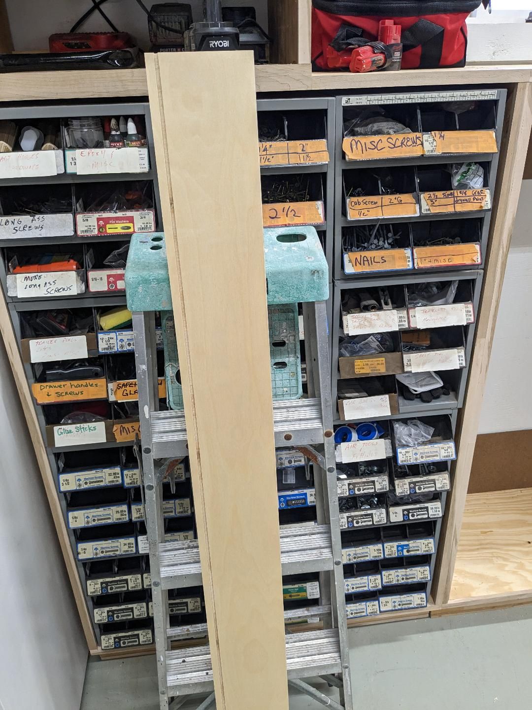

new project i've been wanting to work on for a while has been relocation of parts bins, and add more, and on top will add a charge station for cordless units and storage, along with some shelves to the right of it, will be the counter and chop saw table, it works out great as my chop saw takes up about 20 inches from wall to fence, so, the parts bin cabt is only about 16 inches deep, so i can make an support extention past the cabt, to pick up an extra 3ft of length as i only have a total of about 10 now, till i hit the lathes. so, we;ll see, managed to get toe kick built, 2x4 will build plywood box, put a hardwood edge on ply, add the narrow upper so i don't block window with chargeing area, shelves ect. the chop saw bench/table, will have a hidden floor sweep, in toe kick so i can sweep up my messes for dust collection, Plywood gets ripped tomorrow, and hopefully i can get this done whilst the ole gal is off gallavanting around in kali with her ilk.
i have a whole shed stacked with these bins, i grabbed them at an old ace hardware store that closed a few  years back, why i picked up a whole lot, not sure, as i have plenty and frankly am only gonna use 12 , well maybe in just this spot. lol who knows. i got stuff to store, and never again see the light of day, i need stuff.

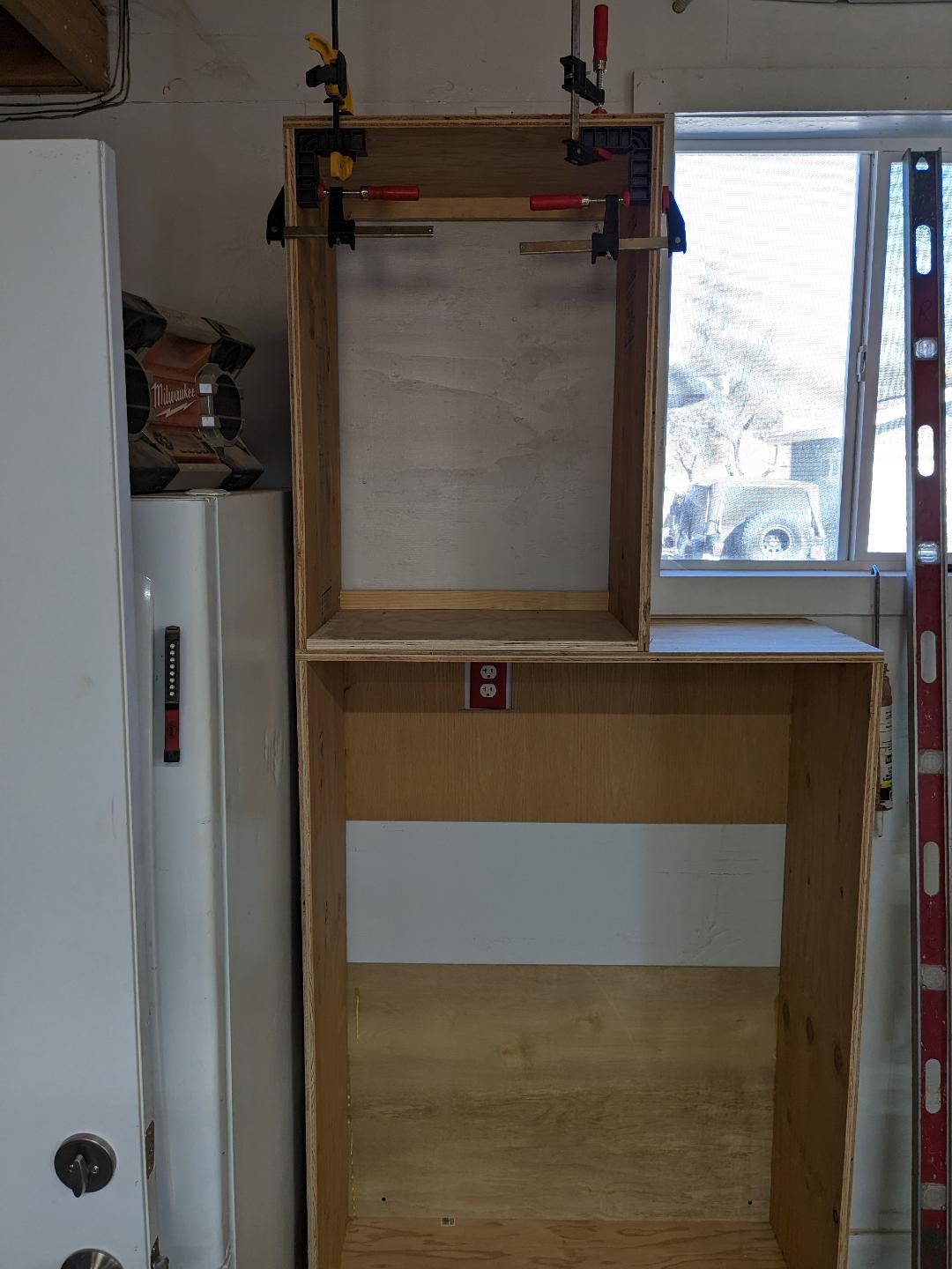

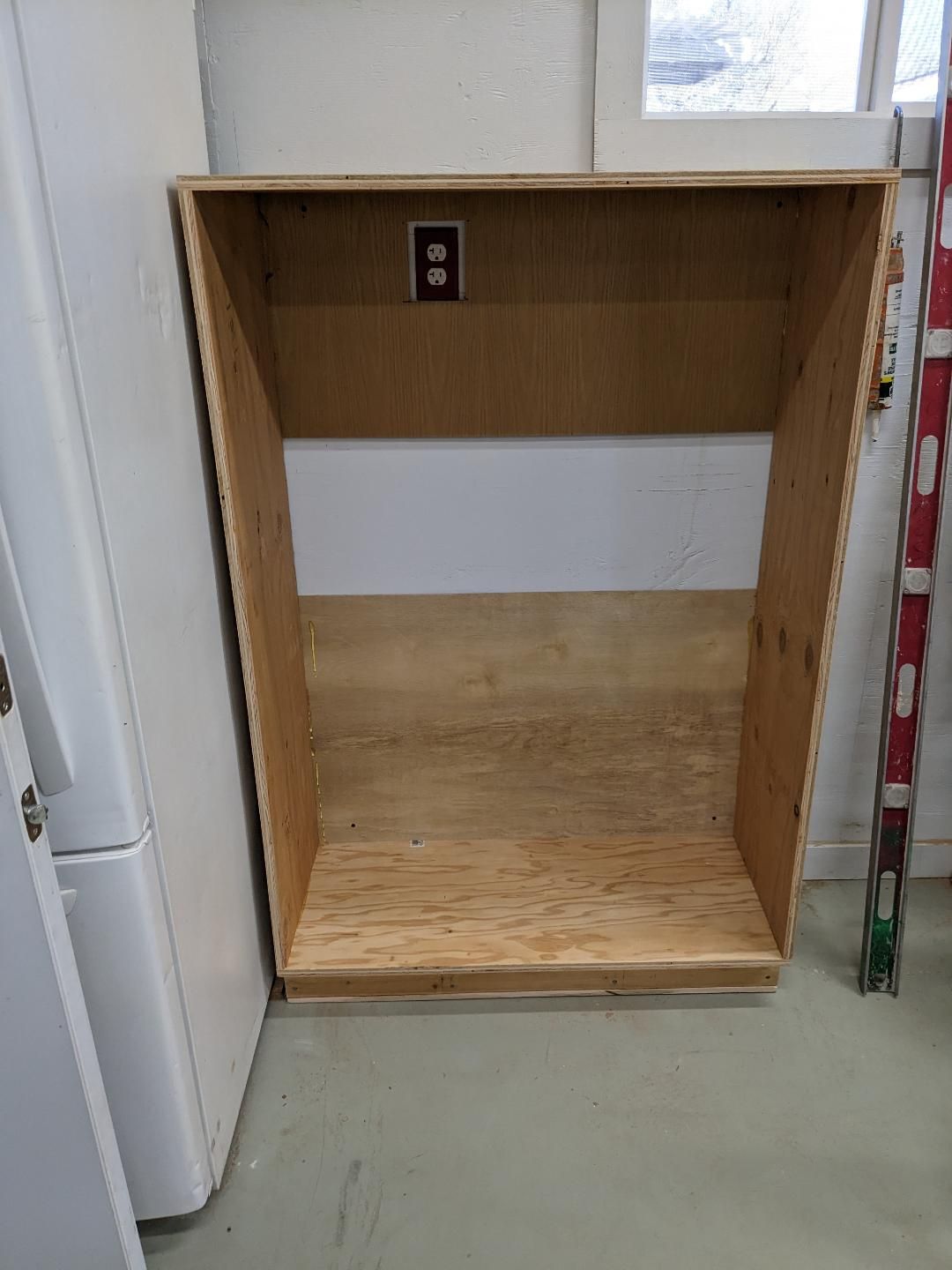

okay pics as promised;  managed to get this mostly done, struggling with how to hang the drills and impacts, in my garage i used pvc white pipe, and hung at bot of upper cabt. thinking i might just do some wood pcs, i have measurements gonna draw something up and see if i can wing it.
i like it so well think i'm gonna build a two bank wide to other side of window, still will allow me to build lowers to put chop saw on and add drawers to hide the rest of the crap, that i'll put in there and never remember where i put it.

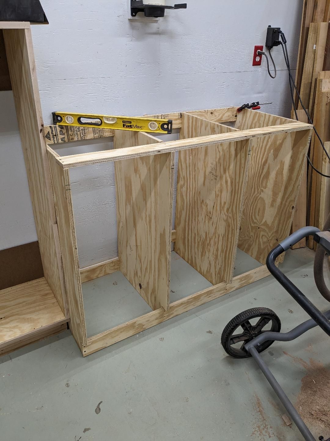

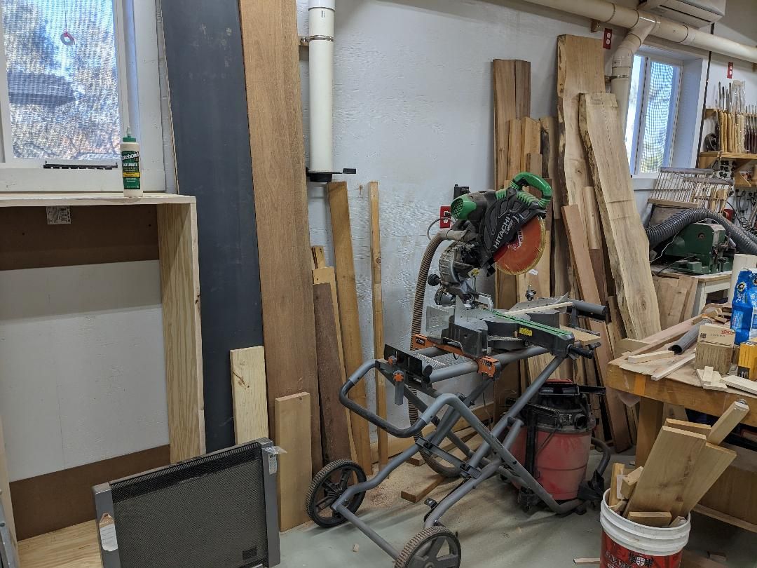

so had to modify the toe kick, forgot i used 4'' base in shop, so, in order for cabt to fit tight to plywood wall, yip had to raise it some, puy maple edge on ply cabt carcass, not sure ifn gonna paint or just seal, see what the boss says.
i drilled holes in upper to hit the upper plug for the charging station, in the shop just about every outlet that is at 50 inches has one at about 8 ft above it, this is due to well stuff against walls, was easy to do, and i'm care ful about all the things i plug in, one never knows.
any howz, maybe tomorrow i'll bang out the other one, and get the organizers in place.

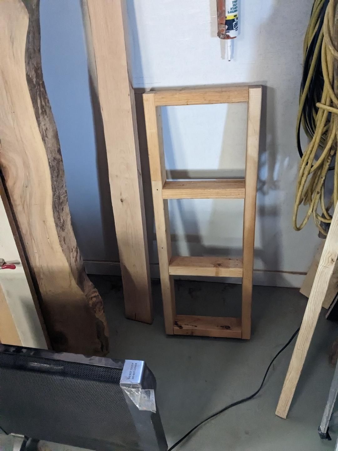

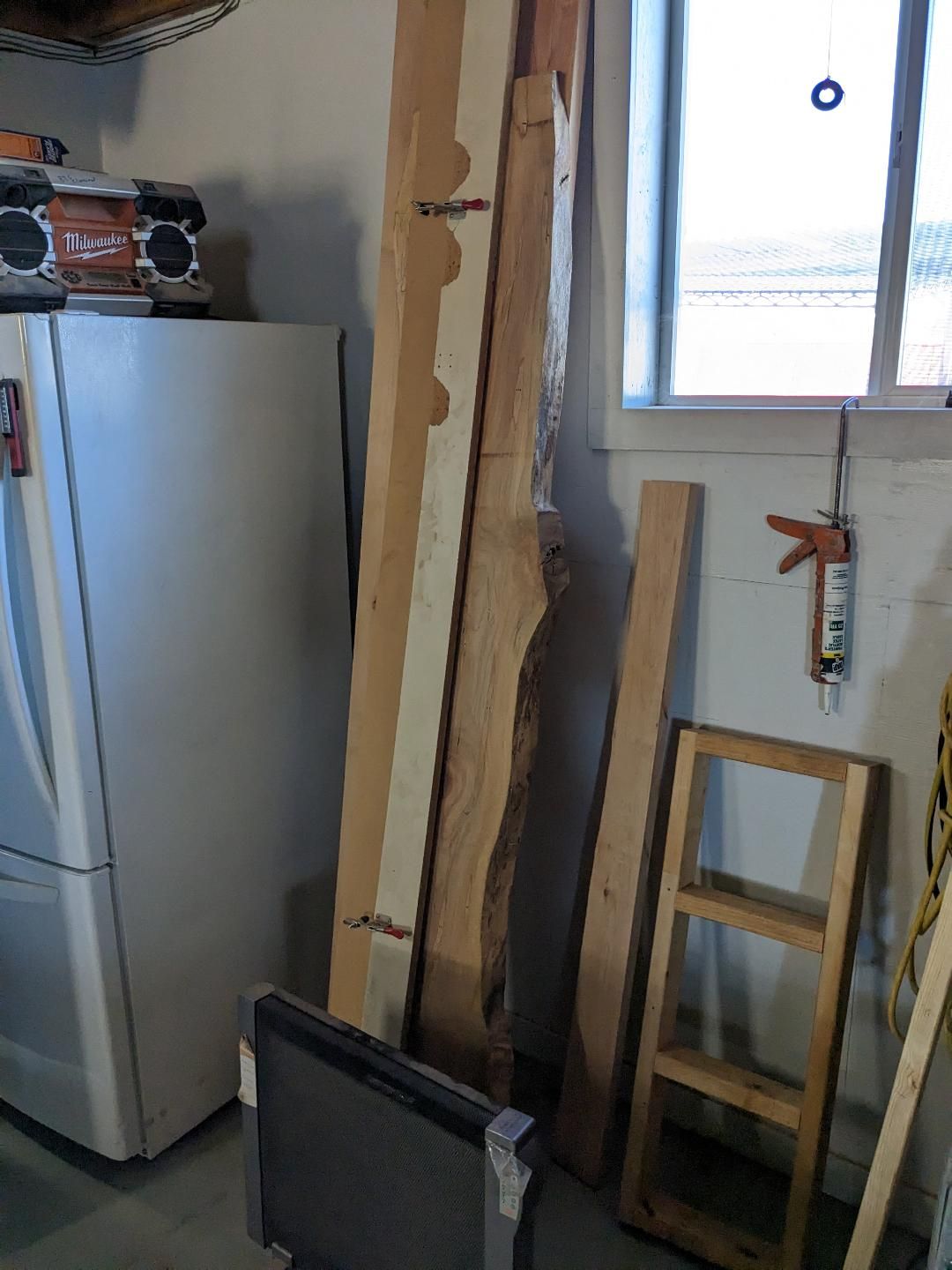

i opted to ,make one outta wood, have a little clean up to do on it, but essentially done, gonna make the other bank of cabts for the organizer bins tomorrow, then plan the cabts and chop saw bench. may end up moving the lathes some, not sure, dang it wished i could make up me mind, lol
and i coulda made'm a couple inches shorter and get more access to shelf, hehe, they aren't glued yet, so think i'll wack'm tomorrow and raise up a tad.

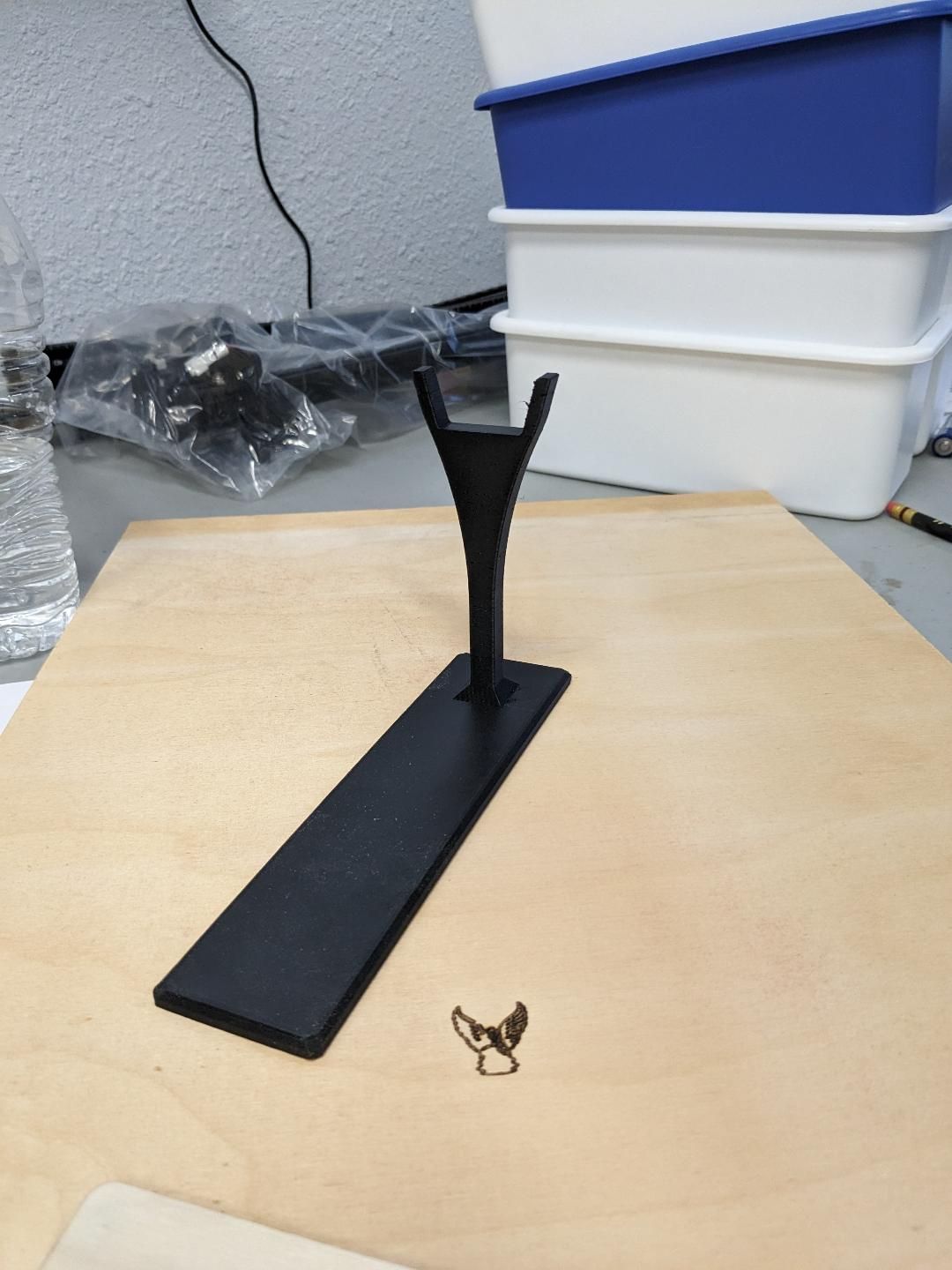

well did get cabt, built but didn't get hardwood edge on it, and or the organizers installed, did however get 3 d printer working, wowza, pretty simple even for a simpleton, and we did some cnc coniving, having a repeat cut issue, it tends to be off a tad, so there is that, but overall am extremely happy with all i've purchased, the printer, the lazers and most of all the cnc router.

this is a pistol stand via the 3 d printer, this was on the flash drive, so we just pulled it and walla. about 3 hour run

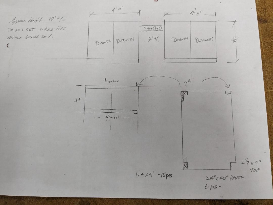

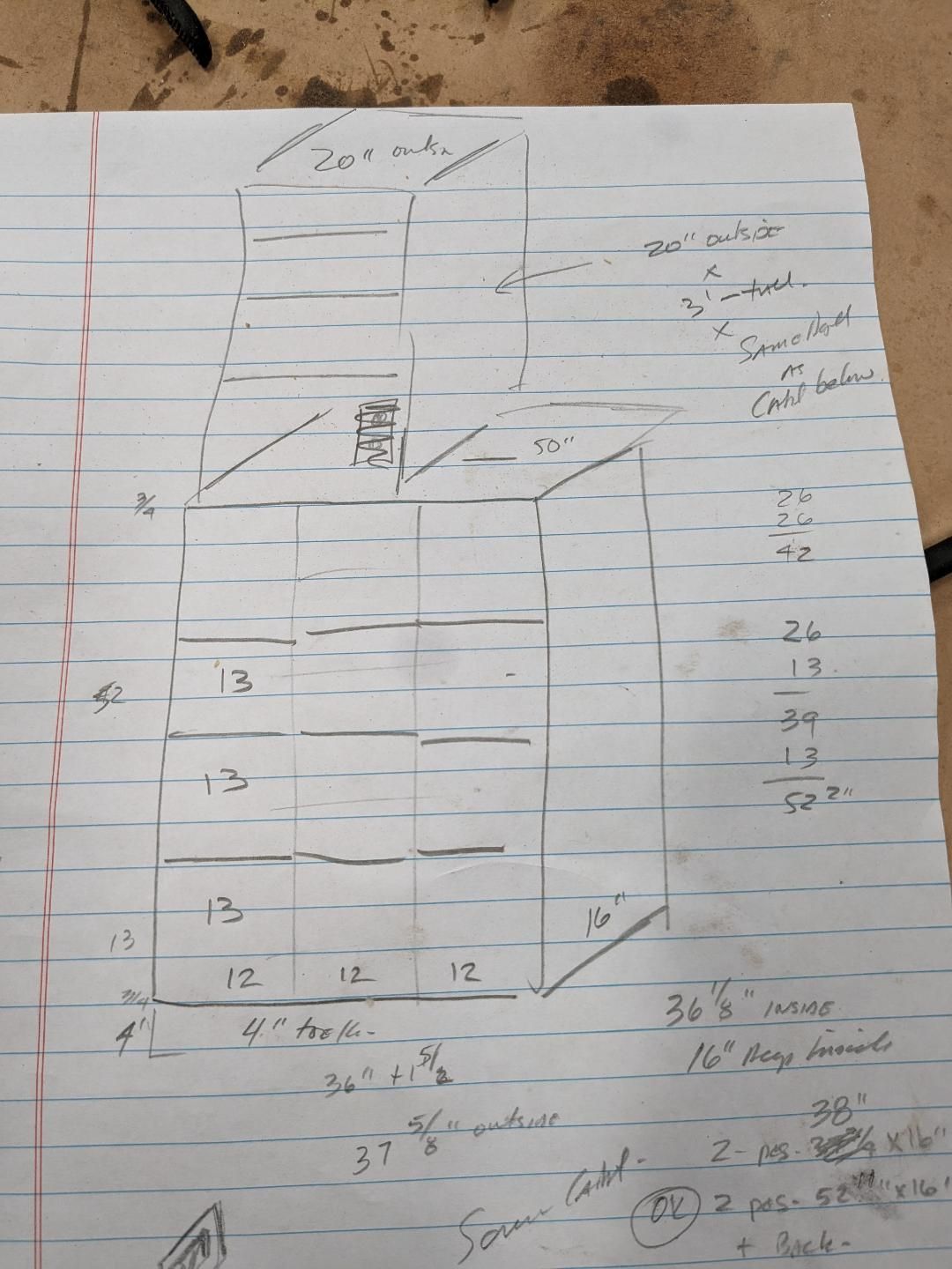

i'' maybe provide a silly dwg on my thoughts. of storage, gotta do some configuring to see if theres enough room
well slow day in da shop. med appts, and general laziness, and some sky leakage, off and on, enough to get windshield wet, again have med appt at mayo at 8, then free rest of day, if not raining found some particle board in so.phx, for cheap to make double thick counter tops, for mitre bench and a few other things,
did get hardwood edge on the new addition to organizer area, and did a dwg on the new soon to me miter station
and decided to make a deep drawer to put the saw blades in, i change blades maybe once a month pending how much ripping and cutting we do, and did also pick up two new in box glue line blades for cheap, so i'm set till mid summer maybe.
see how it goes, won't take long to rip out all parts,
i'm also gonna hit a local vendor galaxy lumber, they sometimes have prepped drawer pcs for cheap out of solid wood, might save me machine time, ect. who knows,
i have the drawer guides full extention heavy guys,
cheesey dwg attached, goal is to getr done. this week.
well as usual, i changed my layout, discovered the drawer material i purchased was shorter than anticipated, so adjusted some sizes of sections for drawers to maximize matl usage. and probably will adjust the right size cabt to accomodate the festool storage boxes.

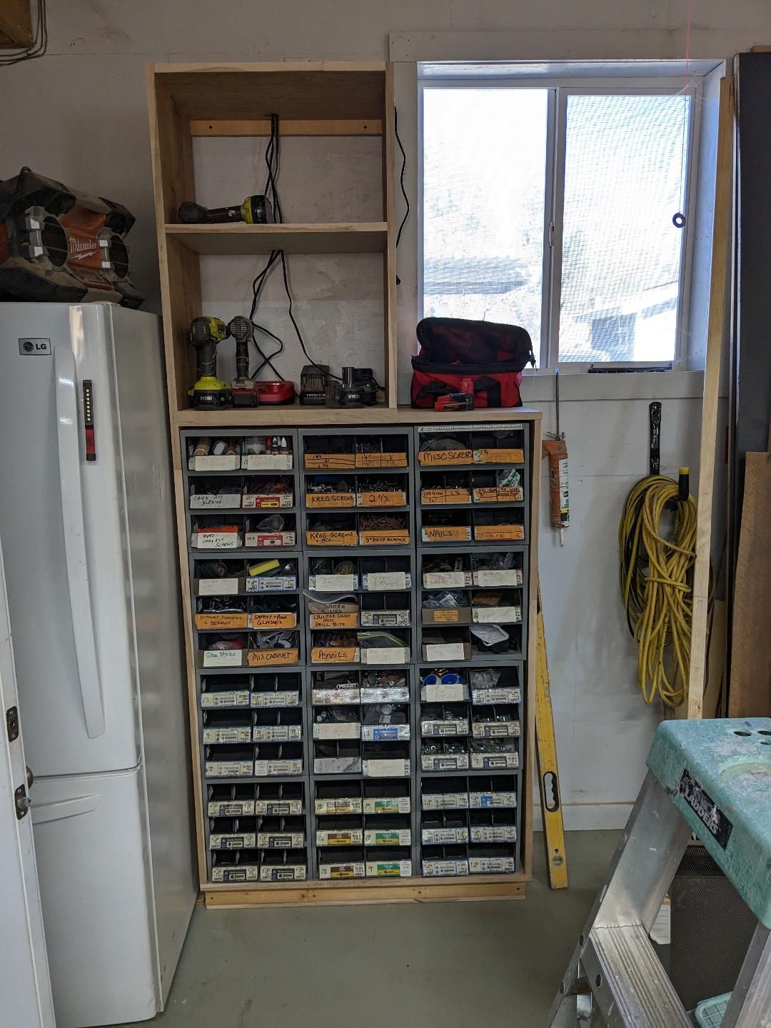

didn't take long to move everything, well yeah it did, who am i kidding, i'm moving at a ant eaters pace, anyhowz, built it pretty quick and set it.
grabbed all the drawer guides, and guess whats missing, the drawer guide screws, i have a gaggle for the recessed screws for other types but no pan heads, so, trying to decide if i want to torture myself by going to big box store or just go to bolt store is a tad farther but they usually have what i need, or i have to go to back up plan and start some grape juice therapy. ugh, i tore the joint apart looking for screws, so as soon as i buy a box, they'll turn up, just life i guess.

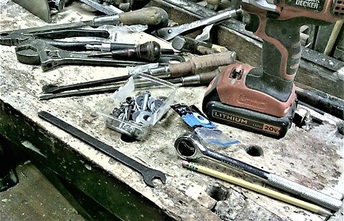

So..what on my bench, at the moment...?
Just the usual mess....
Unless you count the top of my tablesaw as a bench....folders work...
They will lock when the legs are set up...
have to leave it set up, to brush on a finish....while I clean off my bench...

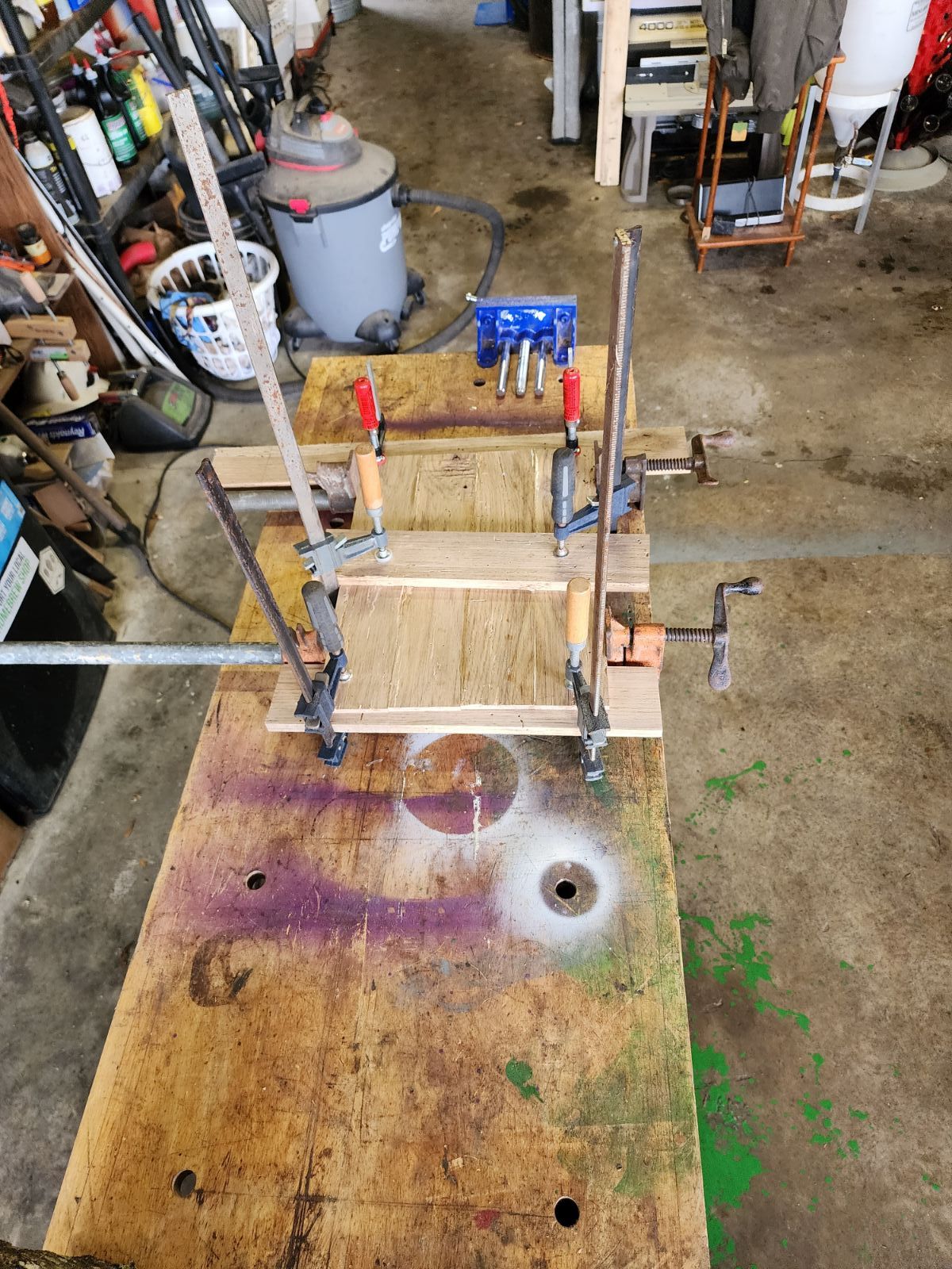

Need a couple of little keepsake boxes so the bottom panels need to be glued up.  Should be enough for two or three little boxes.
These thin little panels are  pain to keep flat while clamping.
