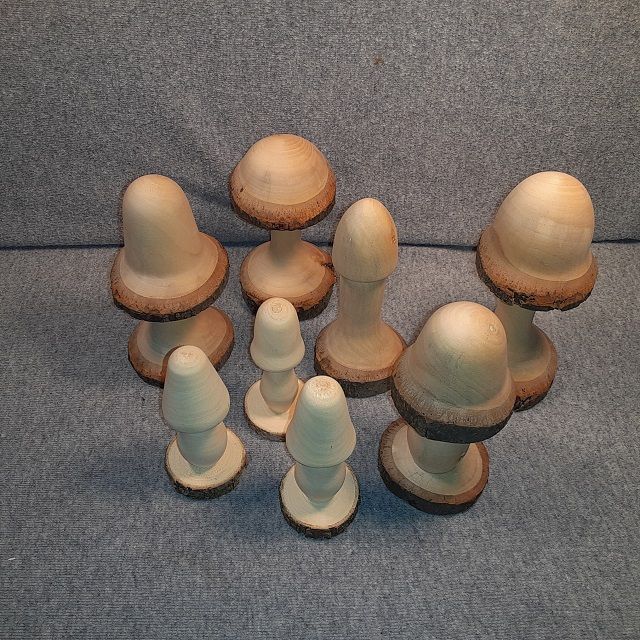

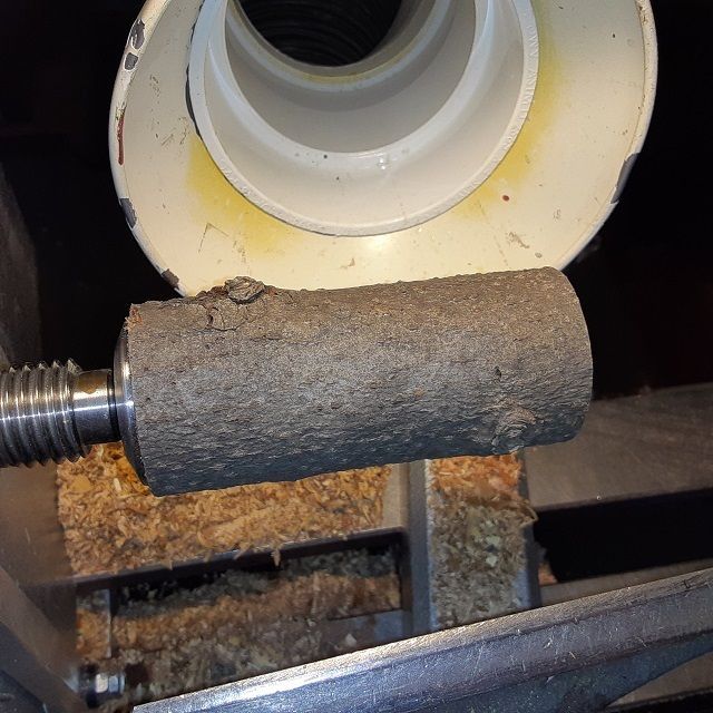

Playing with making mushrooms using branches.  I put them between centers using measured centers since thw[e branches are usually curved and also oblong in shape.
Mount one end to s screw chuck.
Go to town turning one.  They are addicting and the fun part---no two need to be alike.
There's fungus among us
.40
Apologize for the dumb question: what are "measured centers"....I've not heard that phase before.
I measure to the center in a few places because the branch is not symmetrical.  If an object is round or square a center finder is the cat's meow.  Placing them between those centers is the best way to center the overall piece.    I wouldn't be so picky but I'm trying to keep the bark on the edges so I include the bark in the measurements..  I choose which end I want to use as the bottom and cut it flat so it will stand straight.

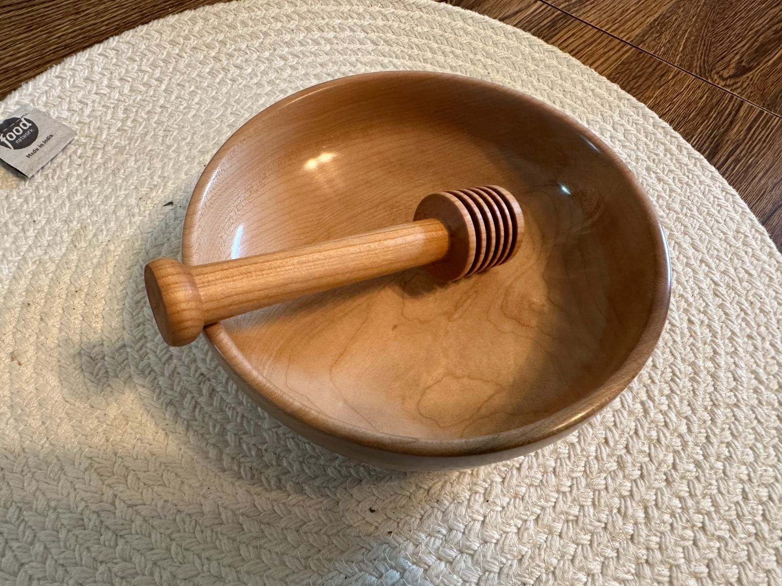

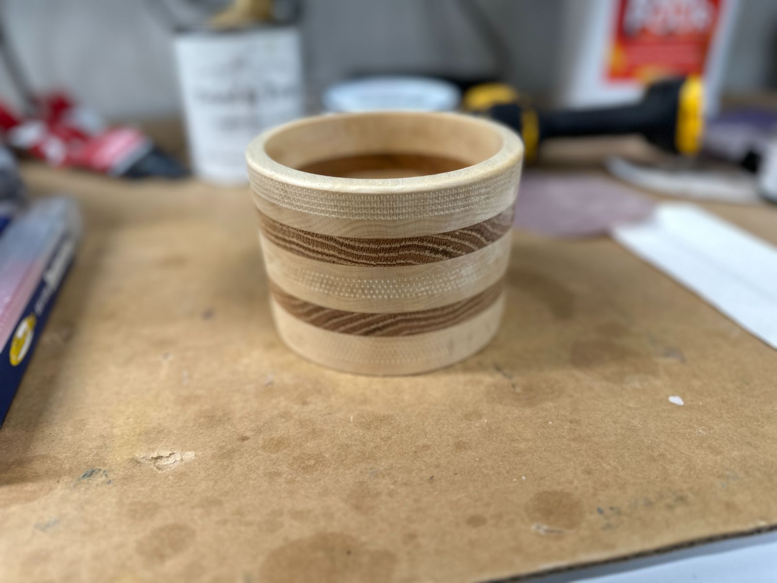

Cherry honey dipper, maple plate, cup made from maple and red oak.
Gorgeous!!
Nice.  What did you use fir the texture on the cup?
I used a 12 TPI - 3/8" texturing tool I got from www.peachtreeusa.com.
I just got it today as a matter of fact.  very heavy duty and seems well made.

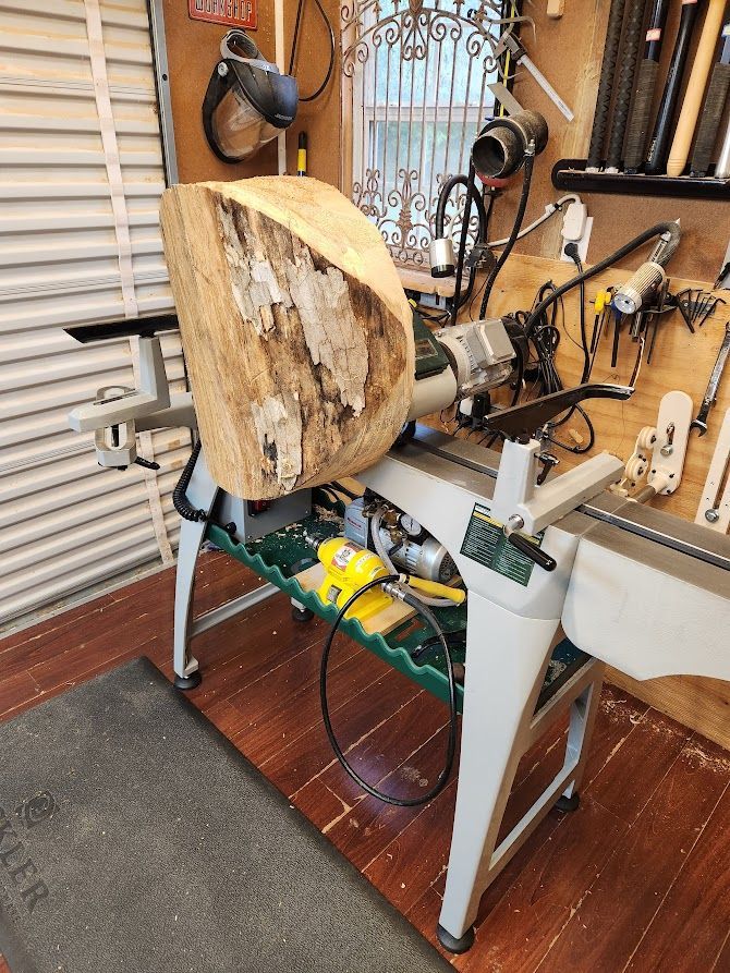

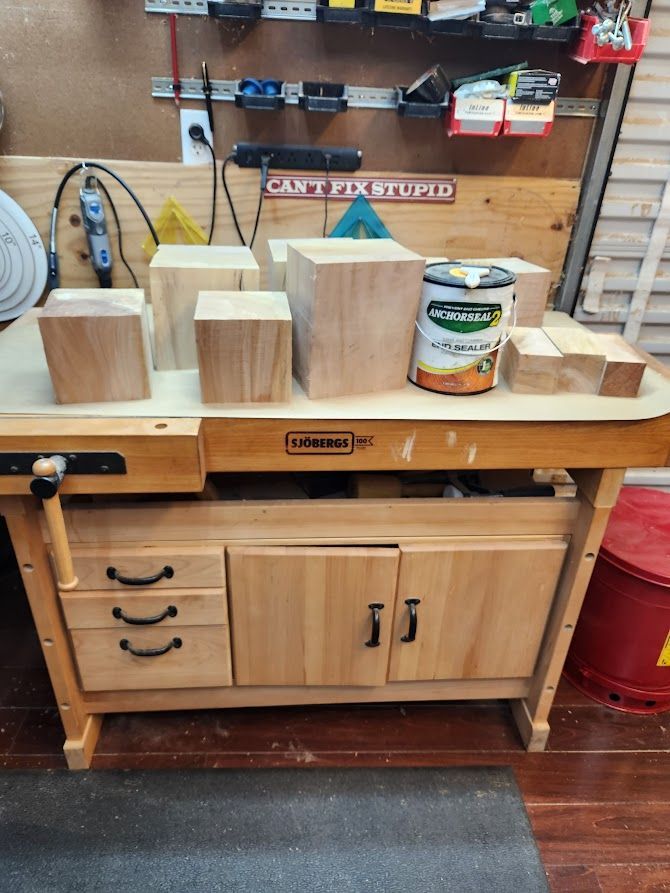

Worked with the large sycamore blanks again today. Unfortunately, the large bowl blank (26") on the lathe was rotten to the core and it was moved to the fire pit. Punky band longways through the middle. I was able to penetrate in several places with an ice pick to a depth of 6" with one finger. Deemed unsafe to turn.
Number 3 cut into smaller blanks. This allowed me to cut out the rot.

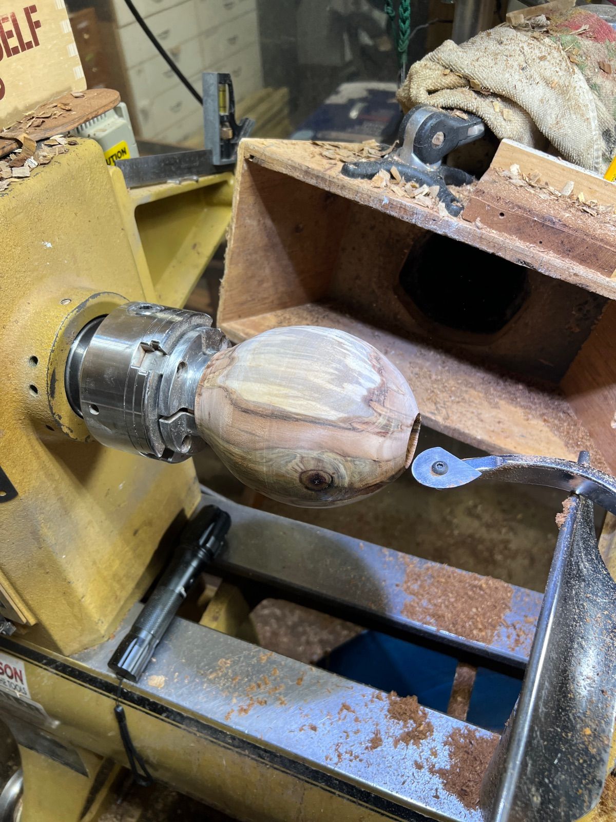

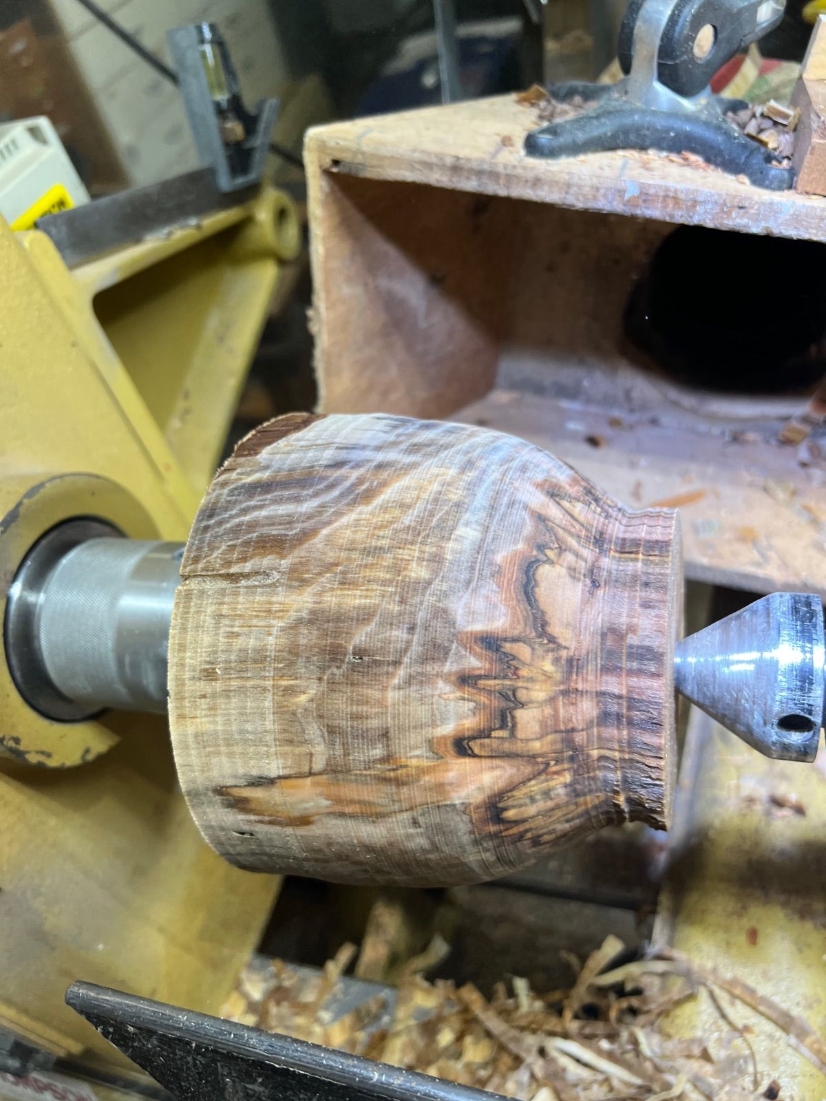

Finally got to o that Sweetgum log in yard. Rather soft in pith.
a look at the pith and heartwood.
working on the tenon
Hollowed after this shot and didn’t get pic.

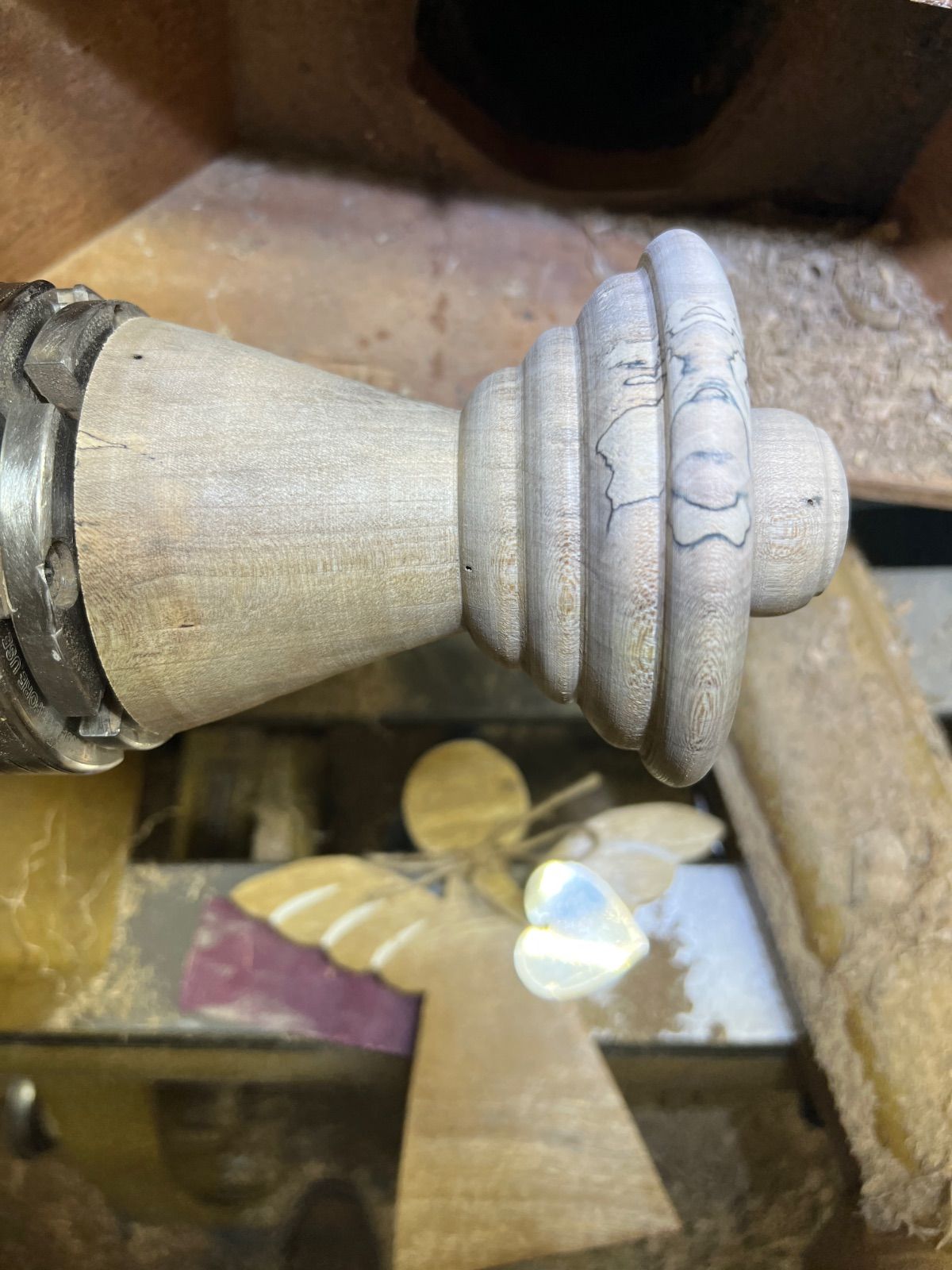

second project a big trial. Wife had the angel on lathe bed and it hit me I could turn one. Tomorrow cut front and back of ribbed area to make wings
Back to the Angel and cut the wings. Wife says to leave it plain, maybe hang something around the neck.

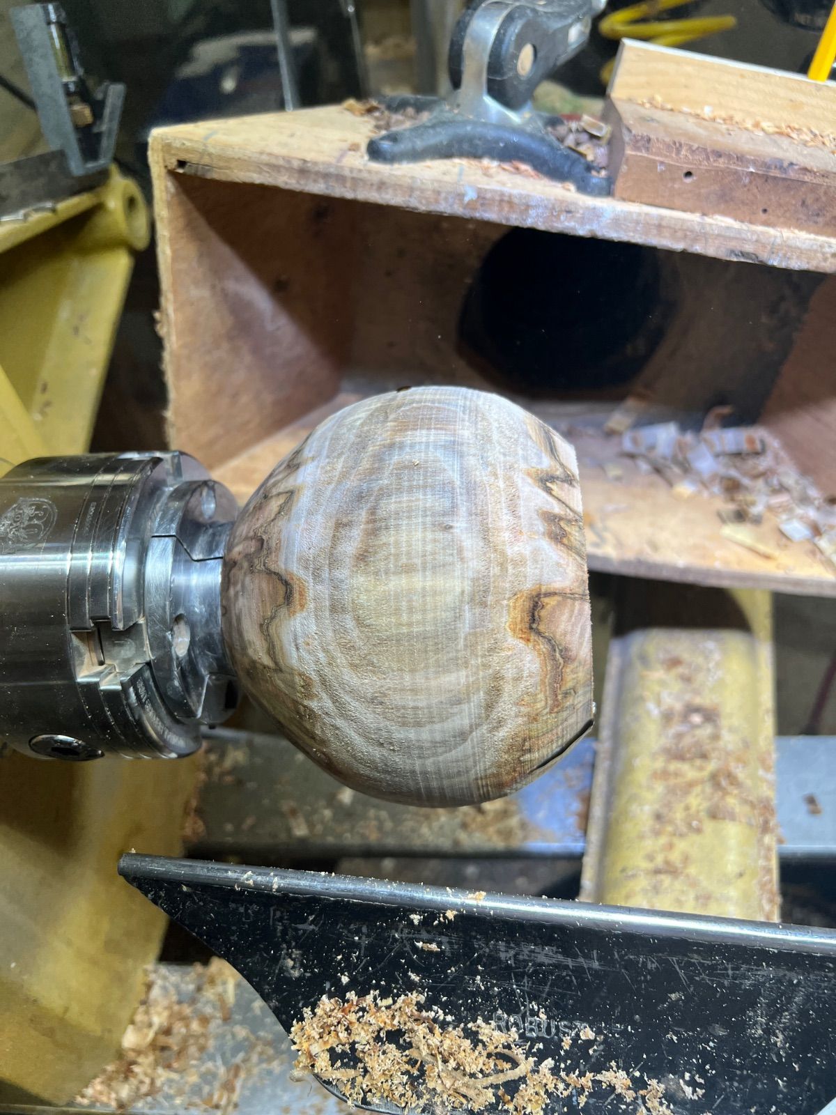

barely had time to do another Sweetgum hollow form.
yes I am loving this log.
