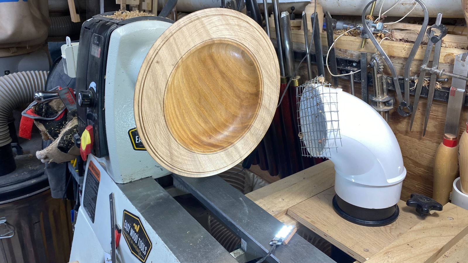

  • White oak platter just about done. Waiting for the final coat of wipe on poly to dry then needs name and date engraved. Second one with a dutchman. Unfinished bottom-   Turned and

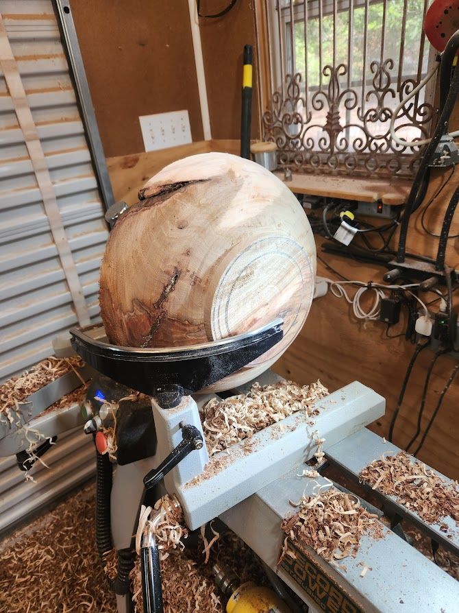

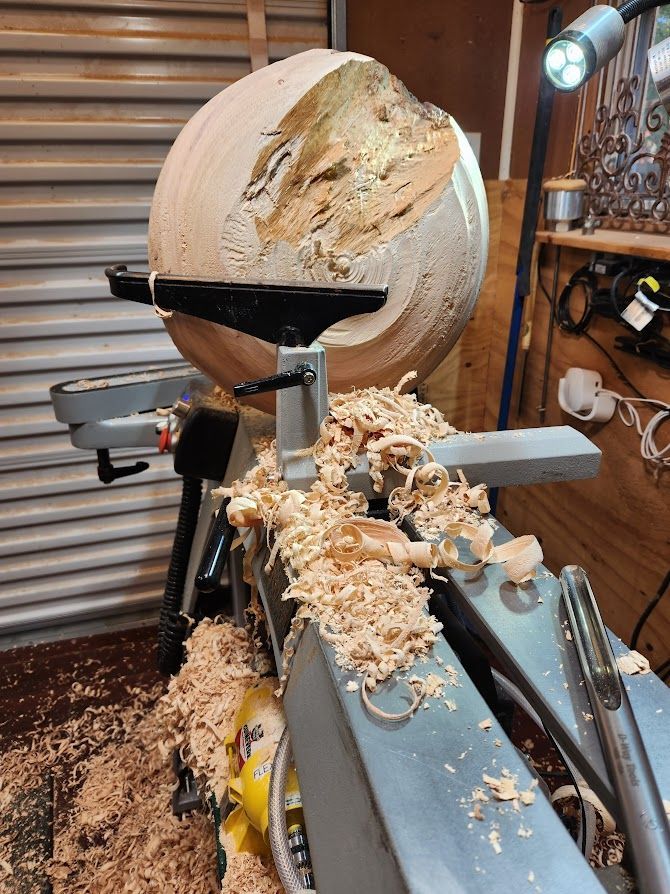

Hays county pecan crotch 14".  Spent some time with "Army of Angry Beavers" a.k.a (D-way 3/4" irish grind gouge) this morning and roughed out a large pecan blank that needed quite a bit of material removed due to the wavy exterior of the tree.  I'm convinced that if I had no limitation on available torque I could take an 1" off the diameter in a single pass with this tool.
Fantastic fiddle-back grain running through the bottom.  Chatoyance is noticeable in this area.
Into the kiln at 45% moisture content.

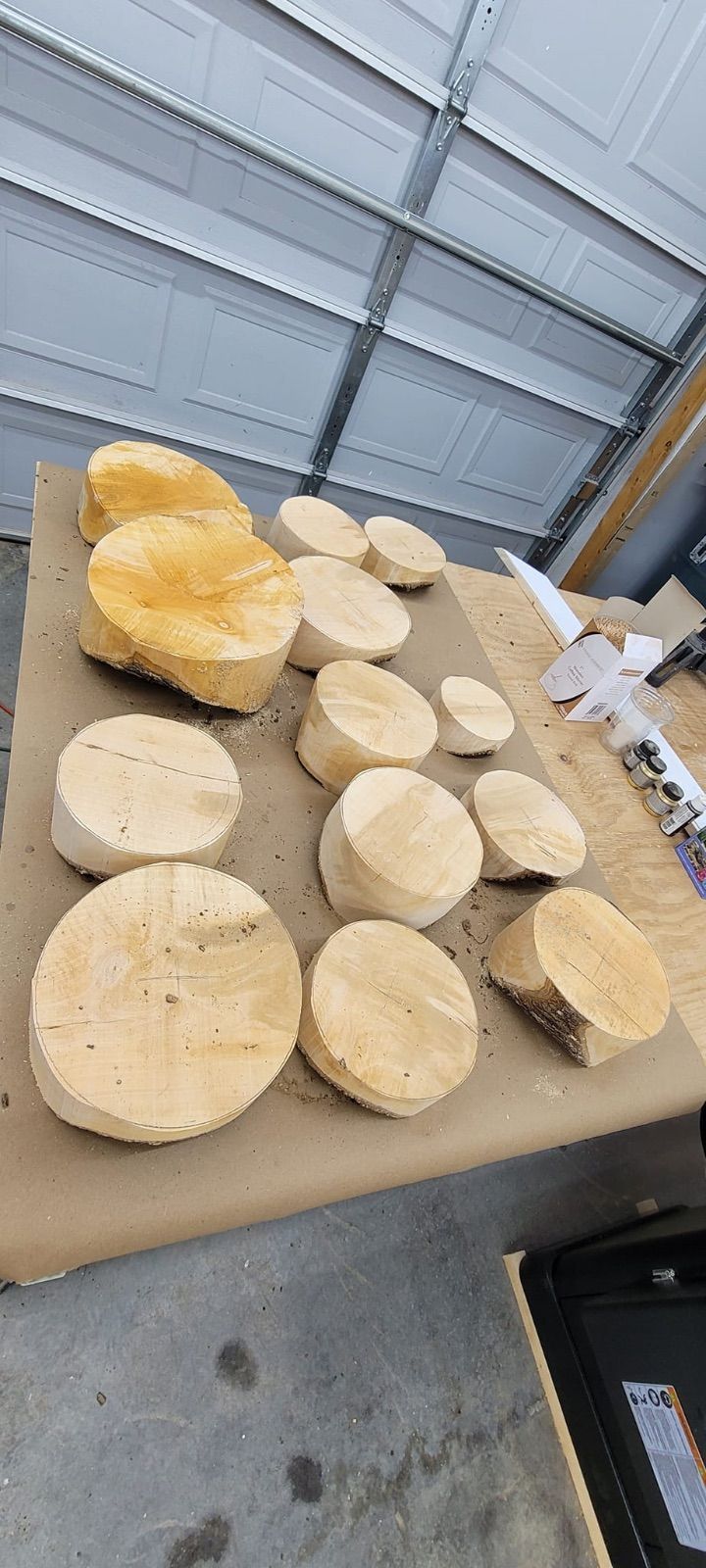

Not on the lathe yet but it won’t be long. Got some Bradford pear yesterday and processed it today. I will start rough turning in a couple of days. Have a few crotch pieces in there.
You're gonna be busy!

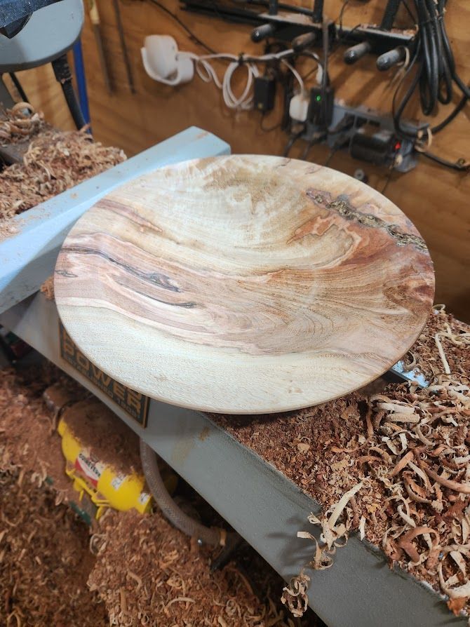

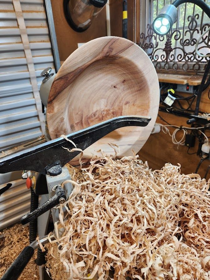

Working on a platter to eventually get engraved. Engraving looked good on the test piece but awful on the platter. Back on the lathe for sanding and try again.

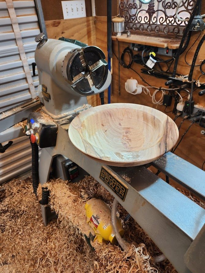

1st time out in the shop since recovering from Covid.   Worked with a difficult chunk of pecan.  Riddled with bark inclusions and post beetle holes, I ended up turning away more than I wanted to.  The big chunk in the top photo ended up flying off the lathe and would have hit me if I wasn't standing to the side.
I moved it to the kiln to dry but give this one 1 chance in 5 of making it to the finish process.  I would be a shame to waste such pretty grain but it is what it is.

I've had some pretty gnarly ones survive by soaking them in the soap/water solution before going to the drying box. Once in the box, checking regularly for cracks and using CA before they get too far along.

It amazes me that that inclusion on the side did not come off when turning. I like to epoxy (with color added) those on pecan.

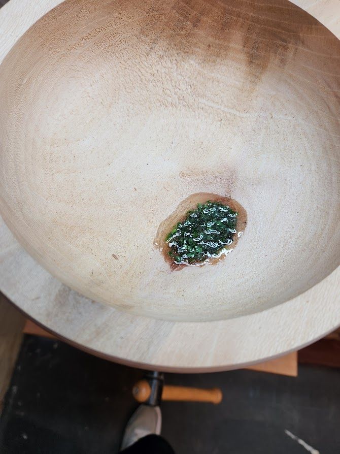

Started 2nd turning pecan bowl.  Experimental knot repair using epoxy and diopside.  Hopefully these small crystals won't pose too much of a problem to cut.
.40
.40
They sure are pretty!

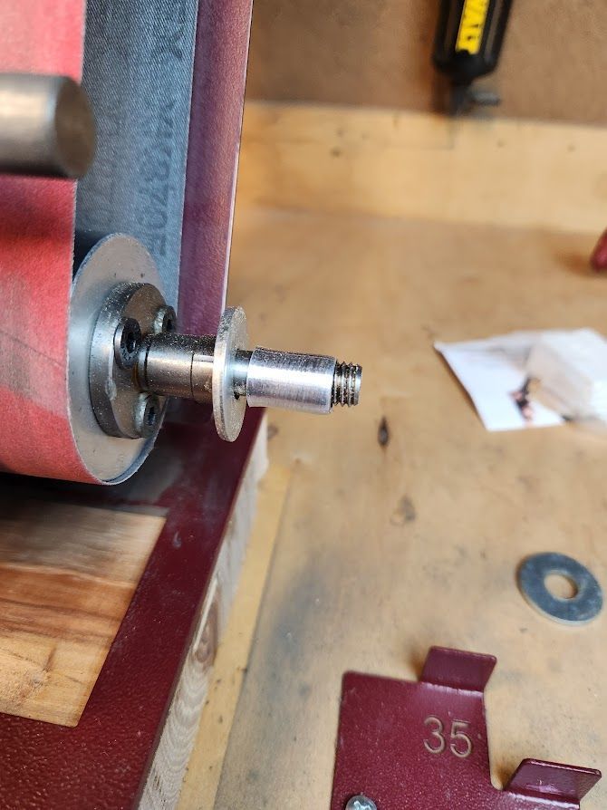

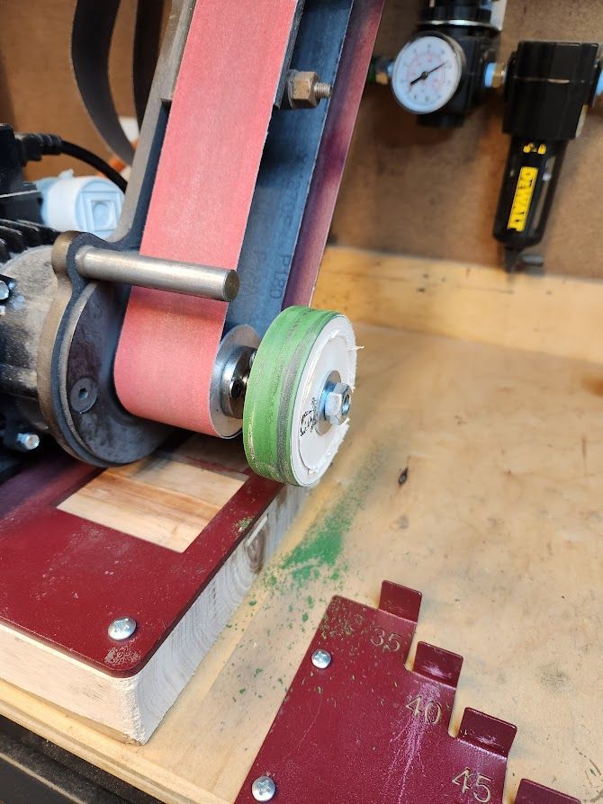

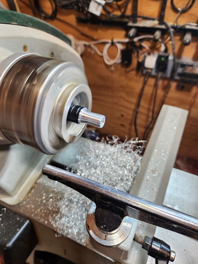

Here is one for the "You probably can but should you" file.  I needed a bushing to mount a leather wheel on the Sorby Pro-Edge.  7/16 ID 1/2 OD x 3/4 long.
Turned from an aluminium spacer that I had on hand.  Used #3 Hunter carbide in sheer scrape orientation at 1700rpm to do the turning.  Chuck in tailstock with drill to form the ID.
Works like a champ.  The green stuff is an abrasive dressing on the leather wheel.  Takes the edge from scary sharp to don't look at it wrong.
.40
Hey, if it works!!

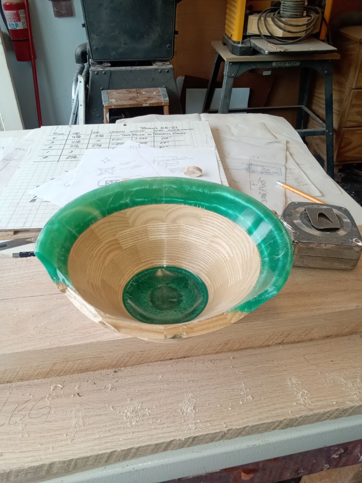

Working on this some today white ash and resin bowl with the pour form partly cut away.
Resin Is Aluminite clear slow with green mica powder
calabrese55
Love it!!

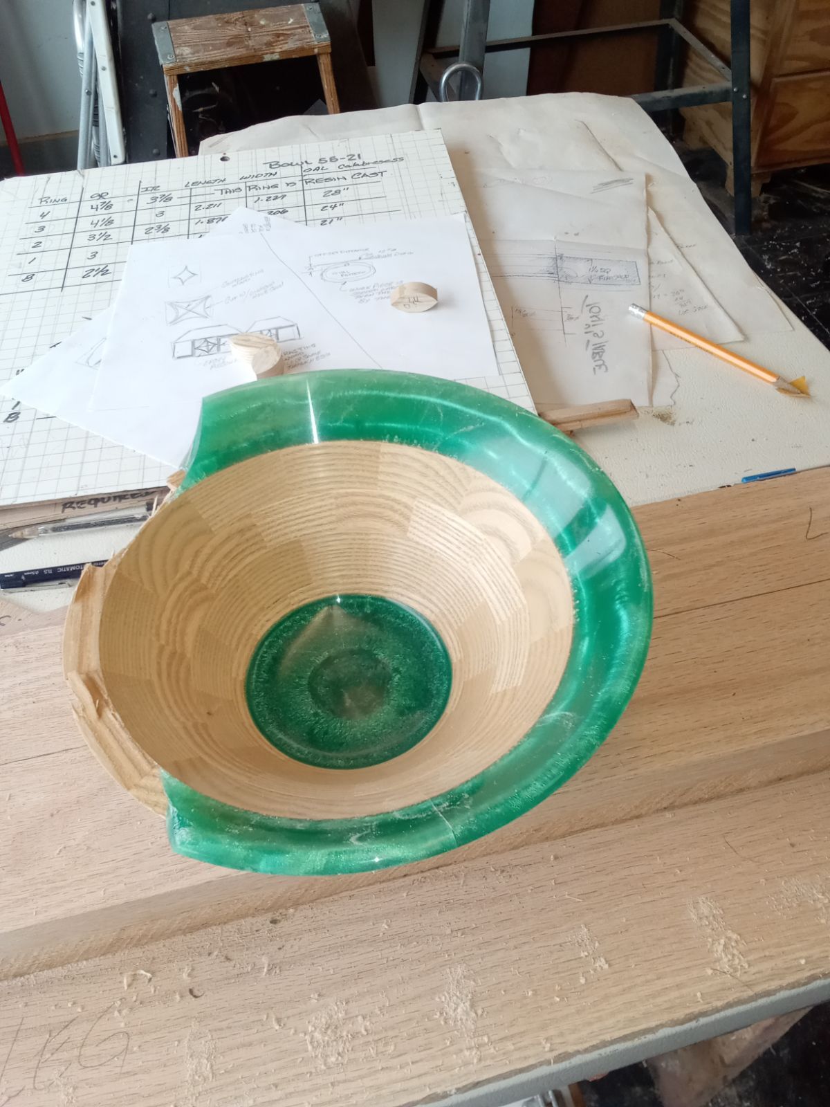

Sometimes you get the test before you get the lesson. This was one of those times .

 While finishing the bottom of the bowl it was just a simple catch in the resin and image.png.8c161cd1169ec2aa39eb88774ccfe76a.png
