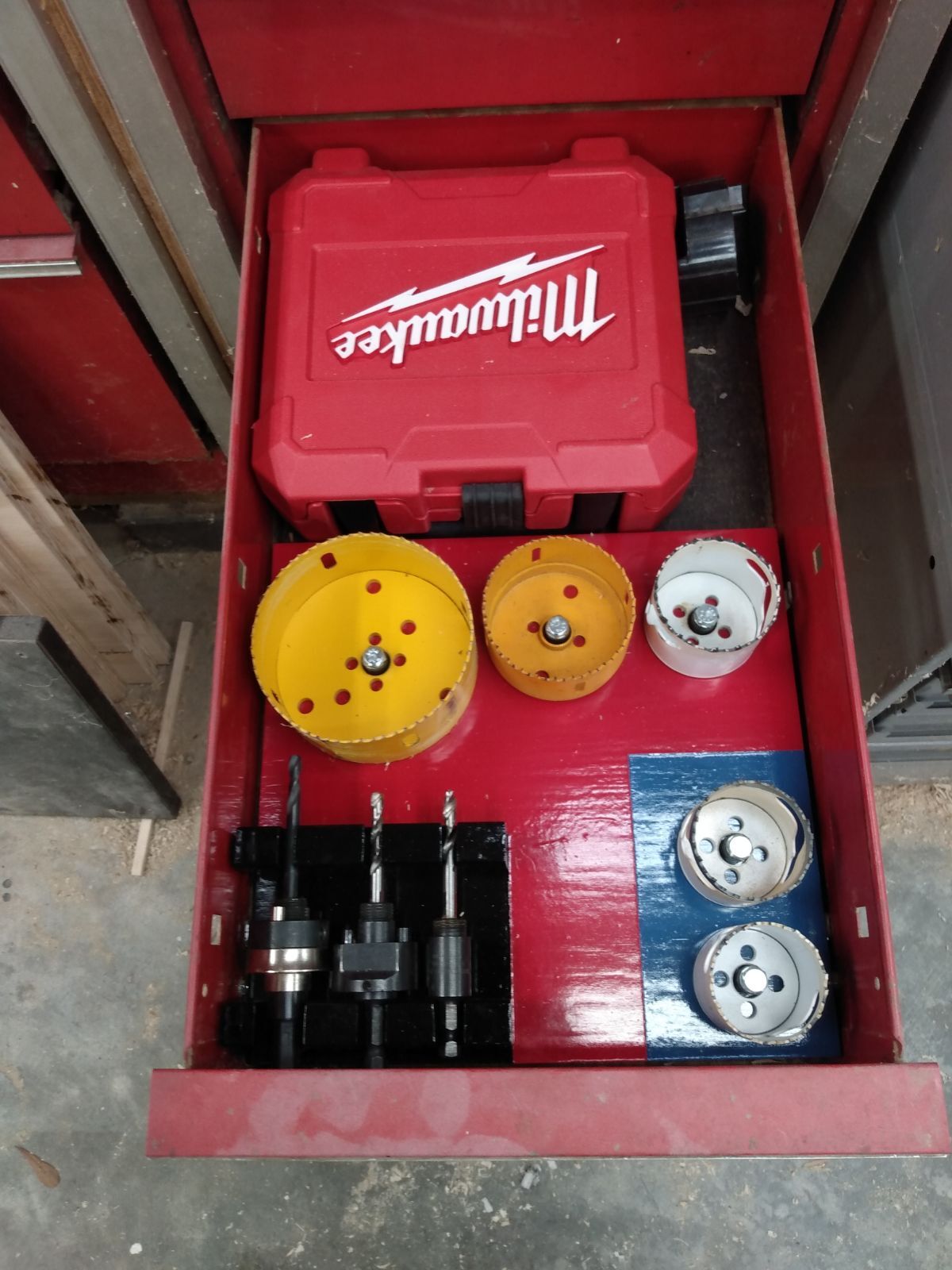

I have drawers like this recent addition

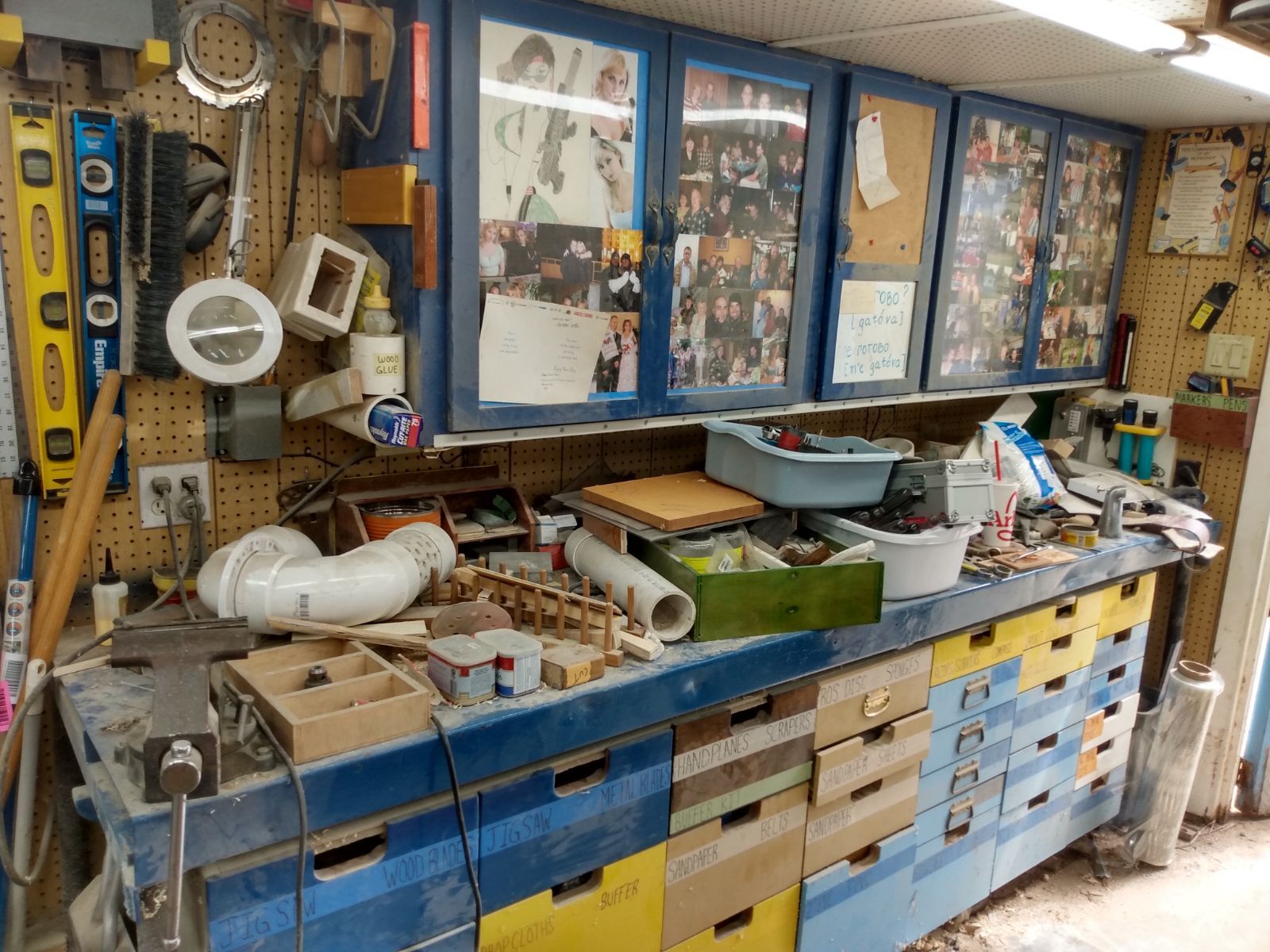

But my bench???🤔
Now THAT's a fine looking work bench! :TwoThumbsUp:

Now to build more drawers to put all that into. OR is it as matter of putting all that into the drawers it belongs in:rolleyes:

I could never work on a bench that clean & organized. Far too tidy for me.:P

All the above.  :throbbinghead:

But it is situated for Restoring An Old Fiddle, conforming perfectly to Step No. 1: Have a dedicated work area which will remain undisturbed for weeks on end. :cowboy:

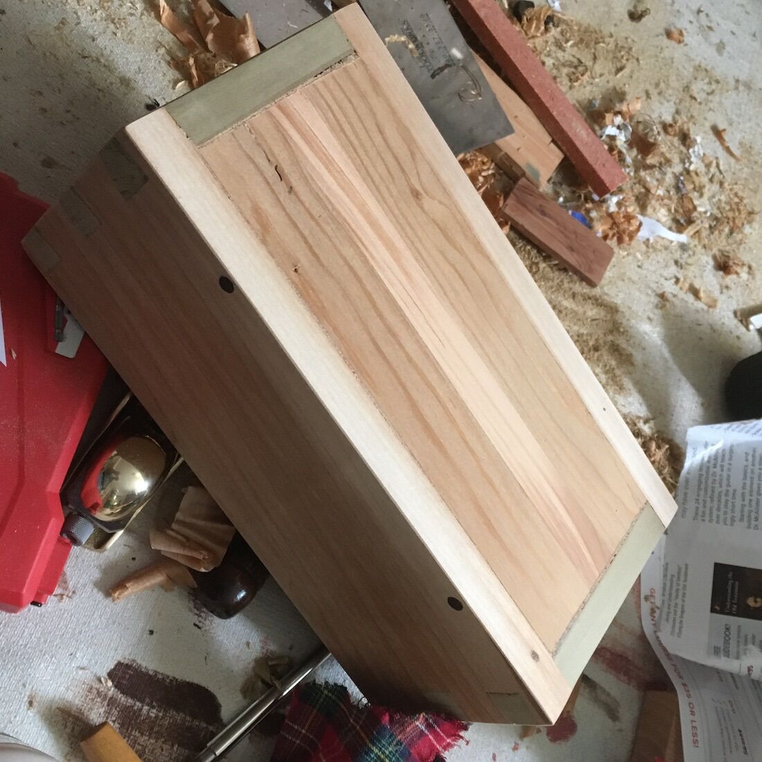

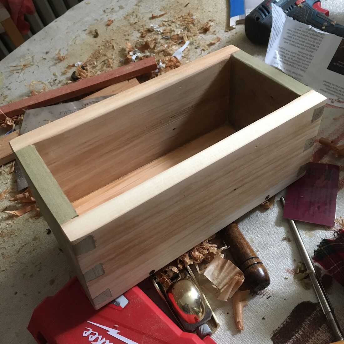

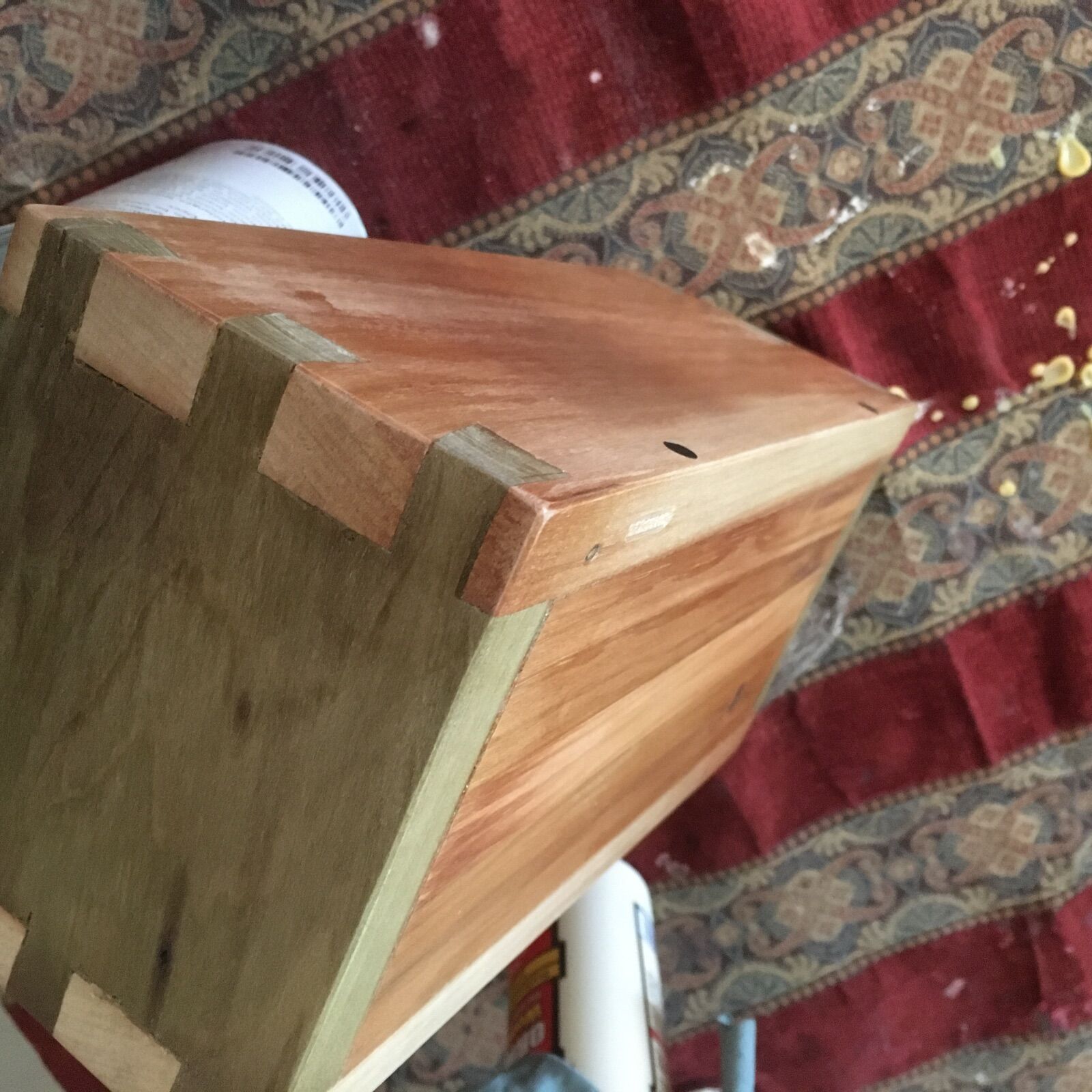

Done D. O. N. E.  Lassa mistakes. Blood. Repeatedly downsized as mistakes forced redesign. :cowboy:  The bottom was supposed to be tight as Mayan block stone walls but it turned out loose as an 1880s saloon door.
Went to the dark side and used the 'lectric sander :o but why not! Wow, that old poplar sure sands up slick. To 320, it's mirror smooth. Will wait a few days, the wood should darken a little as air hits it. Then my go-to, diluted spirit varnish. Violin varnish, to go with the four violin pegs I sunk through the sides into the base. :D

Pretty nice box. The Mayans would be proud. The Incas?...well you know them guys. They never put peaks on their pyramids.

Can't find the workbench I know it's in there somewhere. :blink:
Excellent Jim. Love the contrast which will make those dovetails real eye candy.
Now for the lid???

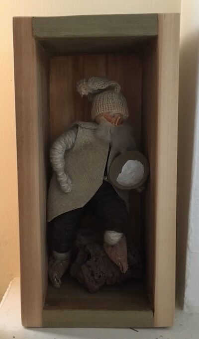

Thanks, Doc! No lid, you can cram more in w/o one. For now, it holds this doll a friend bought in Iceland 35-some years ago.
I'm fairly sure the side woods are poplar; carcass wood within the curb-find. Interesting how one piece remained so green but became very light in weight / density. I've not before handled such dry poplar.

Heartwood versus sapwood perhaps?
Leave the green in the sun light and it will turn a rich dark brown.  Dark as walnut.

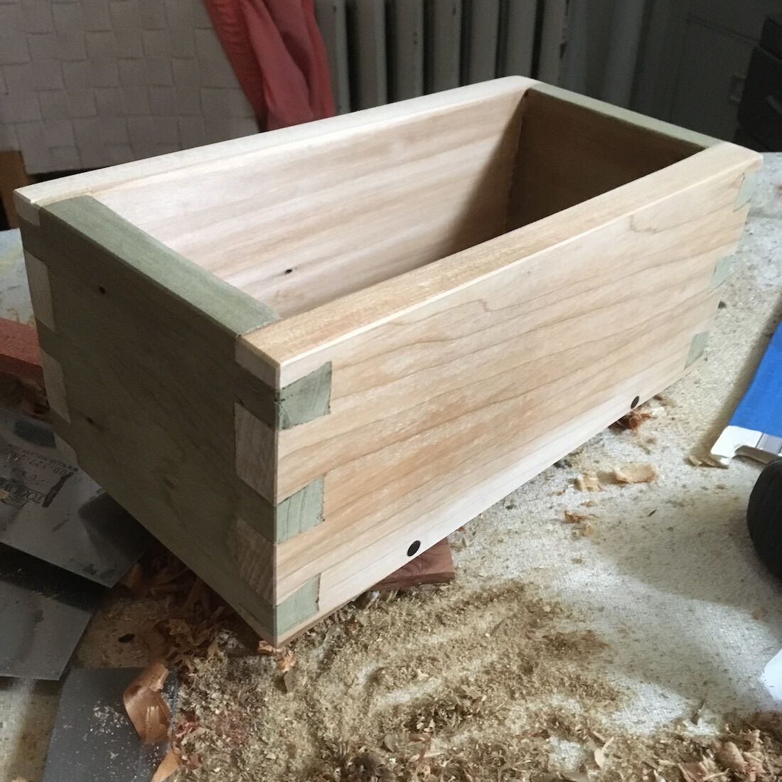

After fooling with the poorly-fitting base - filler and such - I sanded again to 320. Then in quick succession hit it with several light coats of diluted spirit varnish. Today it was hand-sanded w/ 400 thru 2,000 (I get my paper from a jewelers supply) and I'm calling it done. Lossa lessons learned.   #1: MARK the no-go areas. :PullingHair:  #2: take it EASY with the tenon saw! Too deep is TOO DEEP! :cowboy:

Looks mighty nice to me!
