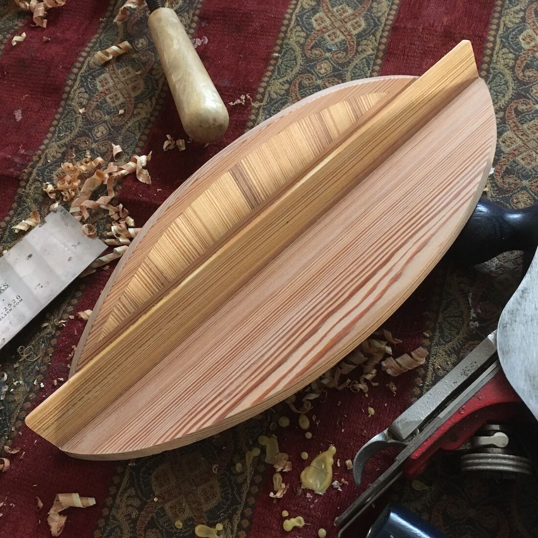

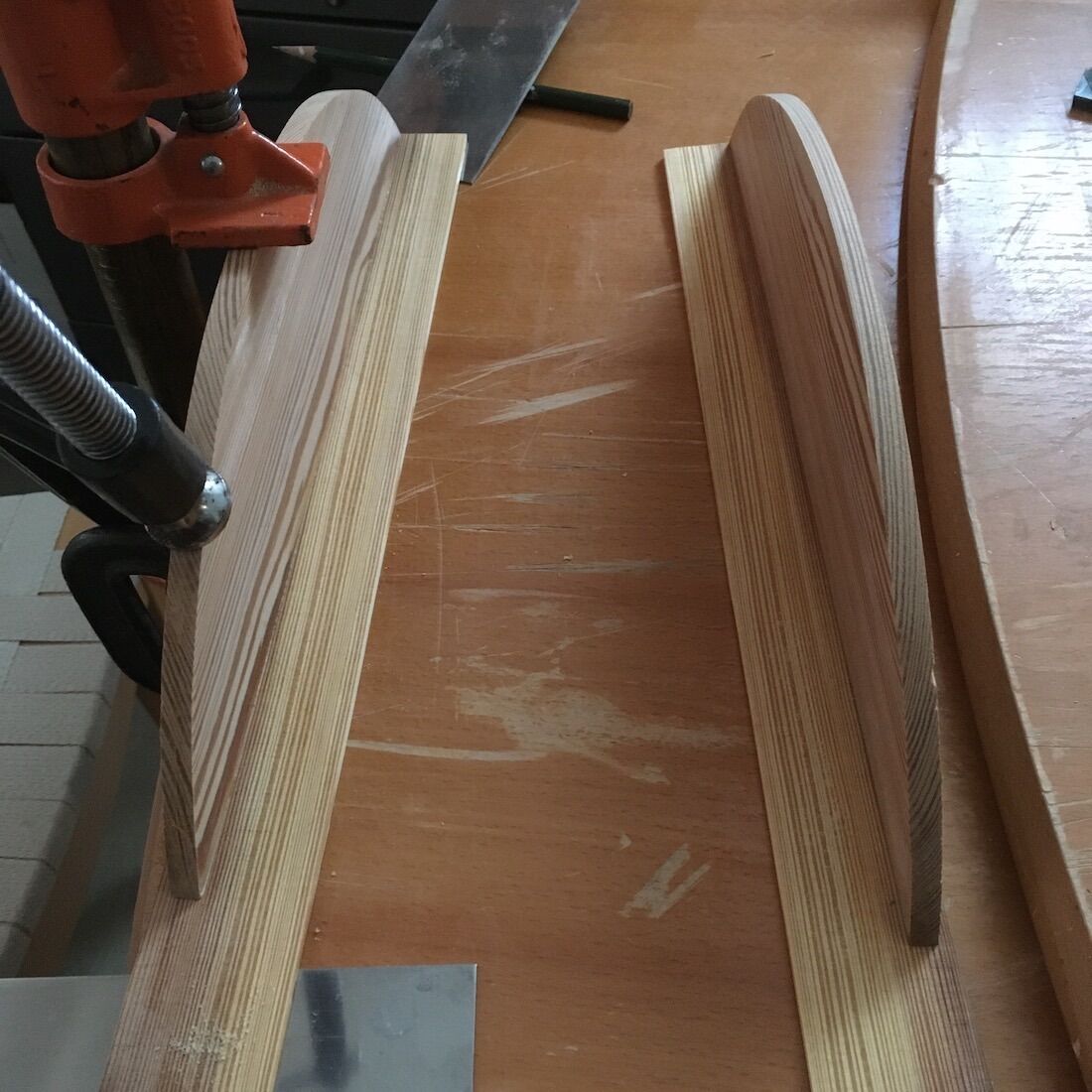

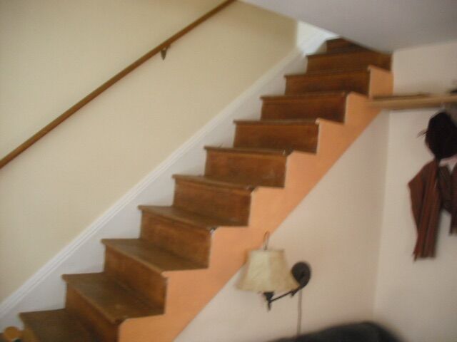

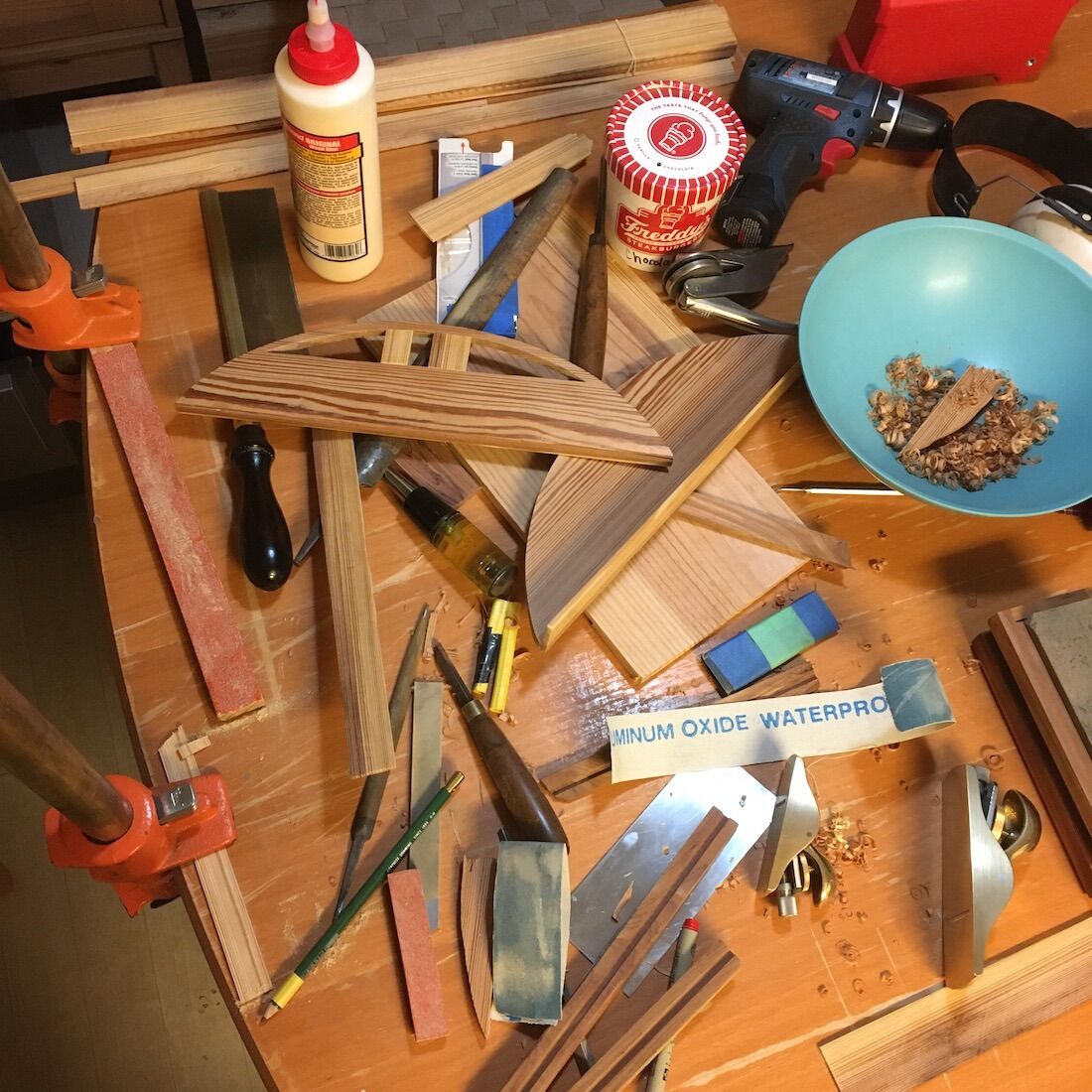

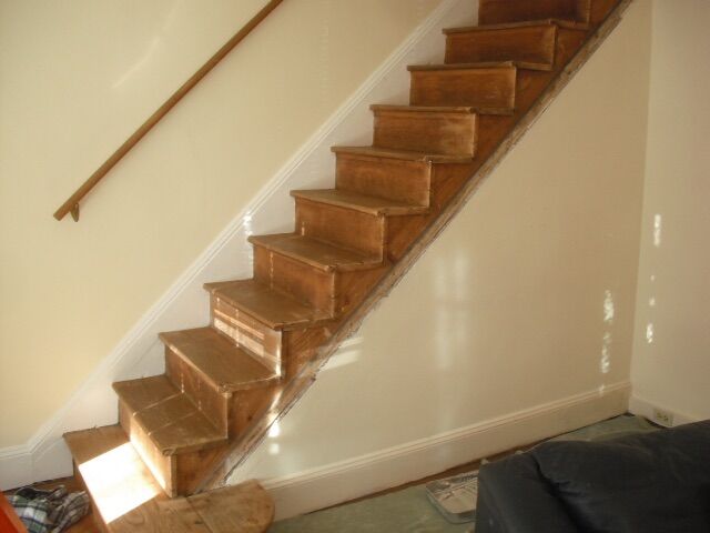

Last week I gave the Makita jigsaw a try after a decade off. It was bought only to replace this stair trim (skirting?).
363876412_steptrim1.JPG.54ba9c13f0a14ded13021a0d8b4d0fc7.JPG 1544548715_steptrim2.JPG.7f7571258b5103cdcc499d6e7b4994fb.JPG 2034334813_steptrim3.JPG.49dca3a36f7d34b0f6e2ab90ab991e3a.JPG

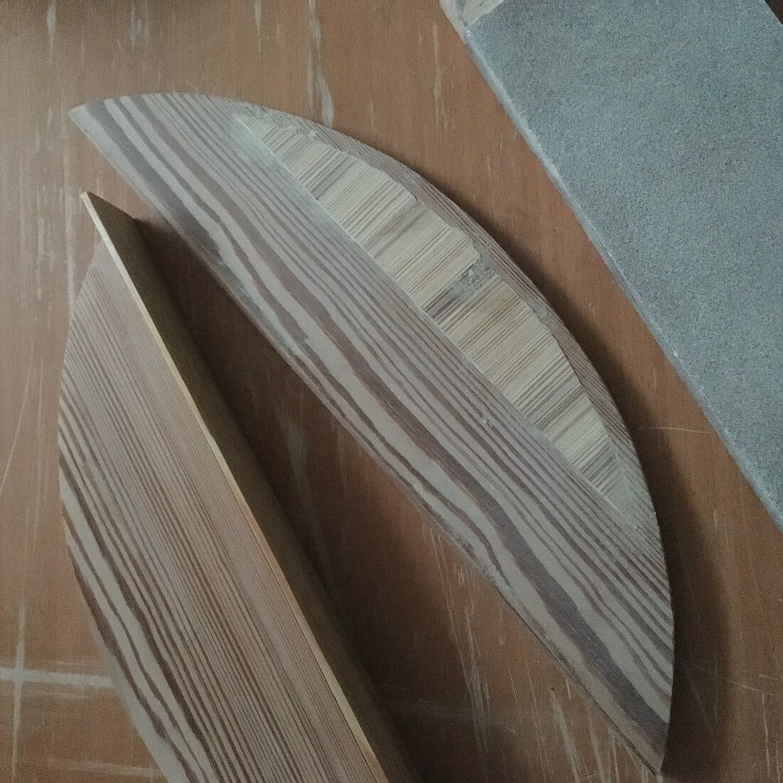

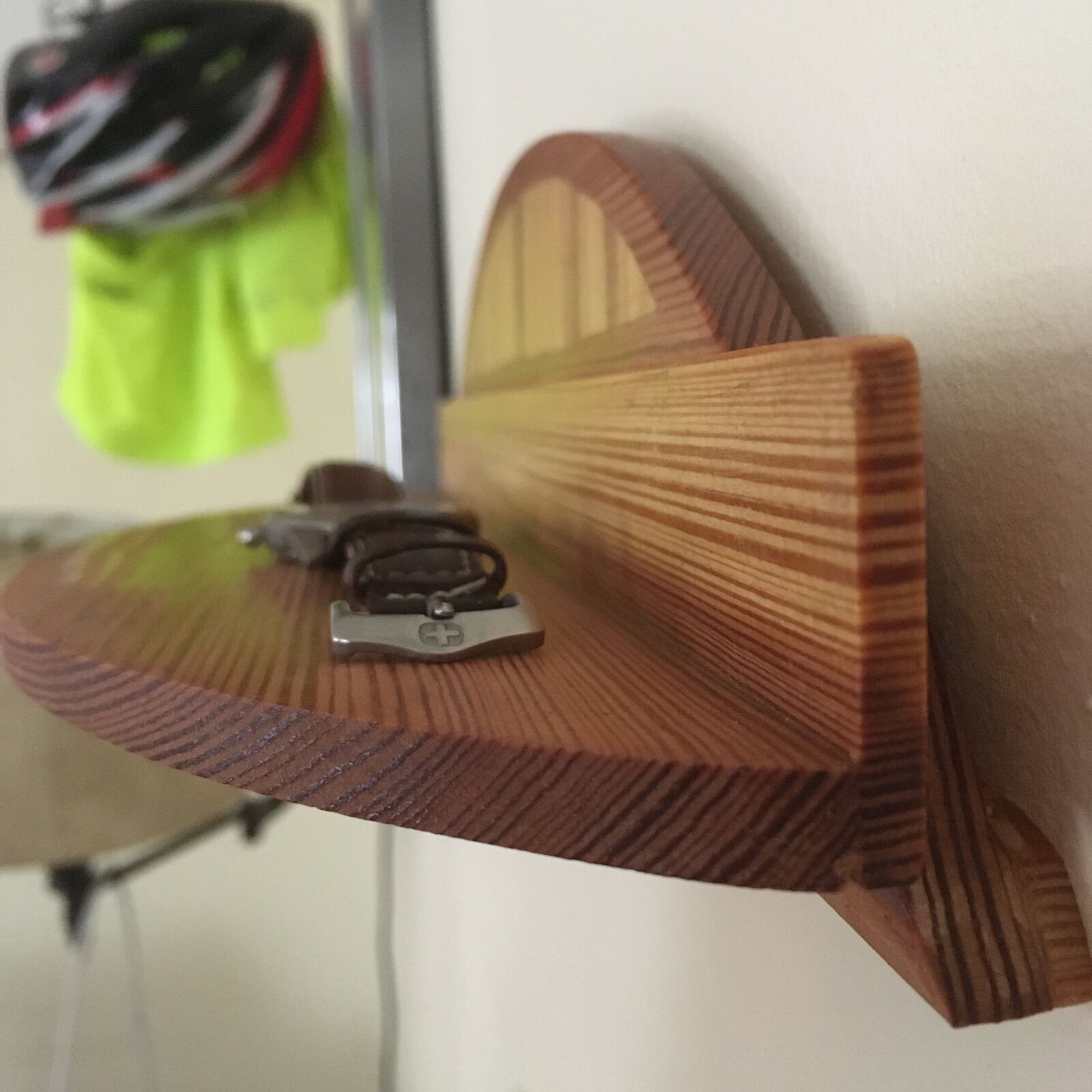

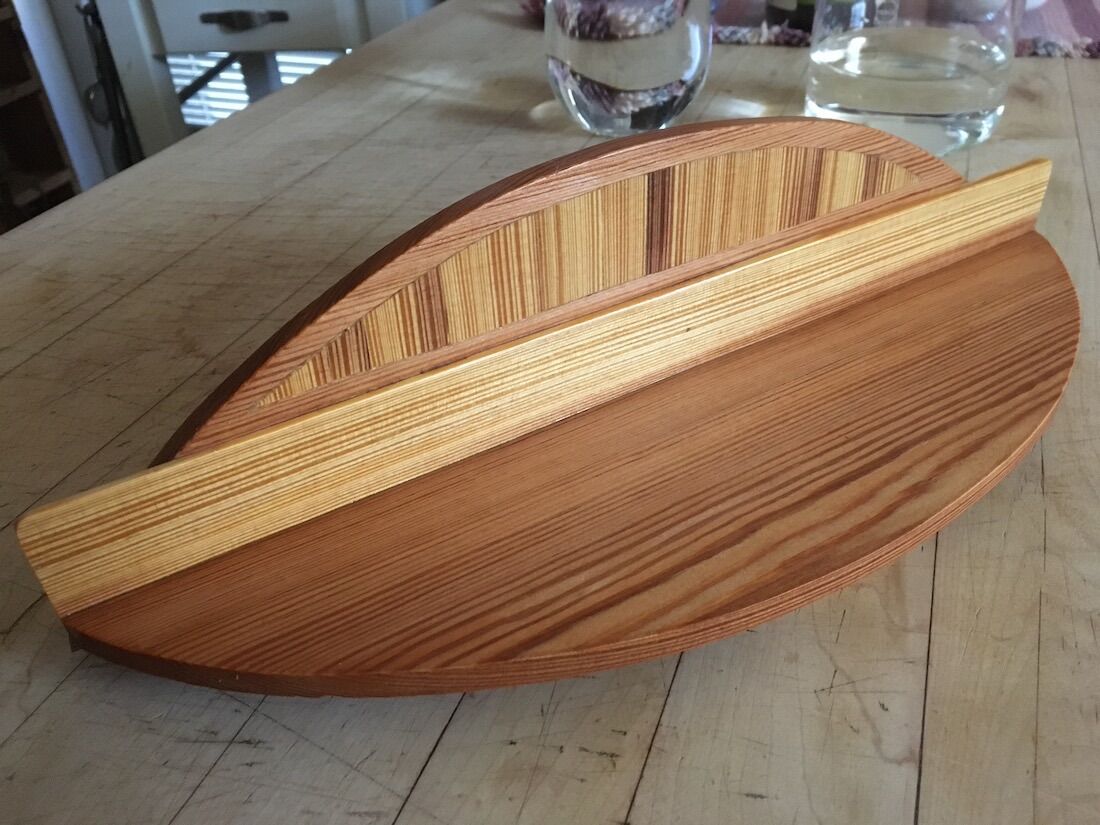

So first I cut these two ovals, attached a backing, and got stuck. One backing cleanly cracked along the grain. Next, taking a cue from @Smallpatch I try out the scroll saw. First job removing and fishing the 5" t-connector blade on this gifted amateur unit. I'll need new blades, but at a slower speed it ain't half bad. But the half that is bad made an uneven cut.
I'll save time next time by making a better cut, but for now, the inside oval was contoured and filled. The final assembly is a little asymmetrical. The big question:
Do I mount as intended, oval up? Or add key rings under, and mount oval down?  Maybe trim the “wings” off of it. Follow a cm above the backing arc.

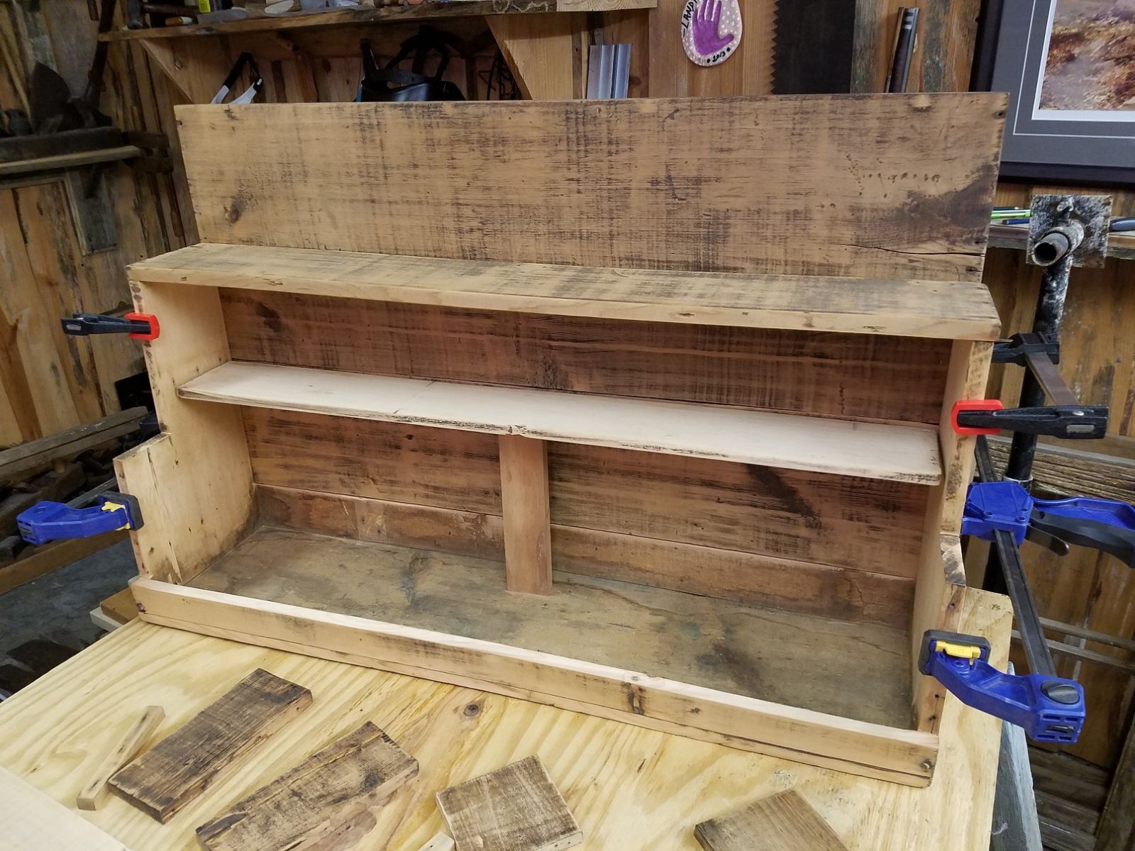

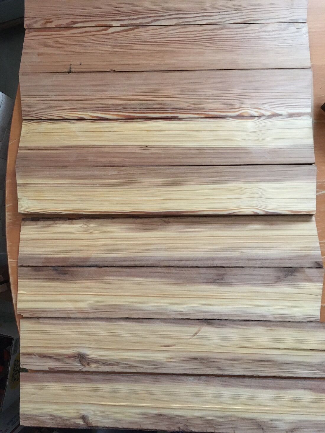

Got almost all the boards through 1 session of sanding today. Was working on the 2 that I plan to use for the back and I heard a voice :blink:.......it was Otis. He said " Easy young Lad..my old chest will come closer to giving you what your after if you don't erase all the age she's earned  :OldManSmiley:"     So..I stopped there and will finish those 2 by hand from here on out. Here's another look at her after some daylight hit it....
Listen to Otis:D. He's correct.
Glad to know others hear voices too. Gets me closer to normal:rolleyes:

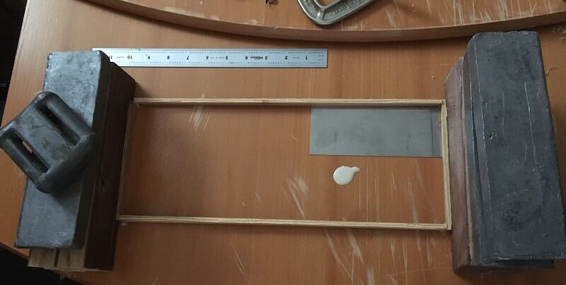

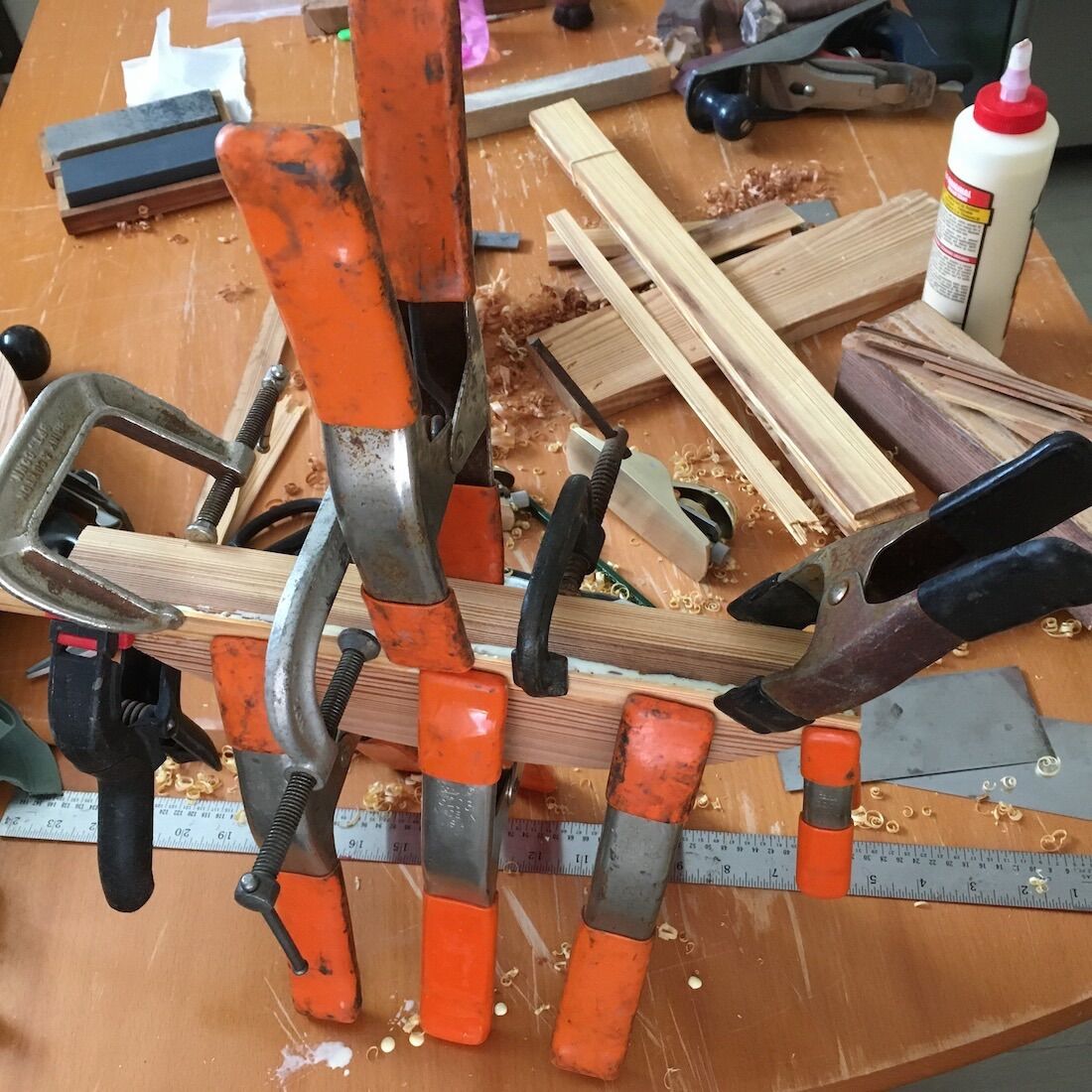

So, this morning I was trying to make a frame spacer - between glass and image - and cutting with my old 32tpi ZONA. Double crooked!
This novel clamping method involves two oak blocks each with 10+ pounds of lead attached. And I push the blocks together until just before the horizontals begin to bow. Although I could have clamped one block and piled up the lead on the other block for double the something-or-other.
1427811234_WoodmansSaturdaymorningcartoonshow..JPG.f413c06e8efda68121f3b87e86f8997b.JPG
