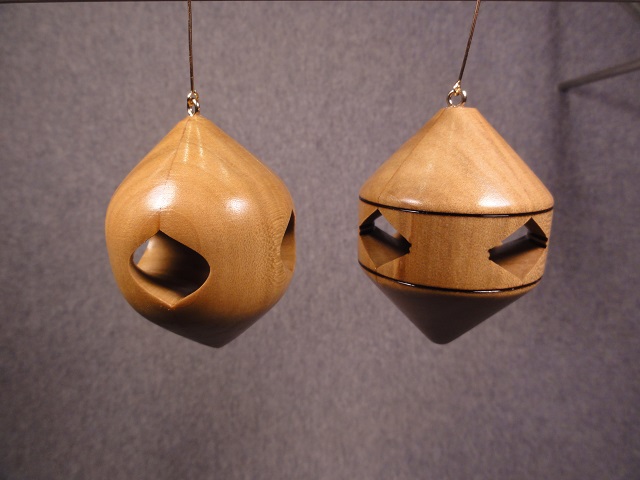

    More Inside Out
    These were all done with one inch square six inch long configurations. Anything that fits through the window can be hung inside for added effect. Some beads are hung in this one. Two smaller ornaments made from one glue up.

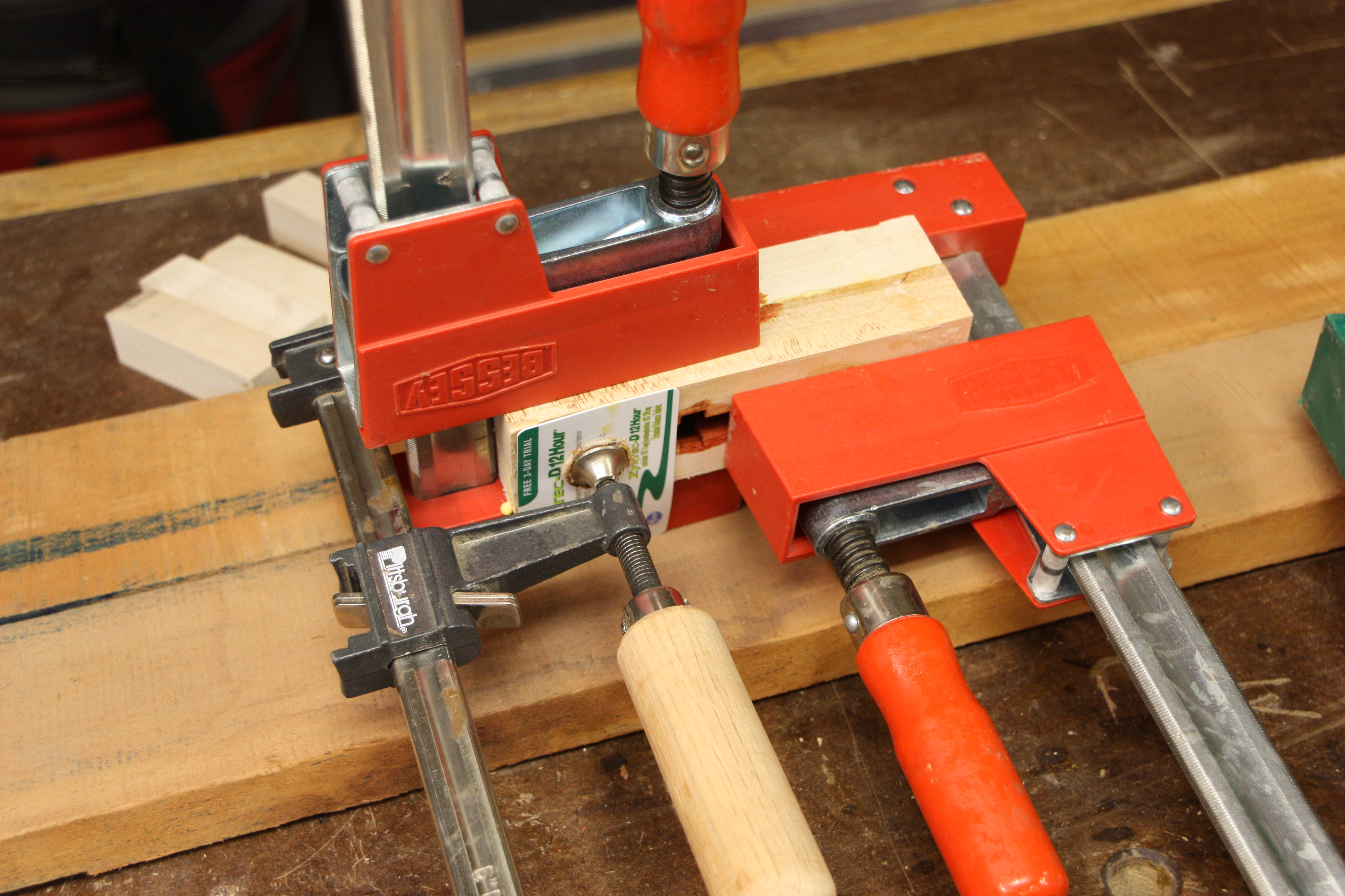

    Lots of Glue and Clamps
    Decided to go ahead and make inside out ornaments for Christmas this year. Much more glue and clamp time than I envisioned not to mention running all the pieces through the saw to size them and make sure they are square. While running them through the saw I keep track of the grain match too. Turning them is the easy part and takes the least amount of time. I start out gluing two pairs together and when they are dry I glue the two halves together to get the square blank. Then they go on the lathe and turn the inside and put some shellac finish on with a rag while still on the lathe. Then I break them apart, turn them inside out and glue two pairs together and when they are dry glue the two halves together keeping track of the numbered pieces to keep the grain oriented. I glued 36 blanks up, here are some of them. I am now working at turning the final shape and will have to put the finish on once they are turned. Whew! I make 60 to give away each year so I still have another batch of 24 to do after these.

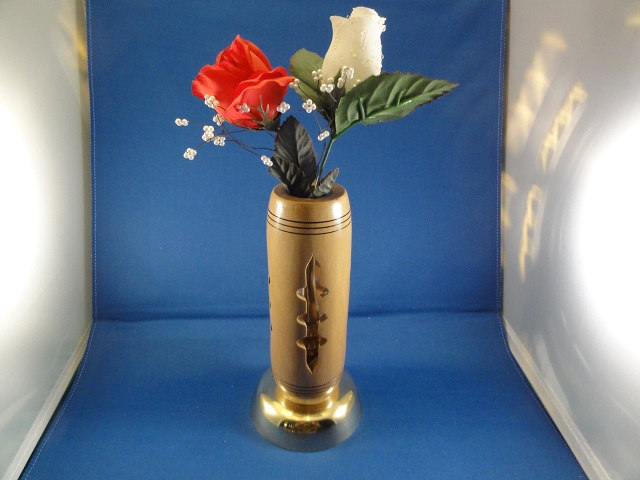

    Another Vase
    Here is another inside out turned vase. I used some brass components found at the thrift store and polished on the lathe. It is about eight inches overall and the wood is Poplar. Used a different window design but think a wider window would show the brass insert better. I got a small photo booth in the tools I bought at auction but is was a bit too small for this vase. Took this picture with the set up I have had for a while.
