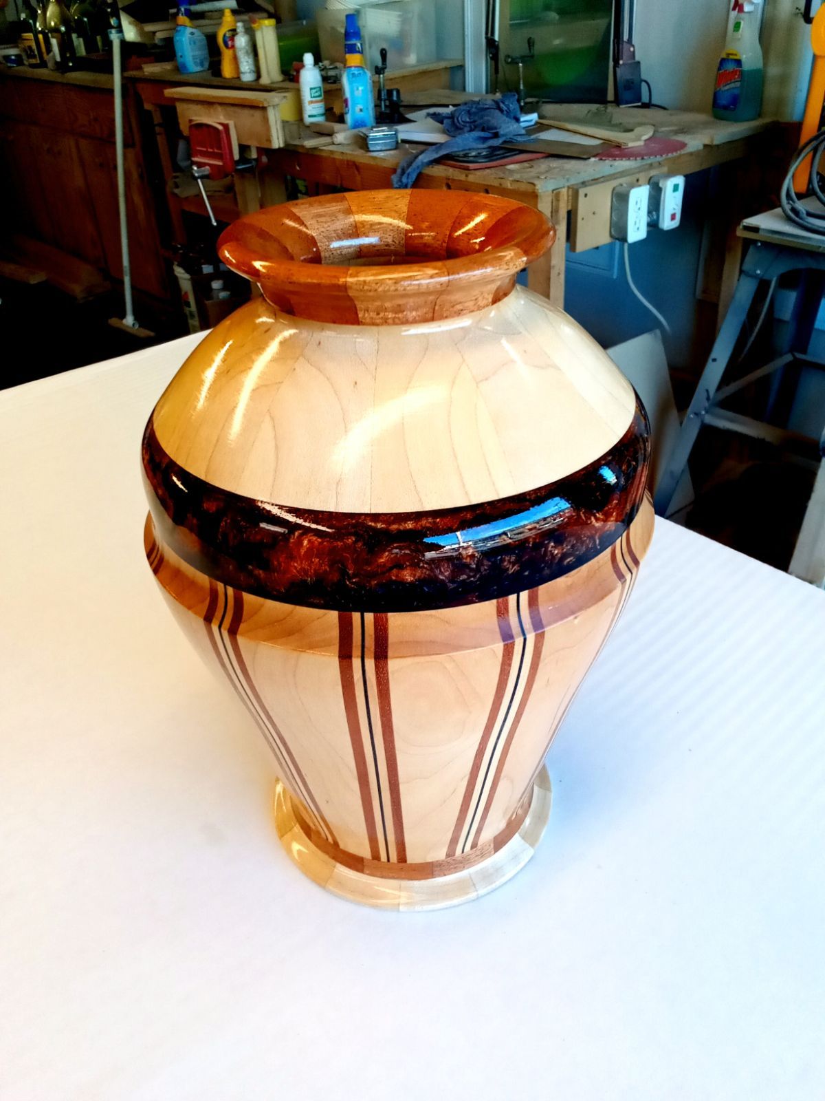

After taking some time away for those things that take you away from what you want to do for the things you have to do I finally got back to this vase last week.  Managed to finish it today finally. Construction is Maple, Sapele , black veneer with Aluminite resin feature ring. Finish is five coats of Minwax wipe on poly. Approximate 7 inches wide x 9 1/2 inches tall. I am kind of hooked on this stave turning thing :rolleyes:

That is gorgeous Mike @calabrese55. Good to have you back. Hope all is well.
Beautiful Mike.  Looks flawless.
mike calabrese55
I think this is your best one yet! Love the feature ring!!
Thanks Lew for looking in.  I feel like I am getting there a little bit. The stave elements are are the most challenging parts. I can get them pretty close off the table saw but need to dial them in with some flat plate sanding. After that it gets a bunch easier . The steady rest has improved my luck a bunch really saves those nasty catches I seem to get if there is some chatter while turning. The resin is Alumilite clear slow with a couple colors of mica powder, it turns nice as long as I can remember to use a soft touch . Catches there can be real attention getters and tough on the underwear :BugEyeSmiley:.
I know some of our turners will groan and roll their eyes- and say here it comes..
Have you considered a negative rake carbide cutter on the Alumilite? They really do work well to lessen chip out and catches on acrylic. Of course you know what brand to which I'm partial ;)
Yes I have negative rake carbides but my type A personality gets too impatient with the cut and I force it and ...well you know the rest.  I have some HHS gouges they are collecting dust, that is a mountain I gave up trying to climb. The mountain gets steeper the older I get and then there is that type A thing all over again......  BOOM goes the dynamite :PullingHair:

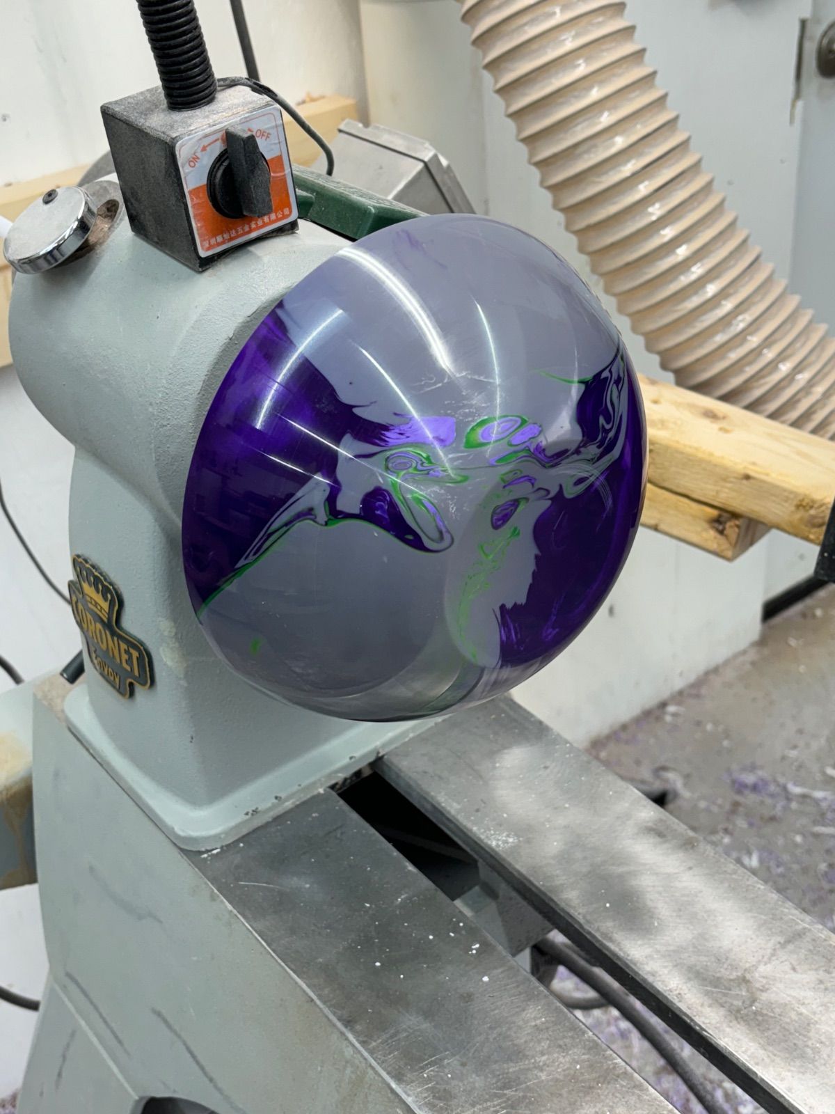

Bowling bowl.
Love the colors @RustyFN.
Love the idea of those bowls Rusty.  I'm not a fan of the mess they make when turning them.
I know what you mean. I have two more to turn then the mess will only be a one time cleanup.

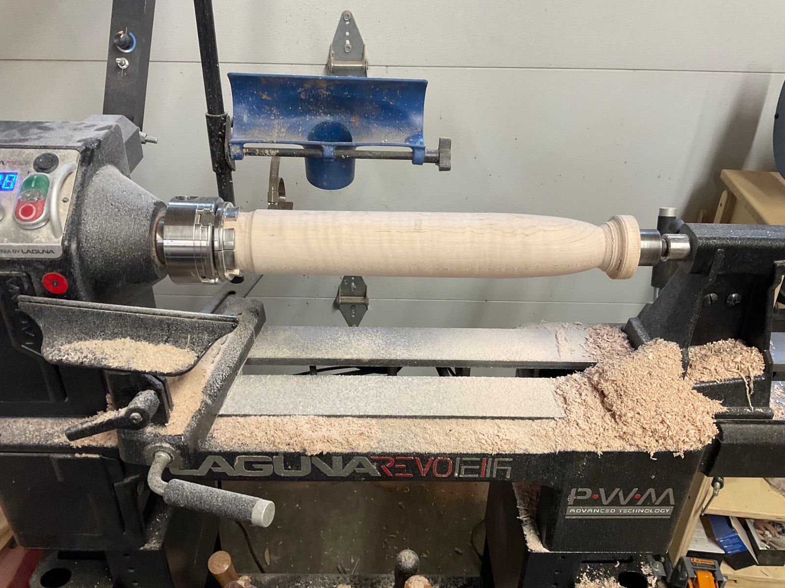

This is what is on my lathe.  I’m not doing the turning, it’s a friends son.  He is interested in woodworking and wood turning.  He has Harshbargers and ADHD.  He is a great kid. He just turned 16.  He also has a HUGE interest in NASA.  He wanted to turn a rocket.  You can see the beginning stages.  Once he got that far, I asked if he would like to turn that rocket into a space shuttle.  His eyes got very wide and yelled yes!  So that’s what we’re going to do.  I’m just showing him, and explaining to him how to approach the lathe, explained how to use the bevel of the tool, speed,of the lathe, etc.  it’s going to take some time because he can only come one day a week, or so.  But that is fine with me.  Never seen someone as a\happy as he is.
I had a student, at school, who suffered from the same afflictions. He would fixate on one specific topic and learn virtually every fact on it. He was almost always 100% accurate, too. Really nice kid. We got him a job fixing computer for a local library. They gave him his own area where he could work undisturbed. Haven't heard from him in a long while.
Good on you Paul for showing the interest and willingness to be a tutor.
I understand the fixation part.  I was standing and watching him turn, and if he came to a spot were there was a nick in the wood, he would stay at that mark to take it away.  I had him stop the lathe so I could explain to him why he shouldn’t do that.  He seemed to understand it.  He made that rocket (as it stands right now) pretty straight down the 14 inch long piece of maple.  That’s something I still struggle with.  I told him and I got a rare smile from him.  His mom later told me he was so excited about working with me in my shop and using the lathe.
