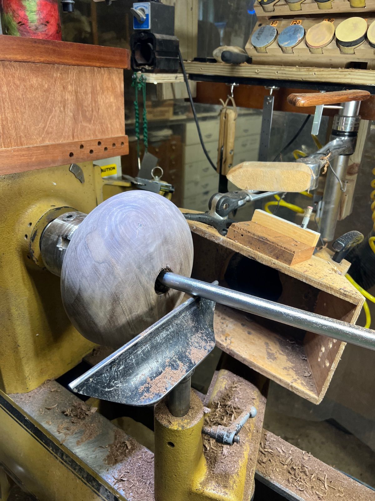

IMG_8838.jpeg.b132b8a7d1c3f4ff1f4f2547b9909387.jpegTrying to get done on this wood off my floor. Today working on an old walnut log a club member gave me. Doing a closed hollow form. Boy do the sanding scratches show on this one.
That looks like a real challenge.  I don't have the patience for hollowing.
Not that bad once you get tools to do the job. Now doing this without the jigs does get nerve racking.

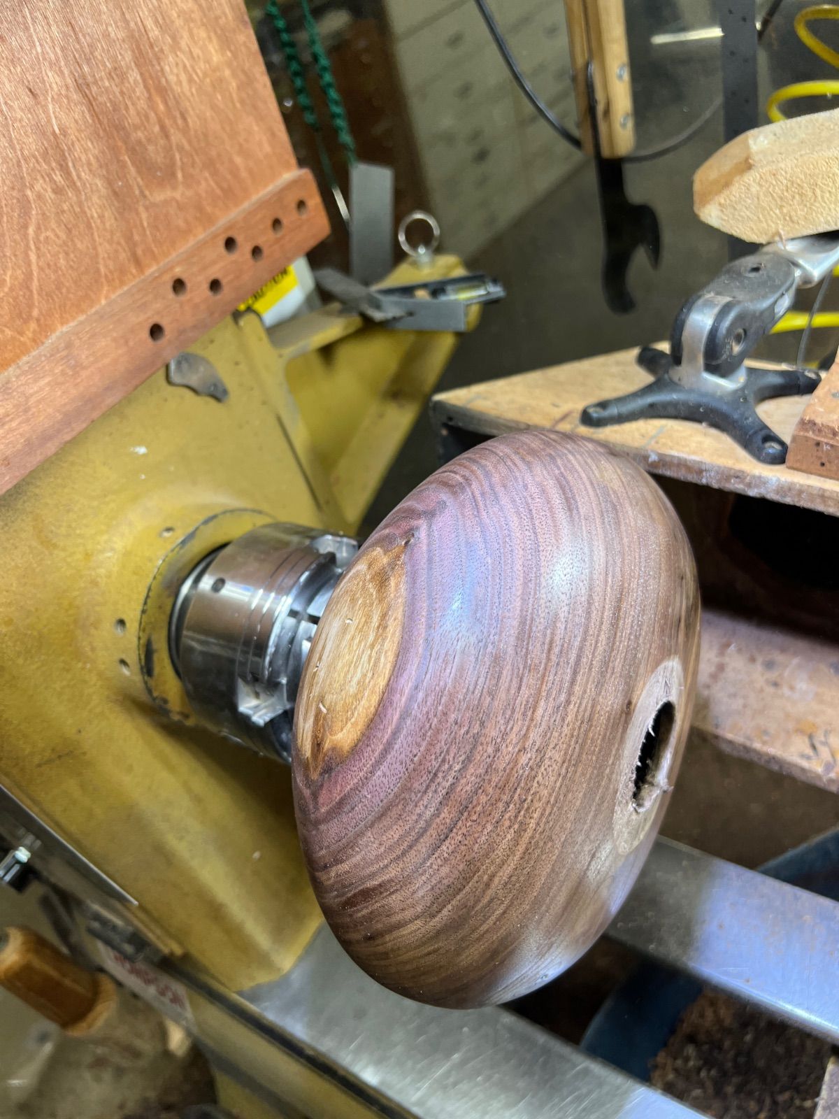

Put a coat of shellac on and that finishes the bowl on this project. Now to turn a collar , then done lacquer. IMG_8846.jpeg.ce18e74ea5416dfe8b21731901e4bbe9.jpeg

When you are doing a bowl like this one, especially like this one with a small opening.  How long can you work inside the bowl before having to stop and clean the shaving out?  It looks like it would multiply the time required by several times?

That's some beautiful wood, @Gerald

Not speaking for Gerald, but I'll give you my limited experience. I use compressed air. It's takes 4-5 seconds to blow out the shavings. Some forms may not be suitable to this methods (very small openings, for example).

It is a little more difficult to hollow when the shavings build up and usually I judge by that. On some woods it is worse and in this form when cutting the low part of this form the shavings accumulate by rotational force and you have to stop more frequently to clear the shavings with air. i do not have a specific time but it is not long just something you develop a feeling for . As a recommendation to a beginner maybe every minute for this form as a guide to clearing shavings. Yes this slows the job but a closed form like this takes much longer than a simple bowl when shavings just fall out.
This whole time thing is like when do I sharpen. Answer if you are fleeing resistance you probably need to sharpen and that works for clearing shavings also.

Excellent @Gerald:Praise: Beautiful grain and color.

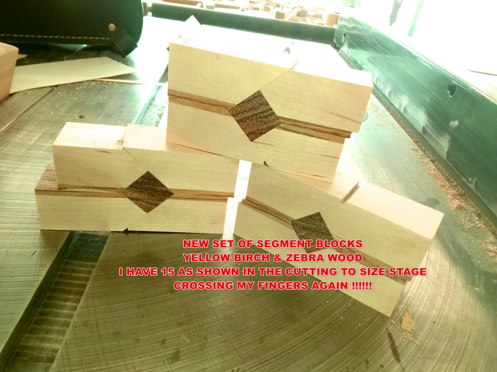

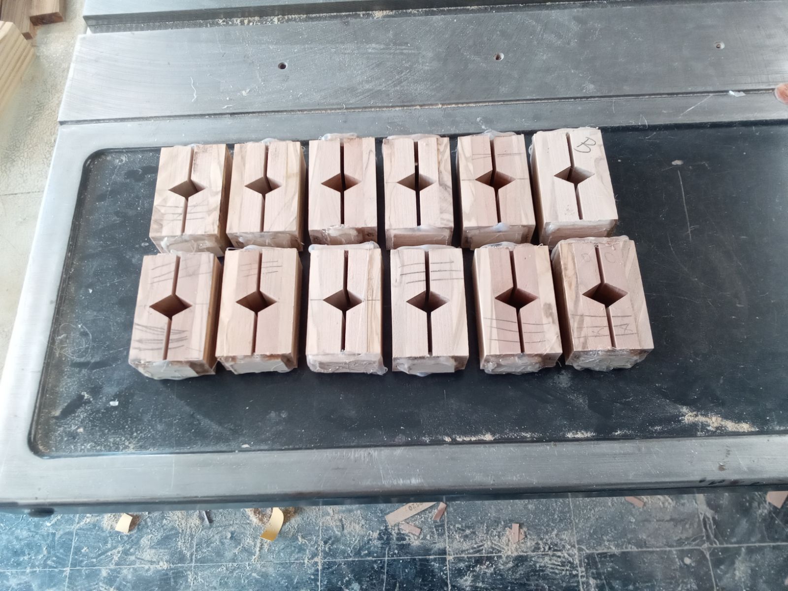

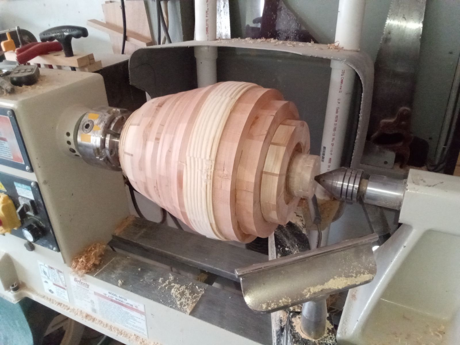

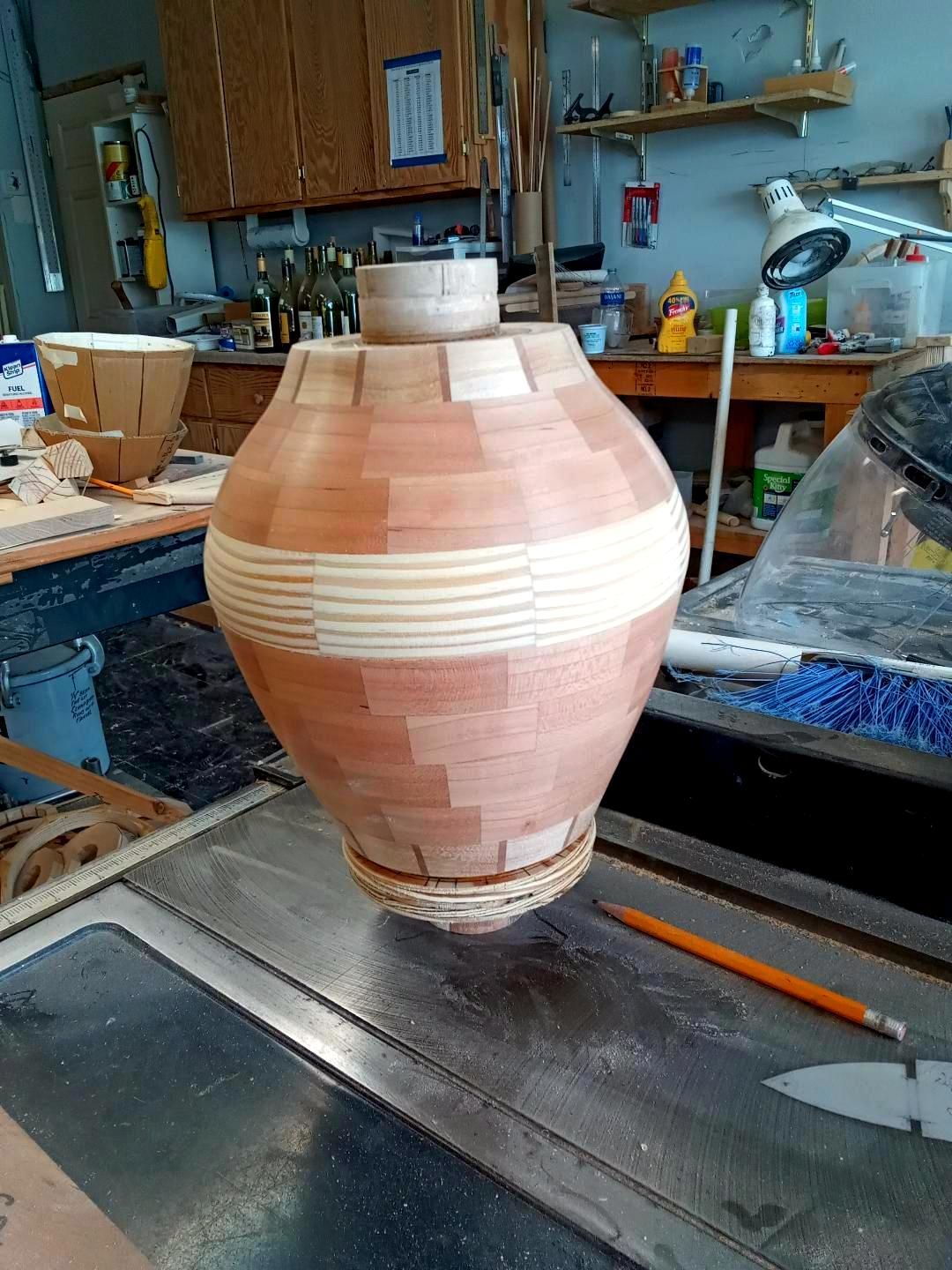

Well it is taking longer than i wanted. Made up a bunch of segments to be filled with black resin with gold resin veins, pics here are before resin was added. Unfortunately some idiot in my shop ( ME !!!!! ) managed to leave the valve on the pressure pot opened and  still hooked to the compressor. So when I shut down the compressor and blew it down it also blew down the pressure pot...BOOM GOES THE DINOMITE. Instant loss with was more bubbles in the resin than a Lawrence Welk Show . ( Anyone with no concept of black and white TV or rotary dial phones  will not get the Lawrence Welk relate).
Ok so we start over. I spent two weeks making another set of segments this time all are solid wood, I am out of resin at the moment. The pics here are yellow birch and zebra wood blanks soon to be the second shot of finishing this vase. Really want to get this vase to the finish line BUT I really need to slow down.
I HATE PAYING FOR THE SAME GROUND TWICE !!!!!!!!

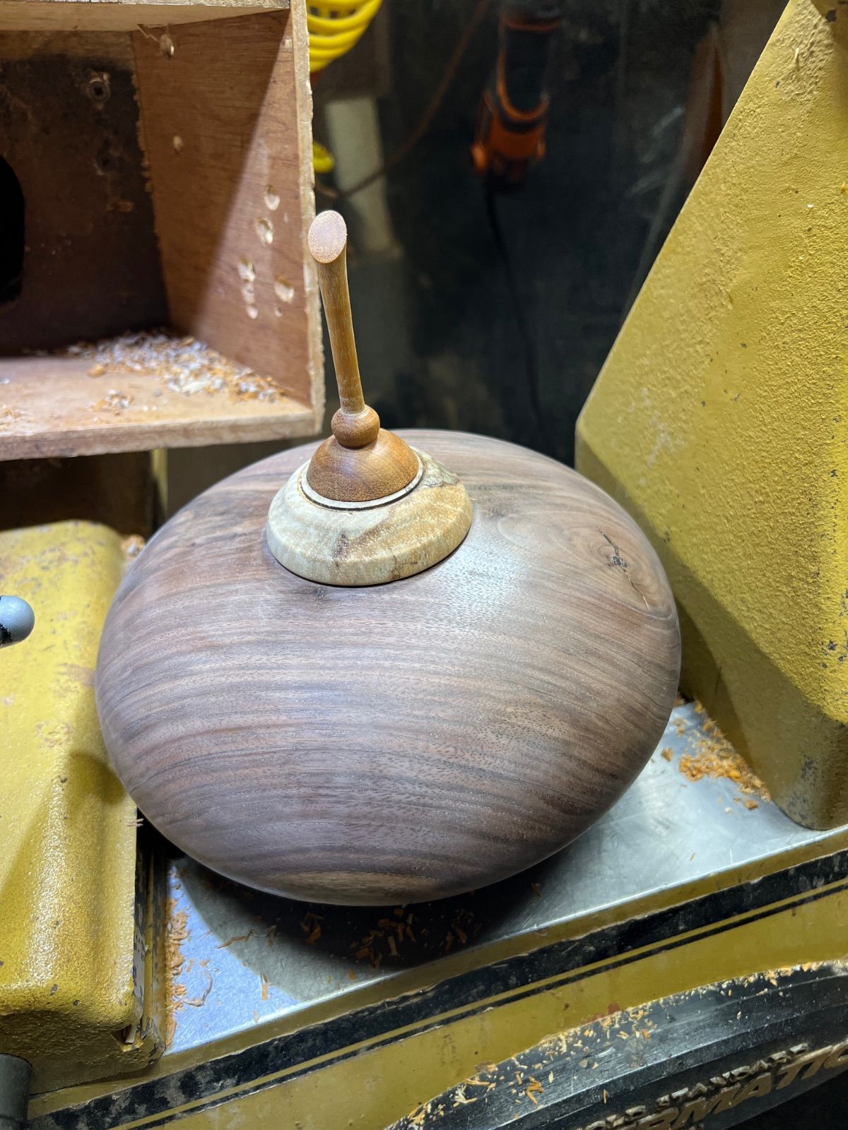

Turned the collar of Spalted pecan and  finial of an unknown exotic. Now to turn off the stubb on bottom and apply lacquer.
Wondrous Gerald.  Nicely done.
Really like that finial!
Most excellent @Gerald. Very unique.
