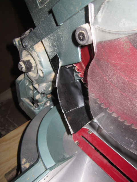

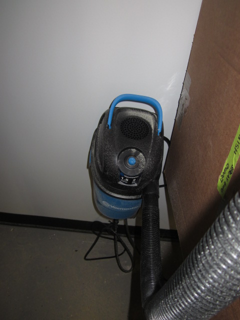

  11. Part of the new shop build is going to be a better miter saw station. Dust collection always seems to be a problem with these guys (I guess Festool might the the exception, but I'm not spending as much on a miter saw as I did on my Unisaw) Anyway, I did steal a Festool idea. They have a little rubber(?) flap that channels the chips from the saw blade into the blade cover / vac chute. My Hitatchi saw didn't have one of these. I did have a little plastic piece that broke off very early. So I fashioned a chip director from duct tape. Seems to improve things a bit . A second thing was to get a $20 shop vac on sale at Menards, hook it up to a master-slave switch so it comes on when I pull the trigger on the saw and runs 3-4 seconds after I turn it off. I have a poor-man's dust hood (moving box) that is just so-so and hope to build a better one with the miter station. Anyone else have a clever solution? It's currently close enough to the dust collector to run another 4" line to it, somehow.

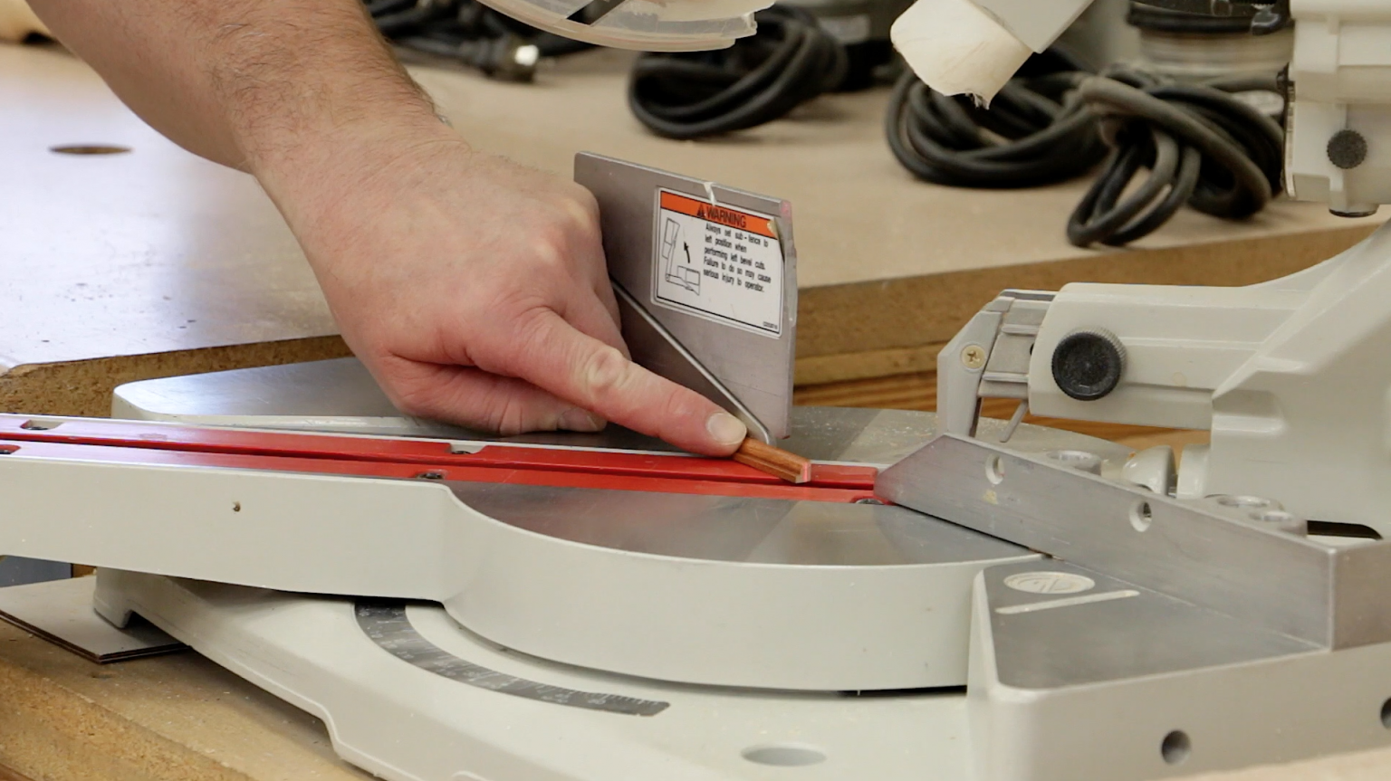

  13. In this video I share how I cut small parts on the miter saw. I am sure this one will be cause for active commentary from the safety police and maybe the hand tool junkies for not using a fancy hand saw to cut small pieces. Well, this is the way I do it in the American Craftsman Workshop. Because if the tool doesn't make any noise and throw a rooster tail of sawdust, how am I supposed to know that any work is getting done? Hope you enjoy the video and find it helpful;) Remember to let your work be your signature. Your friend in the shop, Todd A. Clippinger Share the Love - Share the Knowledge
