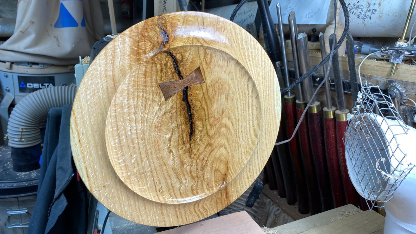

Popular Post lew Posted January 9, 2024 Popular Post Report Posted January 9, 2024 Still needs to be reversed and finish off the bottom mortise when the finish dries. Red oak platter. The defect was worse than first appeared. The dutchman is a piece of walnut thick enough for exposure on both sides. Hand chiseled the dutchman opening almost thru the oak, glued in place then turned away the back side, of the platter, to expose the walnut. A bunch of layers of wipe on poly. Worse part about applying poly, while on the lathe, is you can't do anything else until it dries. Of course, I could get a second lathe but it's cold and rainy and I don't feel up to sleeping in the garden shed. aaronc, Fred W. Hargis Jr, HARO50 and 6 others 2 3 4 Quote
Fred W. Hargis Jr Posted January 9, 2024 Report Posted January 9, 2024 That bowtie is a really nice effect on that, I think it's really cool. lew, Cal, Grandpadave52 and 1 other 3 1 Quote

Popular Post Grandpadave52 Posted January 10, 2024 Popular Post Report Posted January 10, 2024 I'll second Fred's comments. Too bad too, cause it has some beautiful grain characteristics and color especially for red oak. Still a beautiful piece. Just don't use it for soup. lew, HARO50, Gerald and 2 others 5 Quote

Popular Post HandyDan Posted January 10, 2024 Popular Post Report Posted January 10, 2024 Nice job on the chiseling. Looks great. Grandpadave52, Cal, Fred W. Hargis Jr and 2 others 5 Quote
Popular Post forty_caliber Posted January 10, 2024 Popular Post Report Posted January 10, 2024 Great job on the bowtie! Adds to the overall look of the piece. Worth all the work to show off that grain. .40 Grandpadave52, HARO50, lew and 2 others 5 Quote

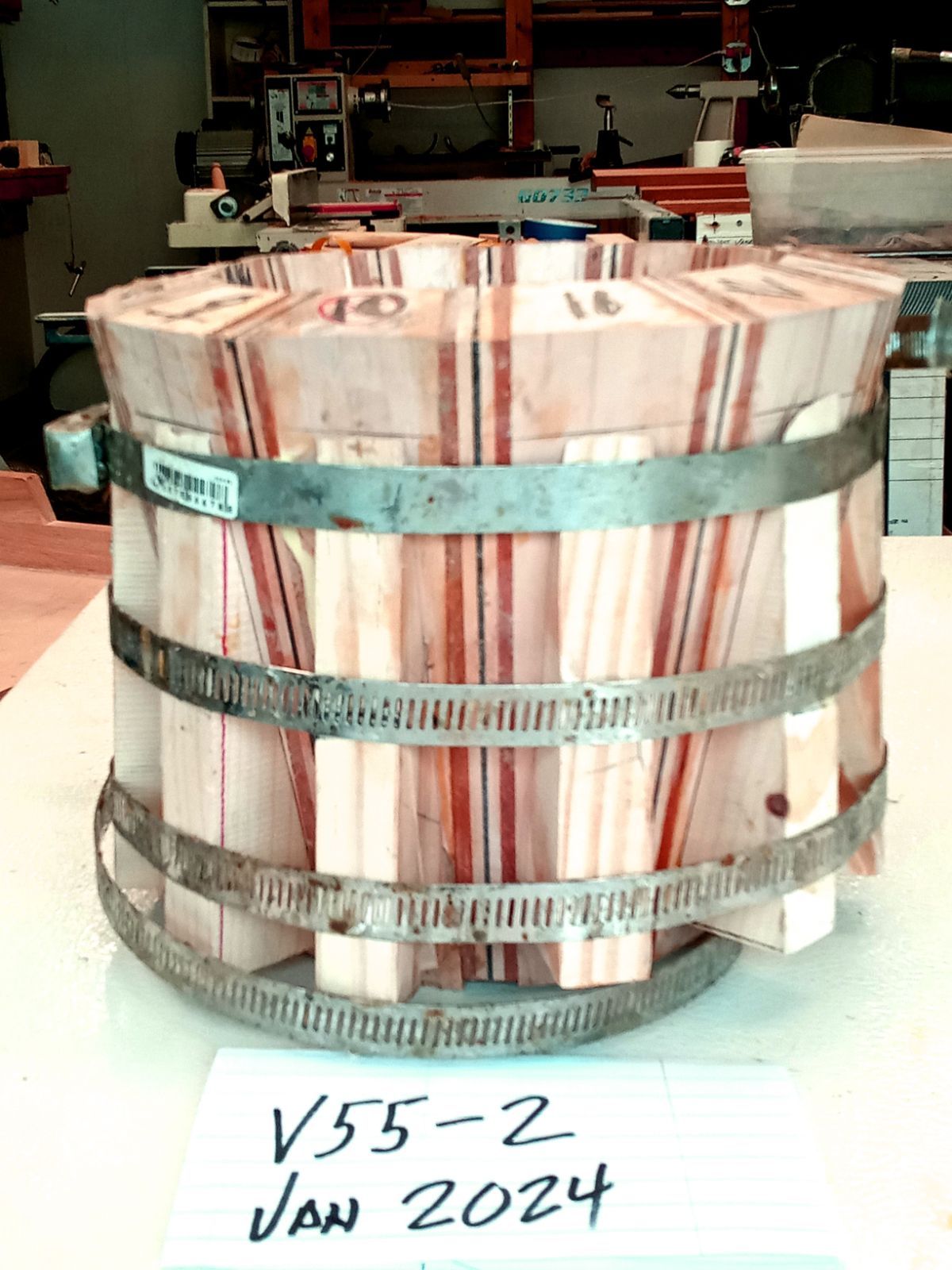

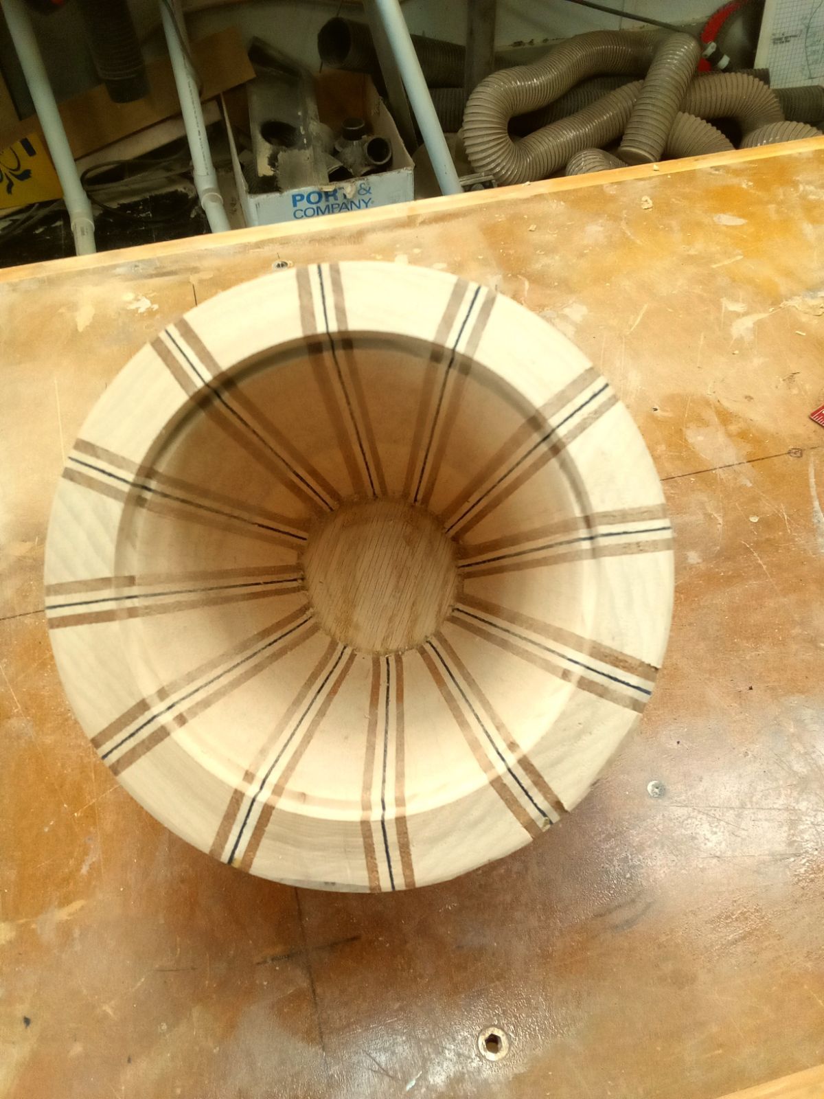

Popular Post calabrese55 Posted January 10, 2024 Popular Post Report Posted January 10, 2024 This may be premature given my recent success with spinning things made of wood. The pictures here are the latest attempt to build a staved bowl. This is the lower portion only. It is maple, sapele and black veneer pieces. The plan is to build a feature ring of epoxy resin and top off with more maple and sapele. So far so good. I have come up with a way to cut the staves that seems to be pretty fool proof for me . In brief I simply mill up the blanks lay out pencil lines of the double taper on one blank and carefully clamp and cut on a cross cut sled. The layout happens on one blank only and when cut stop and register blacks are double taped to the sled so each successive blank is located exactly the same. Couple pics of that process here also. Keeping my fingers crossed calabrese55 Fred W. Hargis Jr, lew, Grandpadave52 and 5 others 6 2 Quote
Grandpadave52 Posted January 10, 2024 Report Posted January 10, 2024 That's awesome Mike. I'll definitely be watching this one to completion. BTW, Happy New Year. lew, HARO50 and Cal 3 Quote
lew Posted January 10, 2024 Report Posted January 10, 2024 @calabrese55 Awesome setup on making those staves! Gonna be a beautiful piece when finished. @forty_caliber Thanks! @HandyDan Thanks! Grandpadave52 and Cal 2 Quote

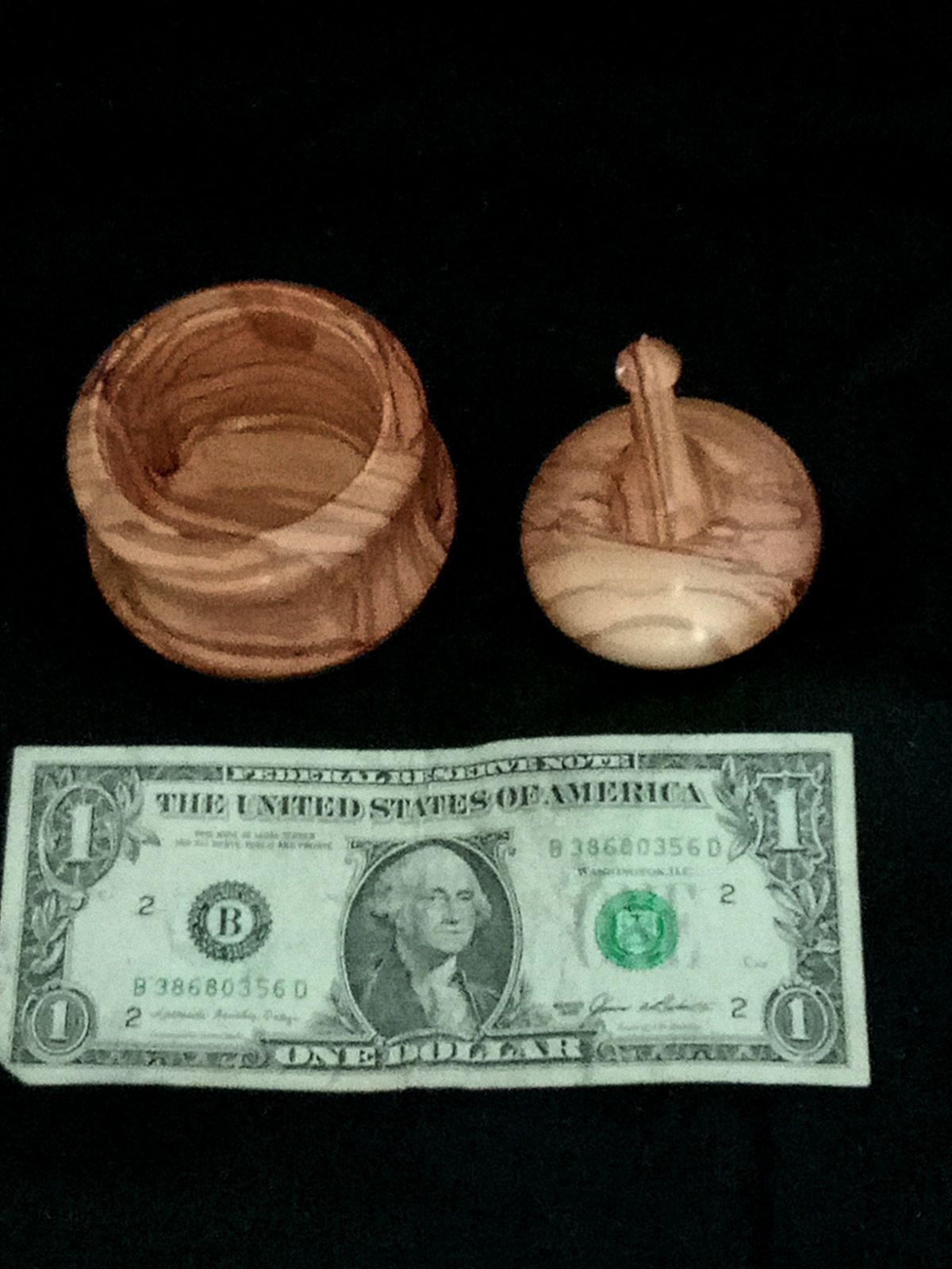

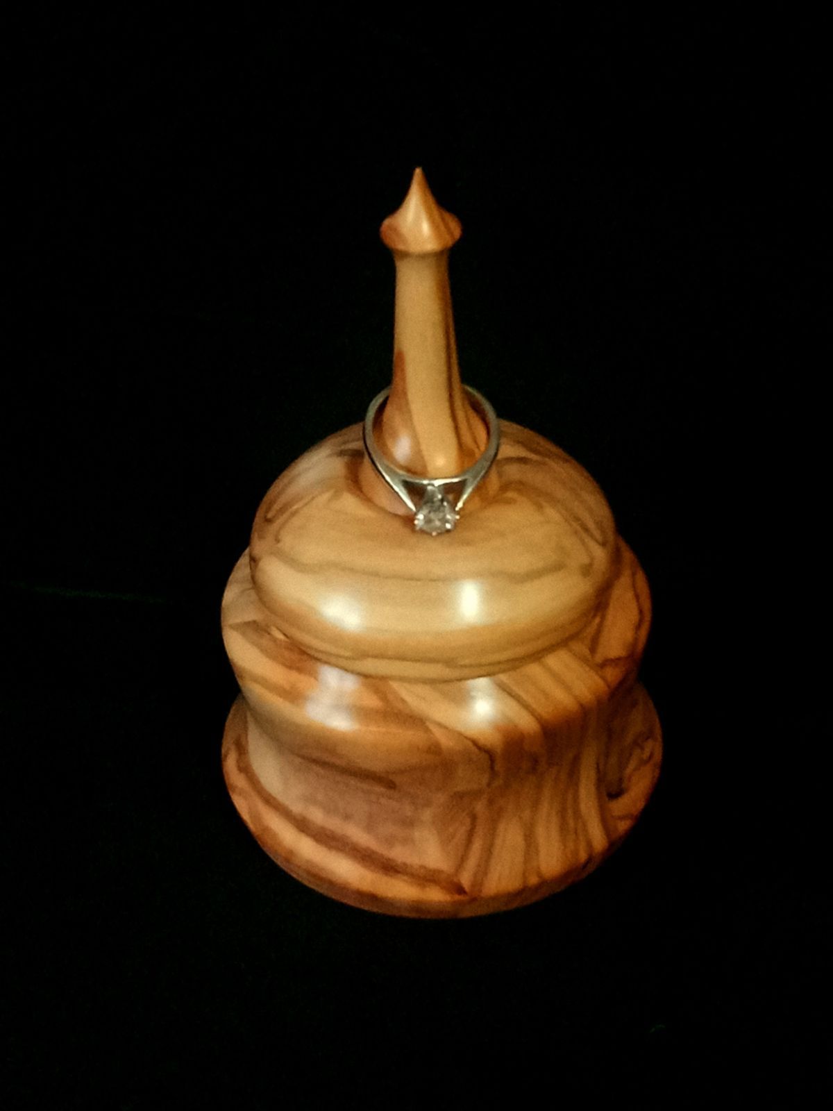

Popular Post calabrese55 Posted January 26, 2024 Popular Post Report Posted January 26, 2024 Re-purposed olive wood pen blanks I am no longer interested in turning into pens fell off my lathe looking loke a ring box. Plan to put it in a gallery for sale but I have to first convince my wife she has enough of my junk in the house . Never show your wife what you lathe can do calabrese55 aaronc, Headhunter, Grandpadave52 and 5 others 2 3 3 Quote
