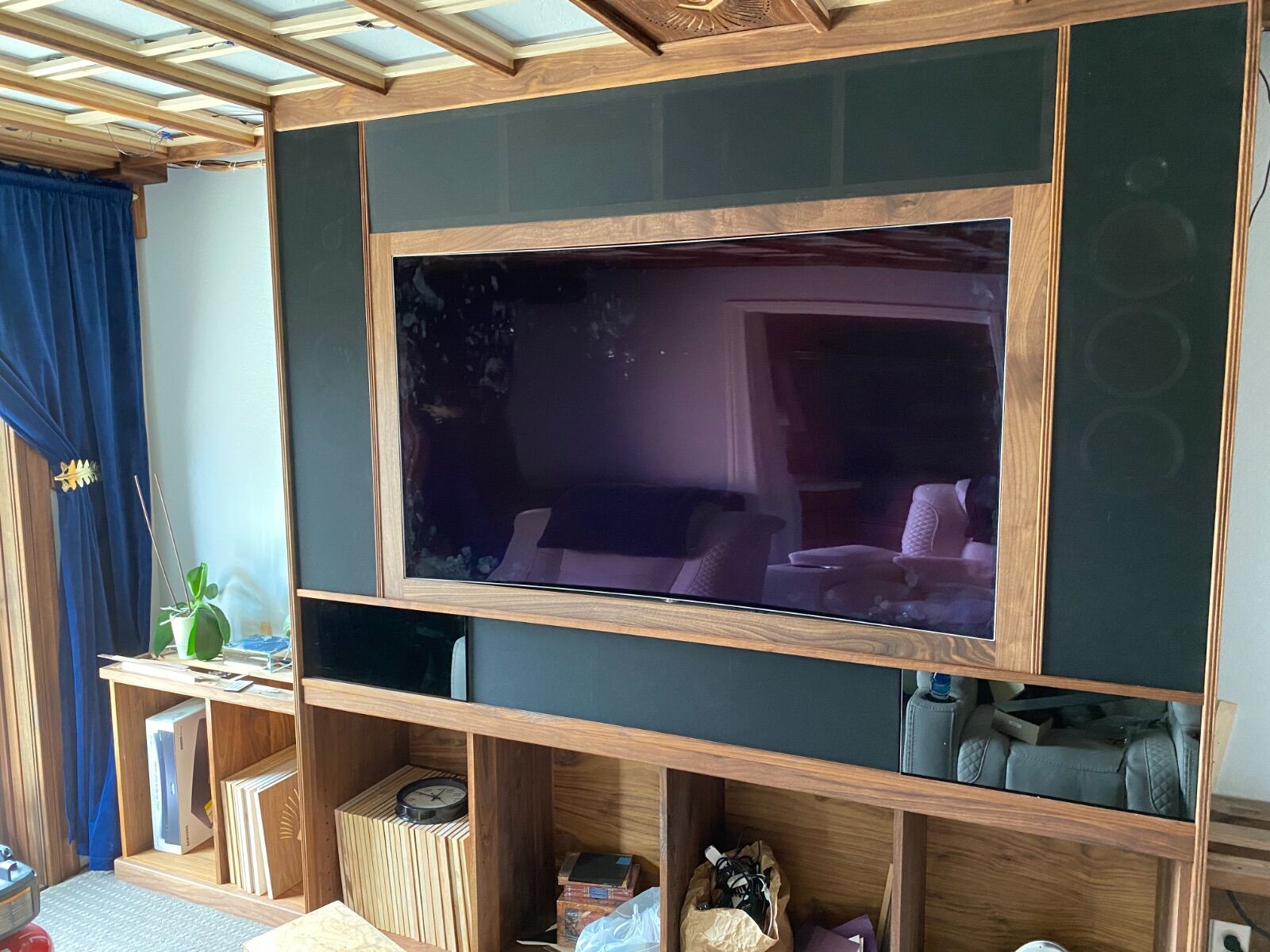

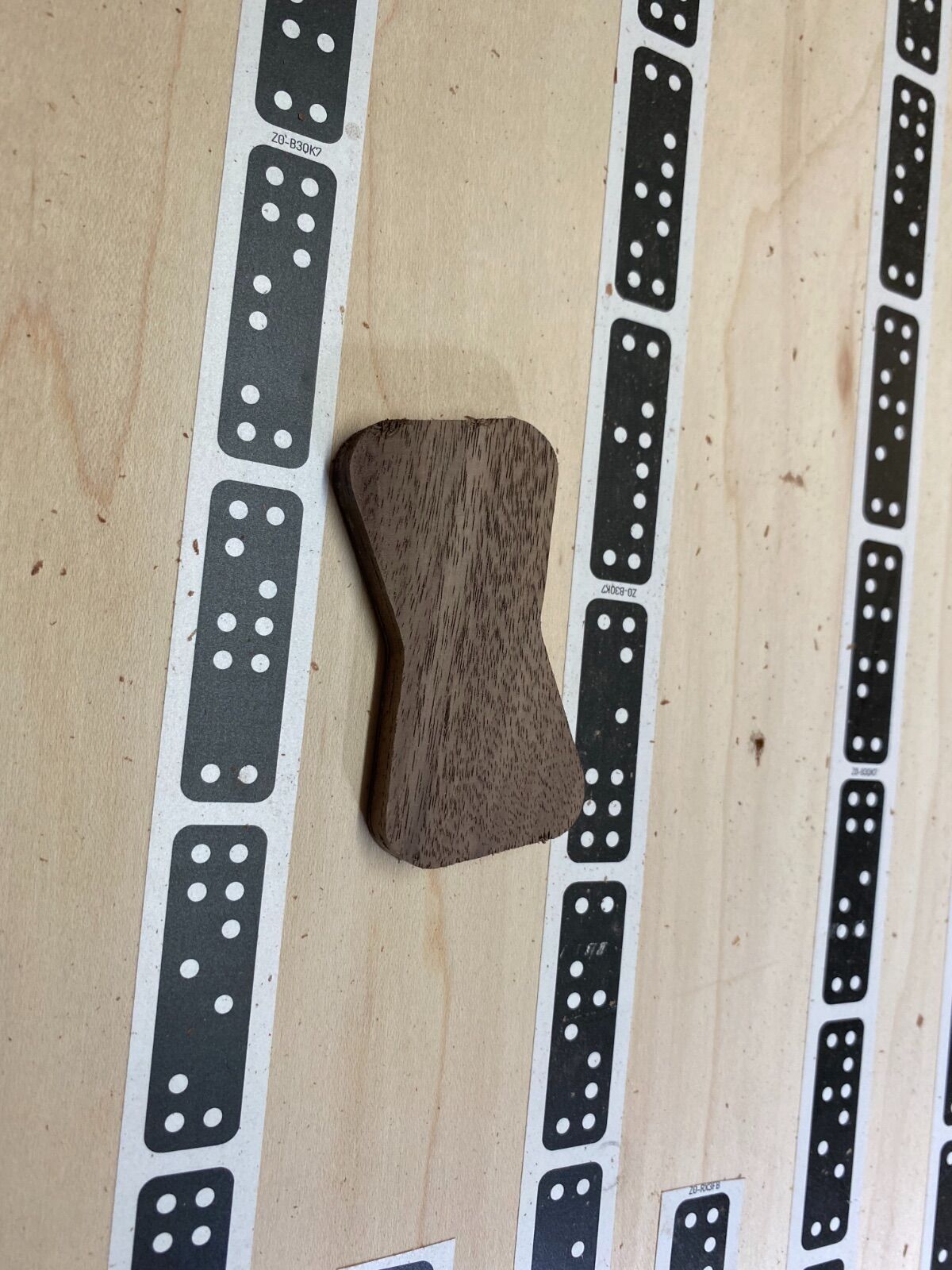

Made the frame for the TV screen today. I decided  to add some reinforcement to the joints due to sides being long and narrow.
Paul
Now that's cool!
Now that's cool!
Ditto!
The frame is finished and installed.  Now it’s on to the cabinet doors and internal dvd drawers.
Paul
That does look great Paul, awesome work!
Ditto
Thanks for all the kind comments 🙏
Looks pretty sweet Paul :TwoThumbsUp:

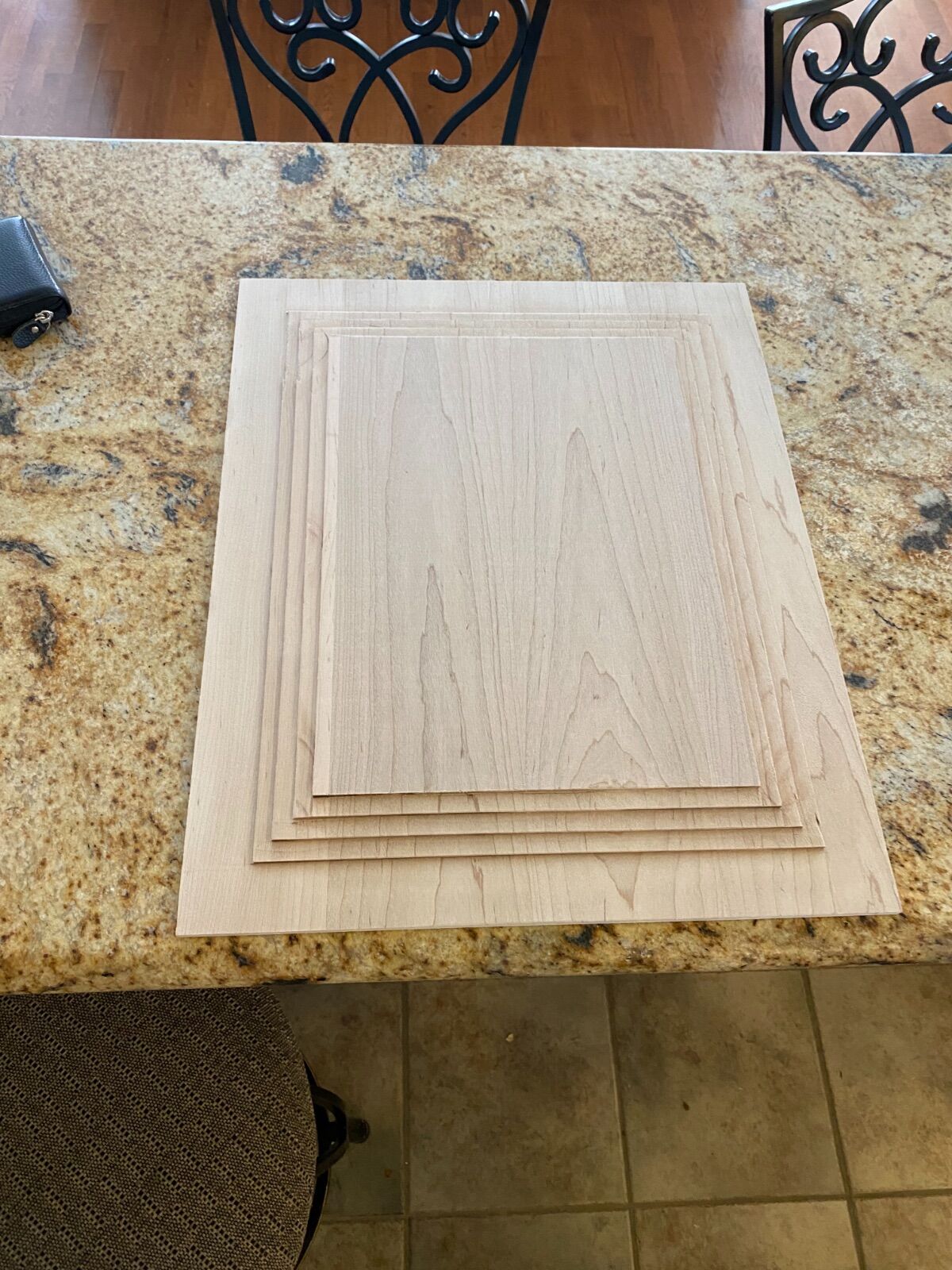

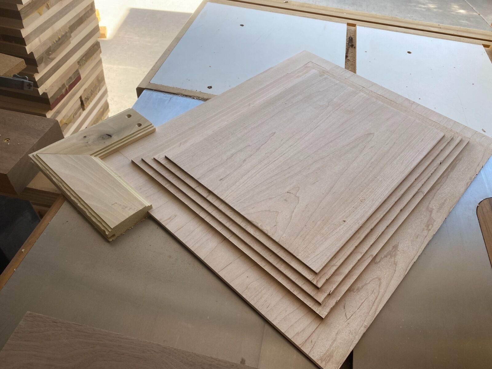

We are back on the media room this week. The first job is to get her sign off on the raised panels for the cabinet doors. I did a couple of examples and she chose the most rectilinear one which is fine. I was leaning towards a softer version that’s made with a set of infinity knives but I like this version also. Now it’s glue up all the panels and get onto the rail and stiles for the door frames. She wants mitered corners so that makes manufacturing them easier but more complicated on the glue up. Oh well. Disregard the quality of the cuts in the picture. I made the panel with a very old 2” router bit. I’m not willing to use a good bit for demo purposes. The actual panels will be made with a fly cutter with replaceable carbide cutters.
Paul

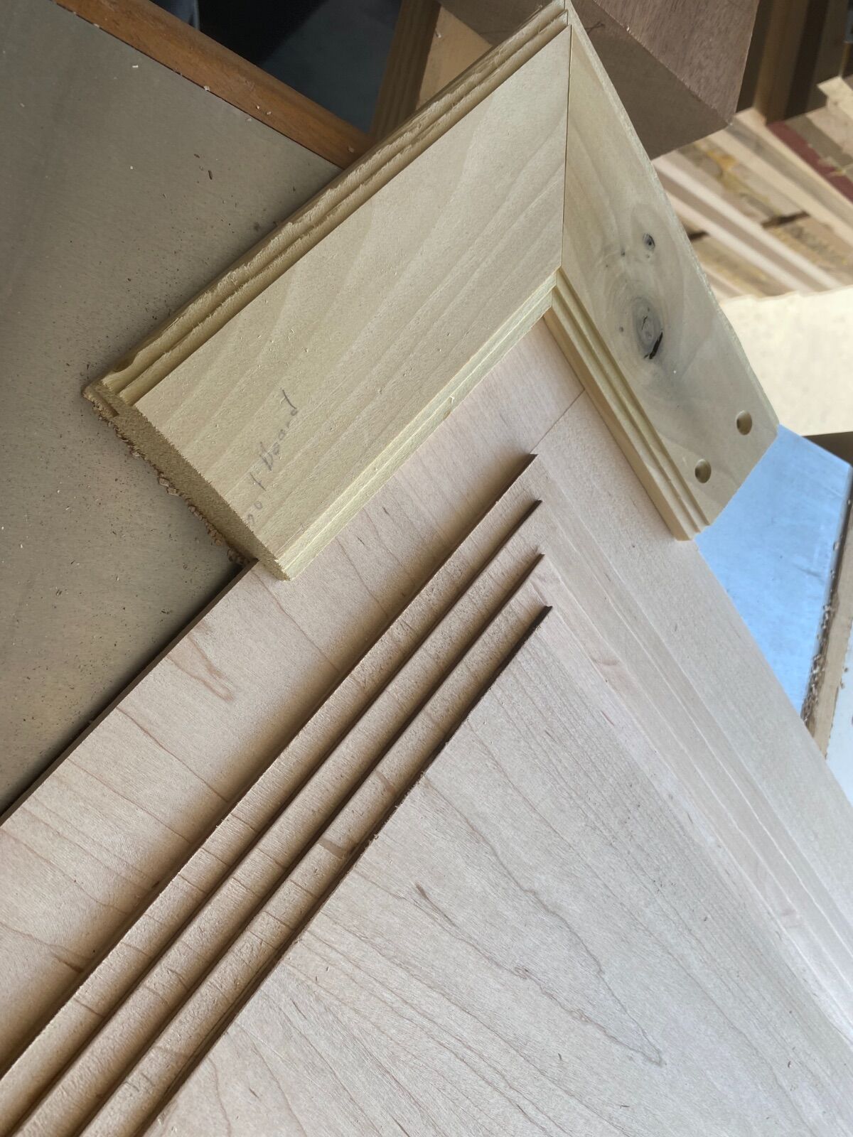

I finished the rail and stile mock-up. Hopefully it will pass muster. I did get all the raised panel blanks resawn and glued and sanded one up to see how it looks. As long as she approves the mock-up all should go fairly smoothly from the point. For me it’s a little too rectilinear but mine is not to question why 😎
