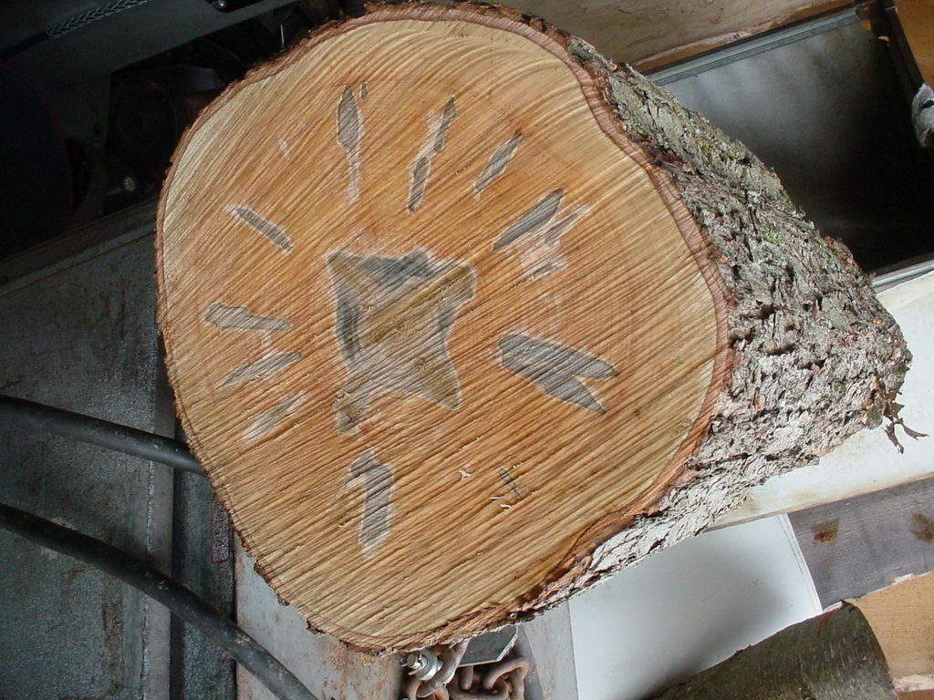

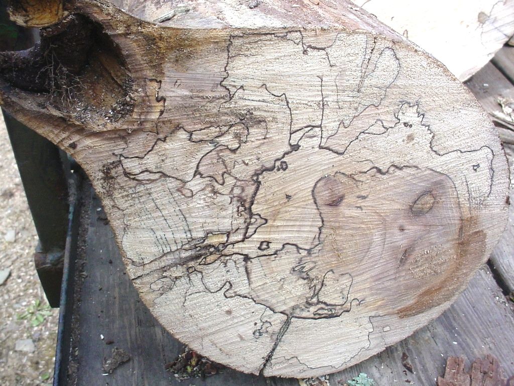

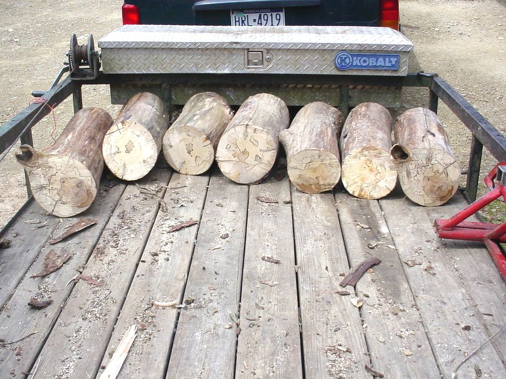

April 23, 20206 yr comment_226275 With nothing else to do I have been cutting a ton of fire wood. I found some spalted ash and I found a fox. I can't wait to get some time to play... Report
April 23, 20206 yr Author comment_226280 I've seem spalted maple never ash. How many kinds of wood can spalt? Report
April 24, 20206 yr comment_226294 Any wood can spalt it just may not be recognizable. The trick with spalt is to catch it before the wood gets too soft. From the outside looks good to me Report
April 24, 20206 yr comment_226296 When I first read the that you found a fox, I thought animal. After seeing the picture, I understand. Absolutely beautiful. Can hardly wait to see the turned product. Report
April 24, 20206 yr Author comment_226301 Not sure how to turn the fox without messing it up... Report

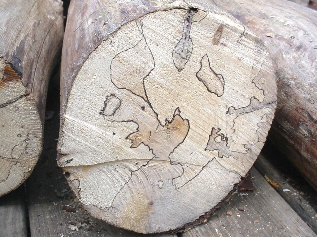

April 29, 20206 yr Author comment_226982 Is this also spalt ? Center dark ? The last picture is another odd ball... Report
April 29, 20206 yr comment_226985 I think you have Ambrosia Maple there and the discoloration is a fungi caused by wood-boring Ambrosia Beetles. Report
April 29, 20206 yr Author comment_226986 6 minutes ago, HandyDan said: I think you have Ambrosia Maple there and the discoloration is a fungi caused by wood-boring Ambrosia Beetles. Thanks I have heard that name before... Report
April 30, 20206 yr comment_227008 I agree with the maple call. Very beautiful wood. This could be the beginning of some amazing turnings ! Paul Report

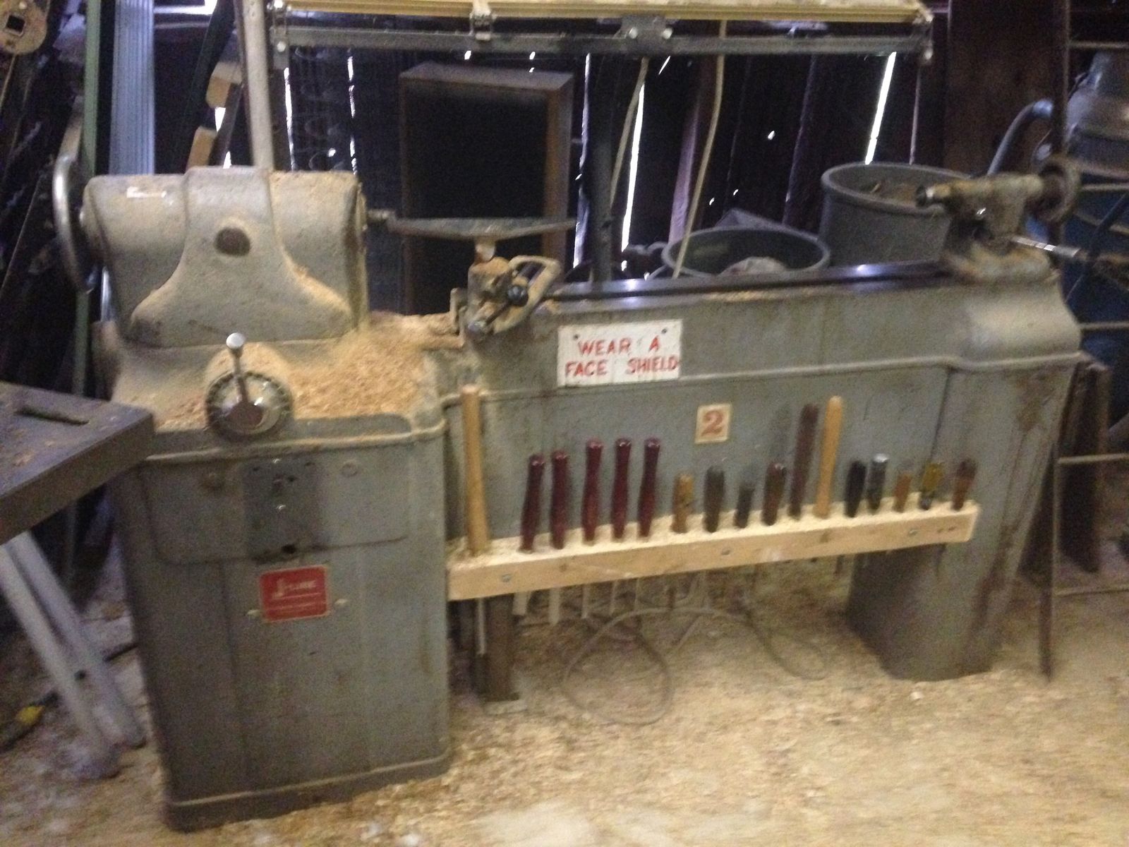

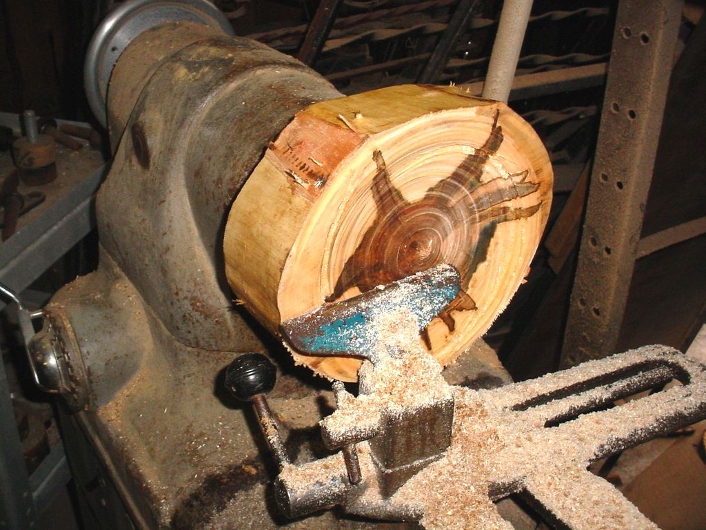

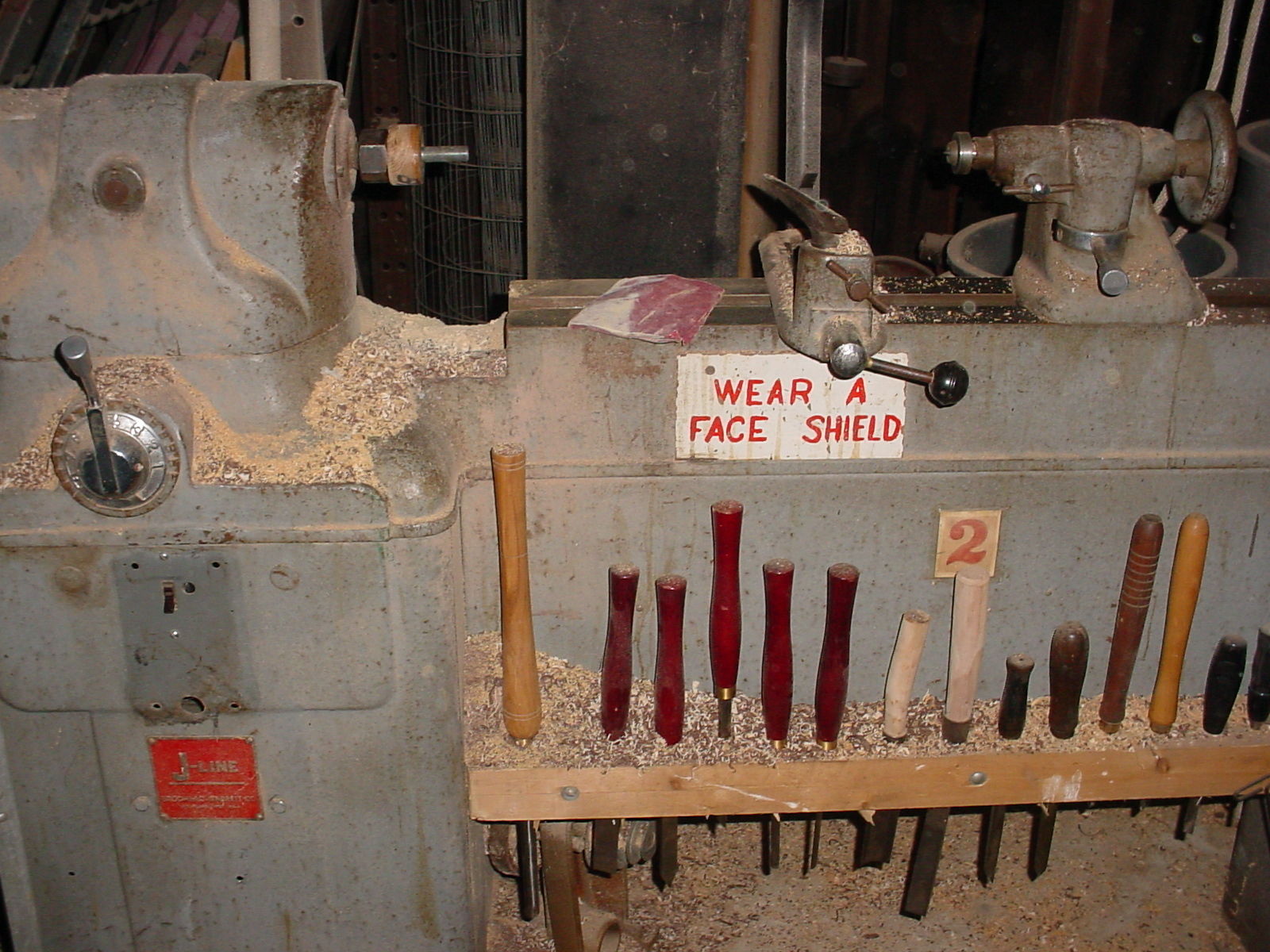

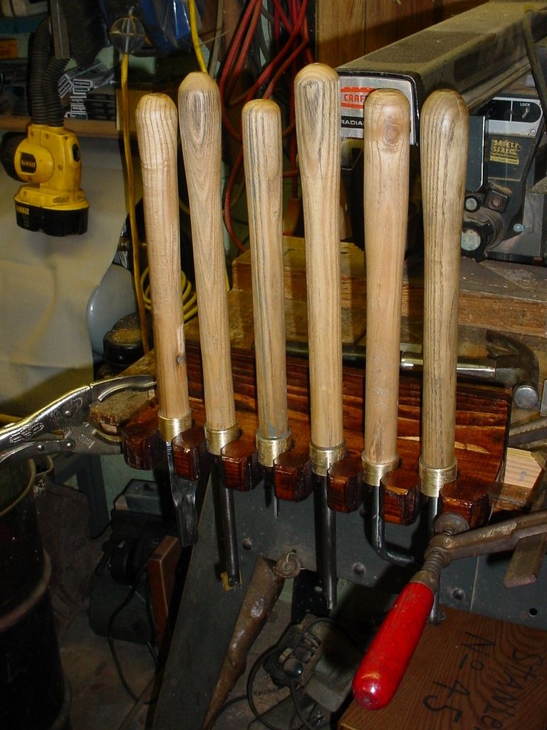

May 1, 20206 yr Author comment_227193 Question on this Ambrosia Maple... When I was cutting this tree down the chainsaw was catching the wood like the rakers was to low on the chain. The rakers was never touched. The chain was almost new. I had lot of chunks to play with so I thought I would try turning a chunk. I know that it's green and wet but I wanted to see what a chunk would look like. I'm not liking it at all. I never had wood that would take the tool right out of your hand. I tried every cutter tool I have and each tool grabs to the point that it's all you can do to hang on to it. The chip and saw dust that comes off the wool stings my hand to the point it feels like there should be blood. If it still turns like this when it's dry I'm giving up. It's not worth it. My hands still hurt. Is it that the wood is green and wet or something else that I'm having problems with? I've turned a many bowls and other things and many different kinds of wood but I have never had a wood that grabs like this. It grabs so hard I'm afraid of braking my tools. I never had my chainsaw grab like this before ether and I grew up on the farm using one for years. ??? Report
May 1, 20206 yr comment_227195 Probably the dark center which is not ambrosia. Ambrosia is somewhat irregular. That pit is very hard and could be your problem. What tool you using? Report
May 1, 20206 yr comment_227200 You are turning all end grain. Not an easy task. Looks like you are using a scraper. If so it should be a negative rake scraper. A spindle gouge works if you start at the middle and work your way out. Scraper should be used the same way. Watch some videos for turning end grain bowls. Plenty of them out there. Report
May 1, 20206 yr comment_227205 1 hour ago, HandyDan said: You are turning all end grain That was what I was thinking, also. Report
May 1, 20206 yr Author comment_227208 Yes I'm turning end grain. I tried every tool I got. Every tool in the pictures. Some carbide, some not. Will this get better when the wood drys? Report
May 1, 20206 yr comment_227209 End grain is more difficult to turn than "side grain" but the end results can be spectacular. Check the video from Tim Yoder in this weeks "Wednesday's..." to get an idea. Report
May 1, 20206 yr Author comment_227210 I've turned a lot of end grain before but I've never had this problem. Report
