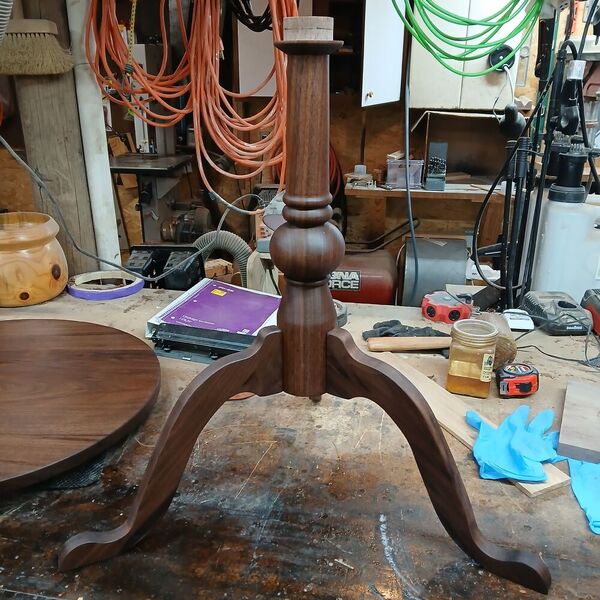

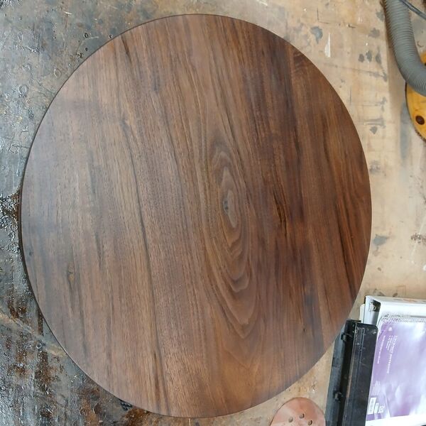

Well it's been a few days since I posted but you all know that life has a habit of getting in the way, wellit did 😄20260306_150115.jpg20260306_150019.jpgBut I got in a good days work today. Everything fits and got the BLO on now to let it dry and put the finish on . Probably notice that there is no hinge, that was a requirement by SWMBO that I agree with. More when it is done.

That is beautiful @Rusty S!!
Indeed, a really nice table. Well done!
Gentlemen; thank you for the kind words they make an old man feel goodOldManSmiley
@Rusty S Beautiful work. Is that Walnut?
Lew your quite welcome I'll show a final picture when the finish is done.
Rick yes Kansas walnut locally sourced and air dried, and thanks for asking.

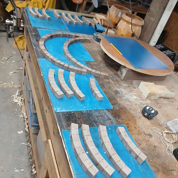

Just when you think it's all under control SWMBO looks and calmly remarks that would look better with an apron ChinScratch so being a Turner what would you do? Especially one that doesn't know he can't do that. 20260308_171430.jpgNever gave a thought to how many pieces would be in each ring and how much error there could be but getting the closer to making it work. To be continued 🤞ppl

Gonna be even more awesome @Rusty S. Enjoying your build.

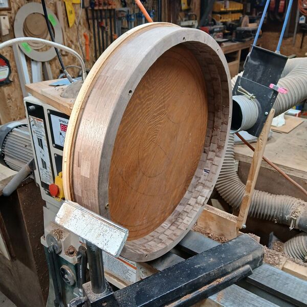

Well it's finally round on one side, doesn't look too bad long as you don't look inside ROFL20260311_115146.jpgMy wife was sure I was about to kill myself with this setup but it worked so what can you say for success except whoooo. More to come 🤞
Insides are for the kids/grandkids to discover. I had a student once that had an intricate jungle/animals/etc. pattern cut on the underside of the dining table she made in my class. For her future kids to discover.
