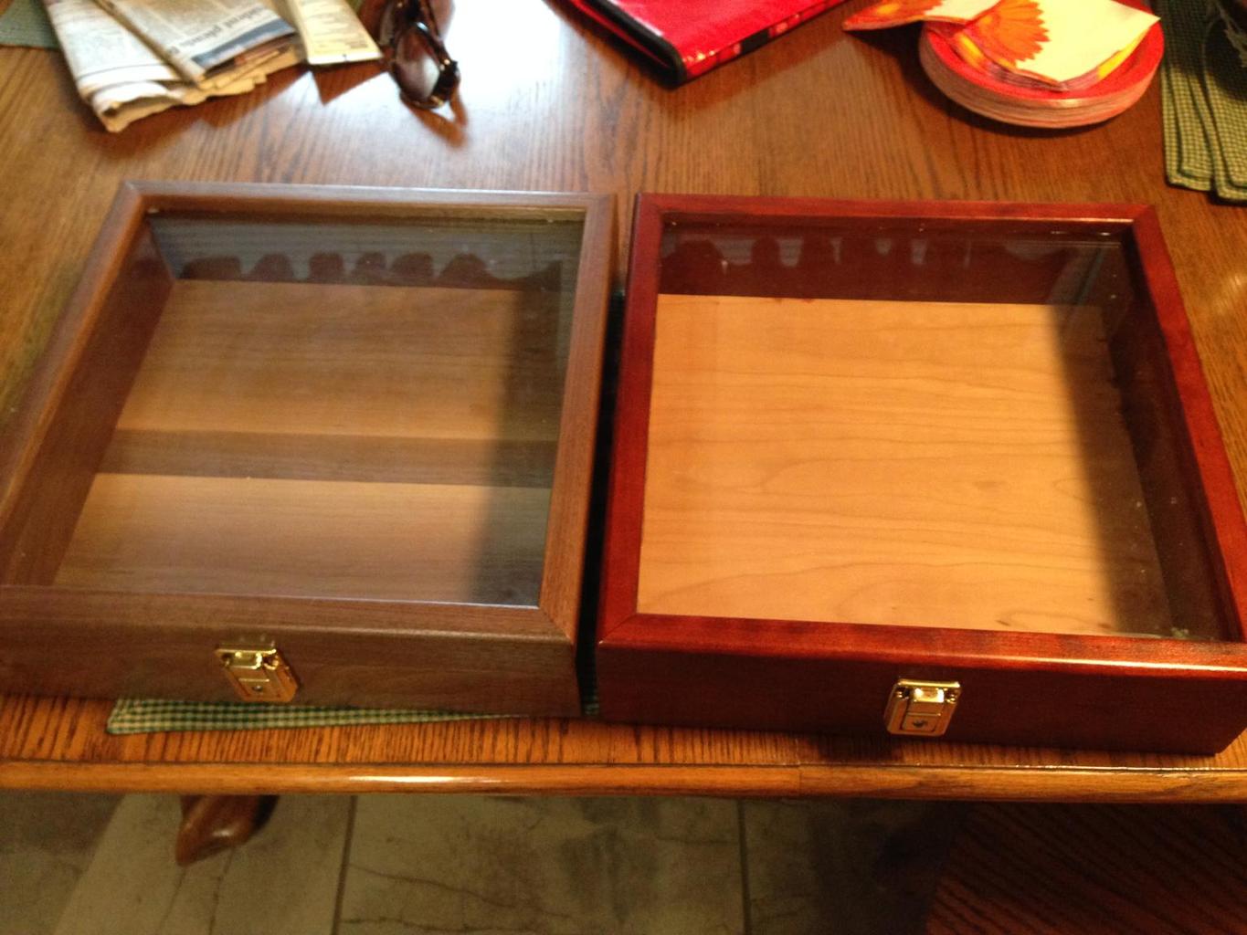

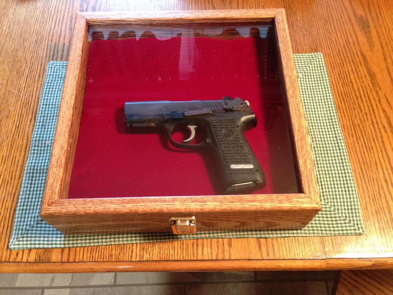

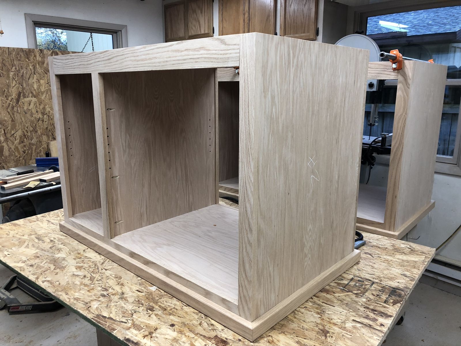

  3. Hey gang, welcome to the weekend. This is NRA convention weekend in Indiana but I was forced to stay home because I’ve been fighting a minor eye issue. I did get credentials though. I’ve been building some accessory cabinets for the local Elk’s lodge here in town and I just finished cabinet number 3 of 6. So, I have to ask, “Whats on your Patriot Woodworker agenda for the weekend?”

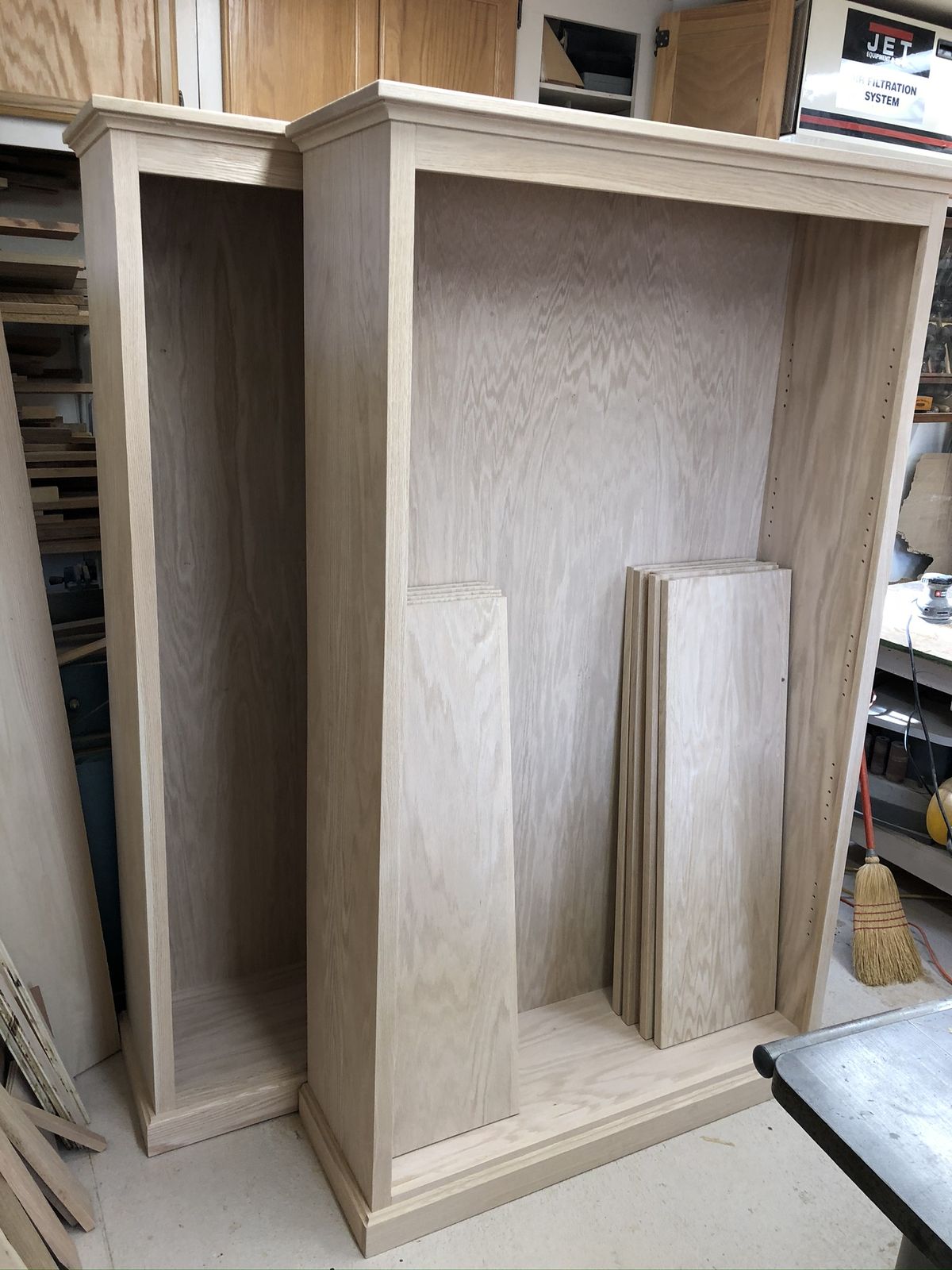

  10. The big big thaw is on in east central Indiana! It’s a balmy 17 degrees and I suspect the robins will be flying in at any time. Last night the temps began to rise and we got 5 inches of snow. The coldest we got this week was -17 but it was bearable because I keep my shop heated. This week I had 2 major accomplishments other than staying warm. Last Monday, I braved the snow and picked up a Dewalt 735 planer 5hat I bought and I managed to complete a mantle for a client. I’ll install it next week and add a bit of trim to match. So, Patriot Woodworker’s, what’s on your weekend agenda?

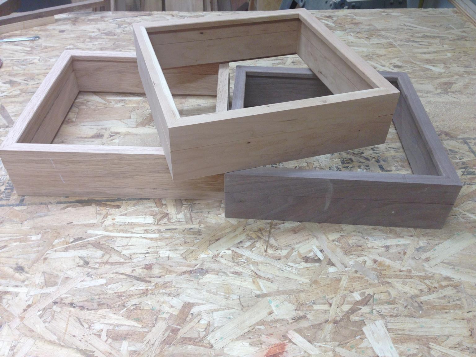

  16. Summer is flying by. Here we are headed into the final weekend in June and we’re looking at Independence Day next week. Shop wise, I started a small job this week. I’m building a double sided glass shadow box for a friend of mine. His dad was a WWII Purple Heart vet and served in the South Pacific. He was carrying a silk AAF map of Japan with him when he was hot in the arm and I’m building a case for the map. BTW, the map still bears the blood stains of his father. Originally we were going to build the case to hang on the wall but with a weight of 24 pounds he opted to make a desk mount. Unfortunately, I failed in convincing him to let me put UV archival glass in it. Too costly he felt. Sigh. Anyway, they’re calling for excessive heat warnings for Indiana so I’m planning not to stray far from the A/C. What’s on your Patriot Woodworker agenda?
