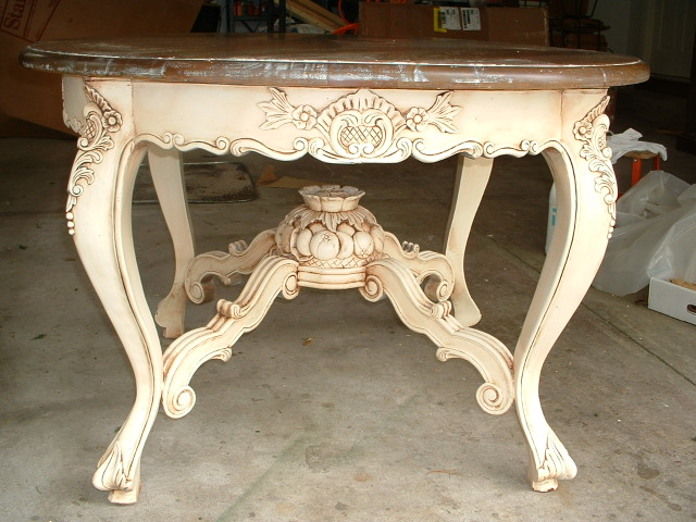

  4. A long time ago, I did this project for a retail customer. Long story short, they gave up this vendor and needed to move the pieces left in stock. Consumer wanted this look, that wasn't one of the options left in inventory.. Applied a couple of coats of white lacquer, then burnt umber glaze, then clear lacquer. I was as glad to be rid of this mfr as the retailer was. Not my tastes, but "whatever." Before During After. White spots across natural stained top are "dusty wax," another of their specialties that caused all sorts of problems. My wife always said it looked like "Insufficient housecleaning," which I guess was the intent. Dusty wax On Off And another job, same mfr, customer wanted the painted highlights on the front of this armoire, what was originally all stained.
