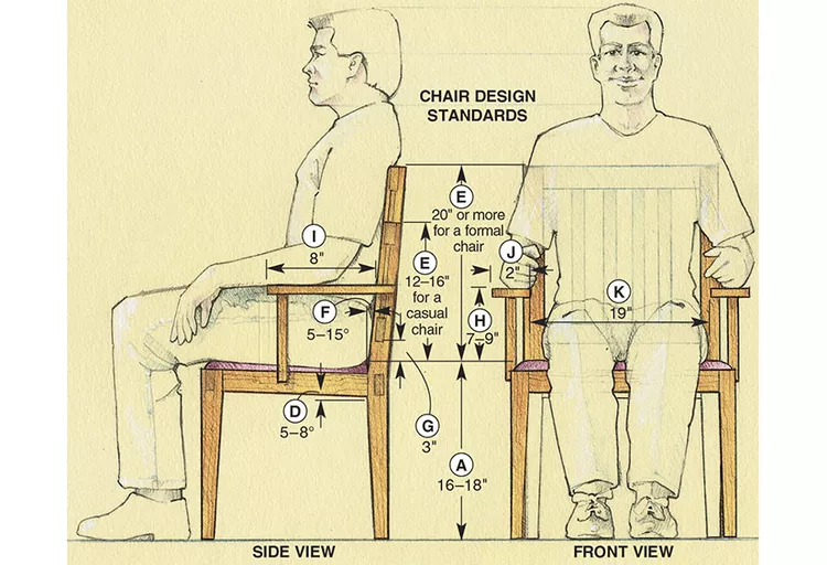

    I've been tasked with making the Pharoah's Throne for the upcoming performance of Joseph and the Amazing Technicolor Dreamcoat. I've been running around the house measuring angles and dimensions to get a basic design together. I found this and thought it was good for anyone designing a chair. https://www.woodmagazine.com/must-have-measurements-for-comfortable-seating

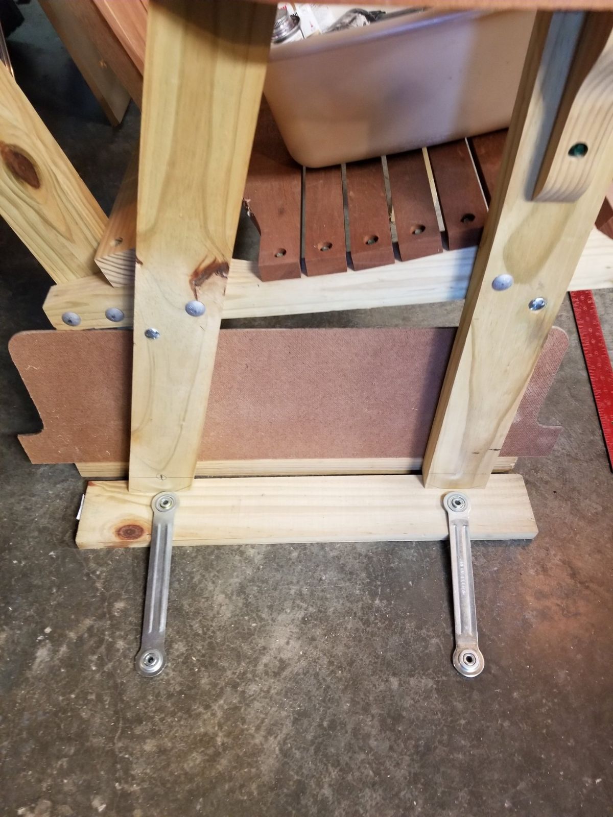

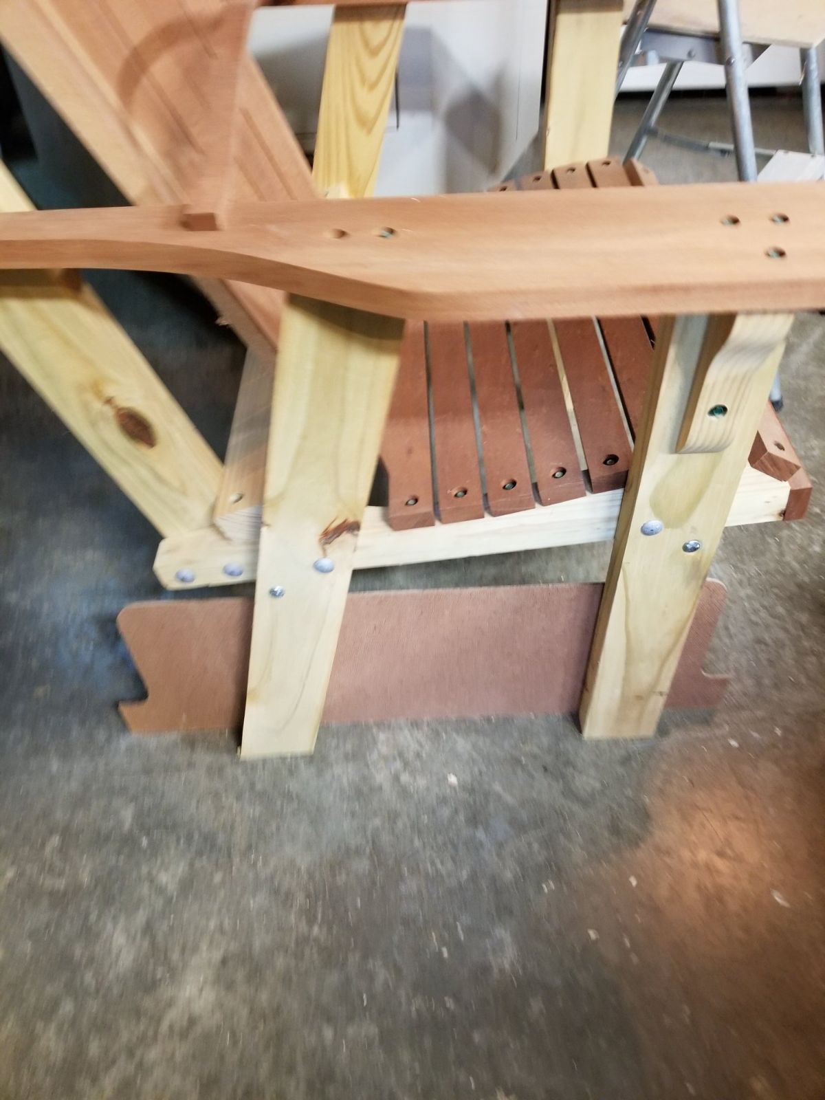

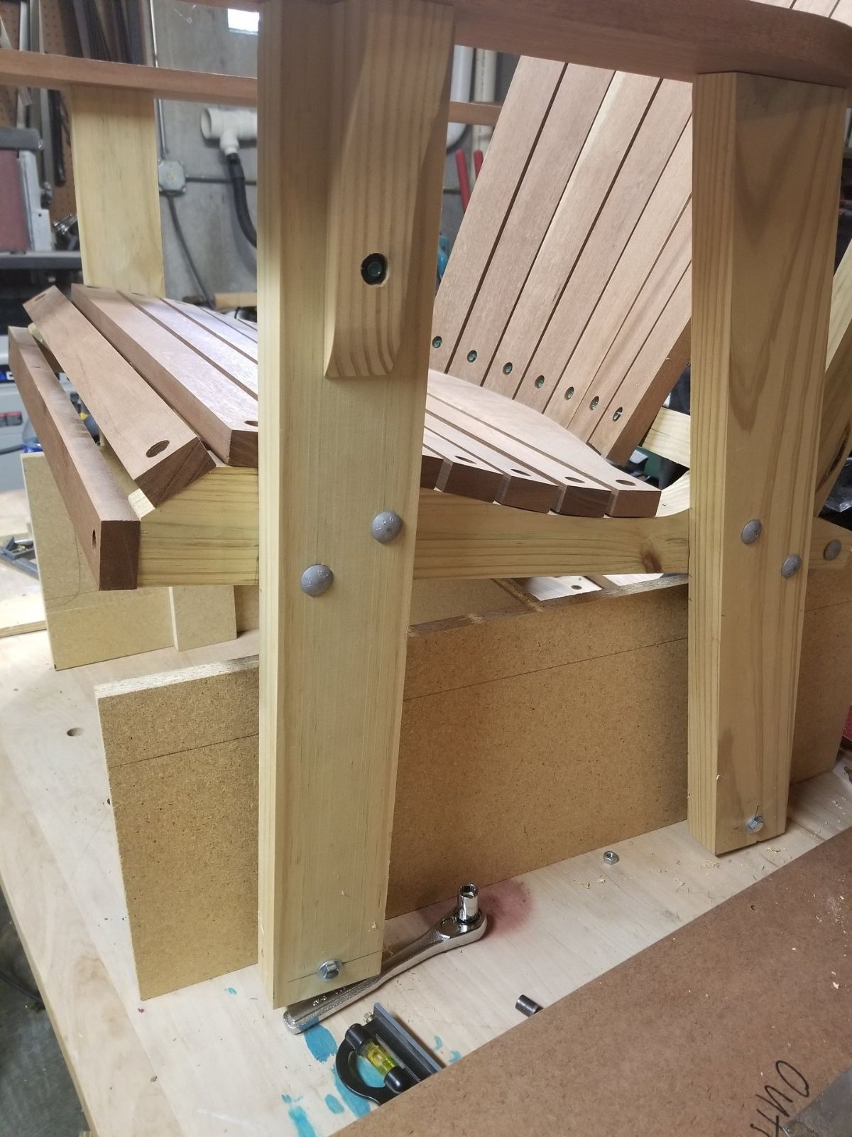

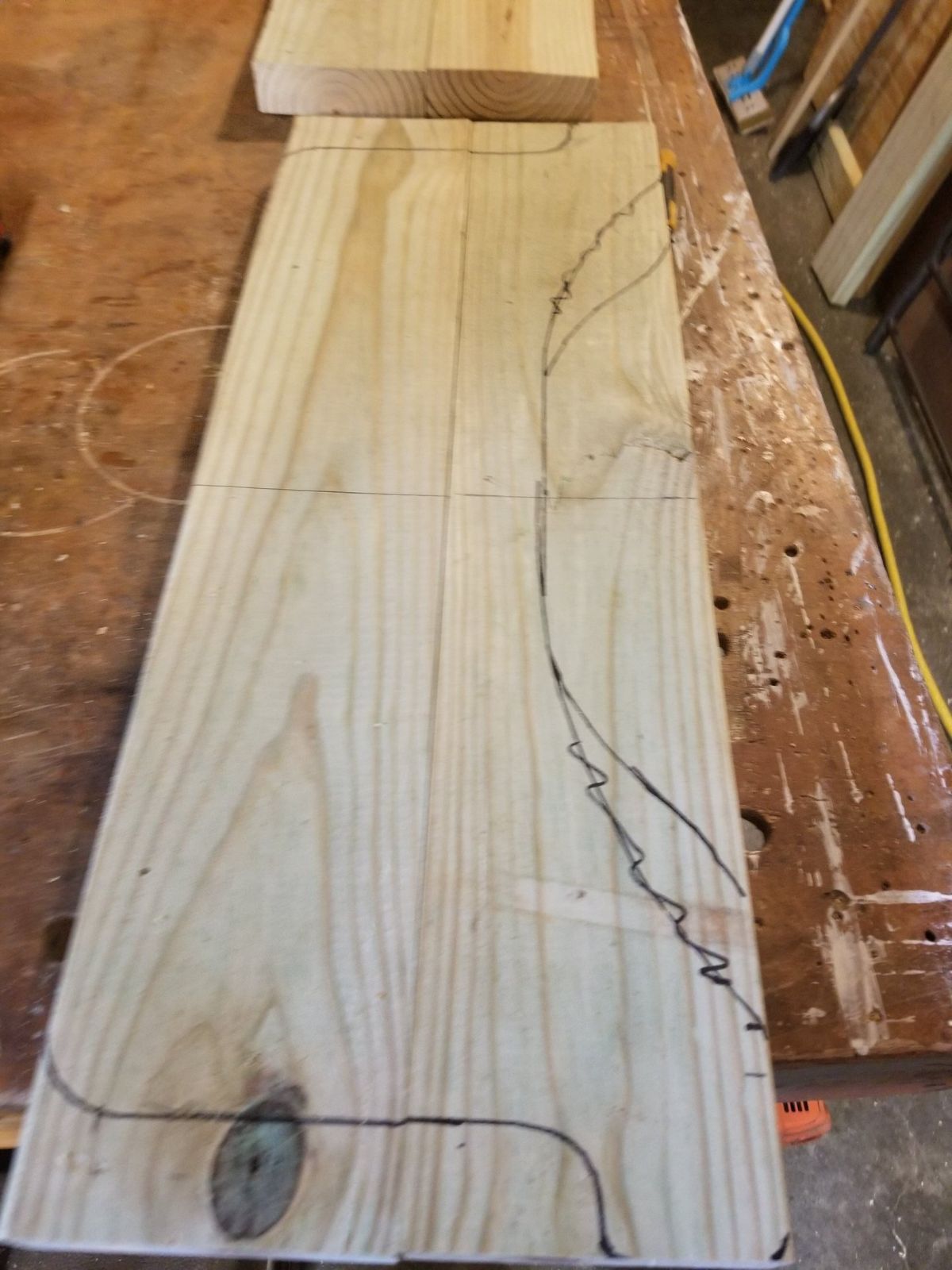

    Another one of the projects I got to a point and wasn't sure I wanted to use all my Sapele on. Stopped and think Im gonna use it to get rid of it. The base has been an issue. I borrowed a sample chair from a relative but took it back before I got the holes, etc on the base pattern. After a couple days of refiguring,adjusting and rebuilding I think I've got it. The bases are treated for ground contact.
