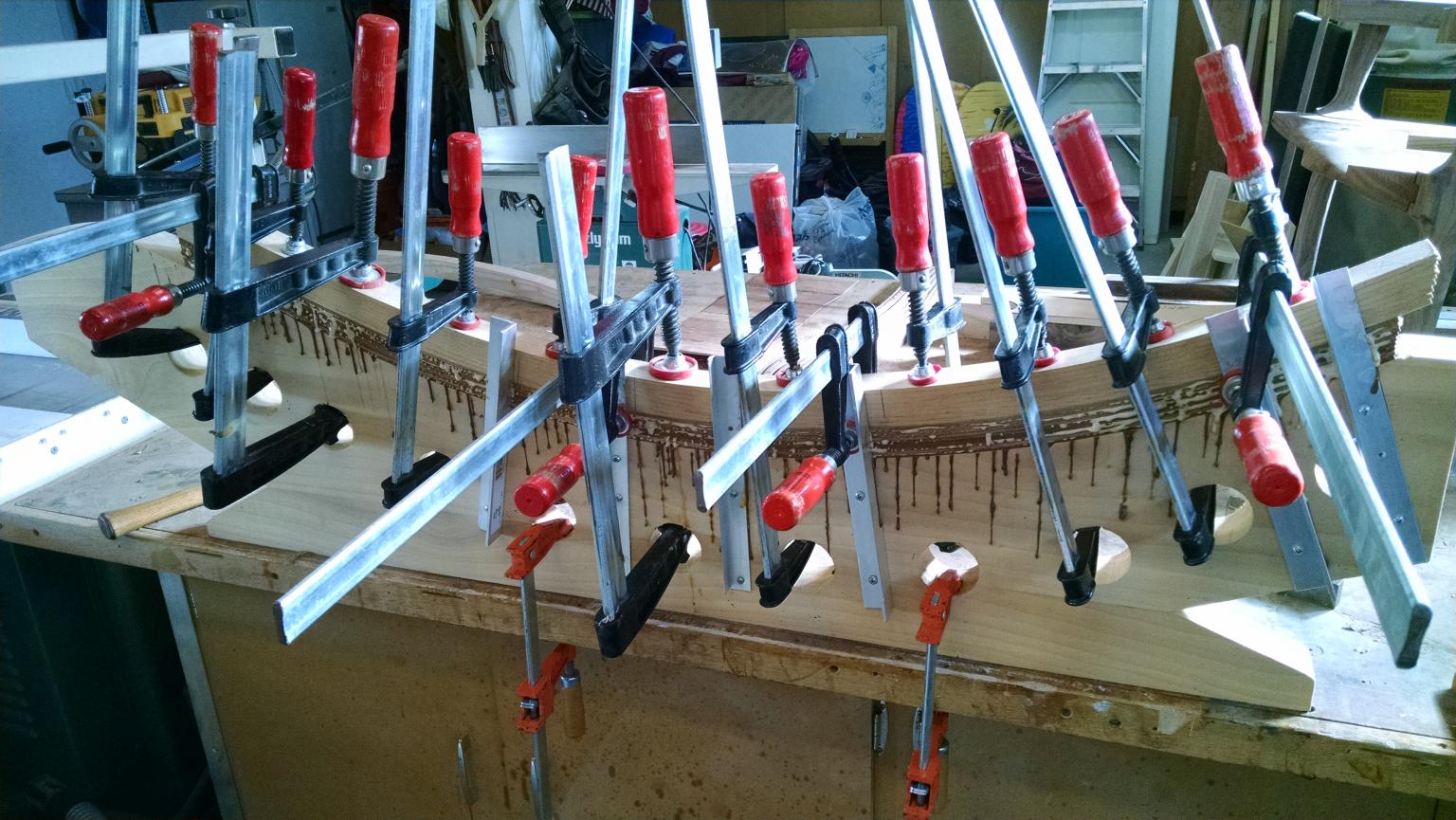

  9. Last night I managed to get one of the rockers glued up and in the form. I have to work fast for this process, so all my clamps need to be near by in reach, and I had to spread my glue on 16 surfaces, each side of each lam except for the top and bottom of the rocker. I used Titebond III which typically has a longer open time than traditional white glue. So it gave me about 10 minutes to work with, but I may have only taken 5 minutes, but it's a long 5 minutes! After getting the lams glued up, and set the stack on my rocker form. Then the clamps were applied I'll be able to remove this rocker from the form this morning, and I can then prep the next stack of lams and get them into the form as well. This next set of lams (below image) will go into the form this morning. I also set my alternative rocker "top form" in the picture too, I departed from the original design of the rocker ("top form" in image above) and created my own design "top form" to extend the rear of the rockers out, and arcing downwards, I love that look. My original intention was to use my modified top form for this chair but I could not, because after my rocker lams had set for so long, the ends split, and I did not have enough material to accommodate the longer rockers, so I had to cut them down, and use the "per-design" top form, much shorter, but still a nice look. There is a lot of room in the making of these chairs to inflict your own design pain over time, eventually I'll have a chair that reflects more of my own thoughts with just a trace of the original design, one step at a time.
