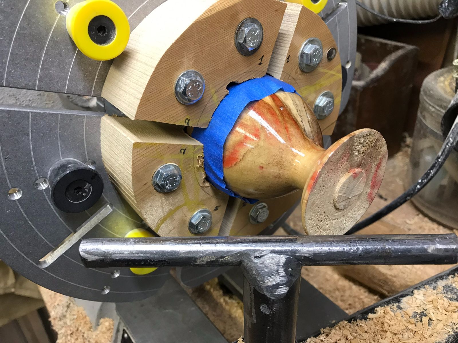

Popular Post lew Posted May 26, 2024 Popular Post Report Posted May 26, 2024 Looks awesome, Fred! Check out the videos from Richard Raffan and his use of scrapers when doing the inside of these types of boxes. https://www.youtube.com/@RichardRaffanwoodturning Also, if you know any welders, have them make you a small tool rest from steel rods. This one I had made at my school in the welding class. The top piece is about 6" long. Makes getting into smaller openings a little easier. Grandpadave52, Cal, Fred W. Hargis Jr and 2 others 4 1 Quote

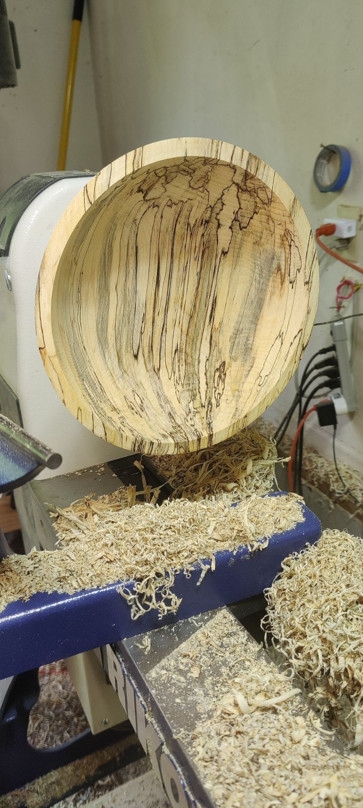

Popular Post kreisdorph Posted May 29, 2024 Popular Post Report Posted May 29, 2024 Spalted sugarbgerry, 11". I'm trying something different on this one-turned bowl. I sealed the end grain with Anchorseal. Now I'll let it dry in the house for a few days. We'll see if the Anchorseal prevents it from warping in a fast-dry environment. Fast-dry meaning it sits on the dining room table for 4-5 days. Grandpadave52, HandyDan, Cal and 4 others 7 Quote

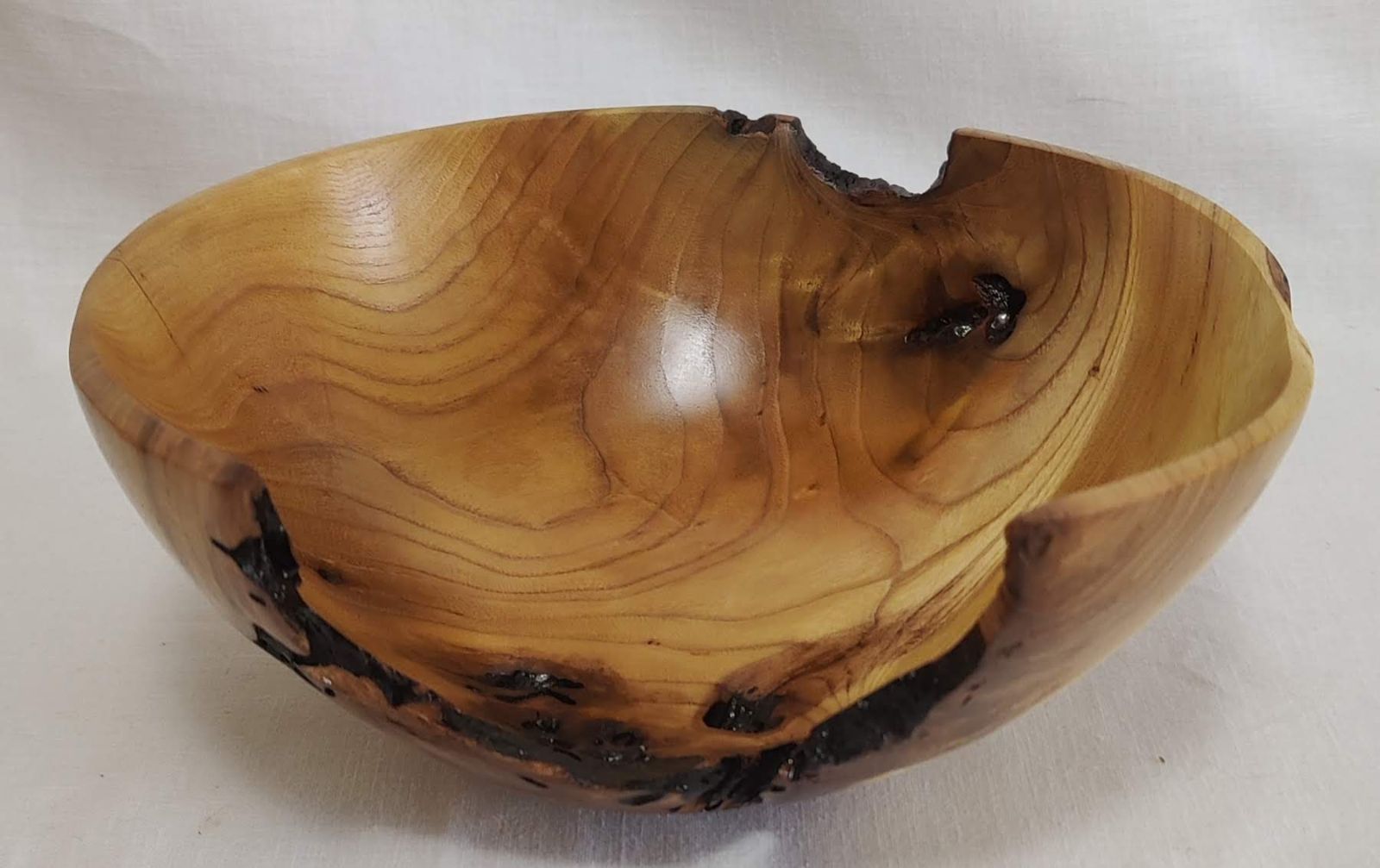

Popular Post kreisdorph Posted May 29, 2024 Popular Post Report Posted May 29, 2024 6 minutes ago, Fred W. Hargis Jr said: No idea, it was in a pile that was unmarked. My mulberry guess was just that I thought Dave had brought it here and I think he said that wood was mulberry. Got it. Mulberry is quite open grained, for whatever it's worth. Grandpadave52, lew, HandyDan and 3 others 3 1 2 Quote
Popular Post lew Posted May 29, 2024 Popular Post Report Posted May 29, 2024 36 minutes ago, kreisdorph said: Spalted sugarbgerry, 11". I'm trying something different on this one-turned bowl. I sealed the end grain with Anchorseal. Now I'll let it dry in the house for a few days. We'll see if the Anchorseal prevents it from warping in a fast-dry environment. Fast-dry meaning it sits on the dining room table for 4-5 days. Love that spalting! Hope your experiment works! Grandpadave52, Fred W. Hargis Jr, kreisdorph and 2 others 5 Quote
lew Posted May 29, 2024 Report Posted May 29, 2024 26 minutes ago, kreisdorph said: Got it. Mulberry is quite open grained, for whatever it's worth. So glad you left the imperfections unfilled! kreisdorph, HARO50, Cal and 1 other 4 Quote

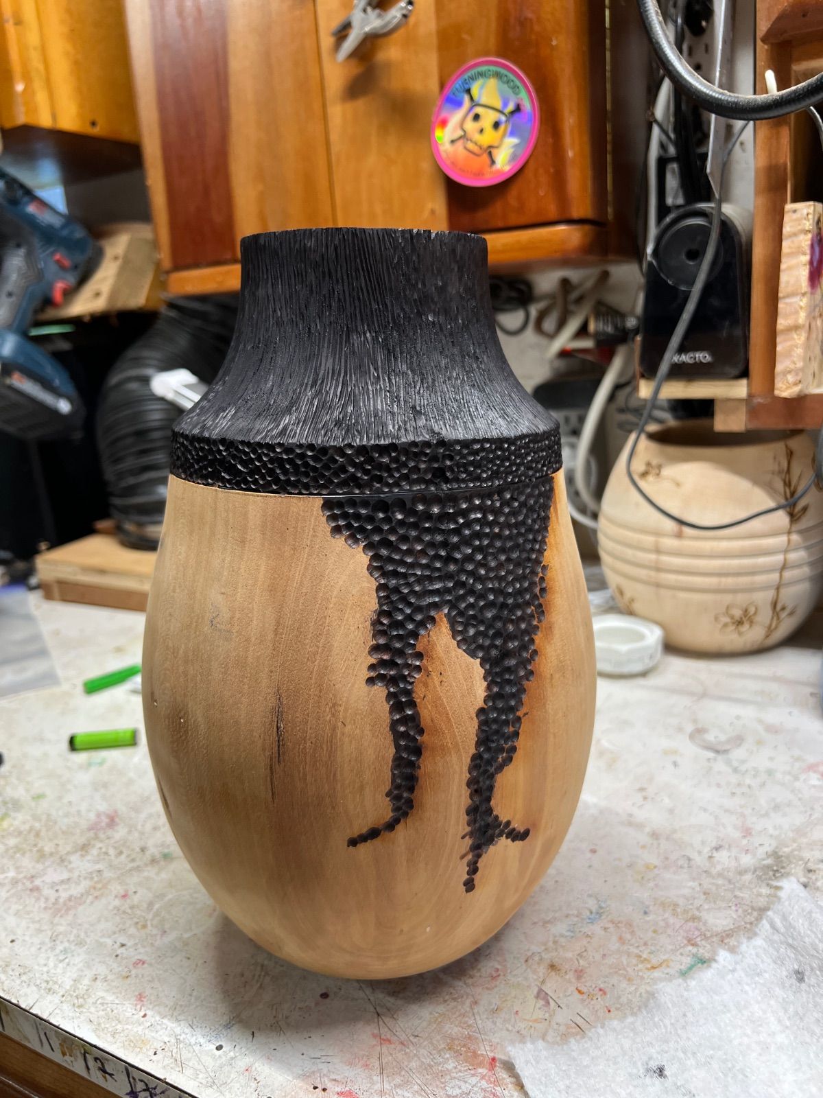

Popular Post Gerald Posted May 31, 2024 Popular Post Report Posted May 31, 2024 Progress on the Urn. Got the time to do the hollowing yesterday. One of my boring bar bit holders is broken so with alternative cutters took a bit longer than usual. It is about 10 inches tall and 7 wide at center. A friend came by yesterday and we got to talking about urns and threaded inserts. He has metal lathe and is going to try plumbing parts and turn them down. kreisdorph, HARO50, lew and 3 others 6 Quote

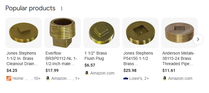

Popular Post lew Posted May 31, 2024 Popular Post Report Posted May 31, 2024 2 hours ago, Gerald said: Progress on the Urn. Got the time to do the hollowing yesterday. One of my boring bar bit holders is broken so with alternative cutters took a bit longer than usual. It is about 10 inches tall and 7 wide at center. A friend came by yesterday and we got to talking about urns and threaded inserts. He has metal lathe and is going to try plumbing parts and turn them down. I've read about using parts from the Borg. Great idea if you have the metal working tools/friends! Grandpadave52, HARO50, Gerald and 2 others 5 Quote

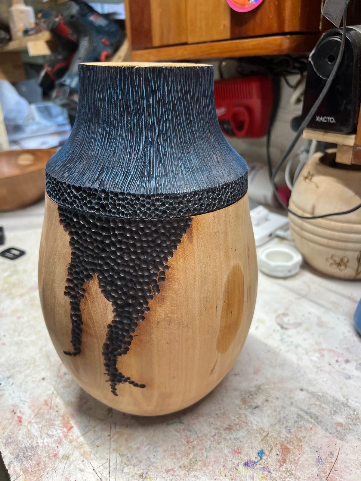

Popular Post Gerald Posted June 1, 2024 Popular Post Report Posted June 1, 2024 Got a bit further down the road today and the lid is on the lathe now. After carving upper portion was dyed black and dry brushed with two shades of blue. The next ring was also dyed black after dots were carved in and dry brushed with a metal flake white. lew, Fred W. Hargis Jr, Cal and 4 others 3 4 Quote
Popular Post calabrese55 Posted June 1, 2024 Popular Post Report Posted June 1, 2024 REMARKABLE simply REMARKABLE ! calabrese55 Gerald, HARO50, Cal and 2 others 4 1 Quote
lew Posted June 1, 2024 Report Posted June 1, 2024 @Gerald, you've outdone yourself! Cal and Grandpadave52 2 Quote
HandyDan Posted June 1, 2024 Report Posted June 1, 2024 18 hours ago, lew said: I've read about using parts from the Borg. Great idea if you have the metal working tools/friends! Trouble is plumbing parts aren't cheap either. This deal you put in a couple weeks ago is hard to beat. https://nilesbottlestoppers.com/product/threaded-rings-for-urns/ And you still need to buy the female thread part. Cal, Grandpadave52, lew and 1 other 4 Quote
HandyDan Posted June 1, 2024 Report Posted June 1, 2024 Love it Gerald! Nice detailing. HARO50, Cal, Grandpadave52 and 1 other 4 Quote
Masonsailor Posted June 1, 2024 Report Posted June 1, 2024 WOW !!!! lew, HARO50, Grandpadave52 and 1 other 4 Quote
lew Posted June 1, 2024 Report Posted June 1, 2024 @Gerald, do you do the "divets" with a burning tool or a rotary tool? Grandpadave52, Cal and HARO50 3 Quote
Gerald Posted June 2, 2024 Report Posted June 2, 2024 8 hours ago, lew said: @Gerald, do you do the "divets" with a burning tool or a rotary tool? Used a micromotor with a diamond bit . You load the bit up by holding it in one place and then it burns the holes. Cal, HARO50, Grandpadave52 and 1 other 3 1 Quote
