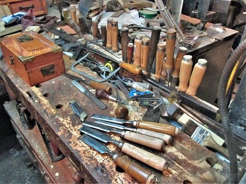

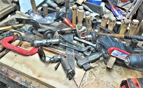

    Ok, latest Project is about ...done. Time to clean up the bench, put away the toys,,,and maybe rehab a few items.. I can finally set this back on the bench....bench is a bit ...full... Over flow from the Tool Well? "Name that Tool"? How do you hang this thing up.... Every shop could use a 4-in-hand rasp/file....but it needs a place to sit, until called for.. Chisel shaped objects, at least the 3 in front...the other was rehabbed long ago...clean, sharpen, and re-do them handles.. May "refine" the other two....Scratch Awls were also cleaned, sharpened up, and a coat of finish brushed on... The rasp was cleaned of rust and crud, pocket knife was too..and sharpened... Anyone want to stop by and help out? Stay tuned..( may build a second row to the back of the bench storage rack....may need 2..?)

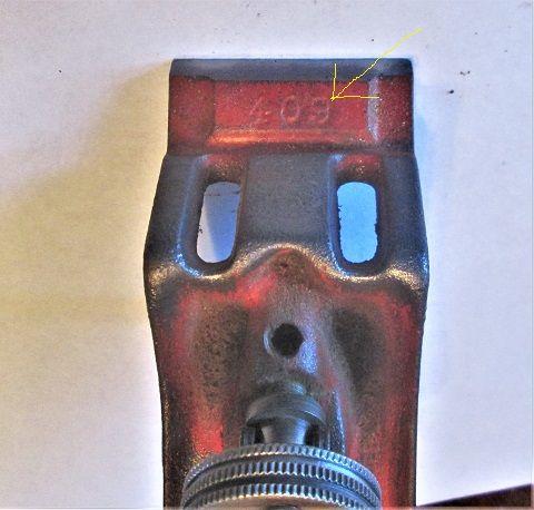

    3 planes...first 2 were easy... Handsome, ain't they...spent about $10 for these three "gems"...In the front is a Sargent V.B.M. #5408/408c (Stanley #3 sized) mainly a lot of wire wheel work, a few spots needed a spritz of PBblaster to loosen bolts up....sole was "groovy" Yeah....refinished the wooden parts...old finish was flaking off.... NOT Rosewood, Sargent used East African Mahogany. Base has a coat of penetrating oil...later was wiped down and a fresh coat of black was sprayed on.. Made about 1917. Metal parts were shined up, chipbreaker mated to the back of the iron. Iron's back was flatten, a single 25 degree bevel was sharpened and stropped.. Test drive showed a few nicks still remained in the edge...will remove those in the next sharpening...meanwhile The second plane is a Stanley No. 4, Type 20 (1962-67) with the dark, Royal Navy blue colour scheme... This spot was packed solid in nasty wood fibres, spider nests....and just plain dirt...wire wheels and wire brush to clean out... Lever was frozen in place, both of them ( Goop-off soak, then oiled) Grinder has a 6" brass wire wheel installed... Been sitting a while. Edge was chewed up a bit...new grinder to regrind the 25 degree bevel needed....then 2 oil stones, 2 grits of sandpaper (1,000 and 2,000 grit) then stropped on the buffer wheel on the old grinder.. Bolt for this wheel was wire wheeled clean, along with the rusty stuff. Brass shined up, dab of oil on the threads... Same with the rest of the metal parts....plated stuff was buffed out. Threads cleared and oiled up...test track set up..again.. BTW...The flaky black paint of the handles? Gone, replace by a coat of Gunstock stain, and then a few coats of BLO... Test tracks, one of Pine.. Took a few tries to get the setting just right... And, since I also do a lot of work with Ash.. 1 x 2 is now smooooth and flat.. Looks more like a plane, now. I left the yellow logo alone, the cleaned up Royal Navy Blue was given a wipe down with a thin coat of 3in1 oil.. Which brings us to the third plane... With "Issues" Lots of issues... Made by Millers Falls, sold at your local Sears store as a Craftsman....turned out, this plane had been broken in two...then brazed back together... Wasn't too bad on the right side ( biggie blob inside, though) but the left side? Not his best work.....checked that sole for flat....was more like a banana, or, high in the middle, low on the ends ( OHIO?) well, we have a beltsander, with 60-80grit belt onboard....took a long time (for me) checking with a straight edge every 5 minutes ( and let the cast iron cool down a bit...) Finally..other than a hollow up front, and a little spot on the "fantail" I think I can live with that...flat the rest of the sole. All this done with the frog and handles still in place...the frog? Needed a soak, and a hammerdrill, to loosen two bolts. Frog was too far forward, made it hard to fully engage the slots in the bolts. Once they were loose enough, the frog was slid to the rear..then removed. End of troubles? Nope....took the wheel off, or tried to....got almost to the end of the threads...bolt had come loose, too.....Backed the bolt out of the wheel, clean the rusty blob out of the threads. At least it made it easier to clean up the rest of the frog.. OEM chipbreaker was too rusted on the end..tossed it, found a 2" wide spare....mated it to the cleaned and straighten iron. Iron was bent, curved, pitted...Ball pean hammer time! grind the pitted edge away, started a new bevel. derusted the now straight iron. Back is NOW flat... Cleaned the hardware..brass had been plated..had. New spritz of blue into the logo...then wiped away the excess.... I was going to sharpen the iron...noticed the cup of water was empty...and, I was covered in cast iron grinding dust...even me beard was black...decided that was enough, closed the shop. The Sargent plane took a couple hours, took longer to sharpen. The Stanley? 90 minutes, total....The Craftsman? still working on it....will be a while.. Stay tuned

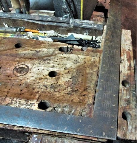

    A while back, like last spring or so...I picked a framing square for about a $1....little on the rusty side.. Flip it over... Nothing was bent...might be worth the effort to clean up? Took some 60 grit paper, and gave a spot a rub down by hand.. Might be ok....80 grit in the palm sander.. Getting rid of the worst of the rusty stuff...except down in the lettering...switch to 220 grit, one "pad" per leg, on each face.... We getting there...wipe each area once it is sanded...then a bead of 3in1 oil, and wipe that around with a rag.... Looking better? About 99.9% of the markings are readable....square should be about ready to go back to work? At one time, one could lay out every cut and build a house, using just a square like this....might be a lost art, now-a-days.....

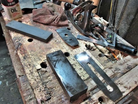

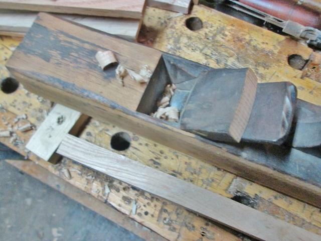

    One of the "treasures" brought home from Wapak.. I've already rehabbed the Defiance plane, and cleaned the drills up...which left that wood bodied Jack plane... Needed a blade/iron/cutter.....Well, I did have a chunk of decent iron handy.. This is the half that is "leftover"...went back as far as this was flat....used the grinder to cut a deep groove.. Because this chunk of steel was laughing at my hacksaws...got as deep as I could, then snapped the "good" part off. Beginning to think someone had re-worked an old lawnmower blade. More grinding.....beltsander......more grinding...wound up with an almost flat "back" and a cambered bevel... 2" wide iron....could have been a tad wider. Will work on the sharpening later... Had to trim the wedge a bit....will refine the cut later. It was sticking up further than the iron was. Finish the sharpening, may see about tightening the handle a bit...finish the wedge a bit..will do for now. May try to find out how thick the iron is..... Stay tuned....

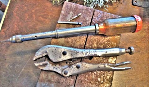

    We have work to do...
    Well, Stopped at ONE garage sale.....Spent a bit over $15...Picked a pair of straight jaw Visegrips, and a "modern" Yankee drill... That had 3 drill points. That was the $0.50 of the $15.50.....and I almost drove off without these two..why? A COMPLETE Stanley Mitre Box with it's OEM saw...had to take the saw out, to make things easier to cart around... So....in order to do a rehab on this new "toy", one item needs addressed... need to put away all of this mess....including those freshly cleaned up bits.. other end of the bench was worse..( board was to test how sharp the saw is....VERY sharp...) Took maybe 10 minutes to go from this mess...to... I think I can live with this... That Disston saw... And, when I cleaned the spine up, there was another Disston & Sons stamp. Took the Brass out, and shined them up. Saw is 26" long, not counting the handle..and WAS 4" under the spine ( now about 3-1/2"..) which makes the Mitre Box it goes to a #246, or a #346 model. IF you look at the bottom of the guide rods, instead of a square block, there is a split cylinder. Both stock rests and both stock holders are there...was missing depth stop back here ( had one in me spares box) Afraid to look under the top deck, and see what sort of shape the main deck is in...No name plate showing Model number.. But there are 4 patent dates, all from 1904...There was one item to replace.. An old break..and I had a replacement in the spares box...Decided to soak the moving parts in PBblaster, since none were moving....got rid of the plywood deck... Well, well, lookee what I found. Those stock rests ( for doing crown molding) These are OEM, OLD ones..they have a small button to keep them from being pulled out too far ( and lost) But, if you take the rest and that thumbscrew and holder around front... That same thumbscrew threads into the metal disc in the deck...and you have a length stop for repeat cuts...Shook up the can of PB..and gave things a soaking... Swing arm did not want to...swing...let this soak for about an hour, gave it another try...was able to move it nicely enough...details? One, in addition to the numbers on top of the quadrant, that show the number of cuts for a given box ( 4 = 4 sides = 4 cuts= 45 degrees) there is a scale along the front edge.. These are degrees. There are detent holes under all of this, to lock the saw in place for the cuts... Still evicting spiders...That HUGE slotted "bolt"? is not a bolt..notice that little hole in the slot? There is a tapered pin in there, when you install the guide rods into the arm, you tight a bolt at the end of this pin. It spreads the slot, and holds the guide rod assembly in place. You can also see the detents the swing arm locks into..other end of the swing arm turns on a "King bolt"... Which I may need to remove, to clean and repaint everything that needs painted.. Intent is to make this Mitre Box & Saw look like the day Mr. L Millice bought it...Saw has been cleaned up....box has been taken down to the bench....need a bowl to toss cleaned up parts in, and a new 6" brass wire wheel for my grinder....and a 3/8" thick plank of Poplar, 6" x 24" Project wood. old wheel sheds worse than a sheep dog in August... Stay tuned...

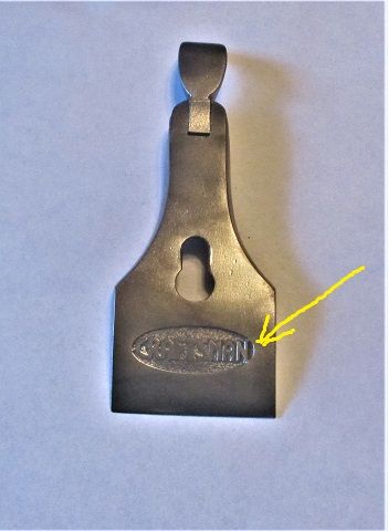

    Not enough lumber to start another project....might as well keep going with the rehab stuff.... 5 planes...some parts were cleaned up, and given a new coat of paint. Threaded items were cleaned off, and oiled up. Decided to work on the red plane Sole is now as flat as I am going to get it. Like the hanger hole This was the easy one...we also have the "Bad".. And the "Ugly"...to go along with the "Good" Yeah....Ok, iron was flattened on the back, honed to 25 degrees and 2,000 grit....then stropped. putthe plane back together Sold by Geo. Worthington Co. of Cleveland, OH. Apparently, this is a made by Stanley #220....Iron is stamped as a Worthington W2200. Pine test track, had to rotate because of grain direction.. Rub a bit of wax of the sole, set the depth and lateral...seems to work. which leaves.. These 3 for tomorrow. Label claims to be a Defiance, by Stanley. Then there is that other plane.. Ummm, yeah. 9-1/2 knock-off. This might take a while.. Stay tuned...

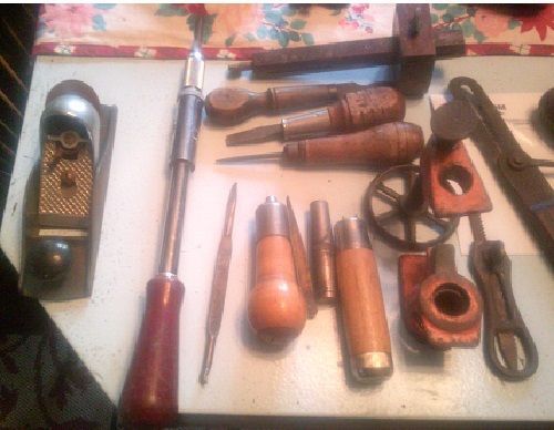

    Because, I had spent $7 the day before the Mitre Box find.....soooo Price tag said $8...bought it for $6...needs a little TLC? There were a few "Gems" in this mess... 2 countersinks, 2 screwdriver tips, and German "center" bit... A #20 bit, and twist drill bit...and a Irwin No. 21 expansive bit..without a cutter I think I could use the one in the #22...but not the #1... Inventory? I cleaned a few, to ID them, but.. The 3 off to the right? P.S.&W. Co. Smallest of the 3 is a #8...8/16" That one in the center, with a slightly different flute pattern....Bates A very Motley Crew? Spade bit, with hex shank, no spurs...Concrete bit...piece of the carbide insert in gone ( junk) Somehow, I doubt IF the twist drill is a #12.....as 12/16" is 3/4"...as for the cut up bit? Methinks this were for a 3 jawed Breast drill, or hand cranked drill press... Those other gems? had a few like them, so cleaned them all up.. Smallest bit is a #4, the Gimlet is 3/8", the center bit is 5/8" I now have 4 countersink bits, and 3 screwdriver tips,,,should be enough, for now.. Box needed cleaned out, in more ways than one.. 1/2 rust..1/2 gunk....soaked it in Oxyclean overnight, this morning a HOT water rinse and let it sit out in the sunshine to finish drying out Outside was dried off....and given a "Basic Black" finish... Letting that 85 degree sun bake the Rustoleum....Might have a couple handles, will see about a latch... Wire wheel to clean the bits....rather a bit messy...have to also watch so they don't catch in the wheel... stay tuned BTW: the $1 extra? Atkins/Sheffield panel saw... Cut out the glare... Will tackle this restore, after the bits are done....

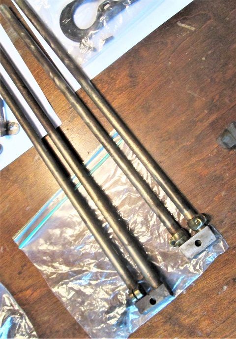

    A friend dropped off a "project" for me to rehab.... The rest of the parts were in a bunch of baggies.. and these.. and.. Lots of tiny parts....and not all the parts were there.. Lever to unlock the swing arm... Guide rods attach here...block for the front set is MIA. saw guides. assembled on set.. These slide on the rods, and guide the saw. Newer models had roller bearings... One bag had just 4 bolts.... To install the feet with. There is also a dozen small wood screws, to attach a wooden "deck" to the metal frame. Been about 3 years since I last rehabbed a Stanley No. 358 Mitre Box... Trying to remember which part goes where....and, this was a newer model, than the one I am now working on.... Need to buy a 1/2" thick Poplar plank....something about iron vs Oak (or Ash).....there is even a few wood screws, to attach the box to a bench. Might take a while to get the latest version rehabbed, and making sawdust. Stay tuned..

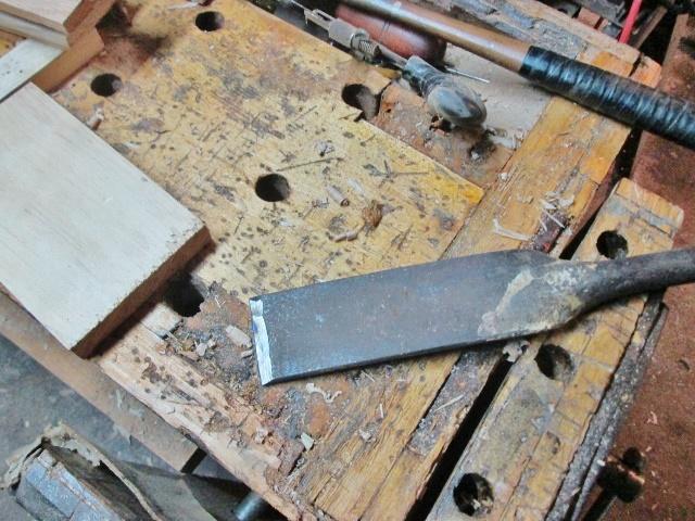

    Ok, awhile back I picked a plastic tub of tools and such....in one of the many "layers" of toys in that tub, was a chisel shaped object. All metal, mushroomed tip, must have been hurting, tip is all red... Well, finally some free time in the shop, got rid of that mushroom.. Could even read all the writing on it..."Made by Crescent Tool Co." "Jamestown, N.Y." No. 175 1 1/4 Made in USA Hmmm, that might take awhile....bevel had a 40+degree angle to it, and was skewed.... Took a large cup of water to the shop, and set it right beside the grinder. VE Haft Werk to do..... Looking better, now. No attempt at a bevel..just straight in. And dunk it often. Once this was straight, I could work on a new bevel...at 35degrees.. And made sure the back was flat.. Will do....then the stones and papers.. A very coarse stone, until a wire edge showed up.. Bench dog to keep things from sliding away. Medium stone..600 grit..then the fine stuff Set each paper, 1000 grit, 1500 grit, and 2000 grit right on the stone. Sprtiz of WD40 on the stone, and the paper...then the leather belt strop, loaded up with the green compound... First test drive.. Yep, it will curl some shavings...but, this is not what this chisel was designed for...next test drive.. Say this is a floor, or ceiling joist, and you needed to run a water line, or electric lines through it...rather than drill a hole that may or may not fit..just chop your way through.....including through lath with brown coat, joists with nails..this chisel will cut through....and that be the hammer most often used... These were sold with a shiny blade, a blue/black handle, and a red top.. Just like new. Might have to find a use for this one, around the house...
