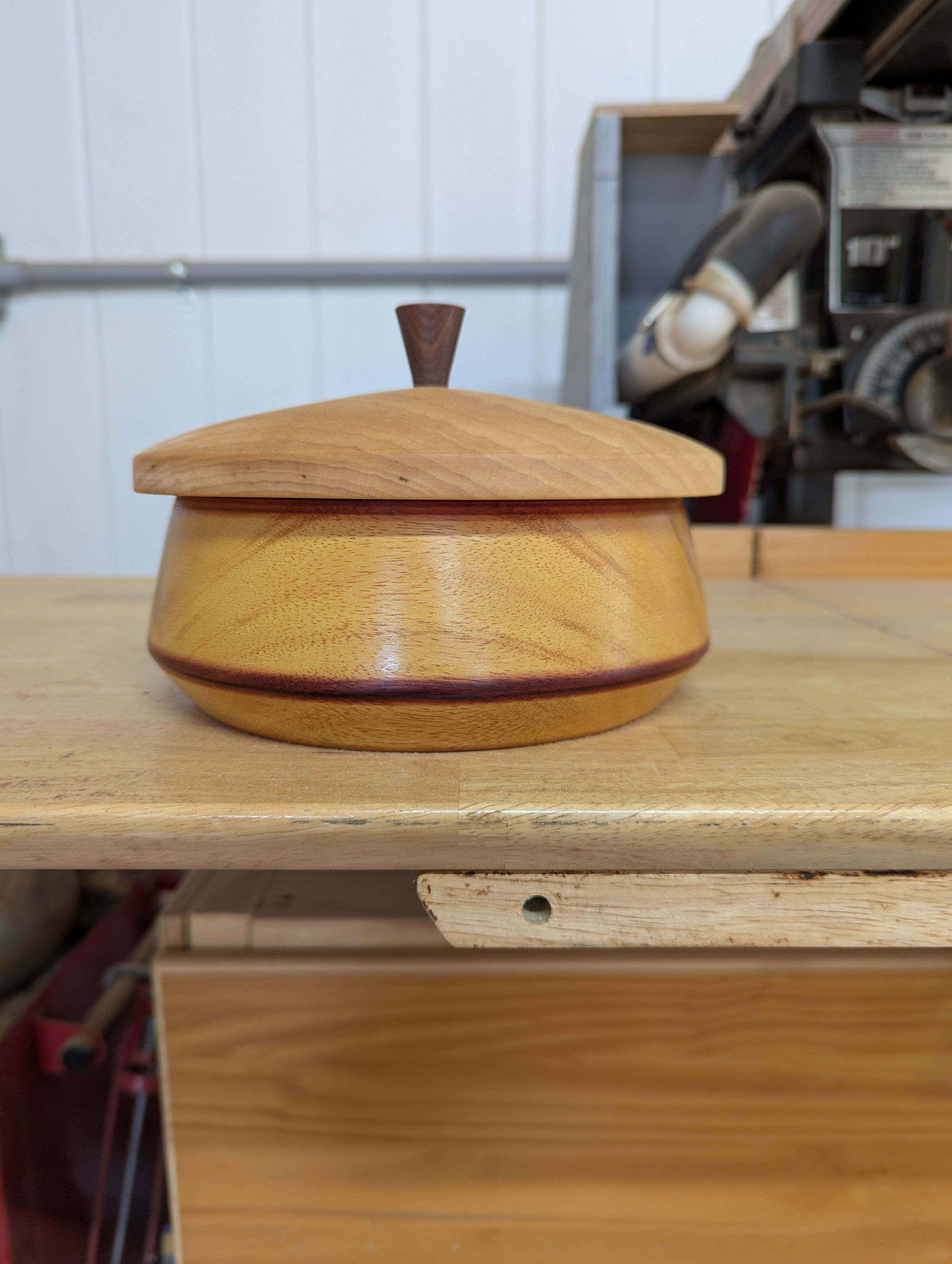

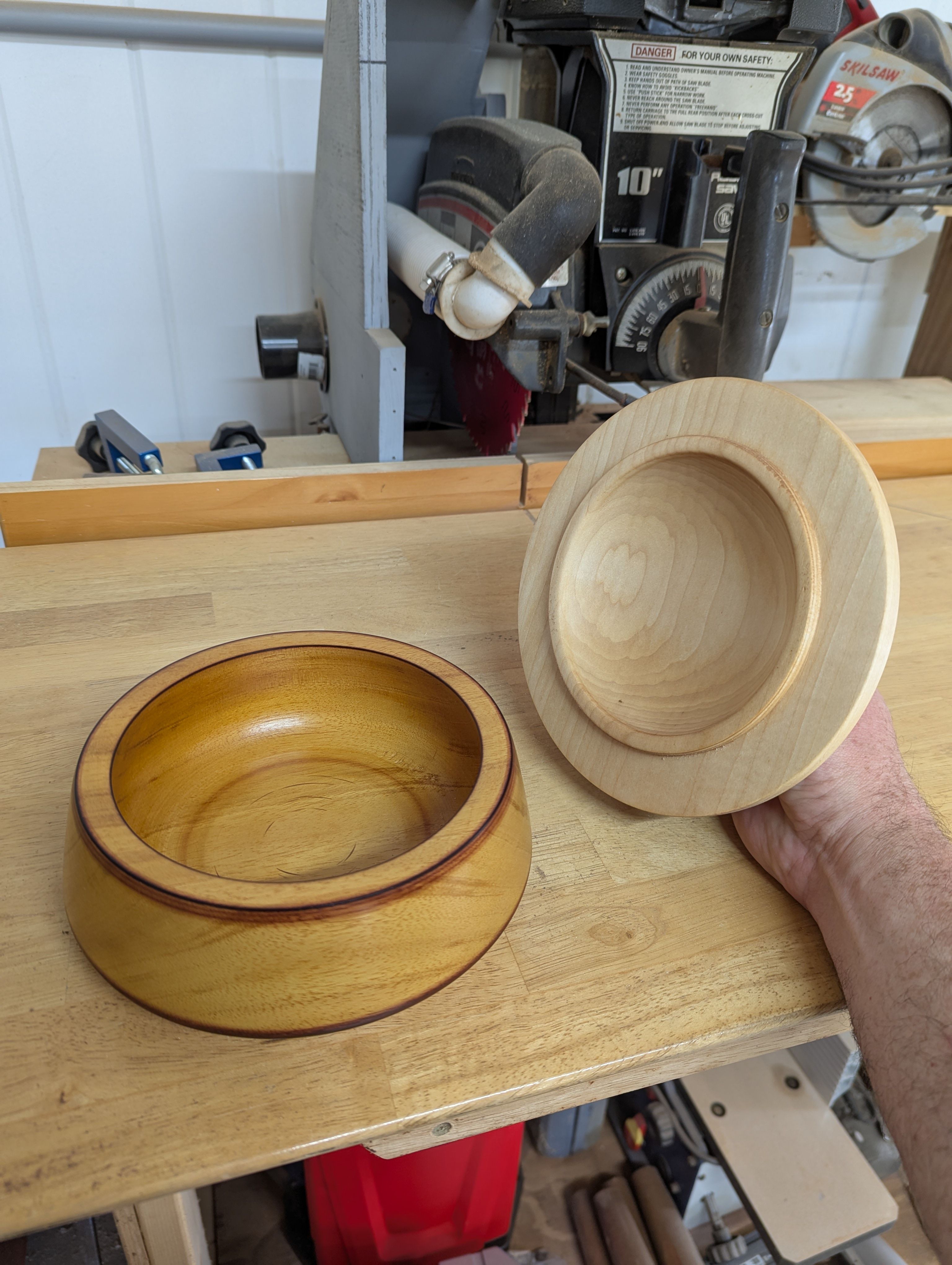

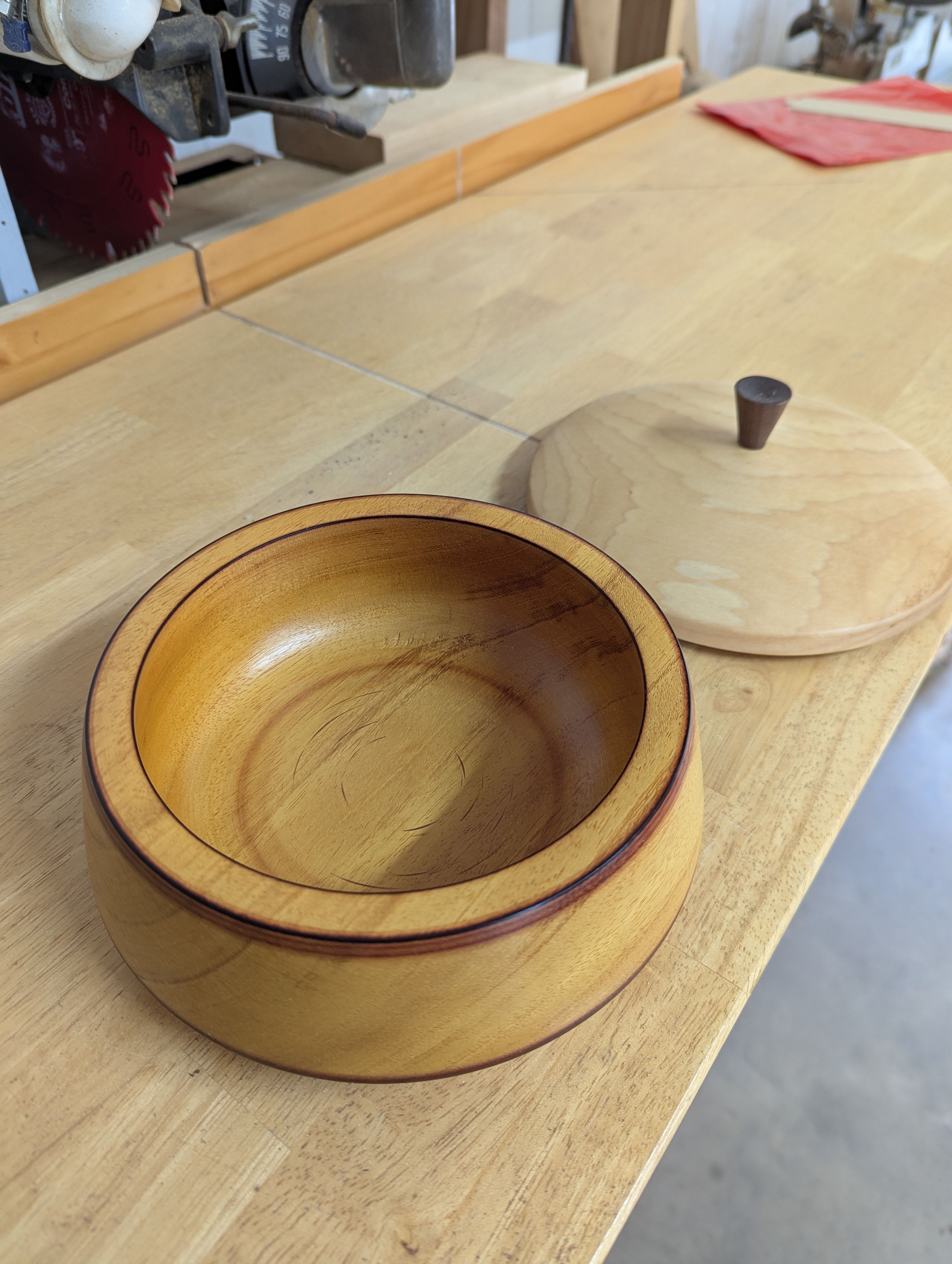

This is a piece of Orange Osage. (Even though it's yellow. Lol) I'm not real sure what the lid is. It doesn't really match the pot in my opinion but it was the only piece I had big enough for a lid. Walnut handle. The burning in the middle happened by accident but it looked good so I did a couple around the rim.
Love the burned embellishment. How did you do it?
It was actually a happy accident. I was applying some natural beeswax so I sped it up to 2000 RPM to help it melt and soak in the wood. I held the cloth just a bit too long and the wax got a bit too hot. It was right on the ridge of the angle transition. It looked good so I did it again on purpose around the rim.
Excellent recovery from the "accident." I really like the look. A very classy looking piece. Glad you're keeping busy in the shop.
Nice loooking bowl . A handsaving tip. Never use a rag on a spinning object on a lathe especially at high speed. The reason : if then rag catches your hand will be wrapped around the object  and it is a guranteed hurt. I suggest if you plan on burn lines in the future (I know this was an accident) use a wire with handles , not wrapped around your hand.
Thanks for the tip. It's good to know there are people out there that care about others. I never use complete rags. I cut old t-shirts up into 3-4 inch squares and fold them over.

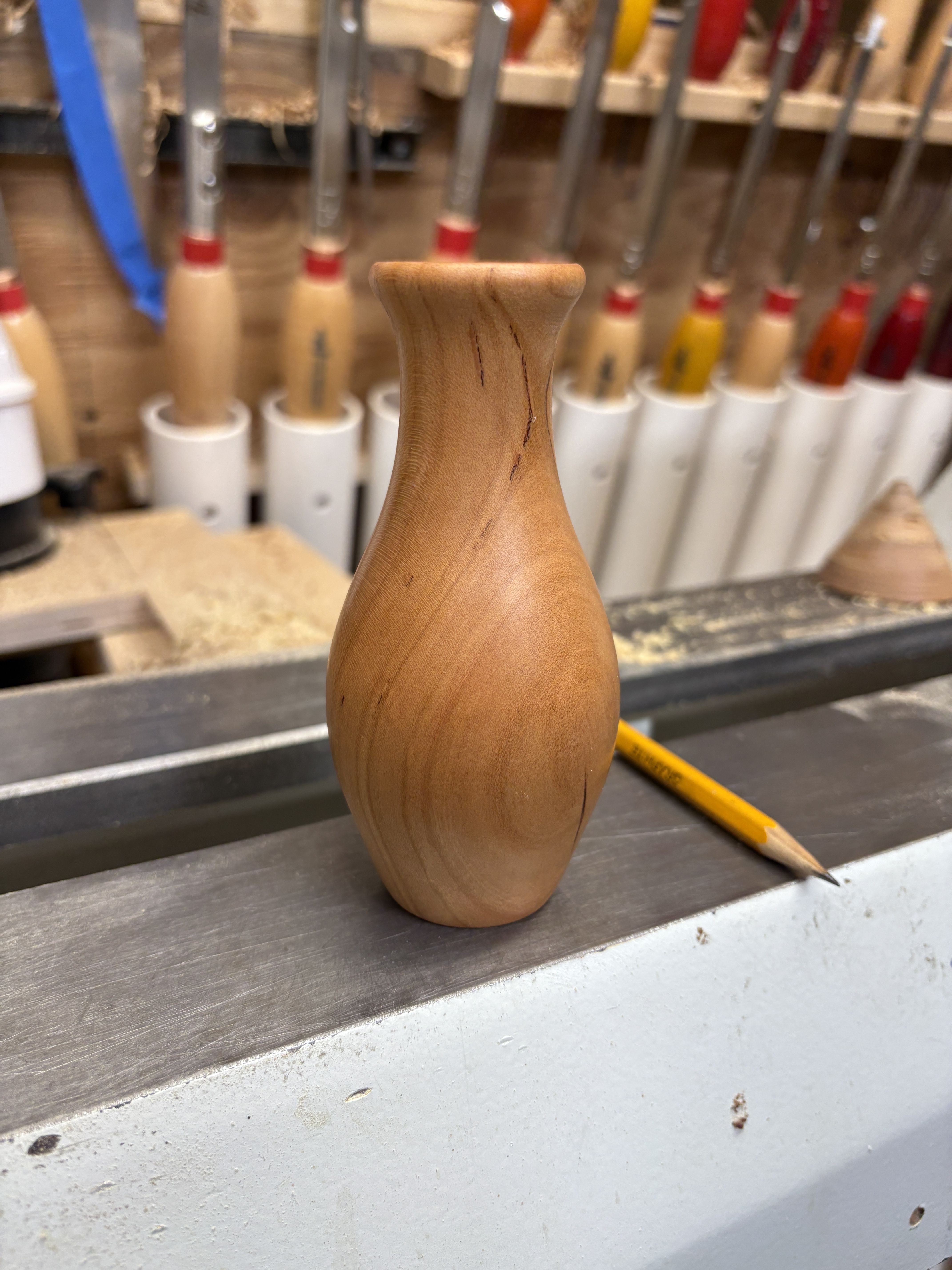

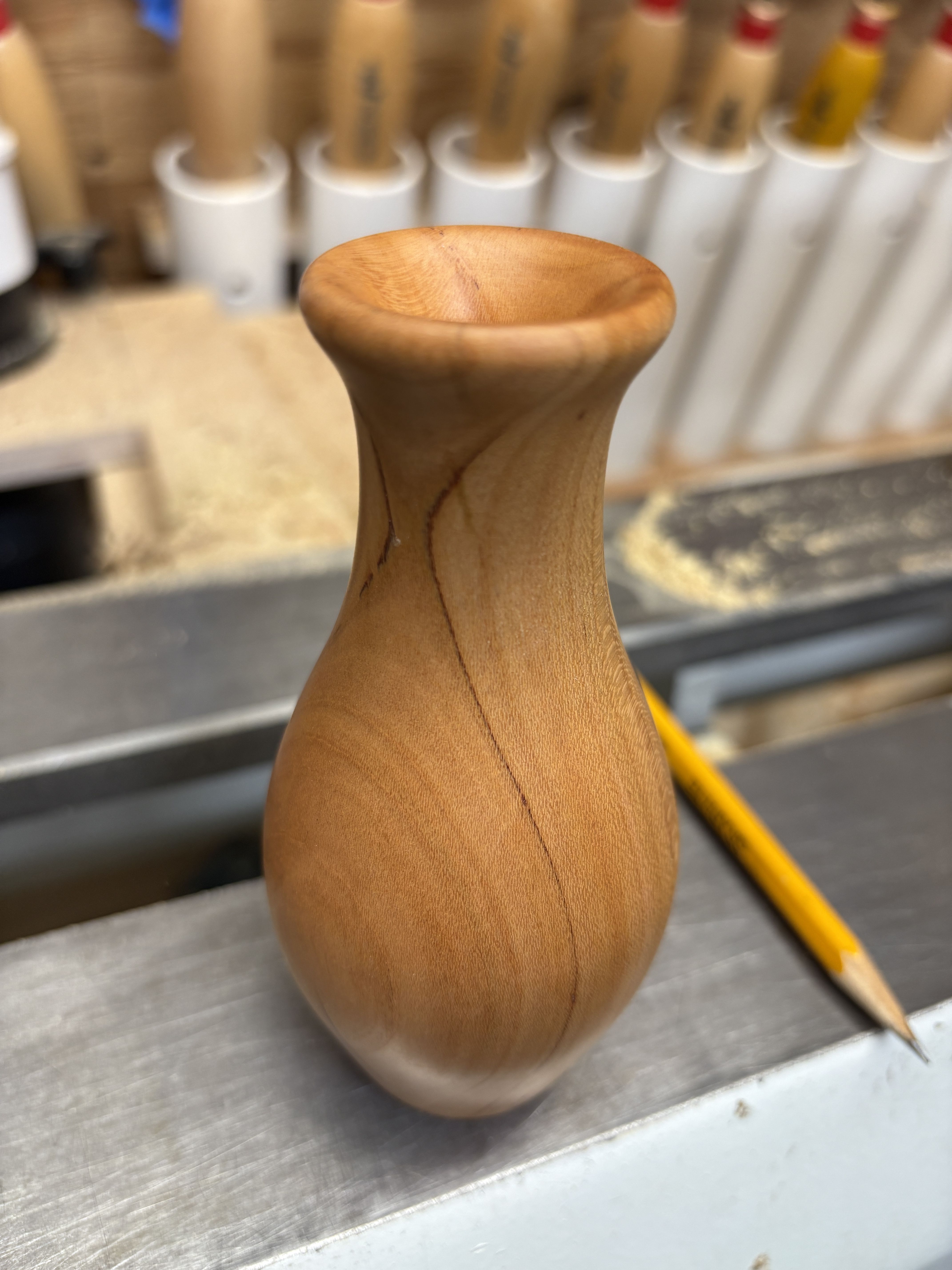

Little cherry hollowed vase. Slightly under 5" tall and a little over 2" at the widest point. Wall thickness about 3/16". Beeswax/mineral oil finish. Turned entirely with Easy Wood Tools products.
Nice grain pattern Lew. Simple but elegant design. Nicely done.
Nice Lew.  I like the shape.

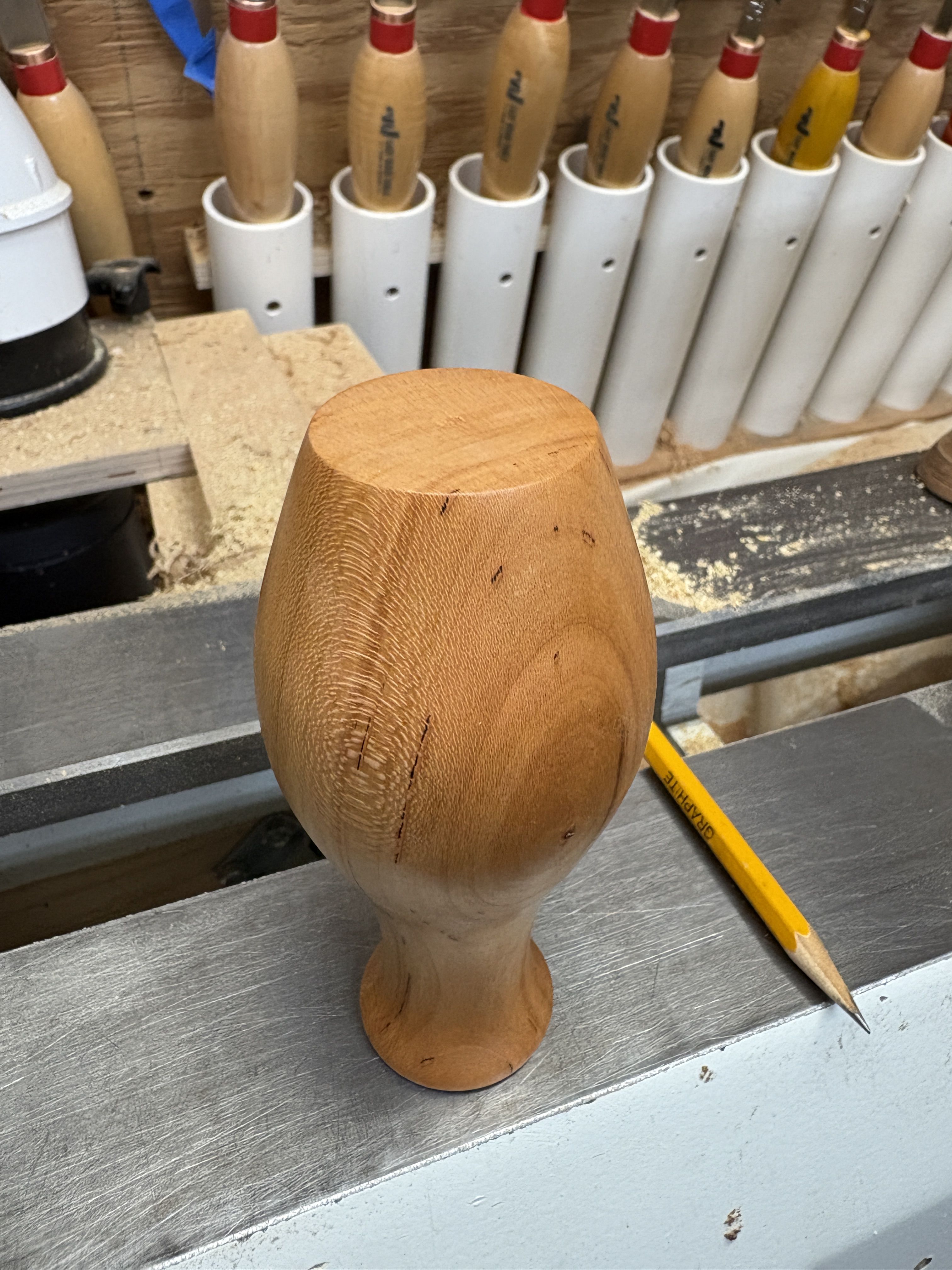

This is a piece of Orange Osage that was supposed to be a bowl but I turned the bottom too small. It would have been easily tipped over so I turned a Walnut base and turned it into a goblet of sorts. I think some of my best work comes from unintentional mishaps.
Another great save Donald. A pedestal bowl of sorts; really cool actually. It'll make it easier to scoop out a handful of M&M's.:P
Love the design!  Those two species really look fantastic together!
Thanks, I agree they go together well.
