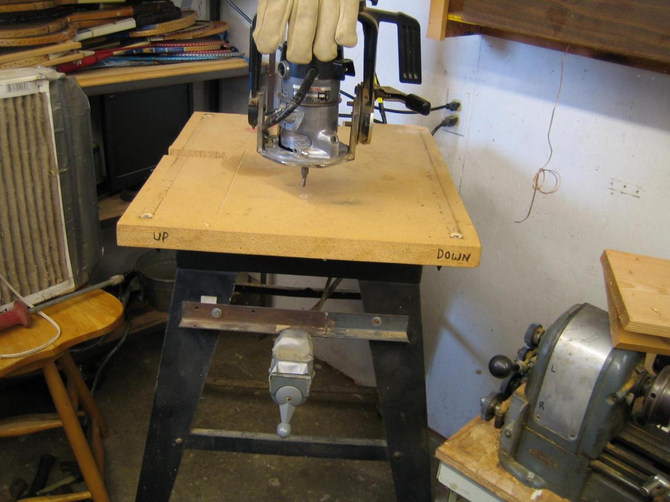

    Not a foot switch, a knee switch
    I took the saw off the Dewalt radial arm and built a plate to hold a router. Next I used a geared down forward-reverse motor and put it in the place of the hand crank back on the top rear that use to raise and lower the saw. I then mounted the forward -reverse switch under the table in front so I could raise and lower the router with my knees as I held the wood I was working on... So instead of on and off, it raises and lowers the router.. I quickly learned I needed some help so I wouldn't forget which knee made it go which direction...the reason for the up and down on each side... The glove is there to keep my head from banging on the end of the arm while concentrating on what the router and bit is doing. This set up did take away trying to free hand a router on certain task...

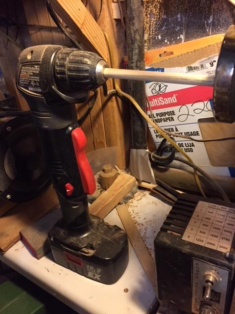

    Slow variable speed set up
    For some time I've wanted a slow speed on my Jet mini. About a year ago I purchased a light weight 18 volt drill, I really like it and quit using my old Sears drills........just to heavy and the batteries don't stay charged. I was recharging one of the old ones and walked by my lathe. I wondered, can I adapt this old angle drill to my lathe. It was almost a perfect fit with a dowel in it. I shimmed the lathe and it works perfectly and has speed adjustment. I've only got to use it once and really like finishing my work. It is not lined up or inserted in the picture
