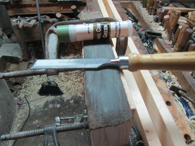

Old work belt I use to strop sharpened edges.  Green stick to "charge" the surface.  Ok..put all of this out of the way.   Mark the two side blanks as to inside, top, bottom and back..clamp one to the side of the bench..

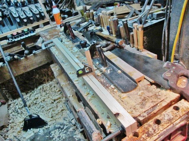

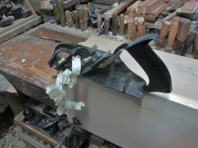

And made sure the Wards 78 was set up just right ( was set a tad too deep.)5aaa8f4e134db_rebatework.jpg.5bf7e6a6ceba3544df7ccf0a2ea95238.jpg
If you don't have a sore left thumb, you ain't holding it right....That shaving is 3' long, made a mess on the floor..

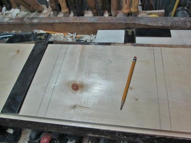

Need to figure out the blank for the raised panel in the door, again...depends on the width of the face frame, plus the width of the frame for the door.   Have two of those "freckled" boards left,  will add some plain trim to accent the fancy stuff...

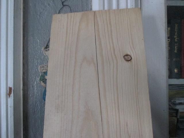

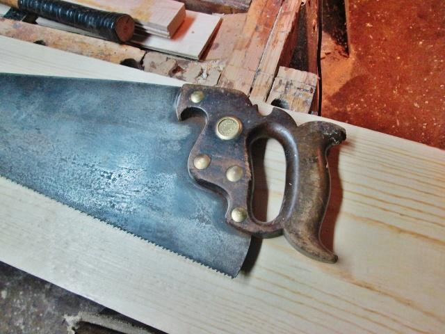

Today's follies......Plank was hauled to the shop....found a clear stretch that was long enough to make the top of the bookcase with....thought I'd try a different handsaw..
About an inch into the cross cut..it was clear Mr. Richardson needed it's teeth sharpened up.....eh, not today, ok?   Went back to the Disston
Operator still needs a bit of practice....needed a 1 x 4 cut the same length.   need the extra width for the top's overhang..Once that was cut, time to joint a few edges...
Clamp the two together, where the matching edges will be.   Once done, I can swing "shorty" around and onto the bigger one, like a book..
Bead of glue, moosh the narrpw board around a bit, until I feel it "stick", then a few clamps and a caul..

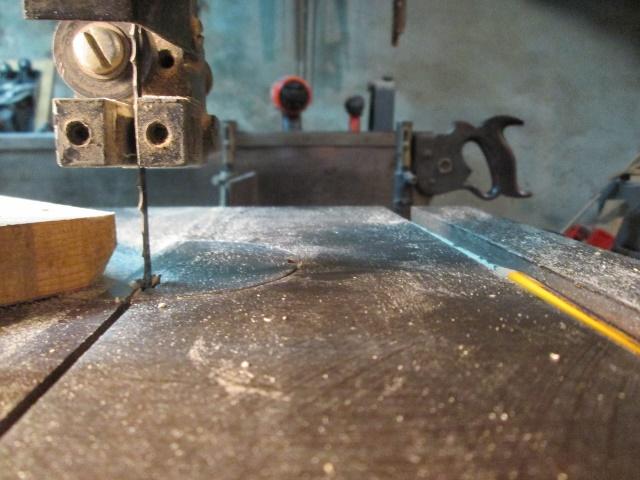

Then set this mess aside.   Needed to set up the bandsaw, needed a few 1 x 2 pieces cut, from the remains of that knotty board...
Needed to reset the rip guide, and move a few things out of the line of traffic,,,,first rip cut, set to 1-5/8" width, was too bad....marked the second cut..
Was having issues with following the cut line..finally the blade hopped off the wheels.:angry: I seemed to think I  had broken the 1/4" blade...so I went old school
I have three such saws, this one seemed to do the best following the lines.   Disston made for Sears, Craftsman Special Edition saw...

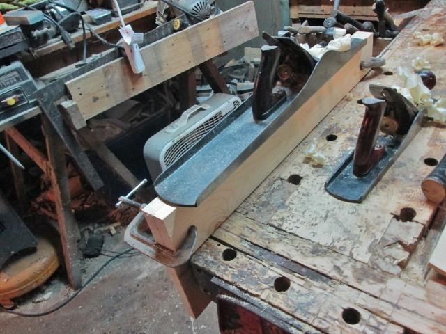

9 minutes ago, steven newman said:
used that panel to show how to use a plane to level a panel.
You need to get more students...you could even charge them to level your panels with fixing their planes:lol:

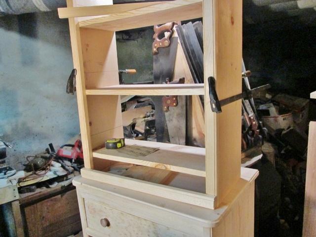

Changed out the bandsaw blade. Ripped a 1 x 4 down.   Ran this thing around..
Actually..I ran both of these....ran a #22 bead cutter around a few parts..
Also this morning, figured out how wide to make the top of the case, and ripped the extra off..
Clamped the stiles in place..
Had to move things around a bit.   needed a bit more room for my fat body....I wanted to mark the rails for length..5aad9f4dc4617_laidout.jpg.c57f0d98f29613fd40acf1e3286a2647.jpg
Better too long, than way too short, eh.    More layout lines, and a bit of work at the bandsaw..
To make these ends.    Then use these to lay out and cut the stiles..
Then dig a few holes..

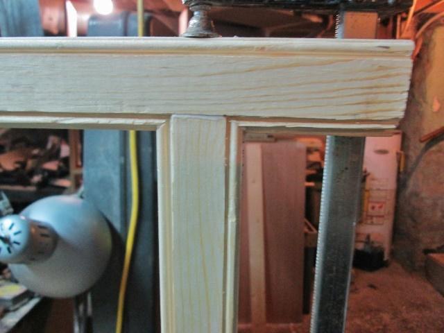

Until a test fit..
Close...got all four joints done, and a dry fit..
One tenon was a hair too long.   Trimmed that  a bit....then spread some glue and added a few clamps
Will let this sit awhile.( while I peel glue off my fingers:rolleyes:..)  Joints looked decent , enough..

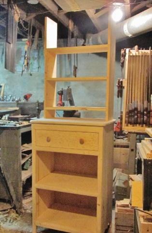

Not too hateful?     As for those sliding dovetails...
No glue was used on it, either....I might be getting the hang of these? :rolleyes:

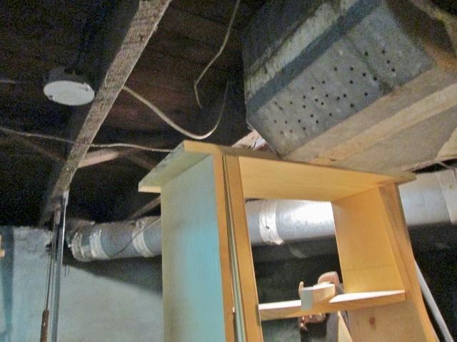

Need to finish the top, and install the back panel.....and install this face frame....maybe tomorrow?
Stay tuned...
Whew...I'd say you had a pretty good day.
Looks like you've about maxed out your shop height with this one.
That double bead detail really steps this project up a couple levels.
I'll be here for the next installment. Little else going on.
