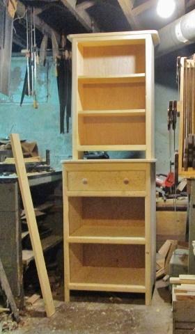

    Quick workout in the shop, today.....after the errands the Boss wanted to run....shot about half a day..   Apron was hanging in my way.. Yep, I know it is mine... Guess
Weather turned nasty, Boss changed her mind about going out....got bored ( dangerous?)  and tried a little shop time:rolleyes:

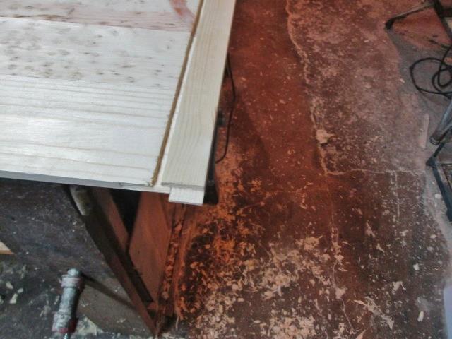

Needed to cut this down a bit.   Didn't want to drag the circular saw out...this saw should do the trick...:ph34r:
Not enough hands right at the end...at least it cuts straight.  Marked it for another cut..

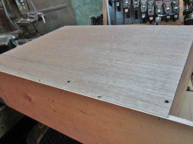

This thin strip I can do on the bandsaw.   Somehow got the shelf unit onto the bench...
Bead of glue along this edge, a few screws.  Turn this around, pipe clamp to pull things square, add one screw.   Clamps to pull the sides together, add more screws..   Back is done.   Set this aside,  cut some corners..

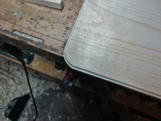

1/2 pint can for the radius.   Bandsaw to cut the corners round.   Then decided which face looked the best, and added a cove detail..

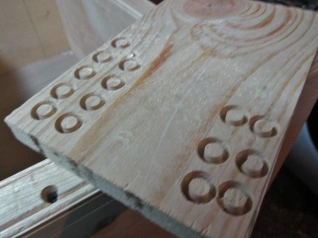

Sanded the "H" out of this.    Set up to do some counterbores..
From one "Vintage" drill to another...

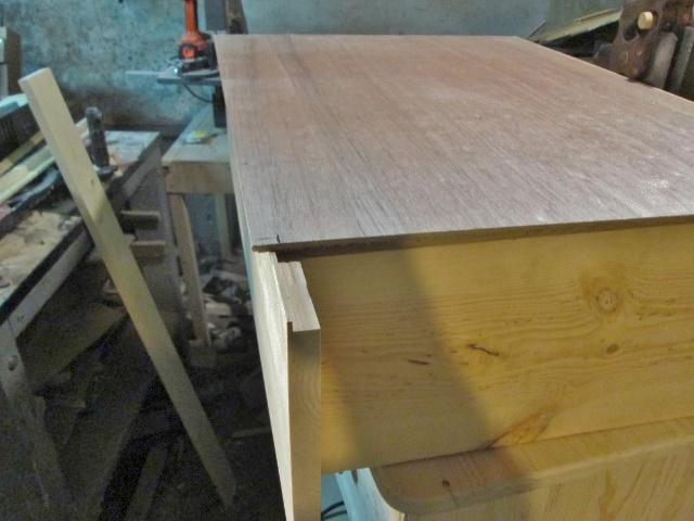

Counter bores and pilot holes.   Attached the top with a few screws.    Had to make four more plugs...installed 8
if'n you are looking for the cove..it is on the underside....unless you are 6'8" +  you will not see this area....
Maybe I can attach the face frame in the morning?
Then start on a door?  stay tuned:ph34r:

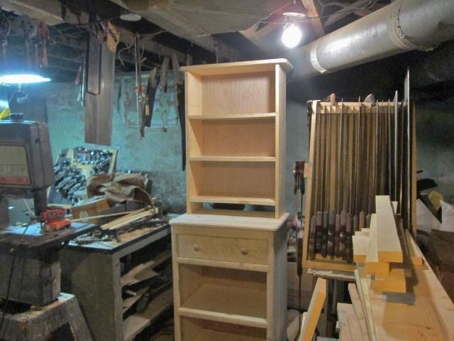

Ok, managed to sneak down to the shop, today....didn't have to drive anywhere...

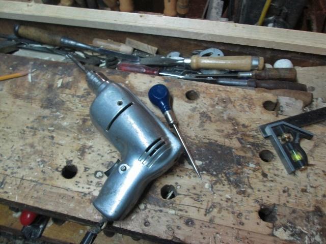

Got the face frame out of the clamps, marked out where to drill a few pilot holes.   Got out the Vintage drill..powerKraft.jpg.573250e710d3d16a7e4da9cf3c4da895.jpg
Scratch awl and a square, to give the forstner bit a starting point.  Laid the frame on the bench..5aaefdc1dcffd_screwhole.jpg.72b69740d757379c798480e259c70b67.jpg

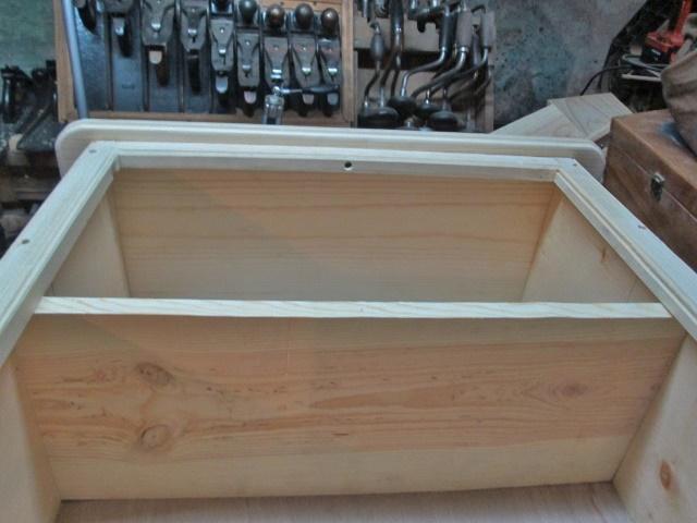

Then drill a pilot hole.  got these done, set the frame aside..got the bookcase onto the top of the bench:ph34r:
I added that top hole, to tie things together.  It just gets a countersink.   Bead of glue, add the screws...had to pull things into alignment, sides wanted to curve outward a bit.
Close as I could get things.   Add a screw to keep it there.  Finally got things screwed down.   Made a new batch of plugs..

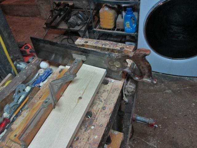

That 1 x 4?   I need to cut it to length for two stiles.....couldn't get TO the Langdon Mitre Box, sooo.
Bandsaw to get things close.  Needed a bit under 31" in length.   Marked a line, and used this thing..

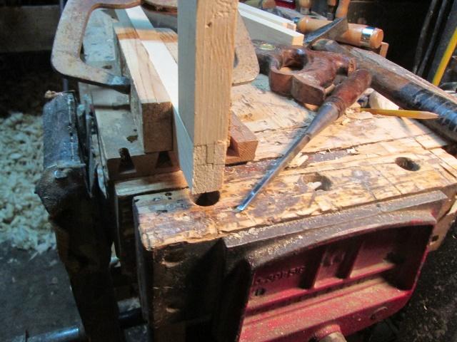

These two also needed jointed.   Then set up for a few open-ended  mortises..
Finally got four corners done, and did a dry fit ( one clamp)

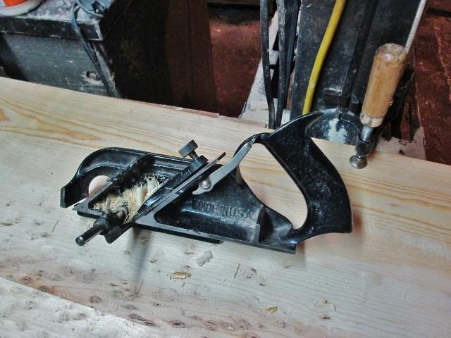

Set up the Stanley 45 to plough a groove to house the raised panel..

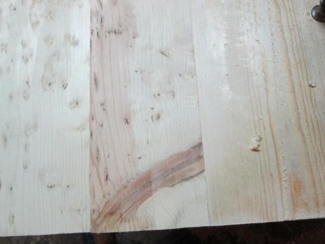

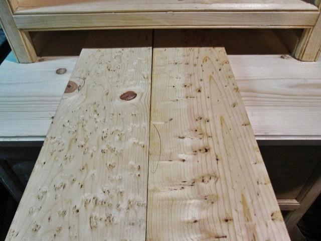

And tried to set up boards to glue up into the panel........the two figured ones were long enough ( barely:unsure:)
The other three I can set back? NOT EVEN CLOSE:angry::angry::angry:
So, tomorrow I get to go to the Green BORG, and BUY ONE MORE BOARD:angry:  Then, maybe Tuesday, I can do a glue up for the raised panel?

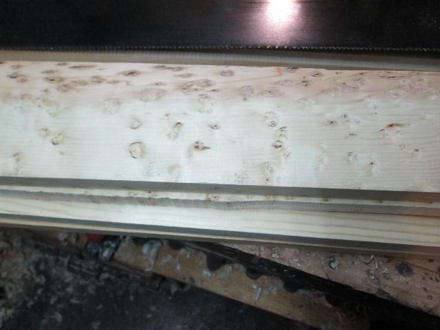

I can rip both of these boards, to remove the worst of these knots...
Set the guide block for each cut....guide and blade did not play well with each other...had about as many waves as the N.Korean Cheer Squad..
Will need to joint all four edges...maybe tomorrow.  Marked the good lumber for length..
Both of them. Even using the Stanley 45 was iffy tonight.....had to keep adjust the fence, until it was finally centered.   Then it was easy to do all the grooves..
"Groovy."    quit while I'm ahead of the day.    I test fitted the door's frame ( dry fitted) into the opening...yep, a bit too tight...

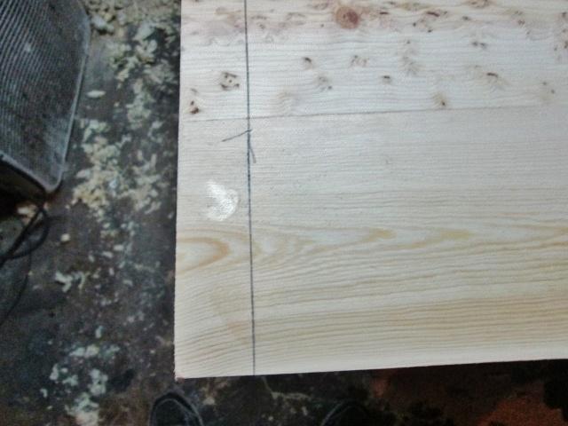

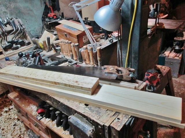

Meet the "Tablesaw"  I use.   Disston D-112.   Needed to cut the longer two down to match the shorter two.
Shorter two needed a bit of work...

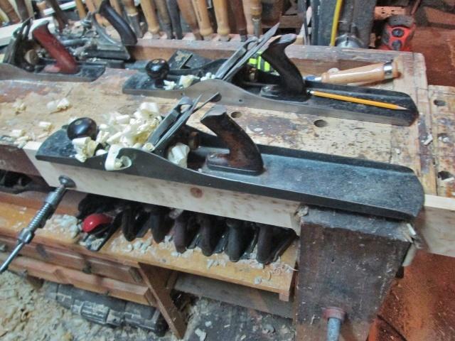

A little wavy.   # 7c to joint the edges of the new boards....Millers Falls #14 to get rid of the worst of this waviness..
#8 took over to edge the bad spots.   ( back is paying the price, now) Worked on all 8 edges, until the board fit together with no gaps...
