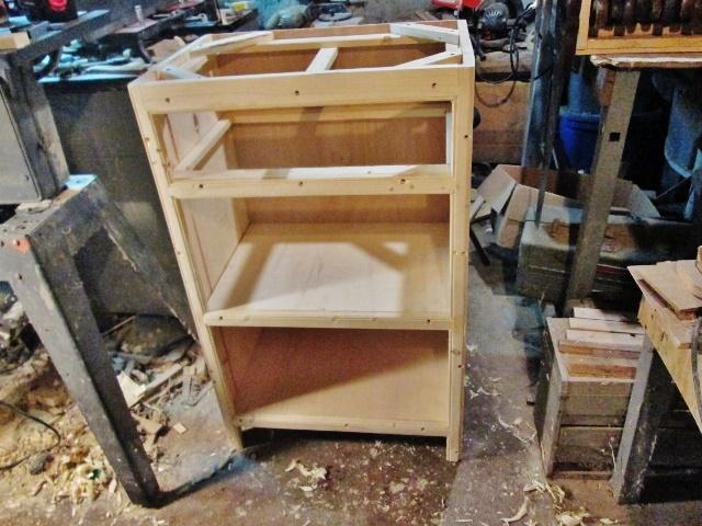

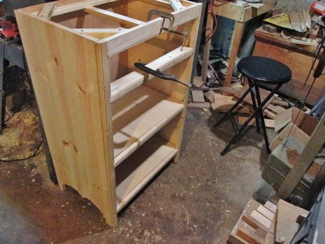

Frame is out of the clamps.....trying to get motivated to do a bit of shop time...
5 hours ago, lew said:
Take it easy! The project can wait. Don't aggravate the brain!
Ditto...we'll still be here...want you to be also!!
Tried just sitting around when we got home yesterday.....just can't sit still...so, I SLOWLY  did a little bit in the shop....5aa13db67fbf0_testfitted.jpg.0f7ccadacd0d80dfda42ffd1954dae0d.jpg

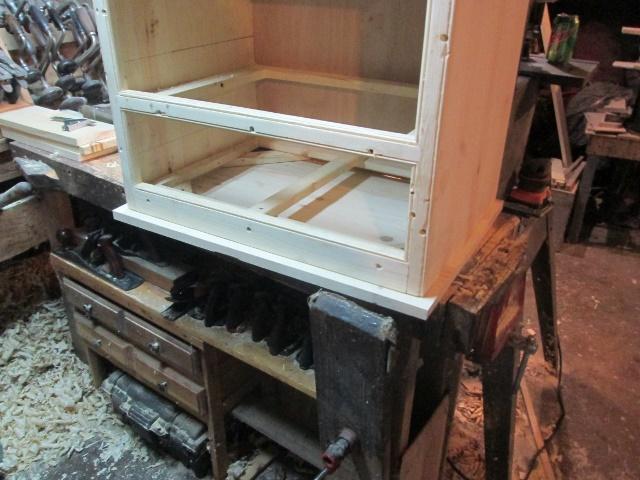

Test fit....meh...will need a few more clamps...cleared the bench top off...and, after some debate on how to do the counter-bored holes, clamps things up to pull the sides into place..and glue and screws to hold one side where it belonged
Then, turn this thing around, and work along the other side...

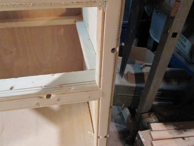

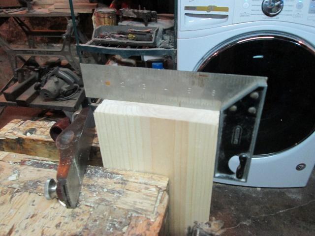

First off, I had to use the bigger clamp to pull the side into square with the frame...add a screw, then apply the clamps where needed, to pull the side closer to the frame, and screw that down. ...once that was done, I took the clamps off, laid the case on it's side...
Squared the feet  front to back on both sides of the case...used a high-tech cutting tool, too.
Then placed the saw on the bench, had other uses for it..
Then grabbed the old stanley smooth plane, and worked on some edges...
To "flush" the sides to the edges of the frame.   Would have taken too long with the sander, anyway.   Stood this mess up..

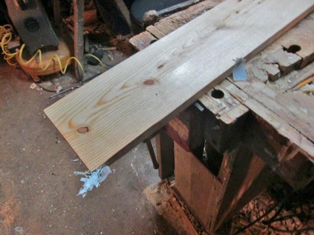

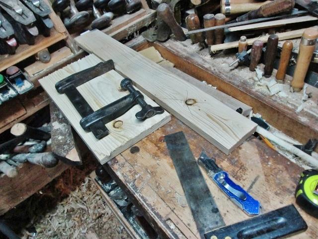

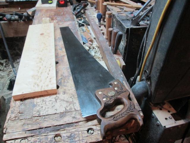

And took a short break....on the way back to the shop, picked up the 1 x 8 x8' and brought it down to the shop....needed 27" long parts cut..
First two weren't too bad....saw operator..still needs a little practice...
There was one spot I wanted to avoid on the last of three cuts..
But, to get around this ugly thing, I needed to accept this lesser ugly..
Not a biggie...as the first two were almost wide enough..
I did have a 1 x 4 that would fit....could not get around a huge knot on it.   So, I used that 1 x 4 to mark the 1 x 8, and make a rip cut, that also get rid of the Junior Knot.    Laid it inbetween the first two..
Panel now measures 3/4" x 27" x 18".....I do have a couple leftovers from that 1 x 8..

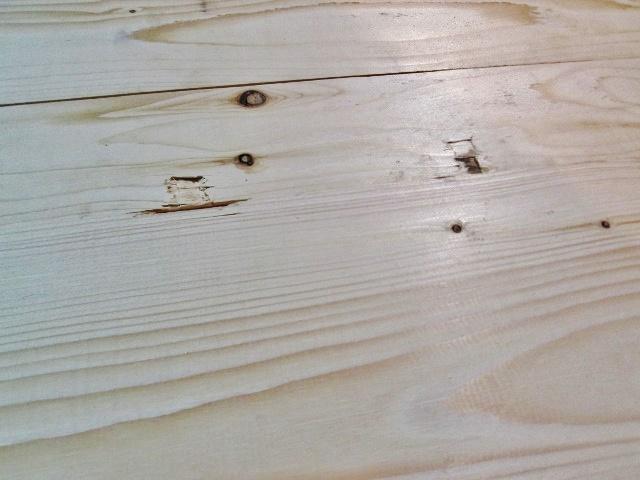

Ain't they lovely?   There is a spot I will need to plane a bit..

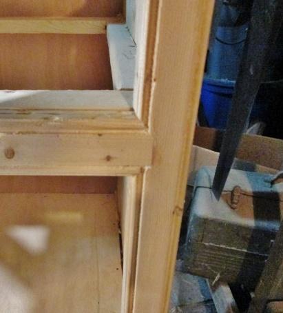

Or..just flip that board over.    As for the fancy joints on the face frame..
Will need a little clean up....need to make a few plugs, as well..
Have a few holes to fill...

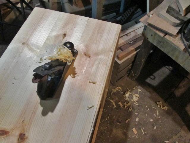

But..Maxwell and Miss Bandit are taking up my spot....let sleeping dogs lay....tried out the jointer plane, where it could just stay flat on a board..

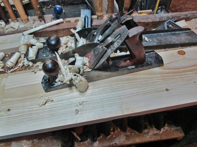

10 pounds is still 10 pounds.   I don't care how nice them shavings look...:rolleyes:
Tried out something a little smaller...:ph34r:
Just a tad smaller...still does shavings like it's big brother..

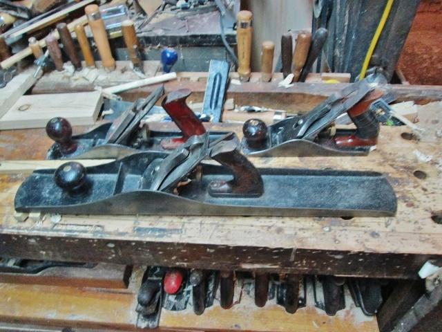

Used both on some edges...as well as the rough sawn faces....after all, I wanted to get this next step done..:ph34r:
So..how much smaller is a jack plane than that #8 jointer?:unsure:
This is the basic set of hand planes everyone says you have to have...Jointer, Jack and Smoother....
They will get a bit of work, once that panel is out of the clamps...stay tuned.. ( need to evict two pups from MY nap spot..)

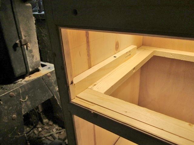

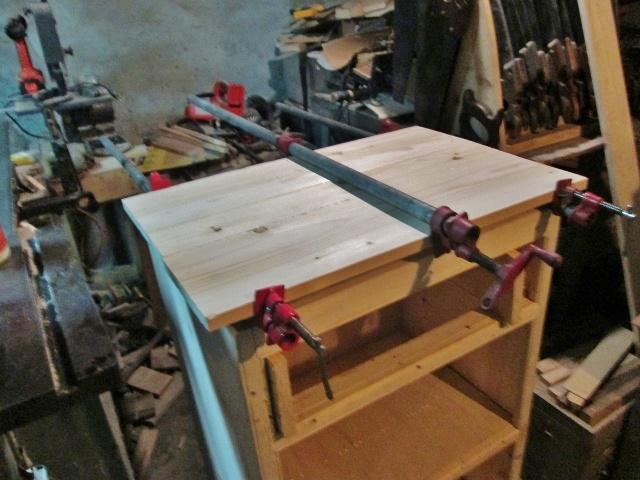

Got the top out of the clamps...and let it sit a bit...got the drawer runners and guides done..
Runner is just a 1 x 1.  Was a tight fit...hammer to adjust.   bead of glue and a single screw to hold it there.  Guide did not have to be all the way back, just enough to guide the drawer in.  Single screw to hold it while the glue dried...Got both done on each side..

Used this old fella to clean the glue joints, and level things out a bit....then the larger plane took over..

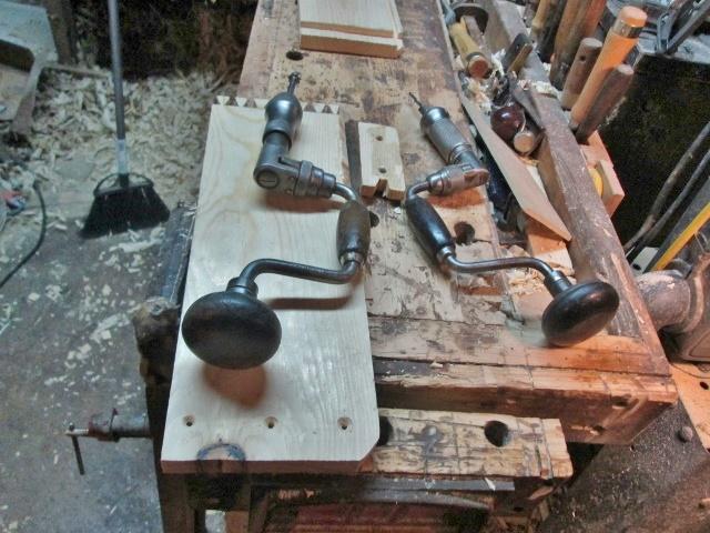

Hmmm...Needed to drill a few slotted holes..marked out for the slots..
marked a spot about in the center of each line. and grabbed the drill..
I drill a through hole first, then GENTLY rock the drill back and forth will turn the handle..only snapped one bit ( had a spare handy)

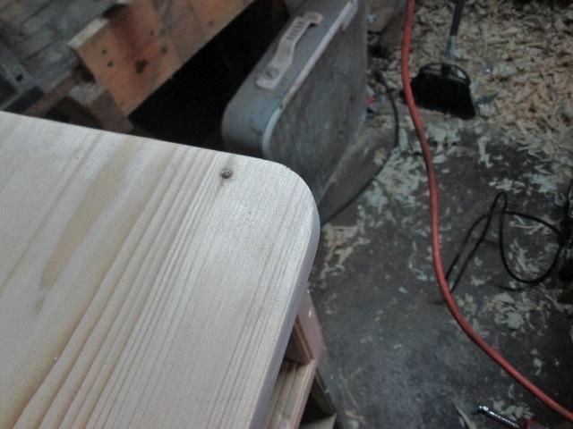

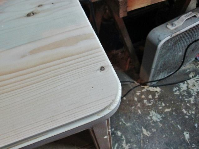

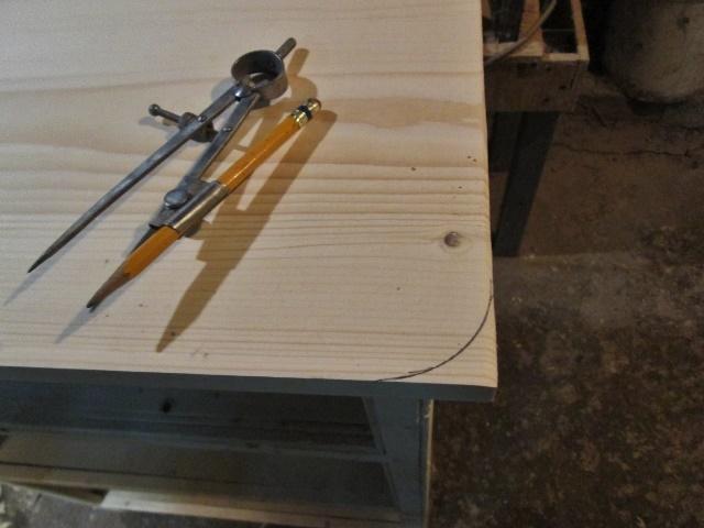

Used a half pint can to sketch a radius, then used this thing to draw two corners...and got out the Green Machine..
Not too sure of this one's Vintage...but..
Then set up the router..
With a small cove bit.  Front and both ends were routed..
Then a bit of sanding, to soften the sharp edges a bit....then set this case aside..

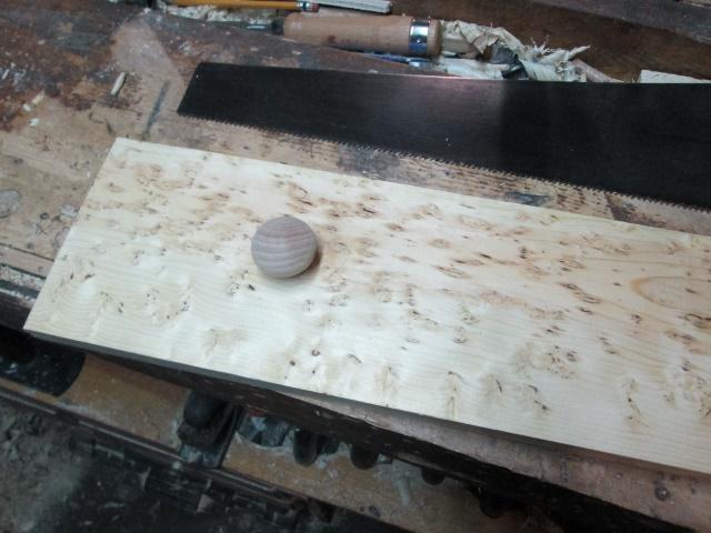

Sooo...."Build-a-Drawer"?    Through dovetails?   Ok....:rolleyes:
handsaw to cut a blank for the drawer's front..
Cut to rough length from that 8' long plank...trimmed this to fit..
As for that knot, we have ways..
Drill a hole through the knot, lots of glue, and attach the knob....orient the knobs grain so it smiles back at you..

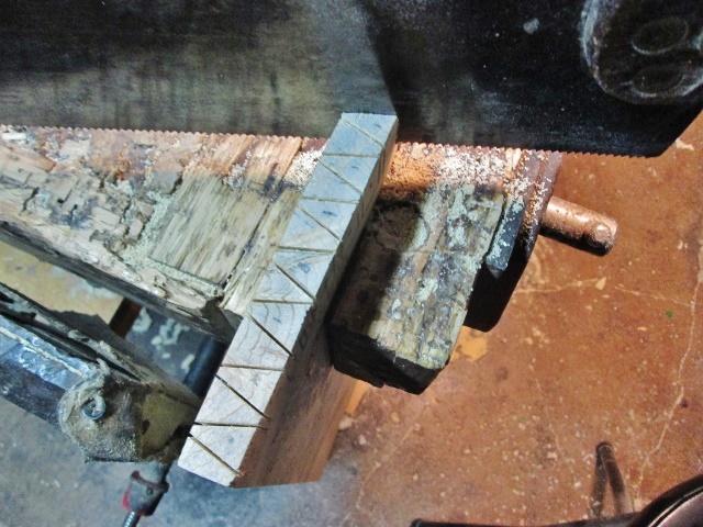

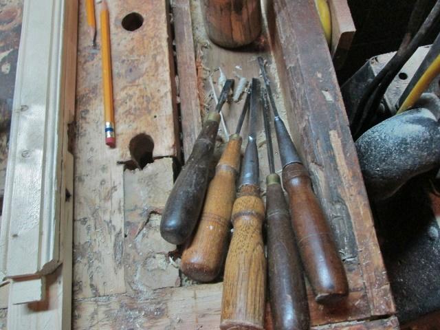

Got out the usual suspects to do dovetails with..
Dovetail bit is to set the bevel gauge with....but before I could do too much, I need to plane the faces of the board, was cupped a bit..

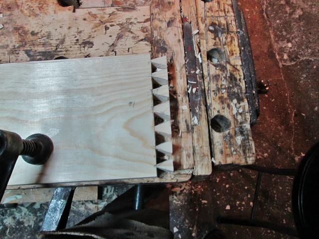

Set up to mark a few lines..
I use the bit to make one line on the edge of the board, then set the bevel...and mark things out.  Small combo square to carry the marks down the faces.  Square was also set for how thick the boards are..

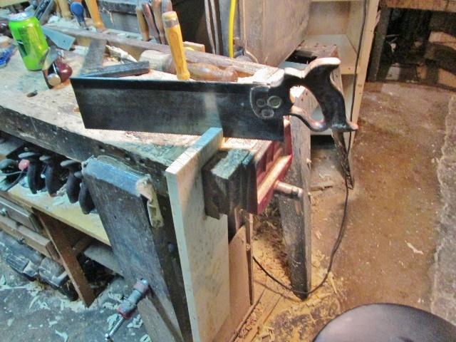

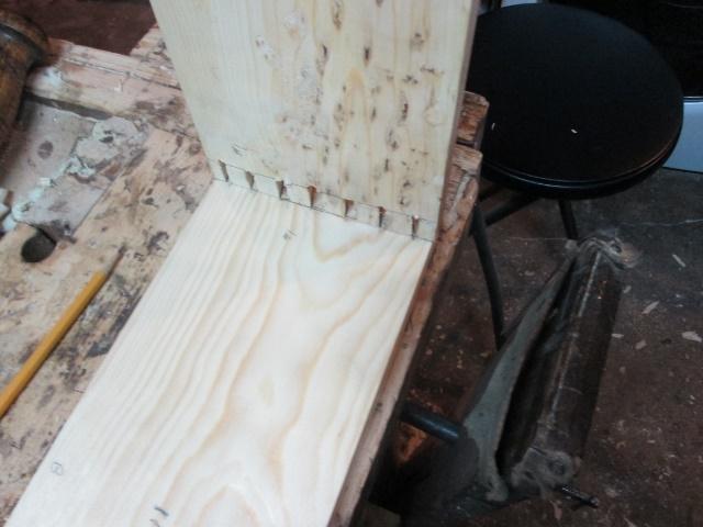

Tick marks to show the waste parts.   Lower the board in the vise, and get out the saw..
Shop stool so I can sit and saw...trying to split the lines..
Not too hateful?   Then lay the board on the bench, and chop 1/2 way in from one side..
Leave a little out on the edge,for support...flip this over, and chisel the rest out..
One end done, repeat for the other end.   To make things even, I used a square to transfer the pin spacings
Then just repeat until the other set of pins were done..

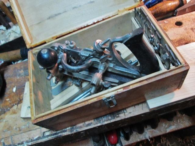

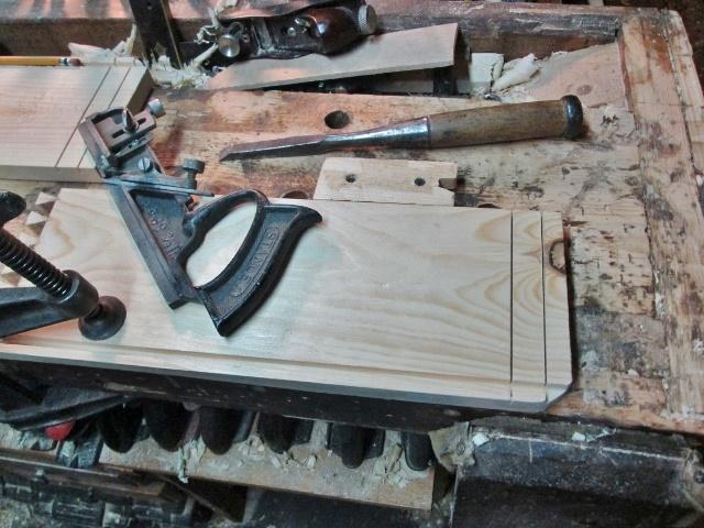

Then repeat for the other side piece.   Ok, I got out the Stanley 45.....
Still had the #23 bead cutter installed....replaced that with a #12 straight cutter. reset the fence so a groove would be a 1/4" up from the bottom of the drawer.   Cutter was ahair longer than the bead cutter, was cutting a bit too deep, reset that...set up a jig on the bench..
Just a way to hold things steady while the 45 works.   Roughly cut a plywood panel.. dry fitted all the parts so far..

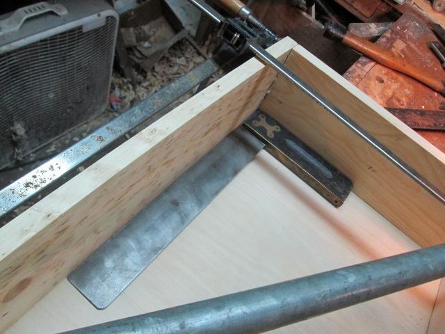

Diagonal to pull things square....
Bench is full of clamped up drawer....guess I get the rest of the day off?    Will let the glue cure...tomorrow, maybe:rolleyes: I take the clamps off, and clean things up.    Need to install a couple knobs, too...stay tuned....

Ok, how do you make a knot...vanish?
Well, I drilled a  hole, right through the center of the knot...then a bolt and some glue..
Right before this knob was installed..I transferred the location to the other end of the drawer, so both knobs are the same..
