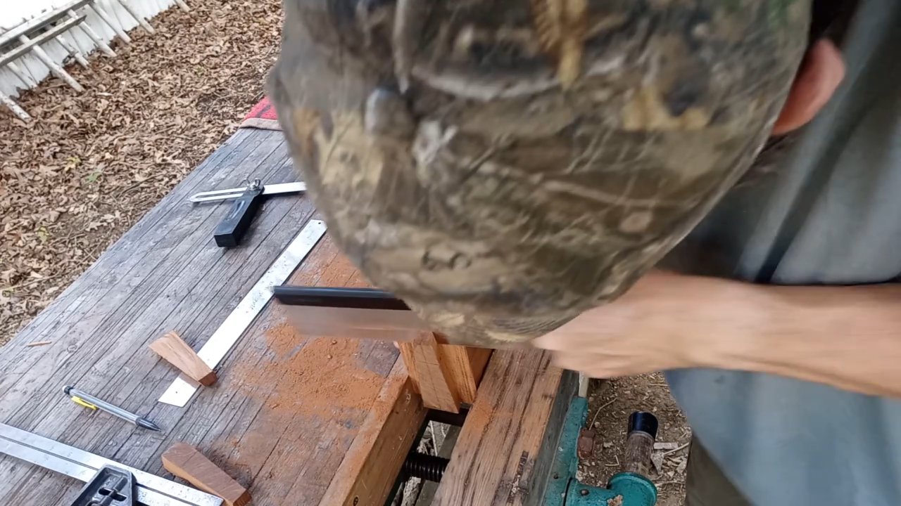

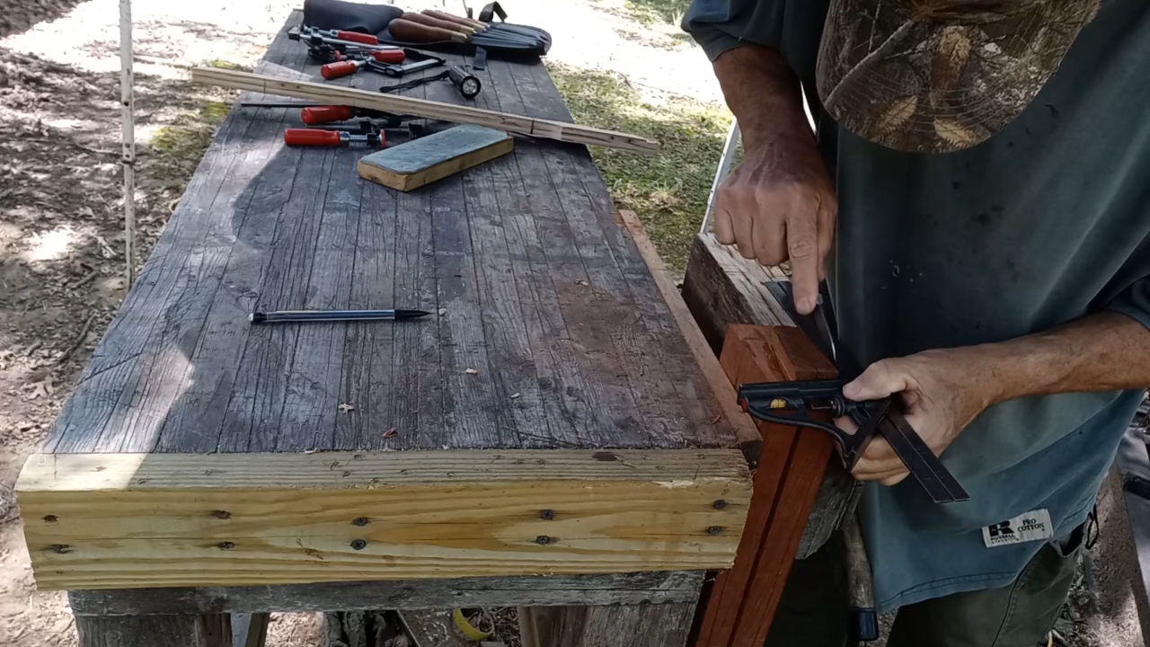

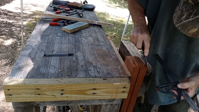

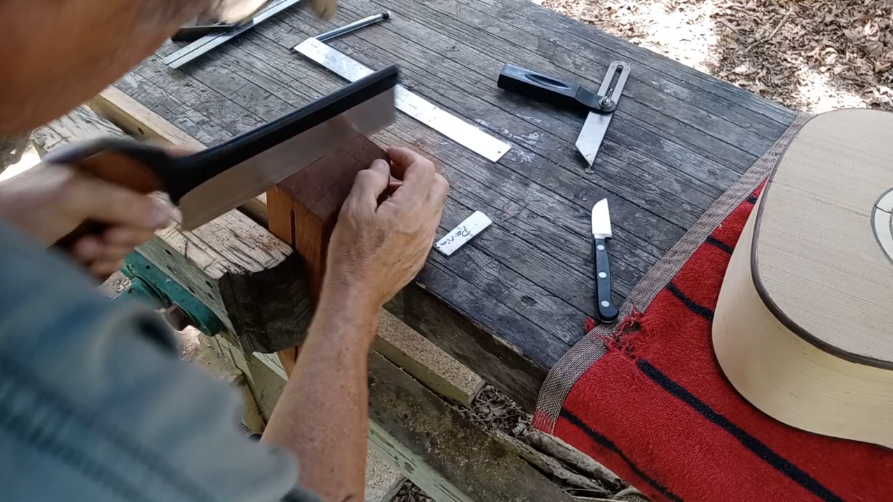

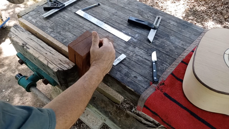

The boudaries of the dovetail, except for that angle, were previously marked on the heelblock of the neck, and inscribed with knife lines. The next step is to cut the dovetail tenon out. I use a fine cut dovetail saw for this.

    And some shots of the finished channel for the top.
The other side is next.

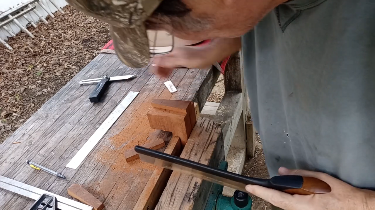

Then the cheeks of the neck heel, where that angle was marked.

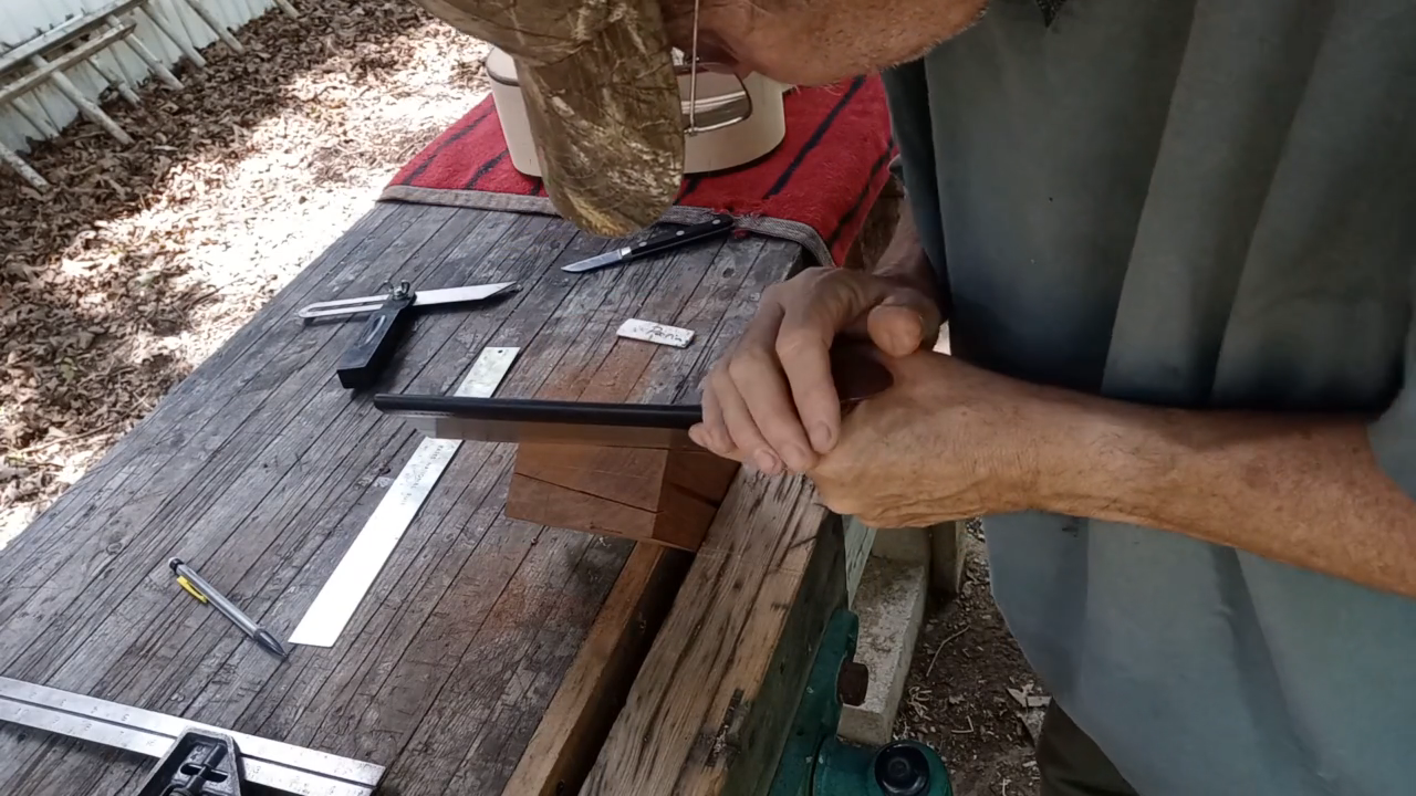

Finally, the bottom of the tenon must be cut.
And the final result.
And the corresponding video for this operation.

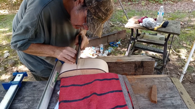

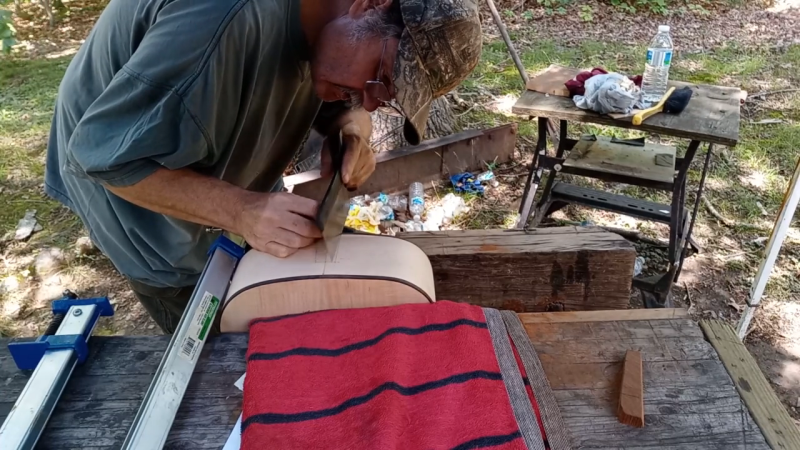

Ok, so we cut the dovetail tenon; now it's time for the mortise.

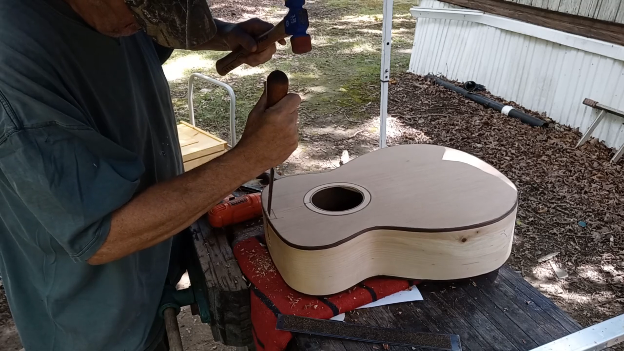

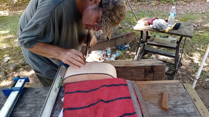

I marked out the mortise on the body, and then I start sawing to the lines.
Edited by Handfoolery

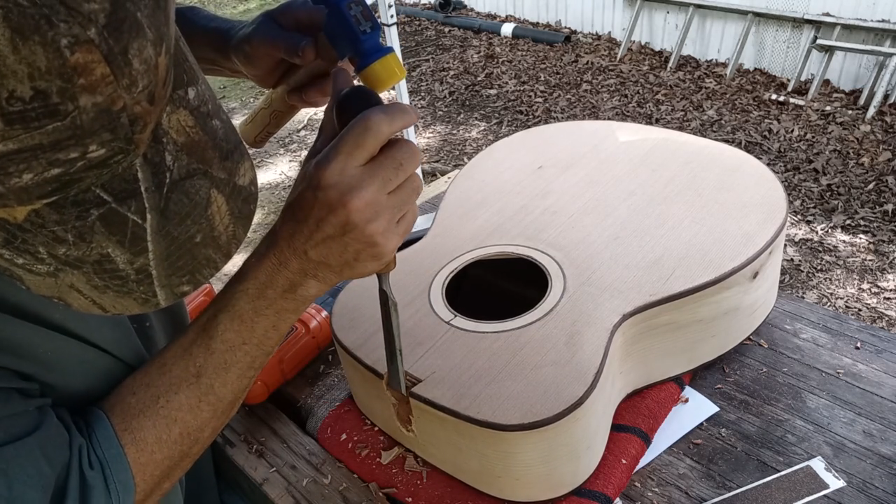

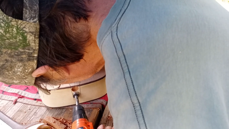

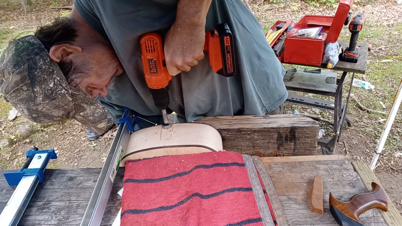

This is basically a blind dovetail, so I can only use the saw for some of this. To complete it I treat it like the mortise for a mortise and tenon joint. In other words, I use other means to remove the bulk of the waste before moving to the chisel.
In this case I hog material away with a forstner bits in a hand drill.

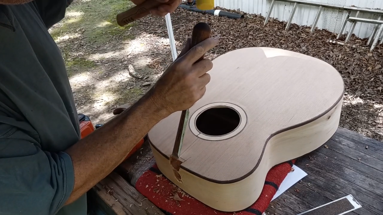

And finish with chisel work.
This takes some time, but it is hand work; best not to get in much of a hurry. It ain't power tools, but the edges of my hand tools will cut you long and deep if you screw up. If they aren't sharp, they aren't worth sqwat.

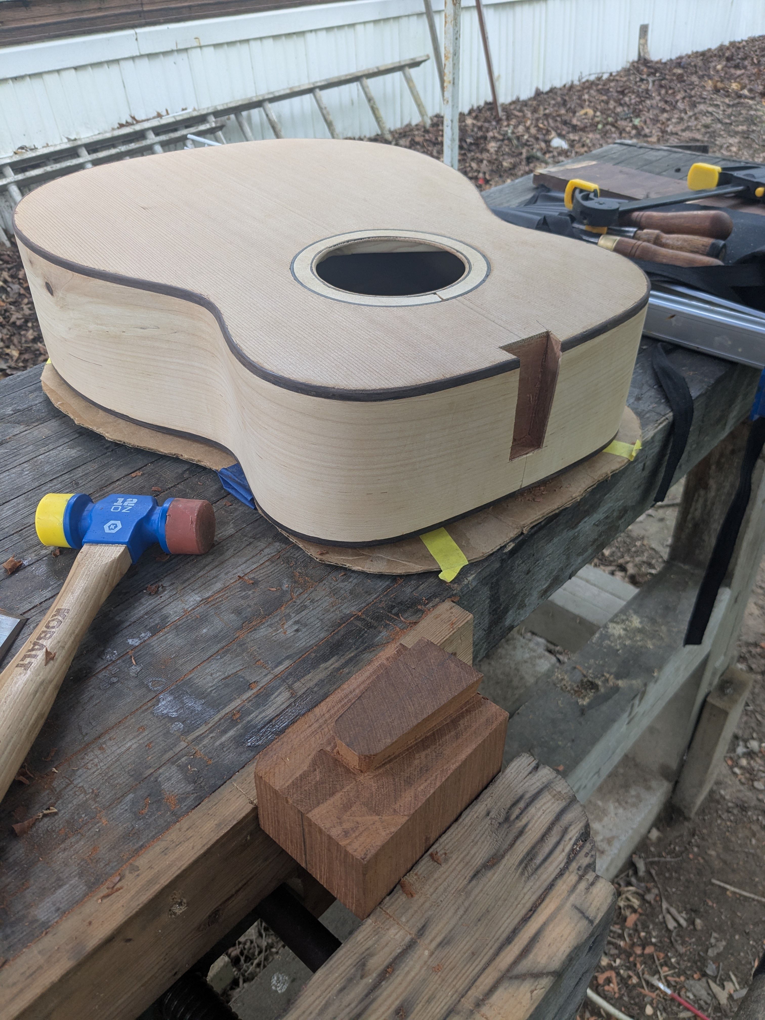

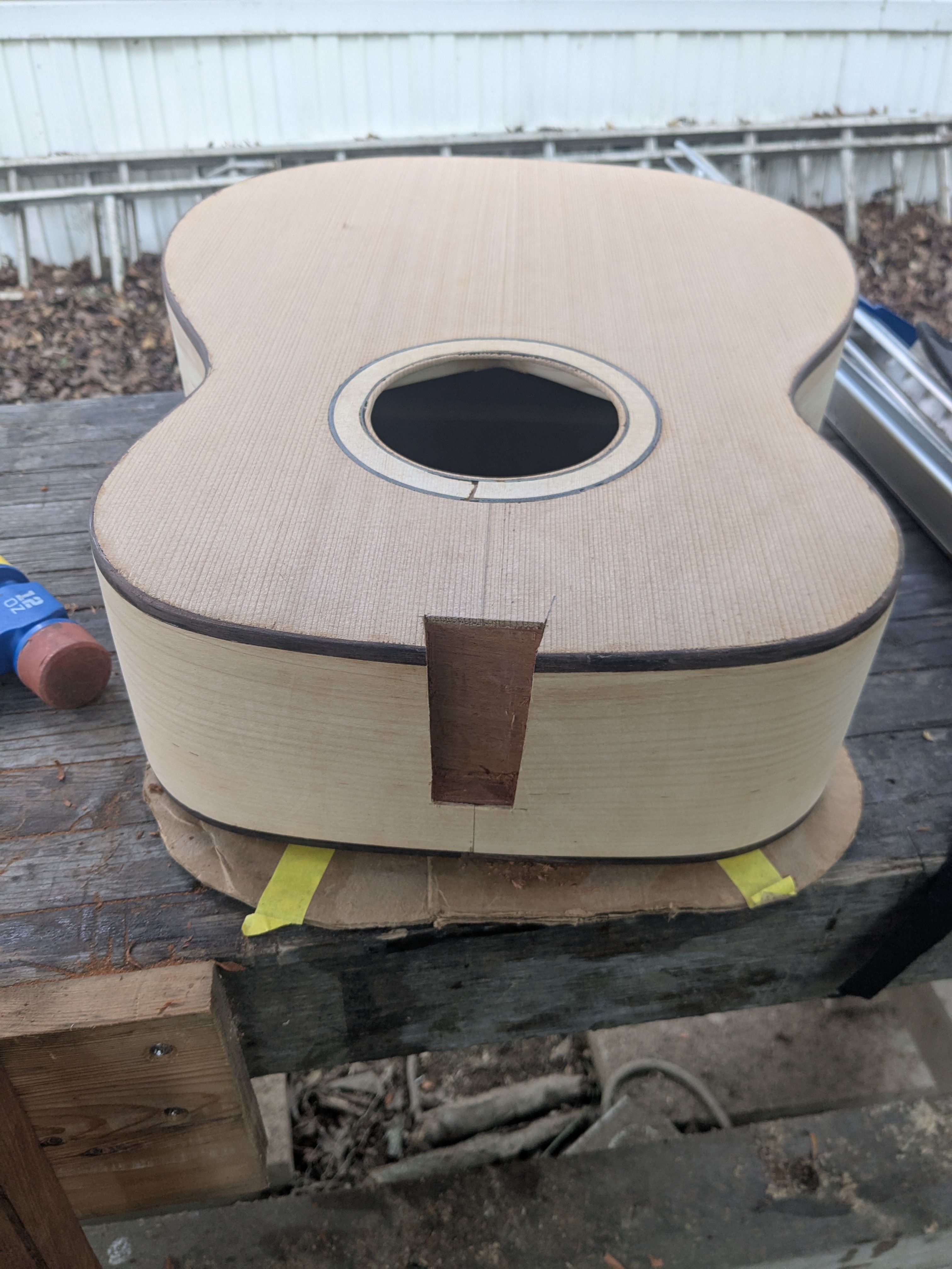

The completed mortise.
And here with the tenon.
Something to note is that the mortise is about a 16th to an eighth deeper and taller than the tenon. This is on purpose because if the face of the tenon contacts the back wall of the mortise, or if the tenon bottoms out in the bottom of the mortise the pieces will be pretty much impossible to fit together. If you don't notice this is happening you can end up taking too much wood out of the joint in an attempt to get it to fit properly until you discover your error. That's technical for bad. Thank you for looking at and commenting on my thread. Happy Independence Day!

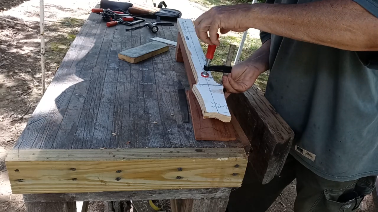

Time to move to rough shaping the outline of the neck. To finalize the outline I use a router template.
But there's a lot to do before that can happen.
I use the template to mark the outline onto the neck blank. So, place the template onto the neck blank.
Clamp it down
making sure it is centered well
I use the marking knife to mark around the template
I love a marking knife. Mine's just an old paring knife I reshaped. There's a video on that somewhere on my channel. Once again, thank you, Paul Sellers.I use a jig saw to initially cut out the waste prior to routing. The heel is 4" tall'; too deep. So I carry the lines over with the marking knife
