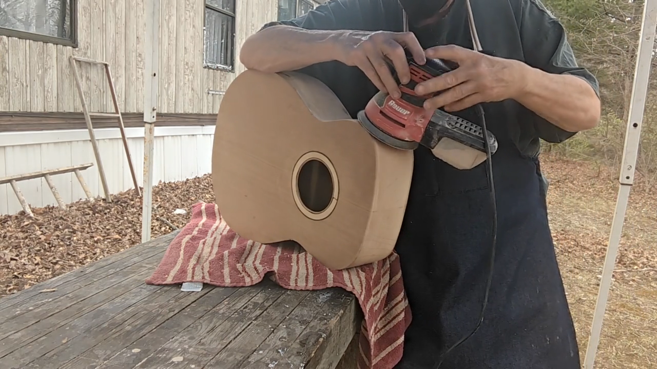

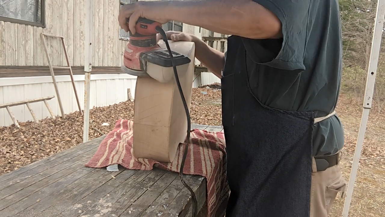

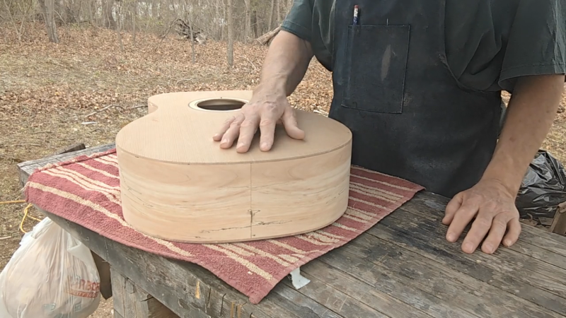

Once that is done I need to level the sides. I will be cutting the binding channels by hand with a gramil and chisels. Said gramil will ride on the sides, so they must be flat, smooth and free of imperfections.
First step in that is to draw hash marks on said sides with pencil.
Then comes the dirty work.
And we are done with this phase.
Thanks for looking and commenting on my little thread. Much appreciated.
More to come.

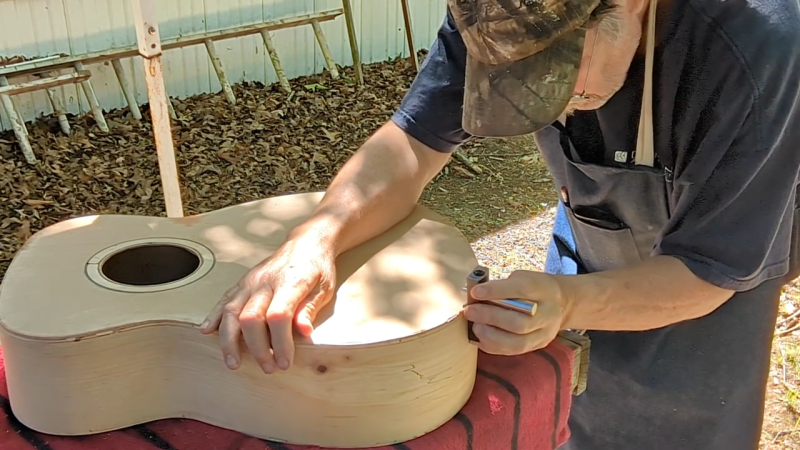

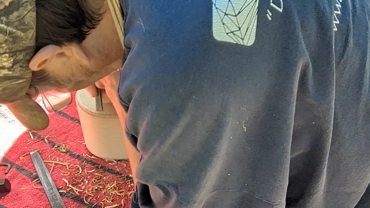

The next step in this build was cutting the binding channels on the top and back. I do this by hand with a small tool called a gramil (spl?), along with chisels and a small file.
I start by setting the tool to the thickness of the binding, and the height of said binding.

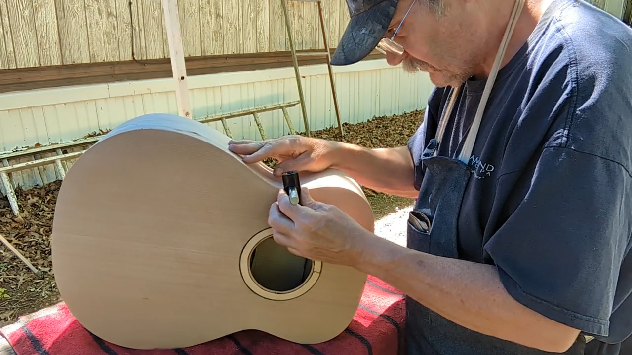

Then the first step is to score a line on the sides of the guitar at that height and to the full depth of the binding's thickness.

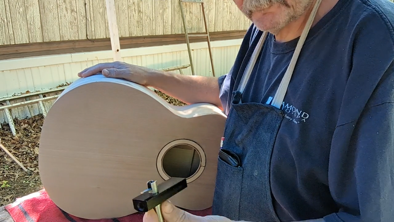

Next I set the gramil to score a line the thickness of the binding, from the outside edge of the top, in this case. I do the same procedure for the back binding as well.
I then score a line along the top of the guitar.

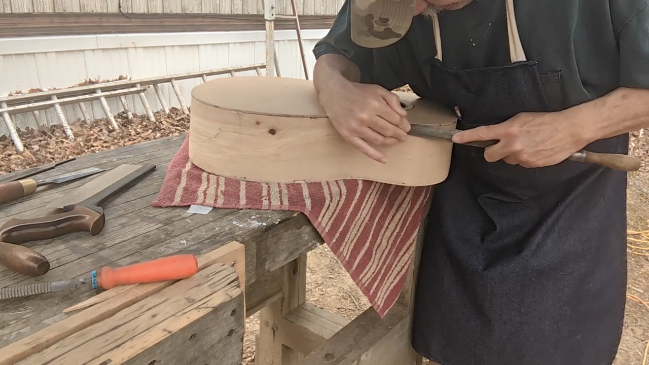

I do not cut the full height of the binding channel, but go a bit at a time, and work it down with a sharp chisel.
And then back to the gramil.
And the chisel.
Back and forth in that manner until the channel is cut.

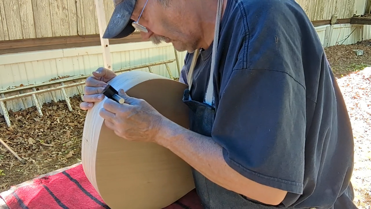

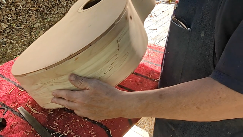

Once the channel is excavated, I use a chisel to kind of slightly shave back the very bottom edge of the channel.
This is important to make certain the bottom of the binding fully seats against the bottom corner of the binding channel.
After which I use an 8" single cut file to clean up the bottom and sides of the binding channel even more.
And some shots of the finished channel for the top.
