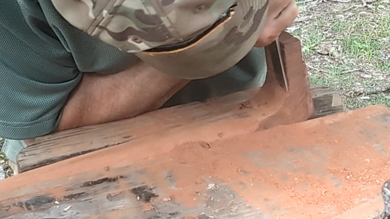

    And some shots of the finished channel for the top.

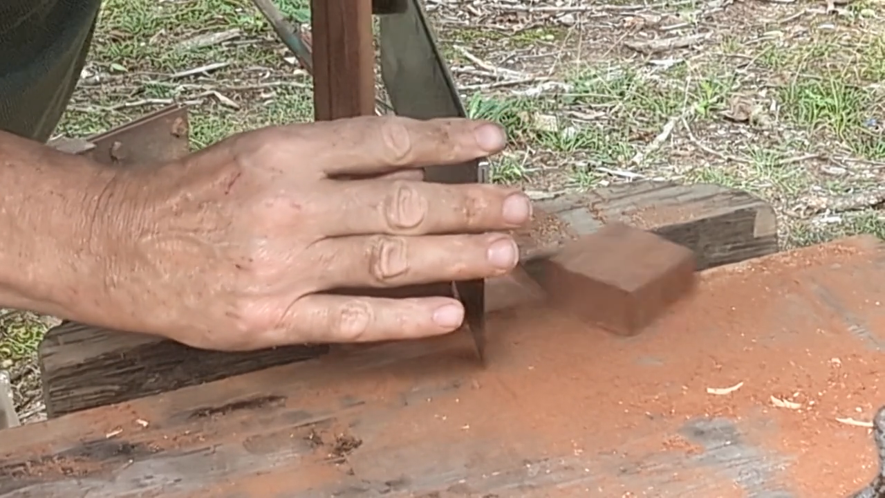

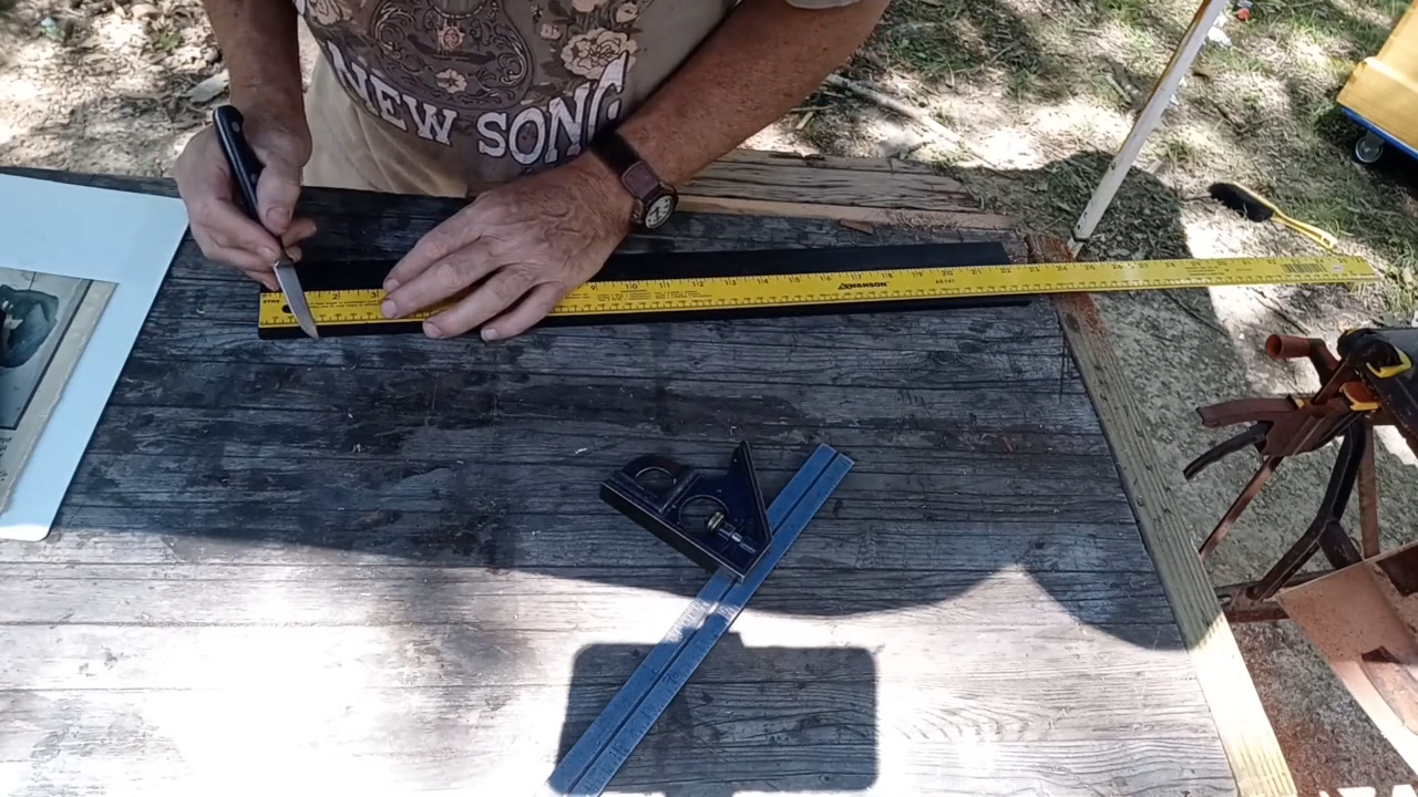

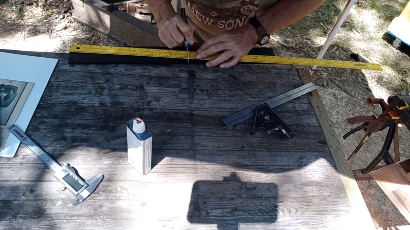

Time to lay out the fretboard.
I'm using a metric equivelent of a 35" rule. I prefer laying out the fret positions in metric because I fins it easier to do.

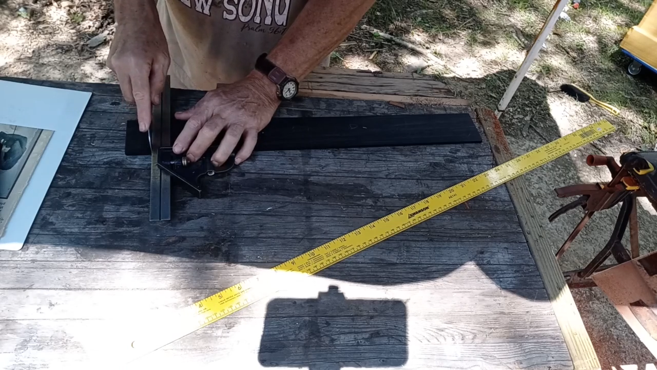

Basically all I'm doing is laying the ruler alongside the fretboard( this one is African Blackwood) and using a knife to put a little tick at each fret position along one side.
Then I'll use a square and the marking knife to carry that fret slot position across the face of the fretboard.
It should go without saying that the fretboard blank is trued up and squared before hand.
And we just continue along in this way until each position is marked.

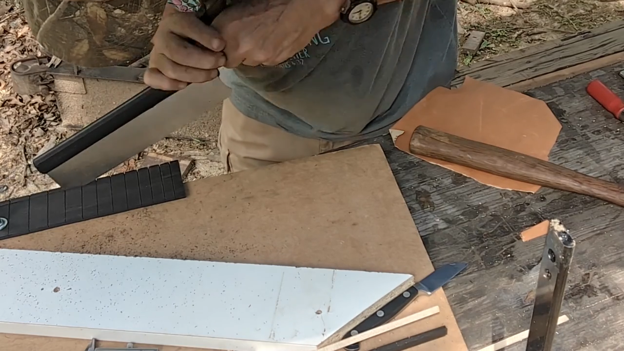

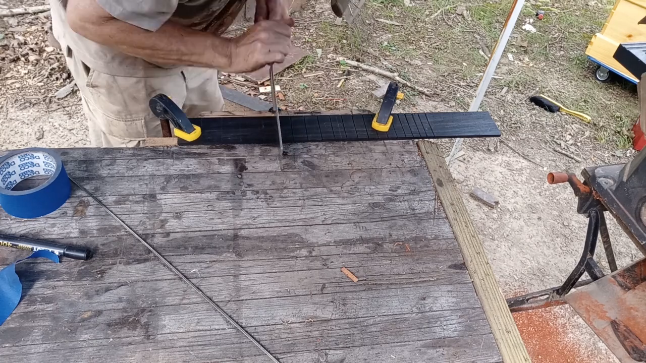

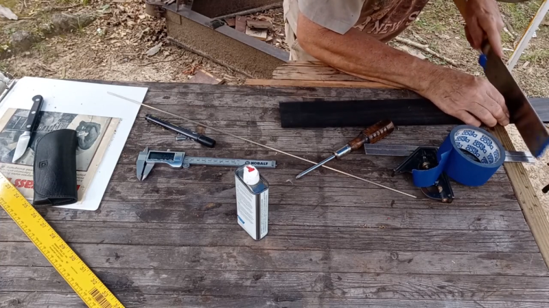

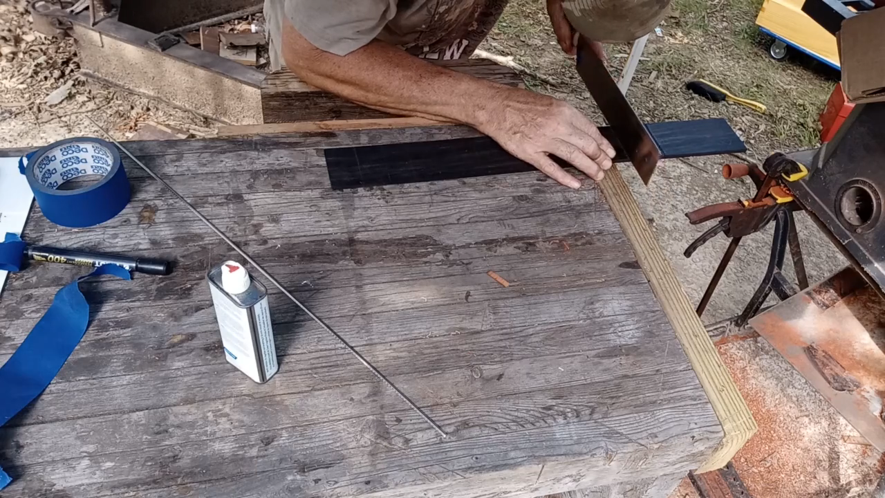

Once this is done I break out my fret saw and cut the slots. I use a piece of tape on the side of the saw plate as a depth stop.
Until all the slots are cut to depth.

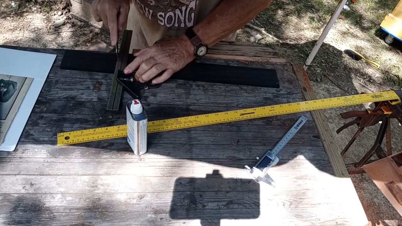

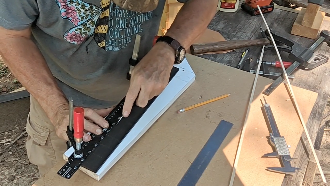

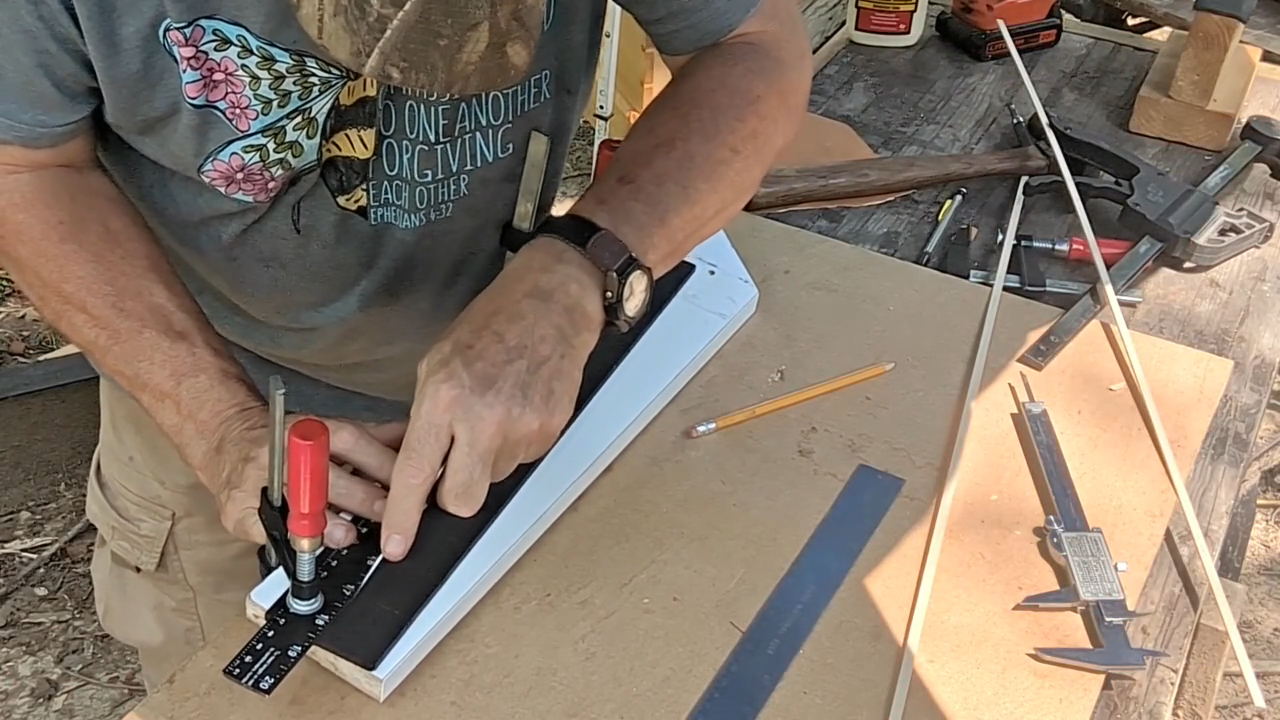

Hello there,

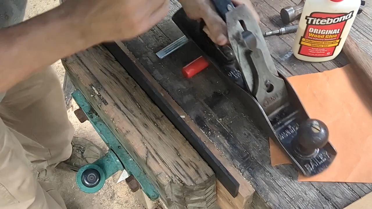

Next step in the process is to size the fretboard for binding.
The fretboard should taper from 1 &3/4" at the nut to 2&1/4" at the other end. But I want to put maple binding on either side of this beautiful African Blackwwood. To do this and have the fretboard come out the proper dimensions I have to make the fretboard undersize by twice the thickness of that binding.
I start by make knife line cuts to mark out that shape/size. So I clamp a straight edge in place so it will not move, and take a sharp knife in my hands.
And cut the knife lines.

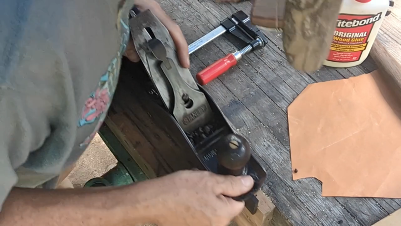

I will saw close to these lines
Once I have cut out a rough shape I'll place it in the vise and  break out the hand plane.
And then it is just a matter of planing to those verydefinitive knife lines.
And, I thought I had the camera running when I glued the binding, but instead a went about talking to myself like an idiot until I was finished and started looking for that footage in my uploads. Oops.
Here is a finished shot, anyway.

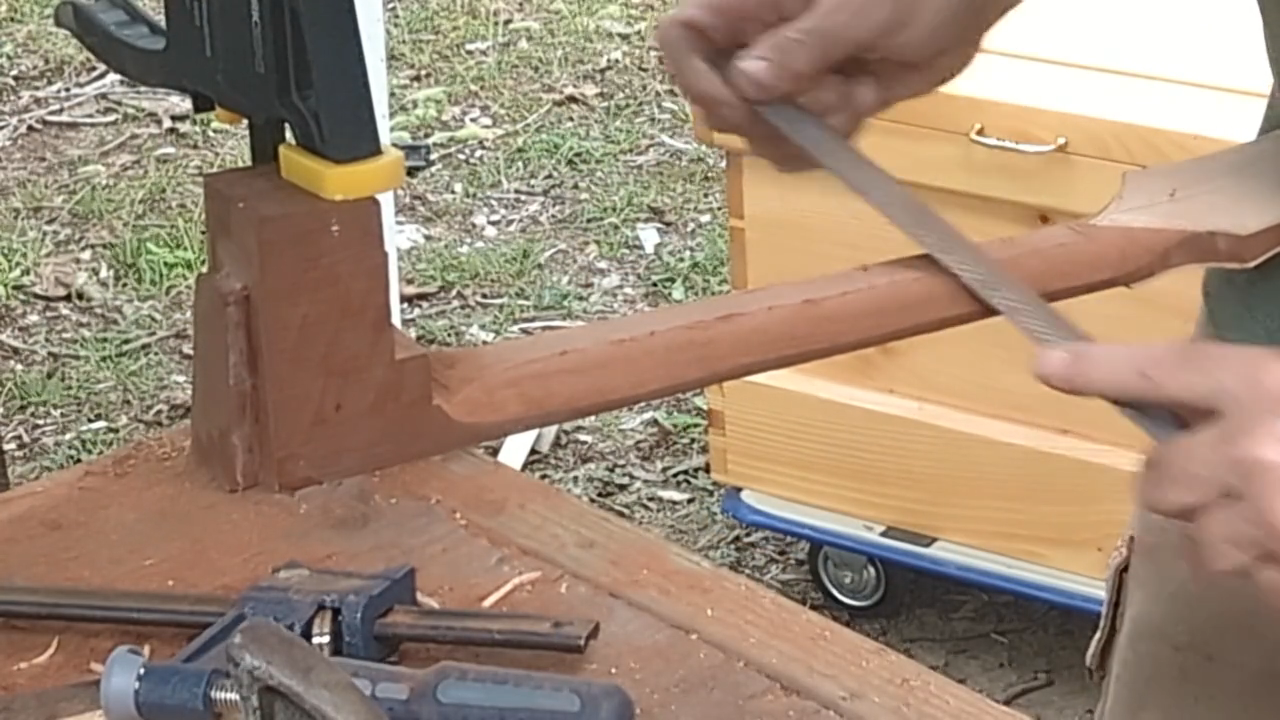

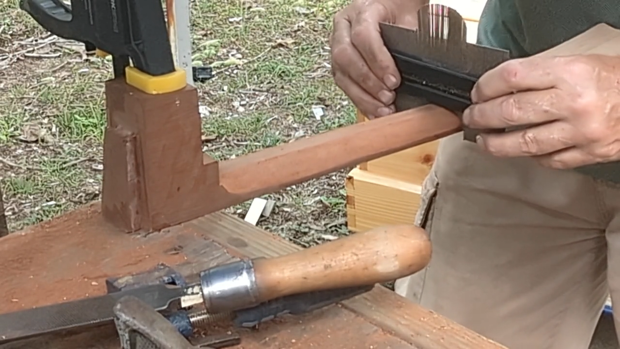

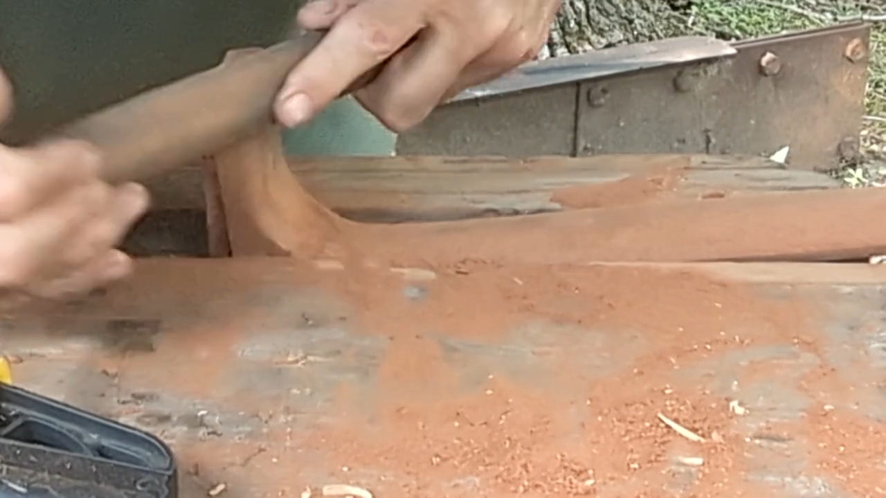

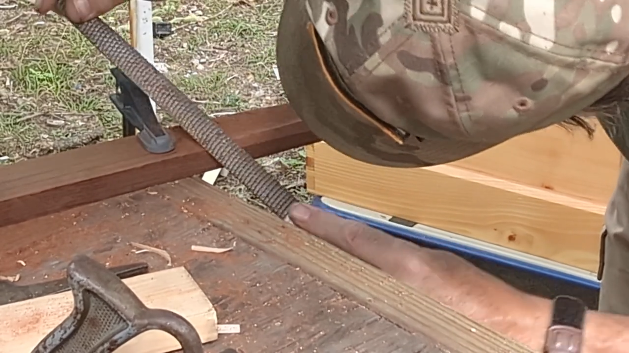

I carve a neck almost exclusively with a rasp. The rasp I use is a cheap No name made you know where. There is nothing graceful about it, but it gets the job done. Neck carving and hammering frets are my favorite things about guitar building. I'm just gonna post several pictures of the process. Enjoy.
When I get close I start checking with a contour gauge to make certain we are symmetrical along the length of the back of the neck.

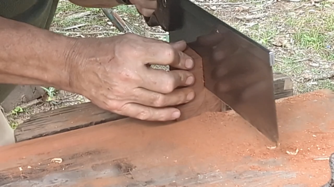

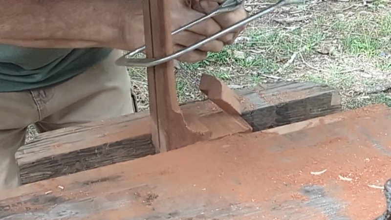

Time to shape the heel. I start by sawing away as much waste as I can.
Then I move to the coping saw.
After that various other tools are employed.
