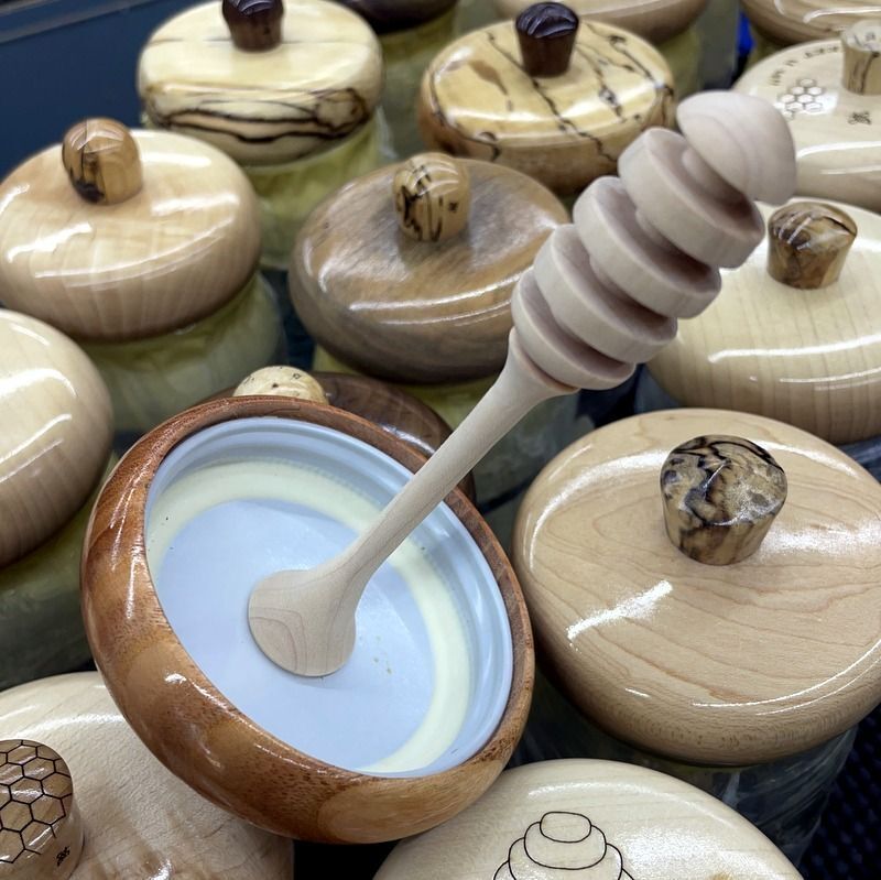

@Steve Krumanaker is our resident laser technician. Steve creates awesome designs for the honey dipper/lid he creates. I really need to invest in a laser setup!
dippers2.jpg.19f8e655a32f3c435d0aabb949baa2c0.jpg.46f1a928250376b3a9a0dd75c91be9de.jpg
Steve received a lot of positive comments about these gems!

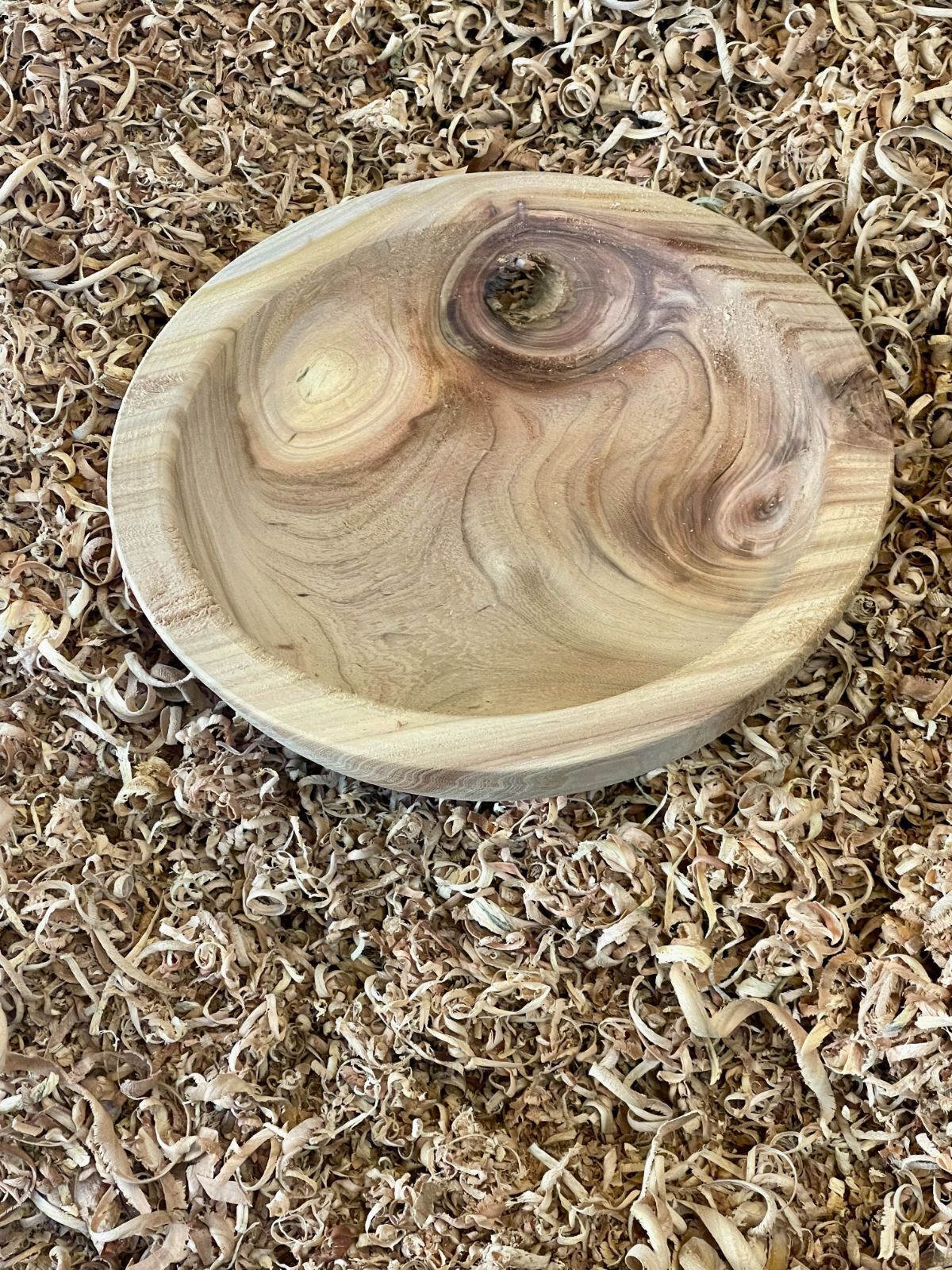

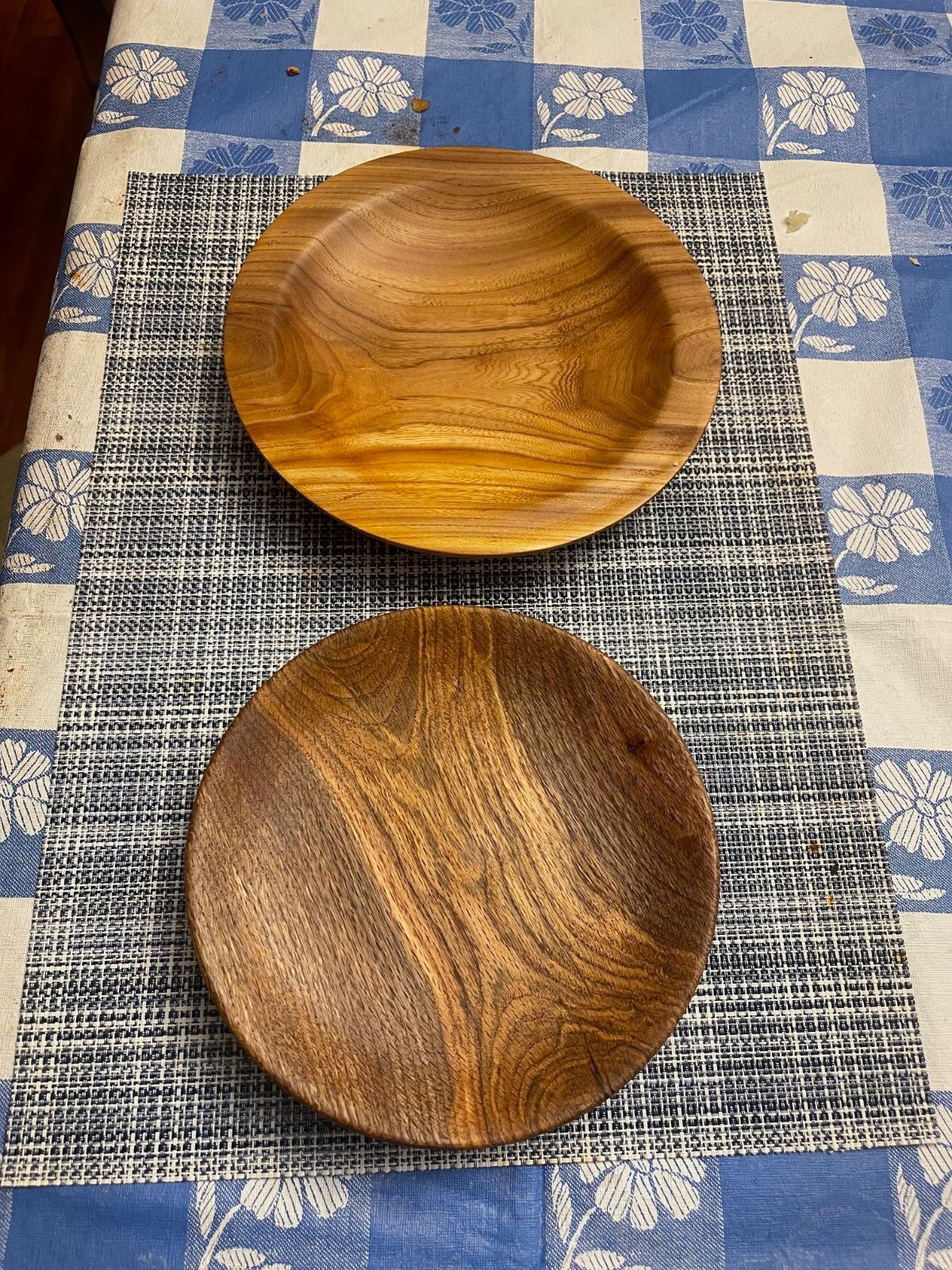

We had several turning related entries in the "What's On Your Weekend Agenda" forum. @forty_caliber Gave us a look at some bowls he turned-
1550446809_2021-1(3).jpeg.86cf745c45ded5897ae0eb3509c6f08a.jpeg.aca09b69d0609ddd6de5d598b6bb4d98.jpeg
And this one-
1481403252_2021-1(4).jpeg.5e8cc9fe7901b88714fe48fd3fe1c115.jpeg.c685b2895e16a8f0020cb864a9fd63c9.jpeg
The pecan bowl was turned green and will need to be dried. @Gerald offered advice on the drying procedure-

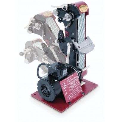

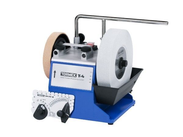

@forty_caliber Gave us a comparison of two sharpening systems- Tormek and Sorby Pro-Edge. Thanks ".40" for the information!
WPED01A_PED01A_Proedge_Deluxe.jpg.52c70fc7985e82b8bbf07d49e5ff8c50.jpg1341846062_tormek-t-4-original_front_2000x1500(600x450).jpg.458bfa3bd9b0657f5bd7fa0de56ee96e.jpg

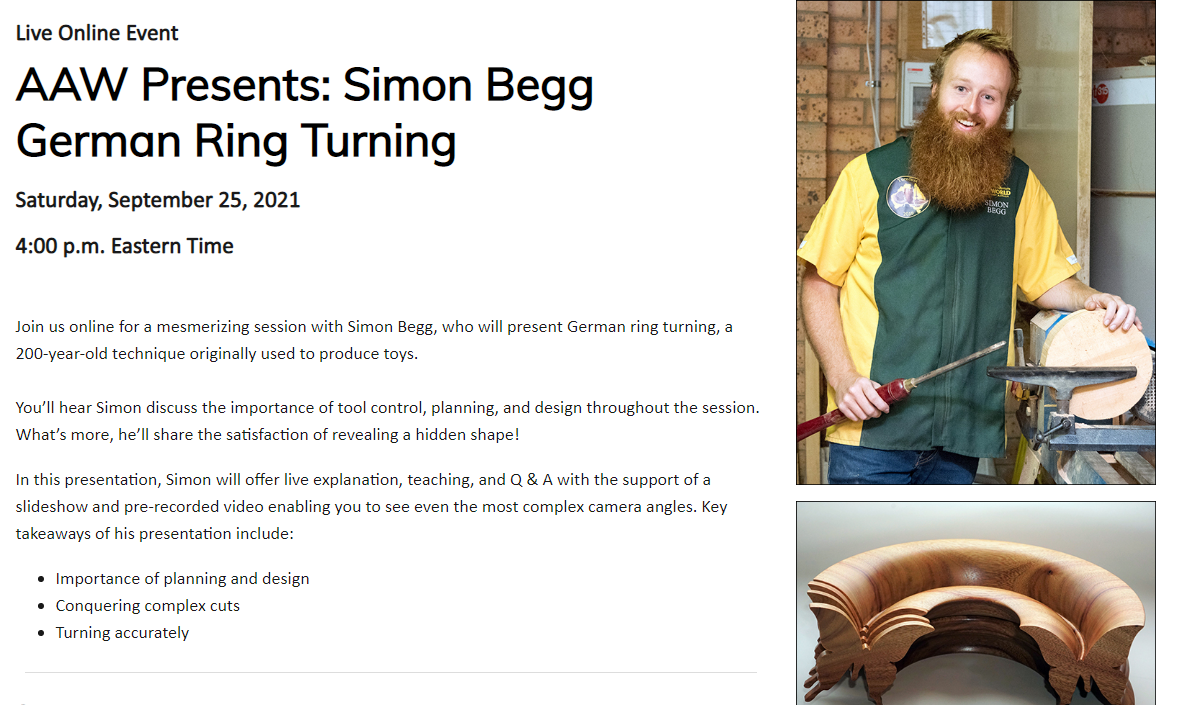

From Simon Begg

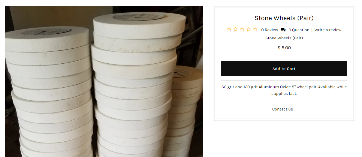

Not a "new" product but one heck of a deal-
$5.00 for 2 wheels!!!!!!!!!!!!!!!!!!!!!!!!  Click on the image for the link!!

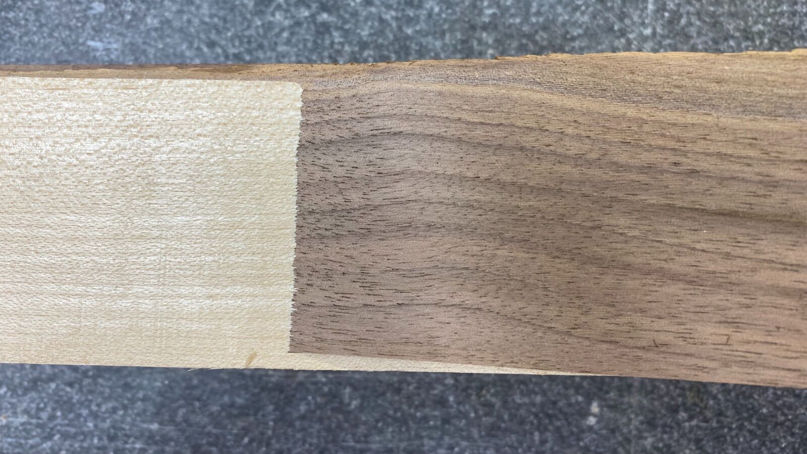

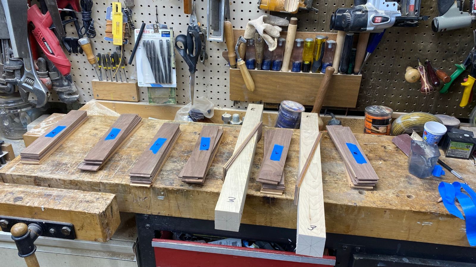

I finally got all of the cherry and walnut inserts sized for the rolling pins. Mimi is happy that the drum sander is put away.
The next steps involve gluing and slot cutting. Each maple blank needs a 3/8" diagonal slot cut for the inserts

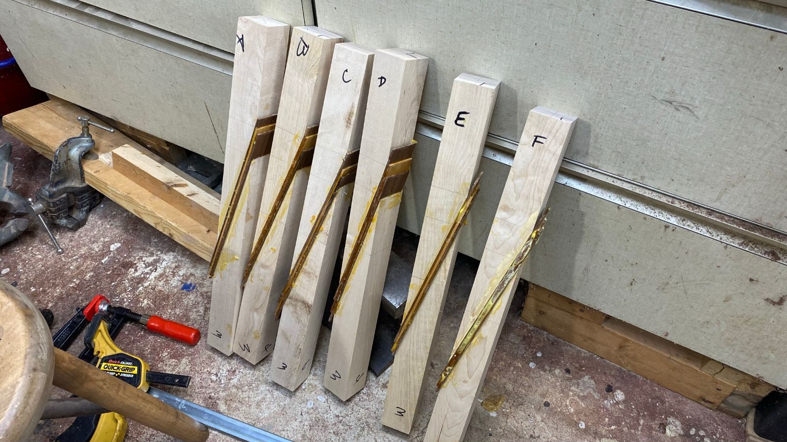

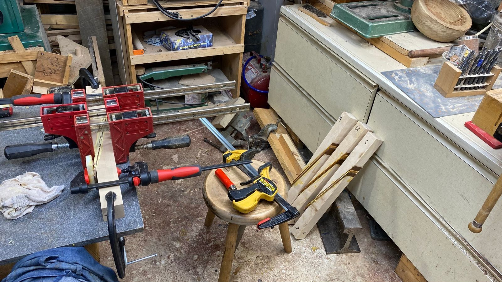

Next the 3 inserts are glued and clamped into the slot. An hour in the clamps and then I usually give each slot glue-up several more hours of drying time before moving on.
Six blanks with the first set of inserts glued into place.

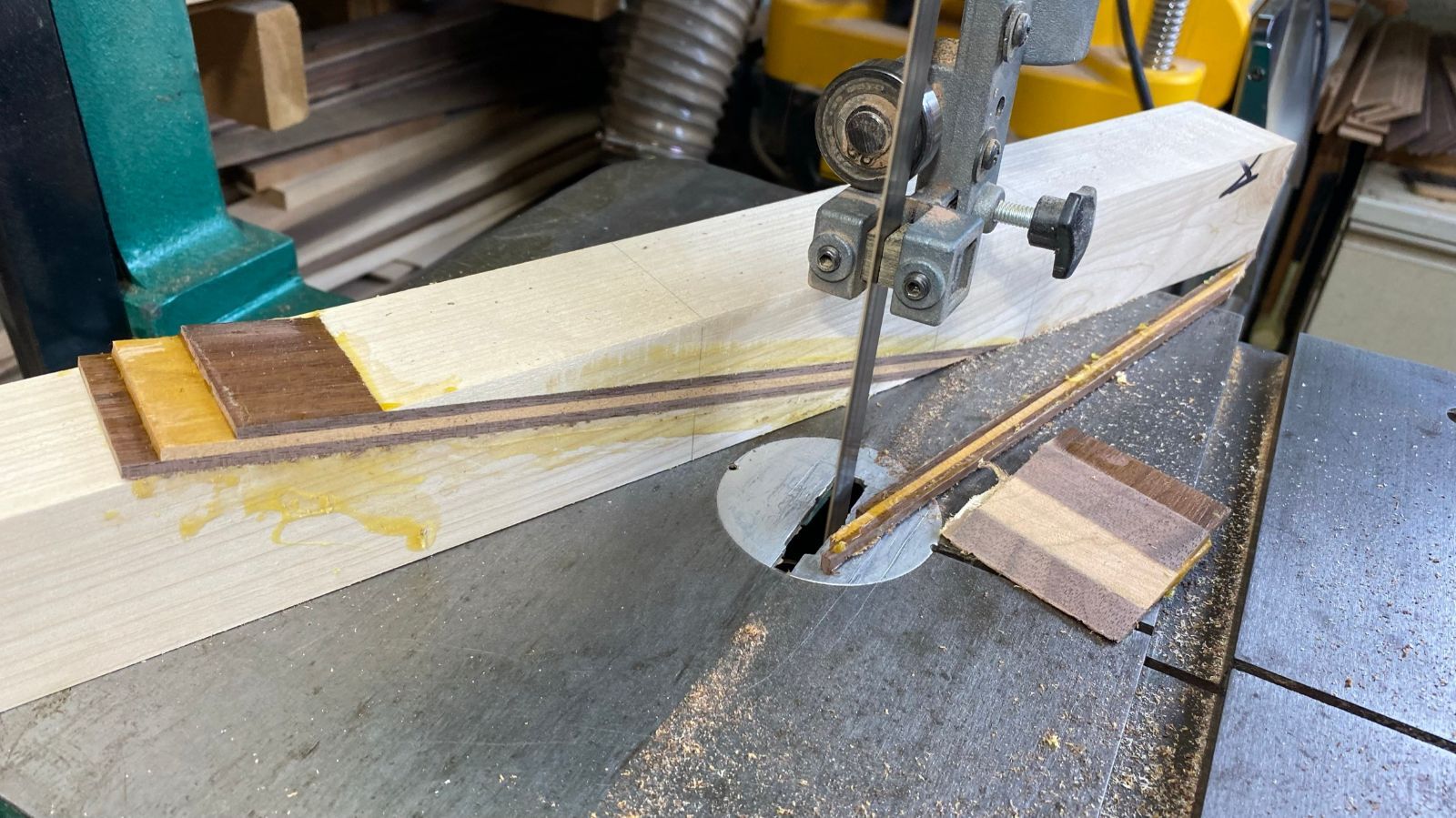

The inserts are slightly oversized in both length and width. Being slightly wider than the maple blank makes for easier positioning/clamping in the slot. But, then that requires each glue-up to be trimmed before cutting the next slot. If left proud of the maple blank, it will not set accurately in the slot cutting jig. I used to do this trimming on the table saw but the band saw works just as well and there is no need to constantly reset the table saw blade between steps.

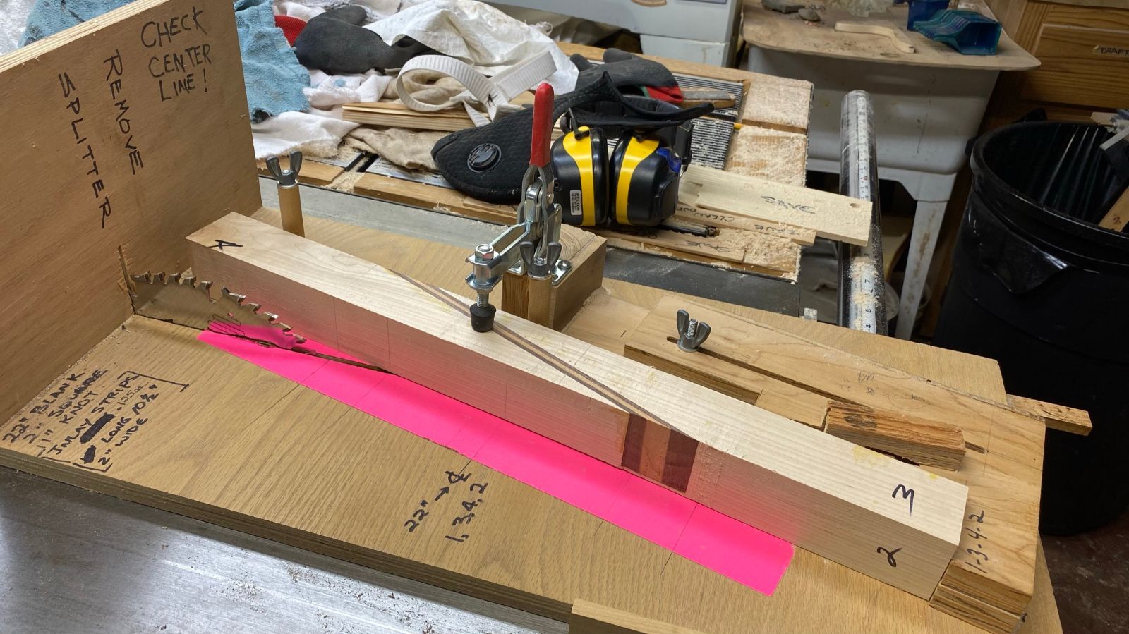

Once all of the maple blanks are trimmed, it's back to the table saw to cut the next slot.
These operations are repeated until the maple blanks have inserts glued in place in all 4 sides.

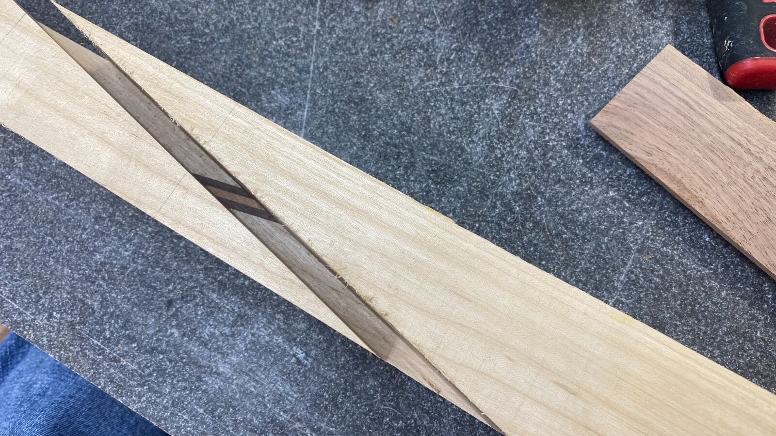

Lew thanks for the mention. You just keep finding these videos. Now you have got to give us more progress photos. Now I have a question. You mentioned cutting a slot but the cut is a thru cut, so are you taking out 3/8 or just making a thru cut? If you do take 3/8 would just a thru cut do the same?

@Gerald I guess the slot should be called a deep dado as it doesn’t go completely thru the blank. A8E5181F-C71F-4973-87E7-4CC269B7182B.jpeg.6c48819de0ea472de0ac1bd96a9ecad1.jpeg
the reason for not cutting completely thru the blank is to keep the pieces aligned. If completely cut, it is super difficult to clamp and glue so that the Celtic knot sections line up around the rolling pin
