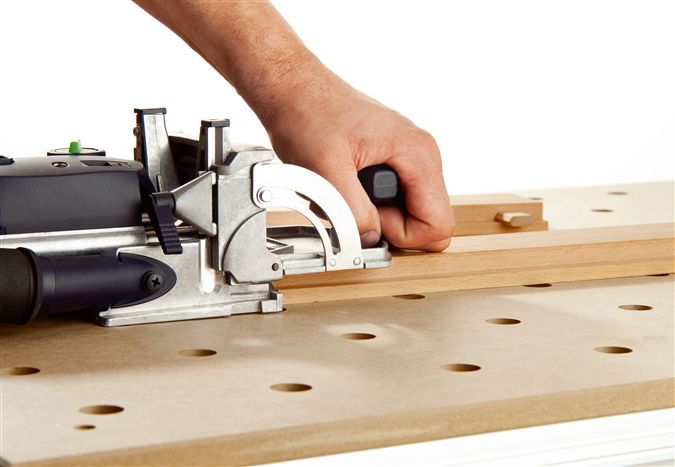

Dust collectors won't pick up if the small ports not enough vacumn. Now a shop vac will. It's like this on small power tools like the Domino ,biscuit jointer but the Delta ras has I believe a 2" port were the powermatic band saw has a 3"...

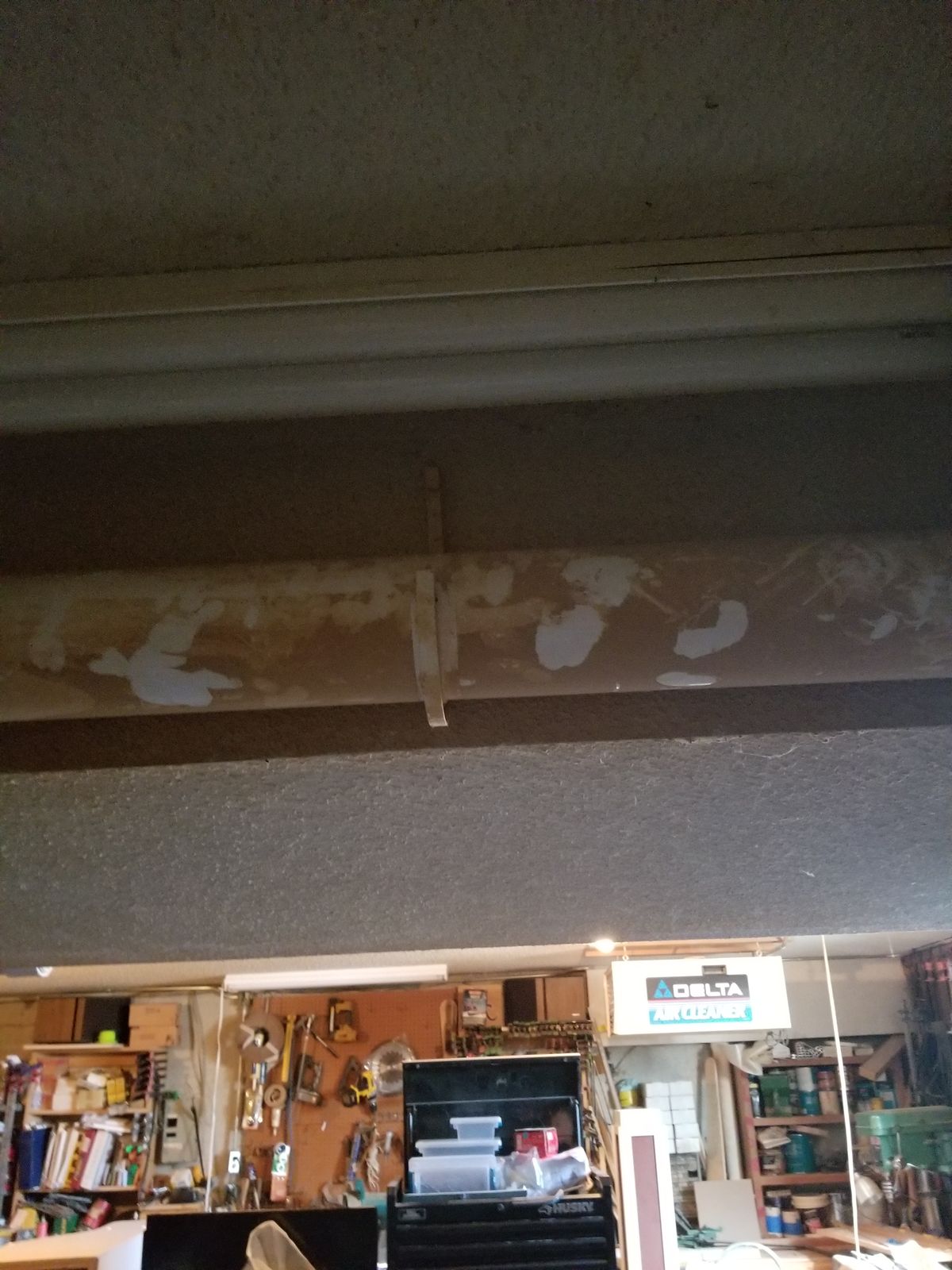

    Ok so I have changed the layout of my shop from the original post, Now I have not changed much in the 1.5 years that it has been set up.  Here is a new picture of the shop layout and of the dust colle

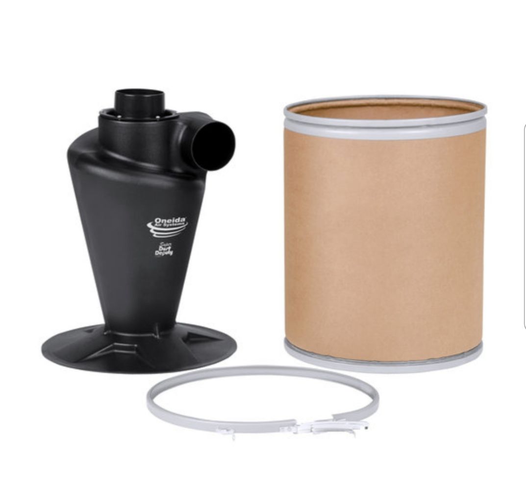

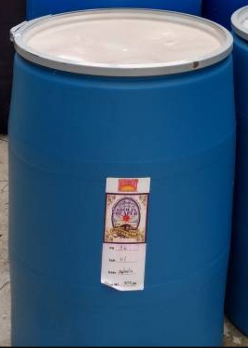

Another question I have a oneida cyclone 4 in. kit that comes with the 15 gallon barrel. The base of the cyclone is like 16 in. diameter and kinda has a flair to it. I am thinking that I want a larger barrel.
Would it be an issue if there is actually a small lip under the edge of the cyclone. I understand that this lip might catch some of the chips but will it affect the function.
Attached is the onieda cyclone kit Ihave and the 55 gallon blue barrel I want to use.
Larry you know that barrel will be very heavy if you fill it. Mine is the next one up from your and I think my barrel is 25 gallon. The base on this one is less than the one you show. It has an area that is what I would call a space at the junction but the seal takes care of that and has not been a problem. I have only had this this year so no long term experience.
Yea I know it will be heavy if full, it still gives me more room even if I only fill it half way.
The bottom of this cyclone is actually the lid for the barrel that came with it.   I just went and looked at the cyclone again and there is actually about 1.5 - 2 in. flat ring (the edge) which should allow the cyclone to sit flat without very much of a lip.

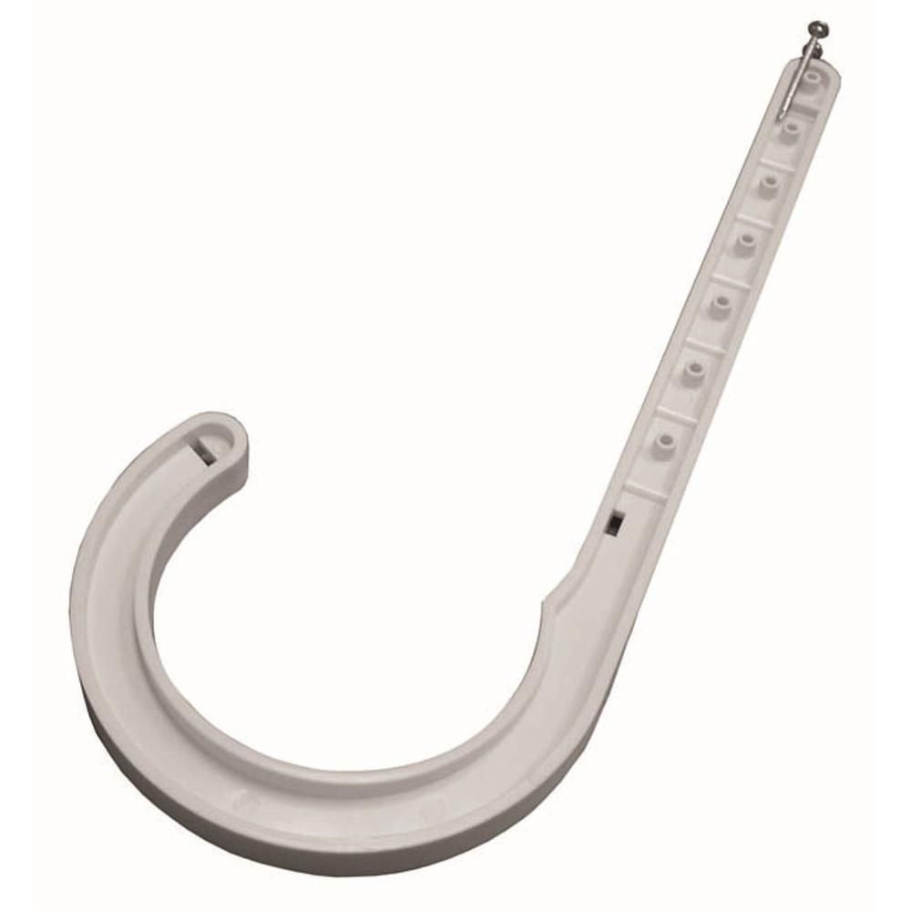

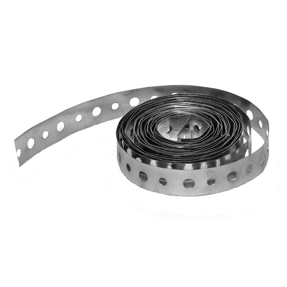

ok another question, what is everyone using to hold there pipe to the walls and ceiling?
Depends on whether you use plastic or metal but they sell pipe strap at the home depot,etc..
Or pvc hangers...
Edited by BillyJack

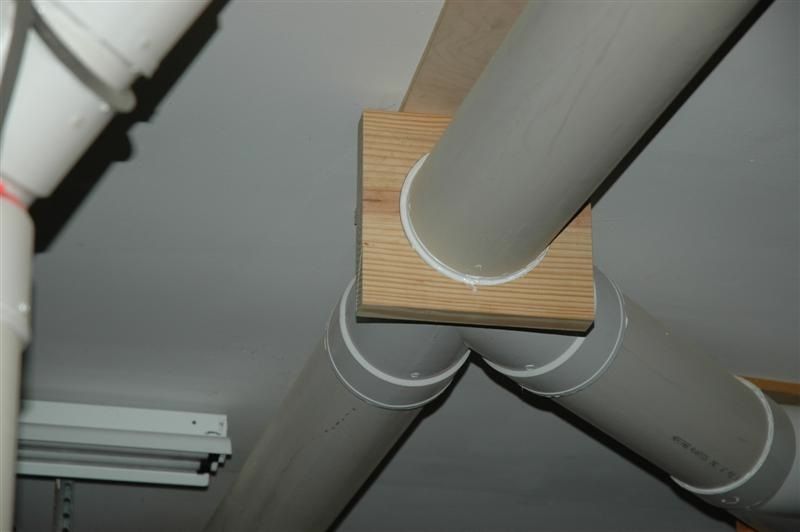

In the past I made wooden hangers, and found them to be a fair amount of work. Making them wasn't too hard but hanging them and then placing the pipe was a small headache (pic below). In the current shop I went a different, and easier, way. I screwed a small piece of 3/4" thick wood to where ever I wanted a hanger. To that I screwed a small piece of 2x stock that had a small groove on the top side of it, the 2 pieces together gave me a little over 2" clearance to the ceiling, and the groove allowed me to slip a duct hanger strap into it. The duct hanger strap looked like a zip tie on steriods, they come in various lengths and easily went around the 6" pipe I used. Using these allowed me to make a large loop, then slip the pipe into it and line it up with the preceeding piece. Then tightening the strap clamped 'er down. In the second pic you can (almost) see the hangers.

Fred does it still look that clean. I think that is the most ingenious hanger I have see. I used galvanized wire (have a lot of clothes line wire) and bent to shape but required 2 screws and was a pain to fins stud or use inserts.

I do think that grounding can help with static shock, but I don't have any (static shock) in  my system. If I don't have it others may not either. Seems like waiting to see if it's a problem before you ground it would be a good approach. Even then, you might get away with just grounding the areas where you get shocked instead of the whole system. Using the duct straps for hanging wasn't my idea, someone on a forum (forgot where) suggested it, the wood blocks was just to make the process easier. What surprised me was that the straps weren't really all that expensive and they hold (rated) a few hundred pounds.  As you guessed, it isn't that clean anymore.
As far as using the blue plastic barrel - yes, go ahead and use it.   Get yourself one of those 4-caster dollies from HF or one of those 4-caster large tool dollies and put the barrel on that.   Then roll to wherever you need.
