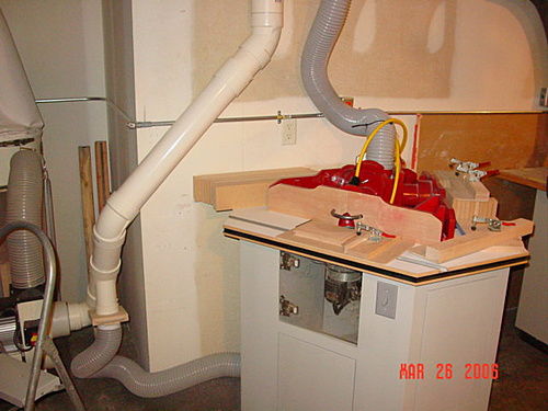

You can see the JET 1.5 on the left. I believe it is the 1100 version.15 years old and still kickin.and I've not been nice to it....
Edited by BillyJack
