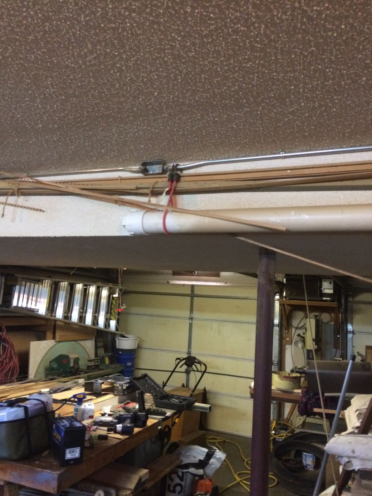

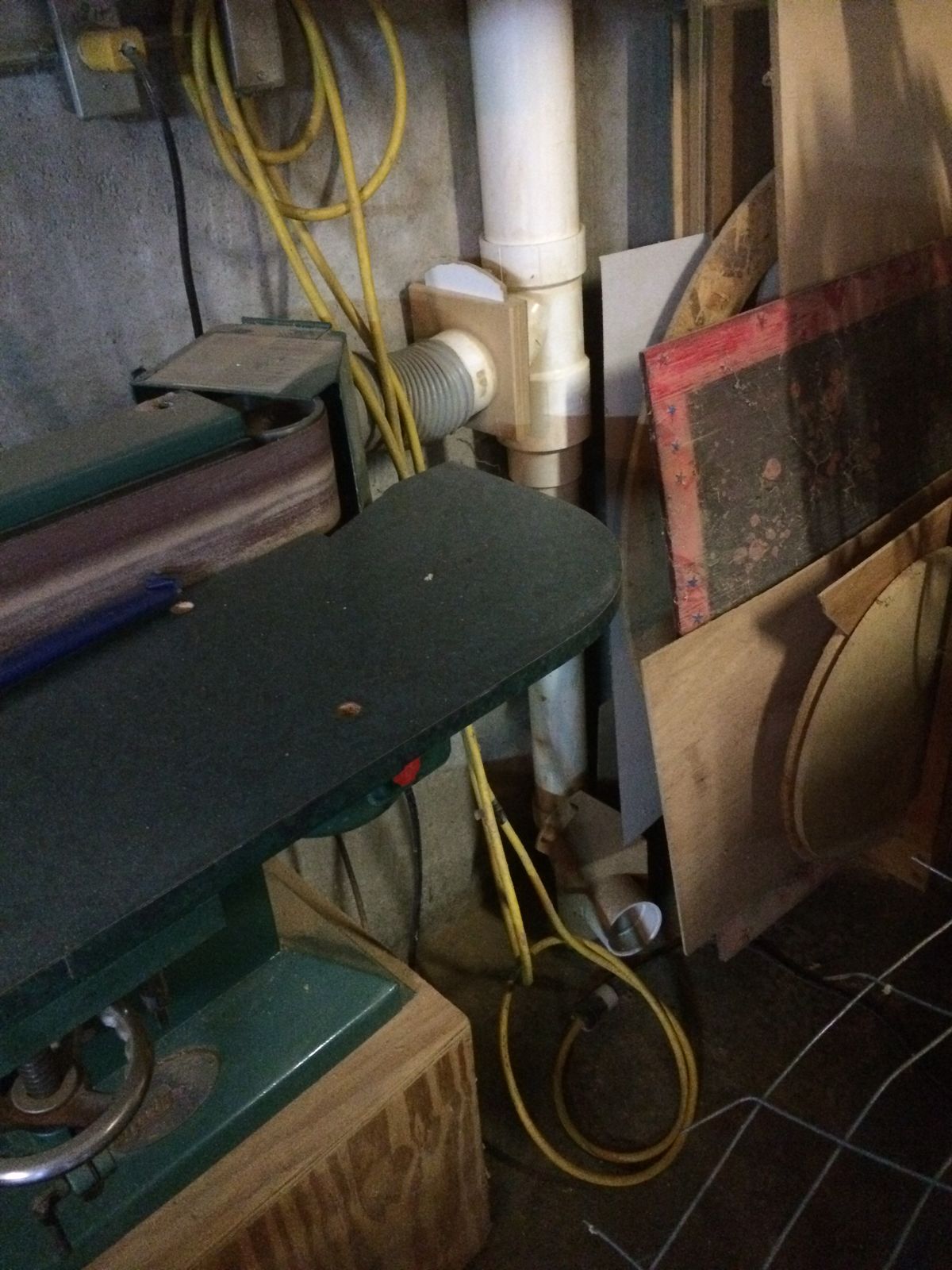

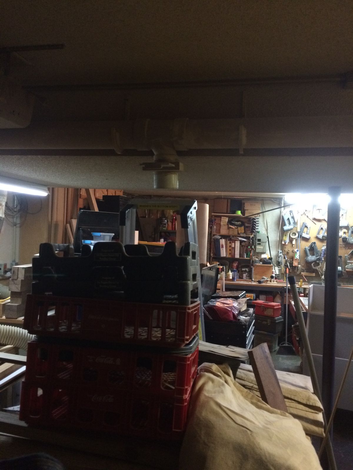

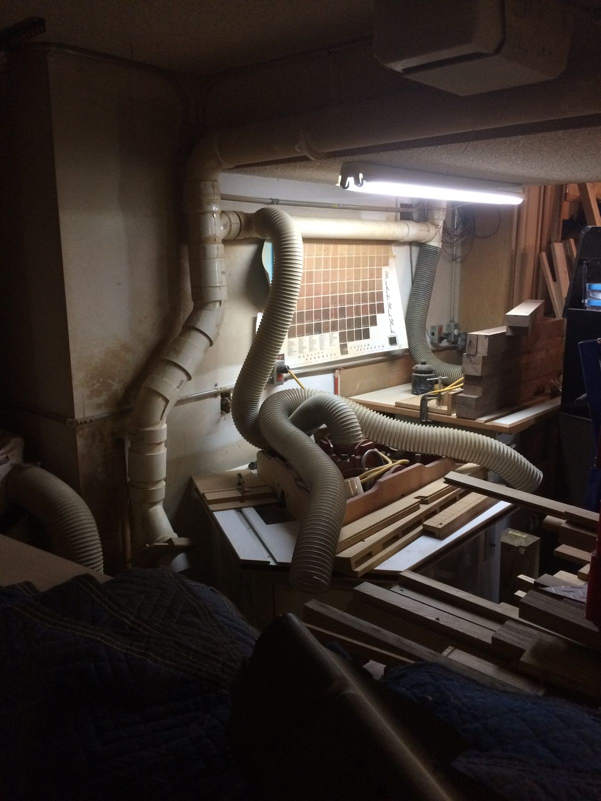

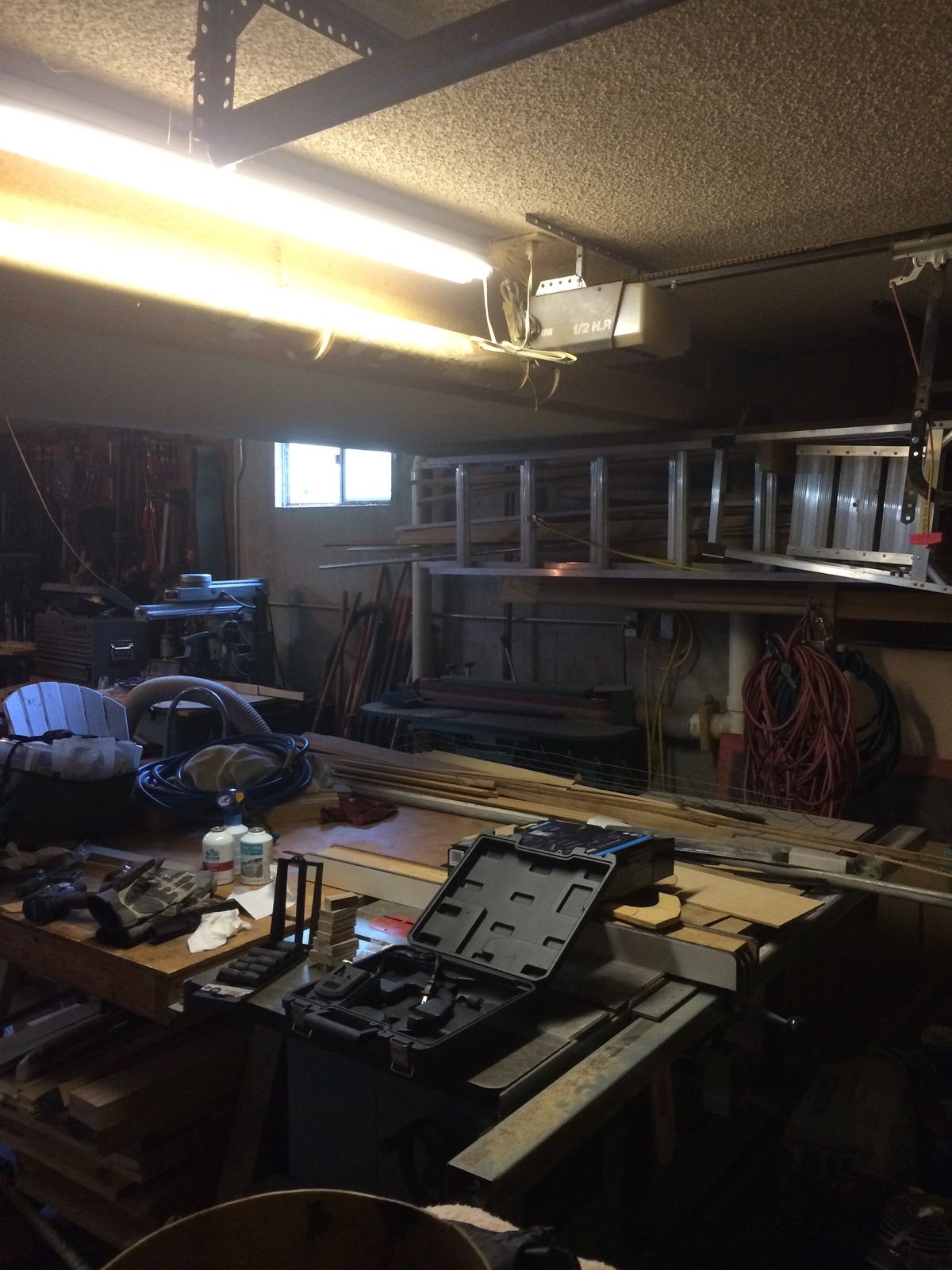

    Ok so I have changed the layout of my shop from the original post, Now I have not changed much in the 1.5 years that it has been set up.  Here is a new picture of the shop layout and of the dust colle

I by no means have a perfect system but it keeps the tools cleared. Don’t beat me up too much
