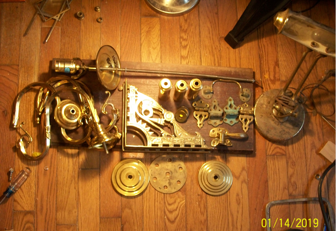

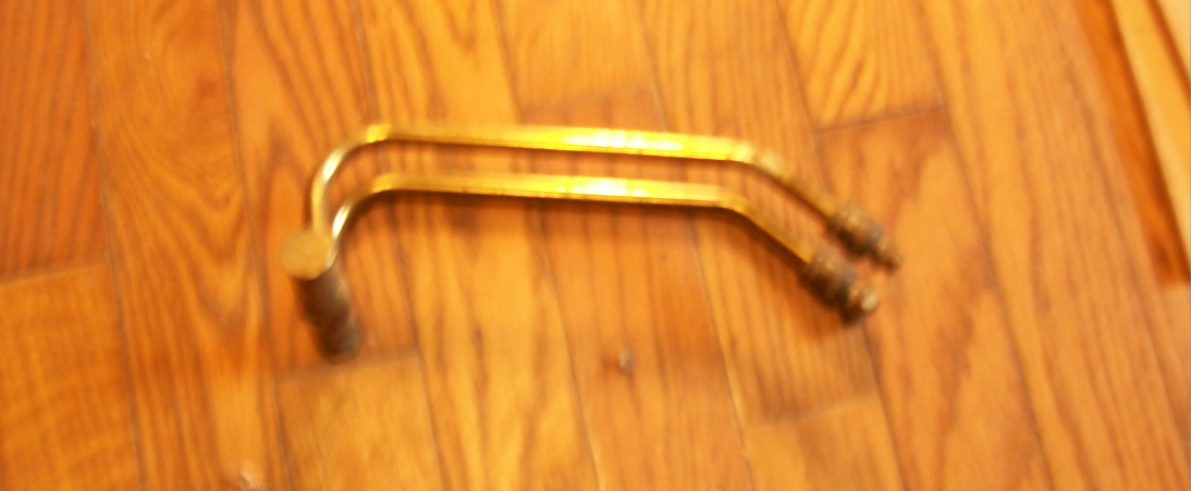

Today I started doing some things with the pile of brass I've been accumulating.

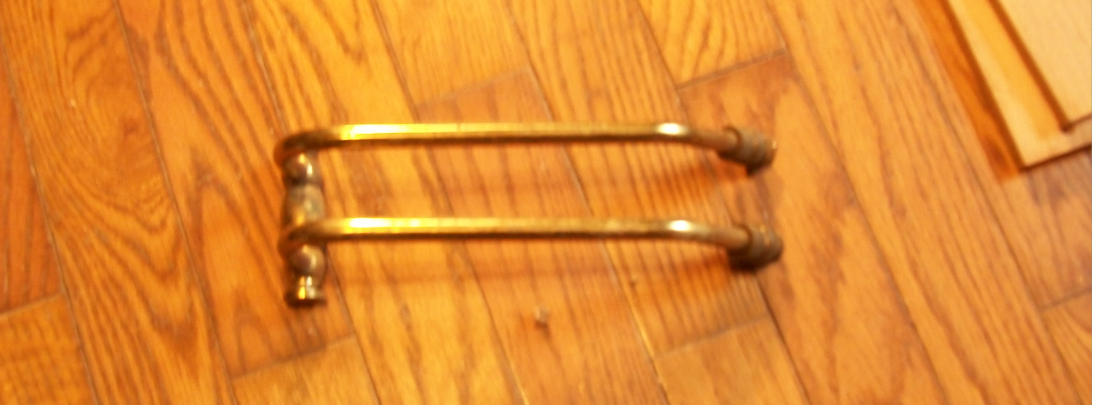

Being that this is not one of those light up keyboards, I decided the keyboard needs a proper lamp. The cruddy desk lamp to the right of the pile gave up its arms for this project. They are the only parts of the lamp that are solid brass. The rest was brass plated steel that had some rusting.
The original lamp shade was a bit big, and rusting so I made a new one that will have LEDs powered by the PC. These are the parts I used to make the new lamp shade.
I used two of these assembled onto an all thread lamp pipe.

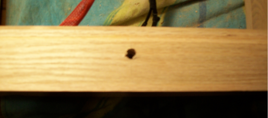

I then drilled a mounting, and wiring hole into the front top edge of the PC case.
I drilled two holes for the arms as per the original shade mounting method.

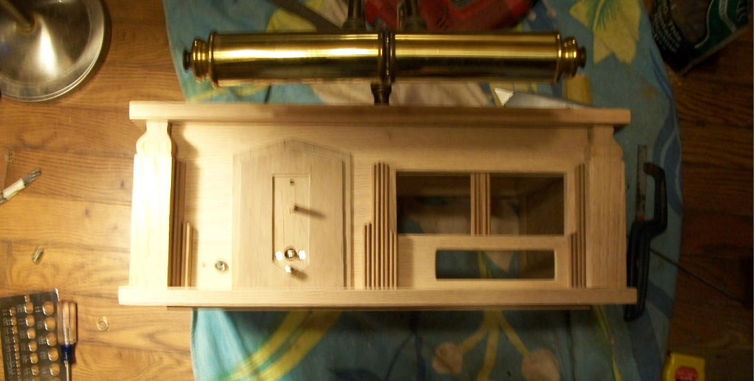

Here are a couple of views of the lamp being mounted.
And here is a view of the lamp over the keyboard/trackball tray.
I still have to drill the light emitting holes, and wire the lamp along with polishing the brass, but I think it looks pretty good.

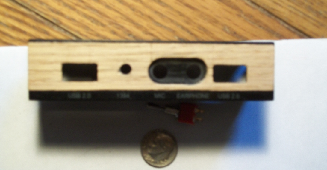

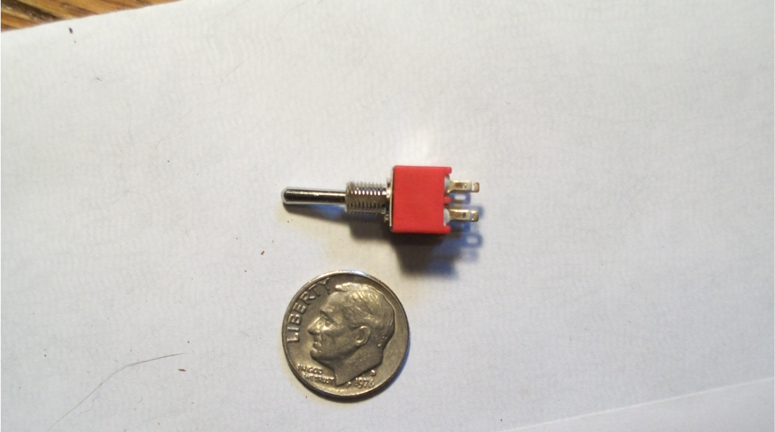

Since I'll be using my old (Windows 98 Days) Cambridge SoundWorks Desktop Theatre 5.1 Surround Sound Speaker System, I'll need a rear channel output for connecting them to the PC. The MSI B450M PRO-M2 motherboard uses the front panel headphone jack for the rear channel output. :CoveringEyes:
I don't want to have a cable constantly sticking out the front of the case. :( But I do want the availability of the headphone jack. :ChinScratch:

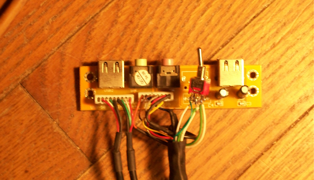

So, I decided to add a rear jack that ties to the front headphone jack. Since these jacks have a switch incorporated into them that signals the motherboard that something is plugged in so the motherboard can decide whether to cut out the speaker system or not, just wiring in another jack just wouldn't do the job. :PullingHair:
So here's a look at what I came up with.
I used a DPST Sub-Mini toggle switch to switch between the jacks.
Which will be located in the second hole from the left.
Here is a look at the switch wired into the circuit.

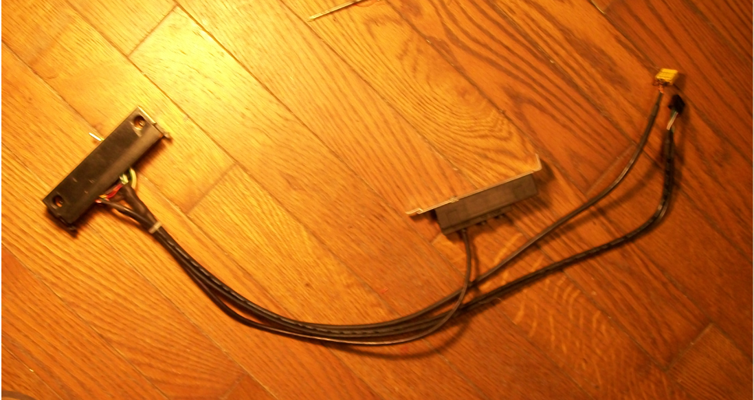

The rear jack came out of the Compaq donor case, and is mounted to a rear expansion slot plate. I'll be adding more to this slot plate for the LED lighting, etc..
Now I have the availability of both front, and rear jacks that will allow me to leave the rear channel plugged in, and also be able to use the front headphone jack. :TwoThumbsUp:
