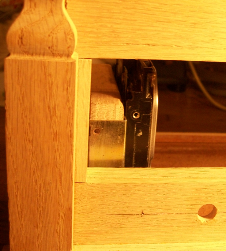

You take a look at figuring out how to mount the 3.5" Hard Drive in a somewhat tight for space case. :unsure:
There wasn't enough room in front of the motherboard to mount it without standing it on it's side which blocked the view through the front beveled glass window. :CoveringEyes: ... No that won't do... :(..
The area behind the power supply?.!!! :huh: ...
Well now what have we got to work with? :WonderScratch:
First we'll need a metal bracket, or brackets for mounting the Hard Drive in a space only 5" wide. <_<
5" wide means the 3.5" wide by 5.75" drive would have to stand on end, and would leave 1.5", or .75" for outside of the drive per side for mounting. :ChinScratch:…
What about inside mounting of the drive bracket, with easy access to the drive?  :blink:..
Let's see now, if I take these 3.5" X 5.25" drive bay adapter brackets, rotate the brackets 90° and mount them to the bottom of the hard drive like so...
We get 4.5" between the brackets!!! :TwoThumbsUp:
Now how do we go about the easy access mounting?

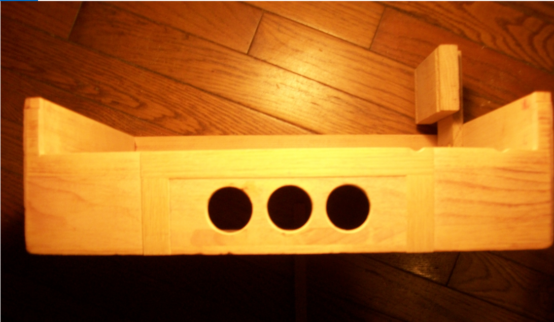

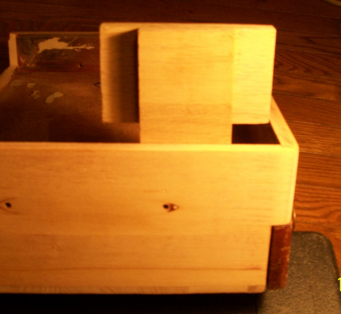

What do we have in scrap wood that might work...3/4" X 2 5/8" X 6"...
Cutoff from making top case sides 1/2" X 5 1/2" that's 2 1/2" wide...
The 3/4" X 2 5/8" was cut down to a length of 4 1/2" to fit between the metal brackets. It had to be grooved to clear the Hard Drive mounting screws. The cutoff was cut to a length of 4 7/8" The two parts were then glued together to form a T.
This is how the wood T fits into the hard drive metal brackets.
The wood T bracket gets mounted into the top of the Silver box like so...
Rear view...
Hard drive, and metal brackets slide onto the wood T. This photo taken with Oak top of case set in place.
It's a tight fit, but leaves enough room to connect cables, etc..
This is the view from the front of the case...

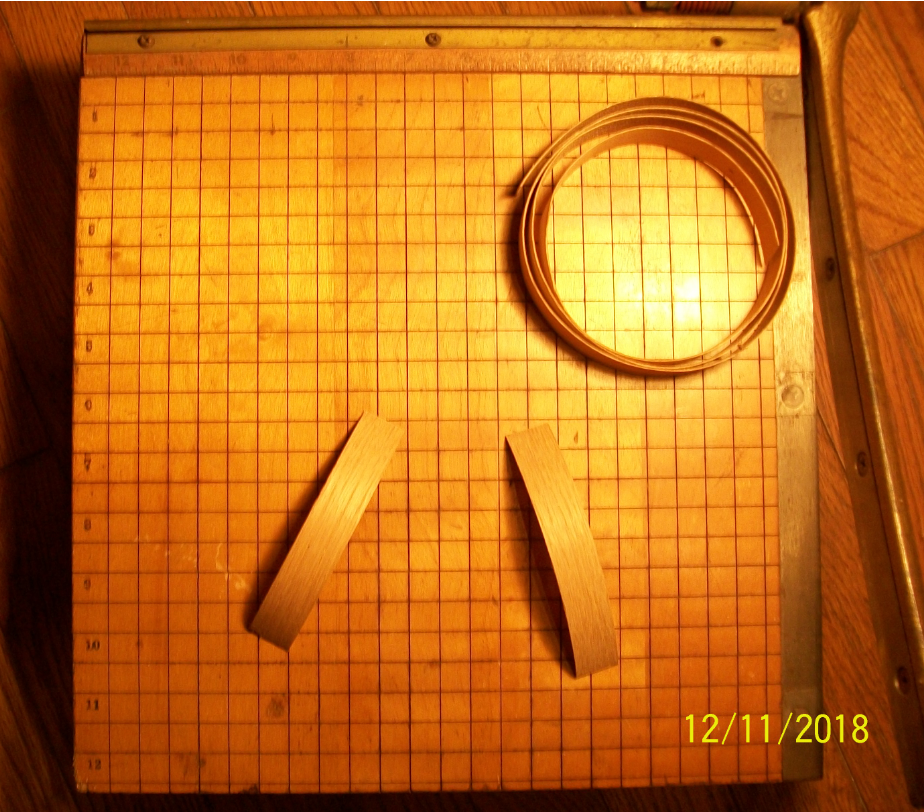

While I was at it, I discovered that the inside of the upper case section was just slightly larger than the Silver Box.
I fixed this by using more of the iron on edge banding.
The strips will be affixed to the lower, and back edges of the inside of the upper case section.
I use masking tape to hold the banding in position for ironing it in place.
And here is one of the almost finished sides. I ended up running two strips next to each other in the back, to fill in around the metal computer case, but didn't take a photo of that.
The bottom edge strips line up the insides of both the lower, and upper case sections so that I can run a cleat down both sides to attach the two case halves together.
That will be one of tomorrows projects.

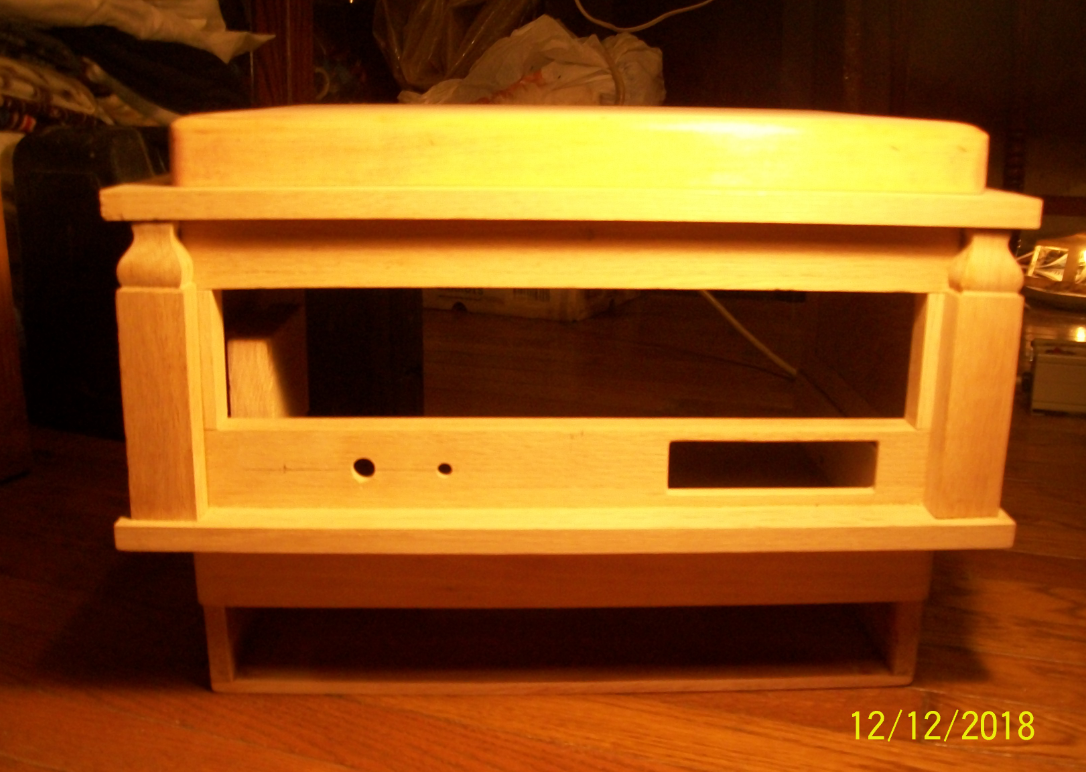

Tomorrow again, so time for my daily update. B)
Today I got the holes drilled for the lower case vents. I also surrounded the area with more of the iron on edge banding. The banding frames the edge of a metal grate I cut out of the Compaq case side panel.
I also framed off the top of the upper case section.
I used 1/2" X 1 1/4" Oak strip for the front, and sides. And a piece of 1/2" X 3/4" Oak strip for the rear edge.
This is how the front view looks.
Here's how the lid will fit.
This is the two case halves stacked, and with the lid.

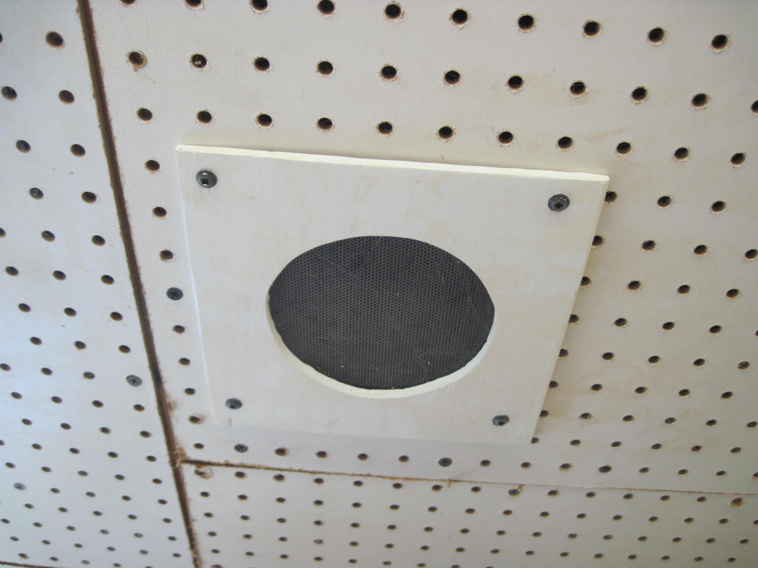

Did the same thing for my speaker covers in the ceiling of shop.  One's man junk, another man's treasure.
