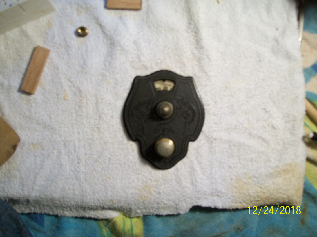

Todays progress report.

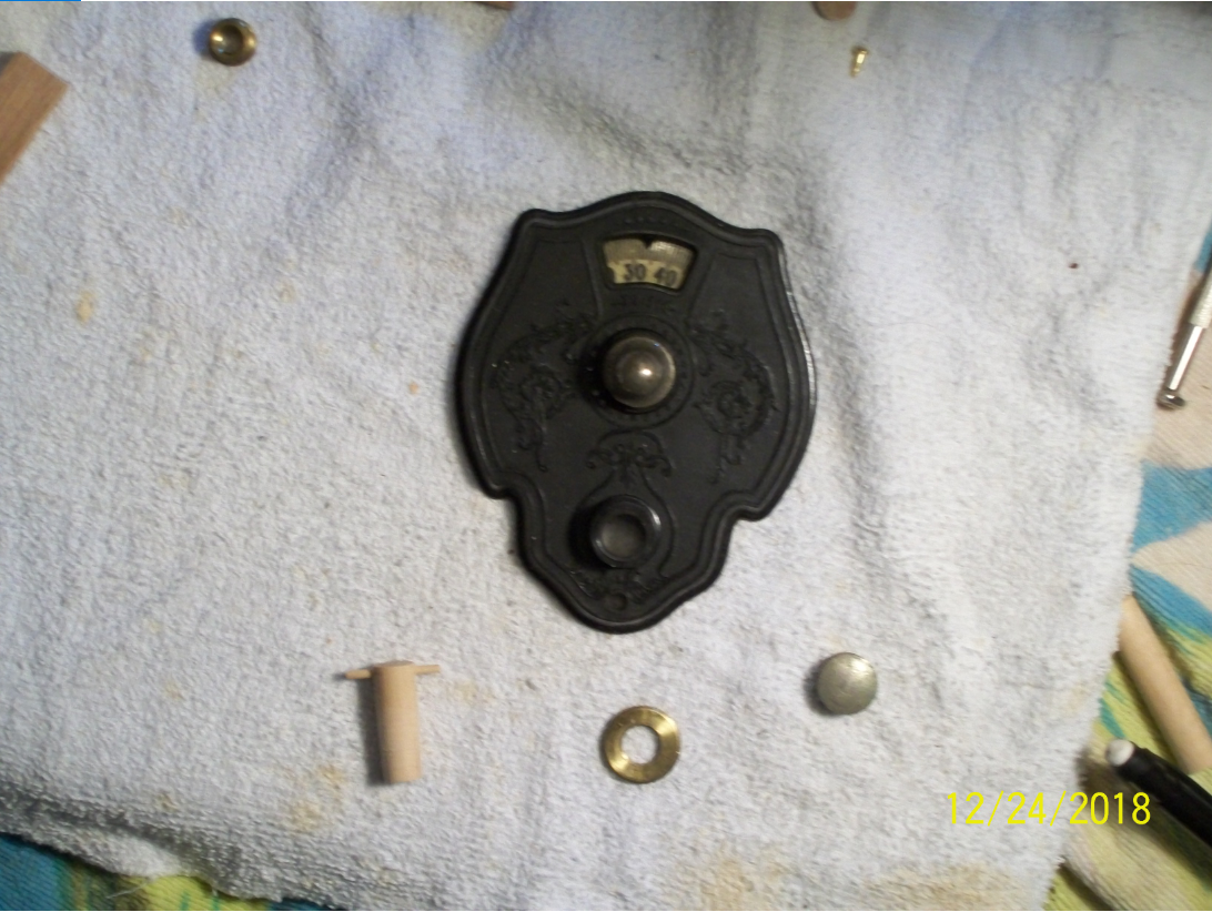

Today I made up the plunger for the power switch, which is now located under the old radio dial. I tried a few different approaches at accomplishing this. From trying to use lamp parts, to settling on a combination of lamp parts, and wood. This photo shows the parts I decided to go with.
Rear view.
This is how I made the plunger. The stop rods are toothpicks.
Toothpicks trimmed to fit radio dial.
They act as stops to keep the plunger from coming out of the front of the radio dial.
I then trimmed the shaft to length for activating the switch.
This is the assembled unit.
It will be activating the power switch which is now located here in this photo. You can also see the hard drive LED crystal bezel, and the red button for the reset switch. The hole above the switch is for the power LED.

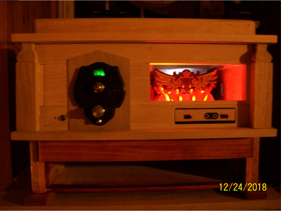

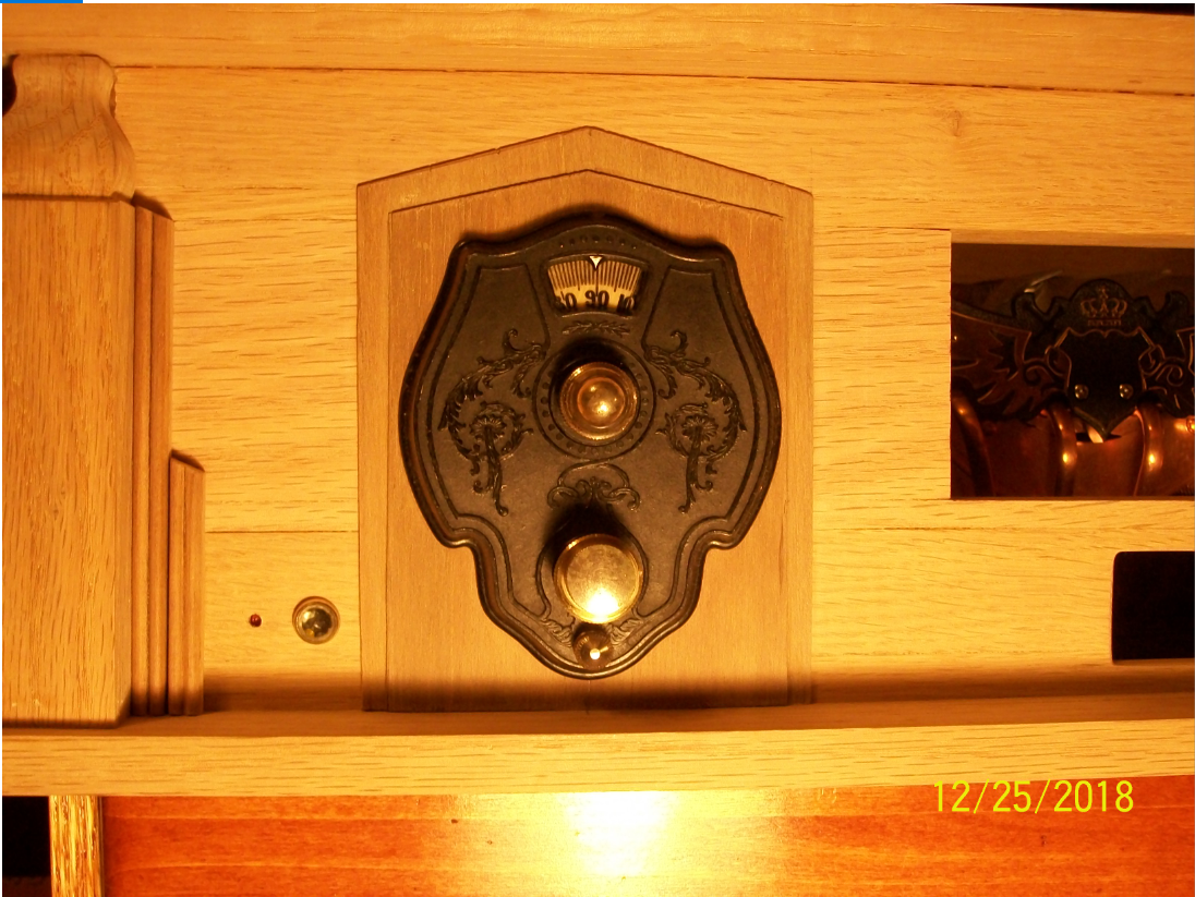

Here's a look at the dial assembly mounted. @Grandpadave52  Tuned for listening to "Animal Stories" on 89 WLS Chicago. :P
And here's a look at the dial lit up.
Love it!!!  The "patch" is perfect with the dial...can't get much more nostalgic than this.:)
This is getting more & more cool everyday.B) I never would have thunk of doing something like this. I'm entranced.:P
Man, Larry, this is an awesome retro look!
Needs an old Philco radio emblem.  Really set it off.  I know always coming up with more work.

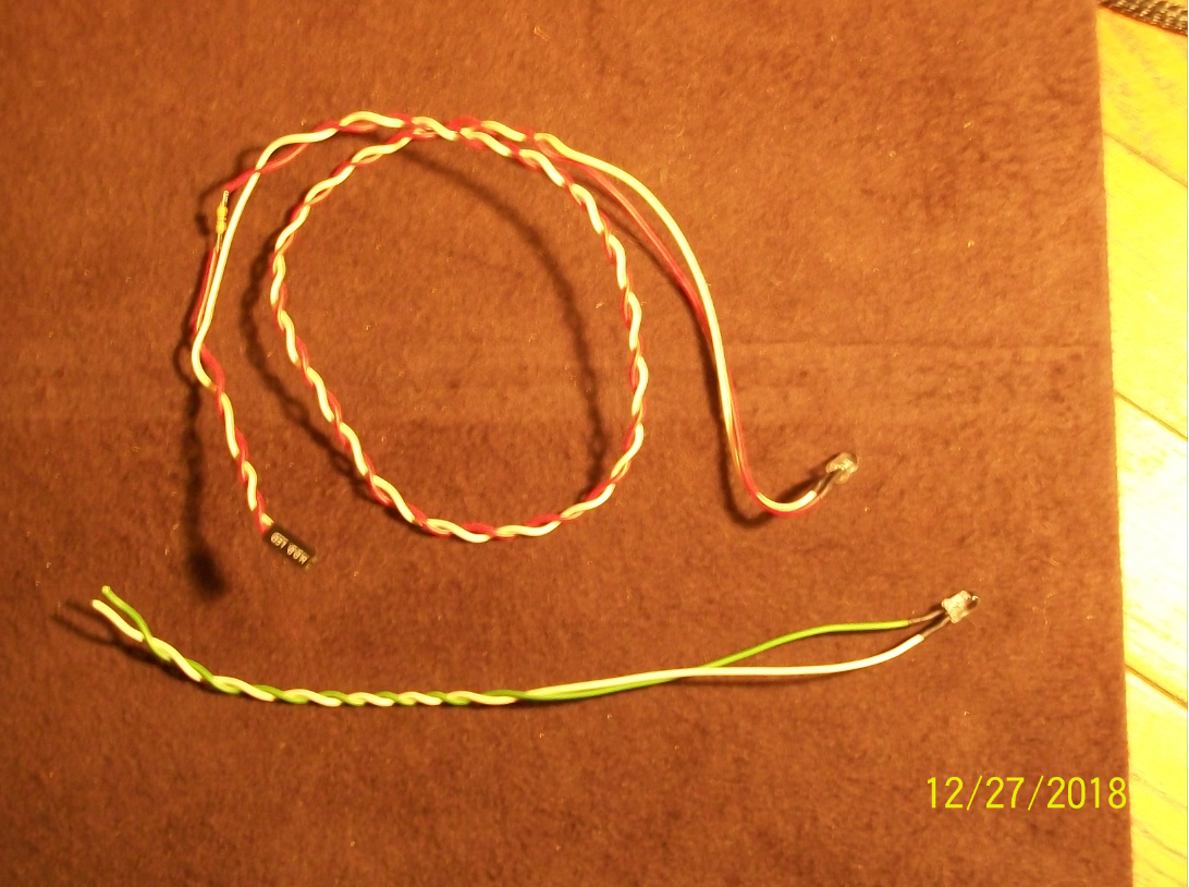

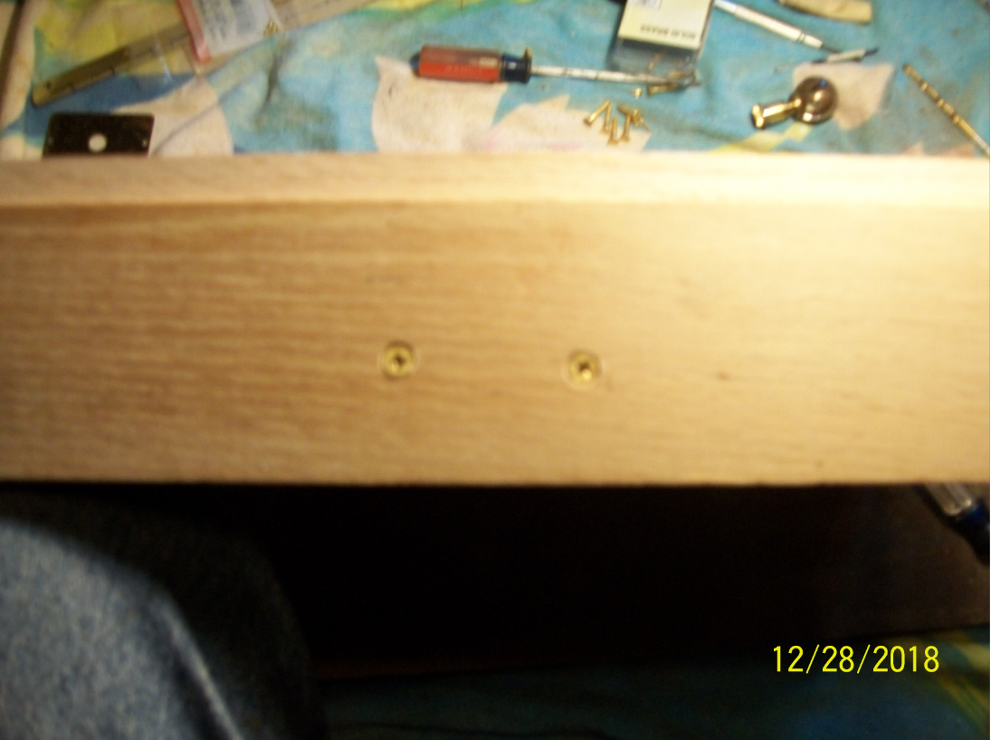

Getting the power cable from the computer motherboard required making another harness that would get there.
Which required drilling a couple of holes. One in the box lid. You can still see the original brass tag holes and the hole at the back edge of the lid.
And the other in the back edge of the upper case.
The harness the gets passed through the above hole. The plug end stays inside the case.
I'll be making an Oak chase for running the wires through, and the finished finial assembly will get mounted to it.
The two original brass tag holes will get covered by the wire chase.
