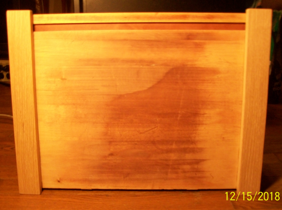

Today I changed my as to my choice of stain color, after looking at the display at Menards the Sedona Red didn't look as good as it did in MINWAX's web photo.
So I went with MINWAX's GUNSTOCK STAIN, and CLEAR GLOSS POLYURETHANE.
I got the lower case section in stain this afternoon, and so far I'm pleased with the results.
Here's a few photos of how the new color choice looks on the case.
813819338_rightsidestained.PNG.81b8344bd87b58bd4b3968c9f2406f0a.PNG102055907_rearstained.PNG.4e59b3e09afbed7a17d40fcc6b329cf0.PNG
And here's a view of the front with the drawer unstained to better show the color versus bare wood.
I noticed I missed removing some glue in spots, even after all that sanding.
I may mix a bit of the stain into the Polyurethane to help hide the missed glue.
And I didn't bother to putty the small gaps in my fit ups.
I want the case to look somewhat "OLD" in appearance, so these actually help to achieve that look.
I'll have to get some better photos taken outside to better represent the actual look of this color.
It appears much darker in these photos than it is. It might be the LED lights in the house.

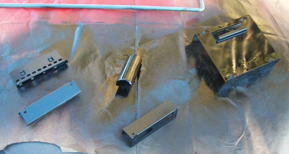

You paint the rest of the metal brackets, and the ends of the CCFL light so you can wait for them to dry! :huh:
And while you're waiting for that to happen, you stain the wood Hard Drive bracket.

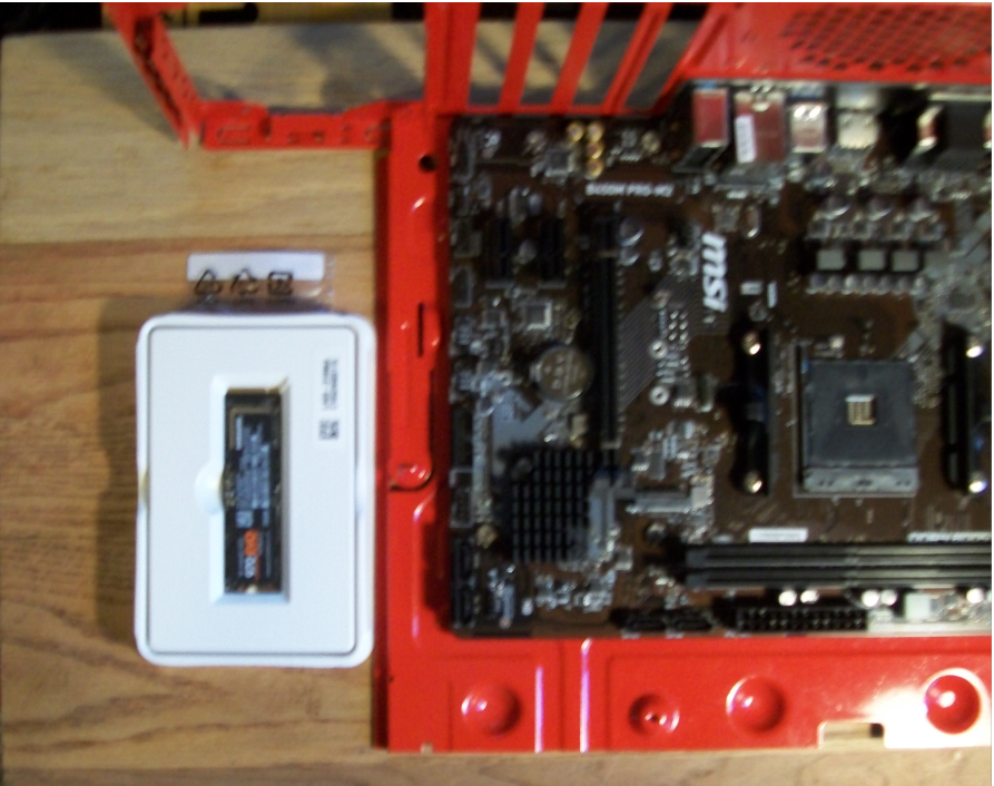

First I installed the backplate, and motherboard into the motherboard tray. The object next to the tray is the Samsung 970 EVO NVMe M.2 Solid State Drive.
This is the drive installed on the motherboard. It installs like a memory module except the connector is on the end of the drive.

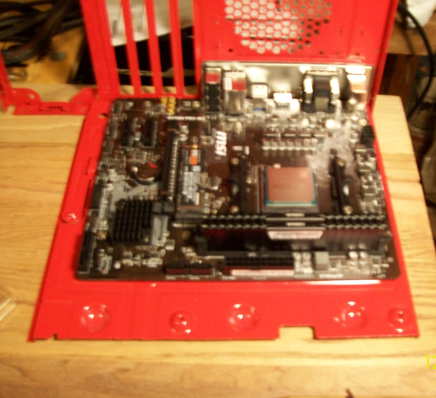

This photo shows the AMD RYZEN 5 2400G Processor.
Here is the processor installed on the motherboard.

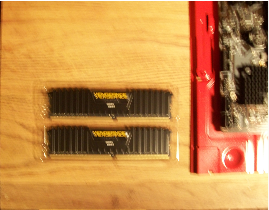

This photo shows the Corsair VENGEANCE LPX DDR4 3000Mhz Memory Modules. (Sorry about the blurry photos I've been taking 3 photos of each step, and picking the best. I've got to get better lighting, this camera doesn't like LED lighting.) :angry:
Here is the memory modules installed on the motherboard.

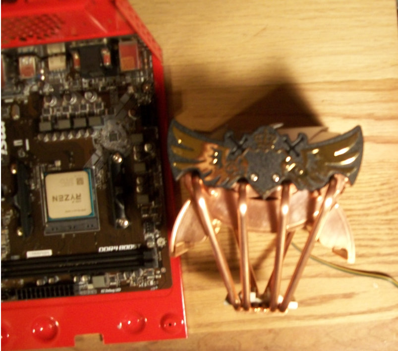

The following two photos are of the ASUS ROYAL KNIGHT CPU Cooler that I'll be using. It's actually about 10 years old, and was originally designed back in the AMD PHENOM Processor days which fit an AMD2+ Socket. The AMD4 socket is capable of using the CPU coolers from the AMD2 Socket, and up.
Looks kind of like an old tube radio tuner. :D
I haven't installed this yet, as I want to work out the power supply wiring.
Top photo.
Front photo.

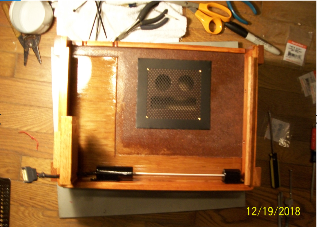

The following photo shows the 5 cables (26 wires total) removed, and the LED fan that I replaced the original with. I also replaced the cord receptacle, and power switch with one that lights when in the on position. These parts came from a dead power supply from one of my sons old computers.

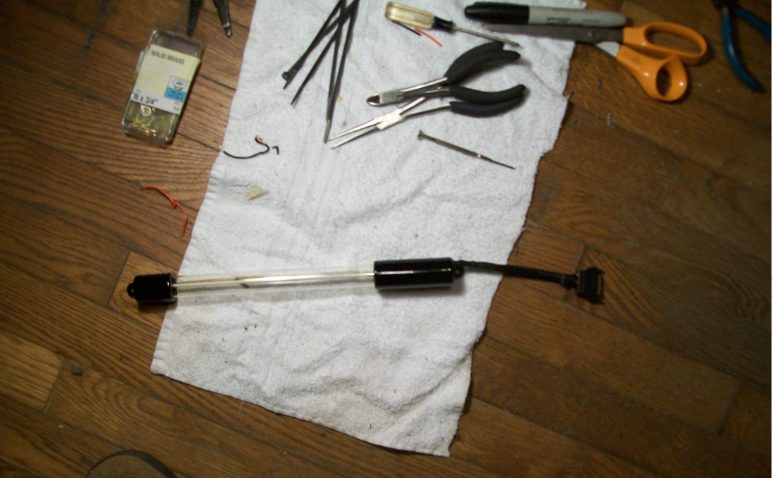

I also rewired the CCFL light so it could be plugged into a SATA plug. The cord below the lamp is the SATA plug.
Here's a photo of the completed lamp. I used a piece of the cable wrap removed from the power supply, and shrink tubing to match the rest of the wiring.
Here's the CCFL lamp, and vent grate mounted in the lower half of the case.
And here's a look at the motherboard tray, power supply, and hard drive installed in the lower case section.
