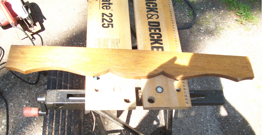

    It's tomorrow, so here's what I got done today.   This photo shows the front where I have to make a filler piece for.     This photo is the filler piece I made up.

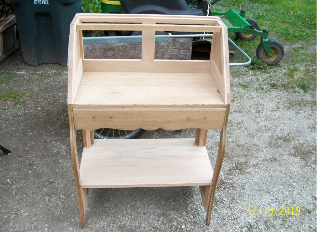

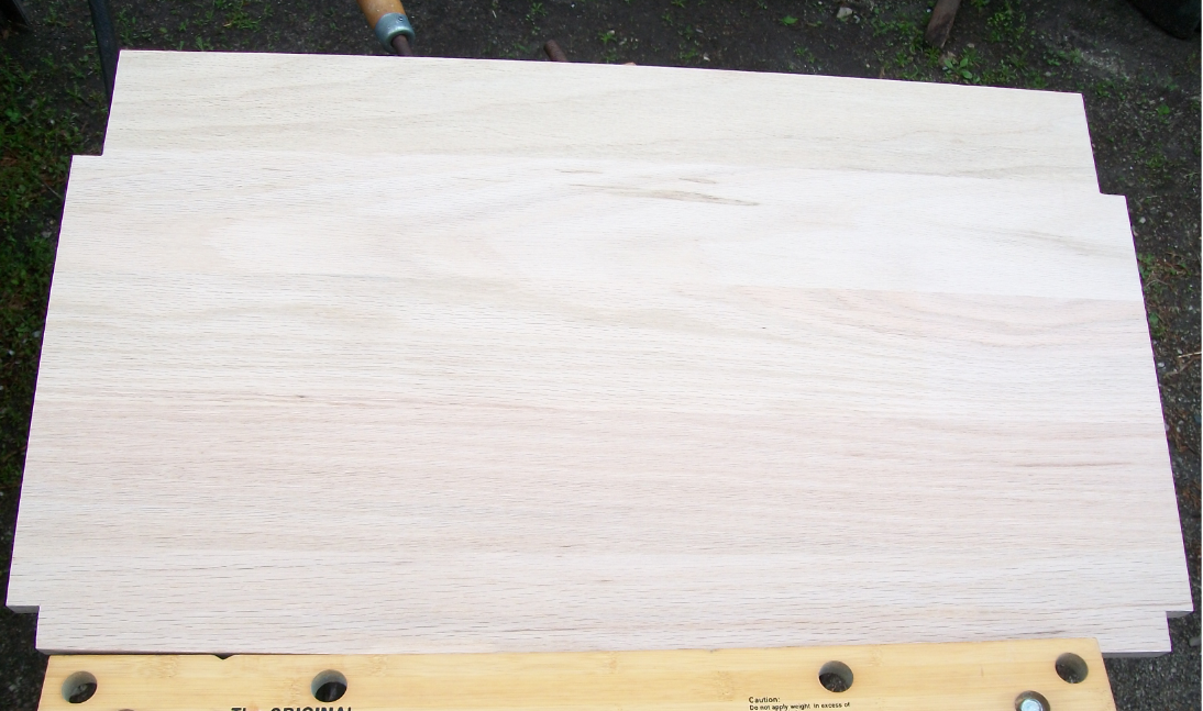

So today I cut and installed the new lower shelf. It was made from one of those glued up 3/4" X 16" X 3' panels that Menards sells ($19.99) but a real time saver. Following is a photo of the old shelf before removal.
The new lower shelf cut to size.
And the new lower shelf installed.

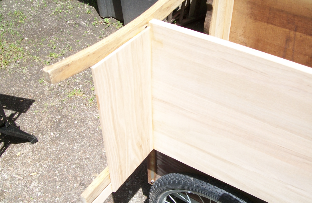

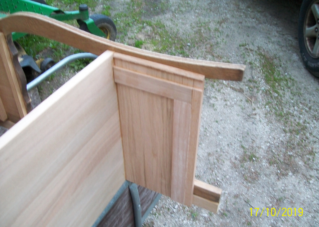

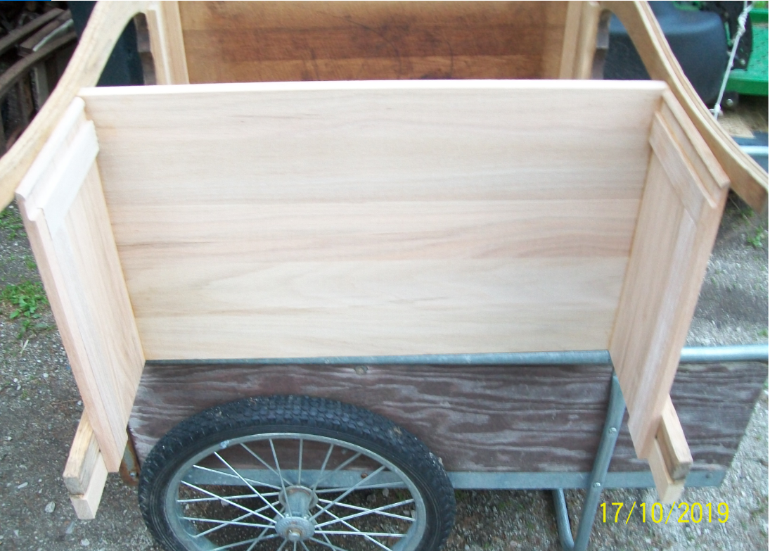

I then went about making up the side panels for the drop front printer drawer. These were made from 1/4" X 7 1/4" Oak stock.
7 1/4" was not quite deep enough so I added an extension made from 1/2" X 3/4" Oak stock. This was notched to provide clearance for the drawer front.
These got installed like so.
1497798066_PrinterDrawerSidePanelFillerInstalled.PNG.2818ef579cb5170a6f7db91148617e13.PNG
I then added 1/4" X 1 1/2" Oak stock to complete the side panels. I'll be using full extension drawer slides and they will get mounted to the doubled up lower section. I finished the front edge with quarter round to avoid end grain showing.
1892333694_RightPrinterDrawerSidePanelComplete.PNG.29a0e2dee8653013a9b9cc55628e6e47.PNG

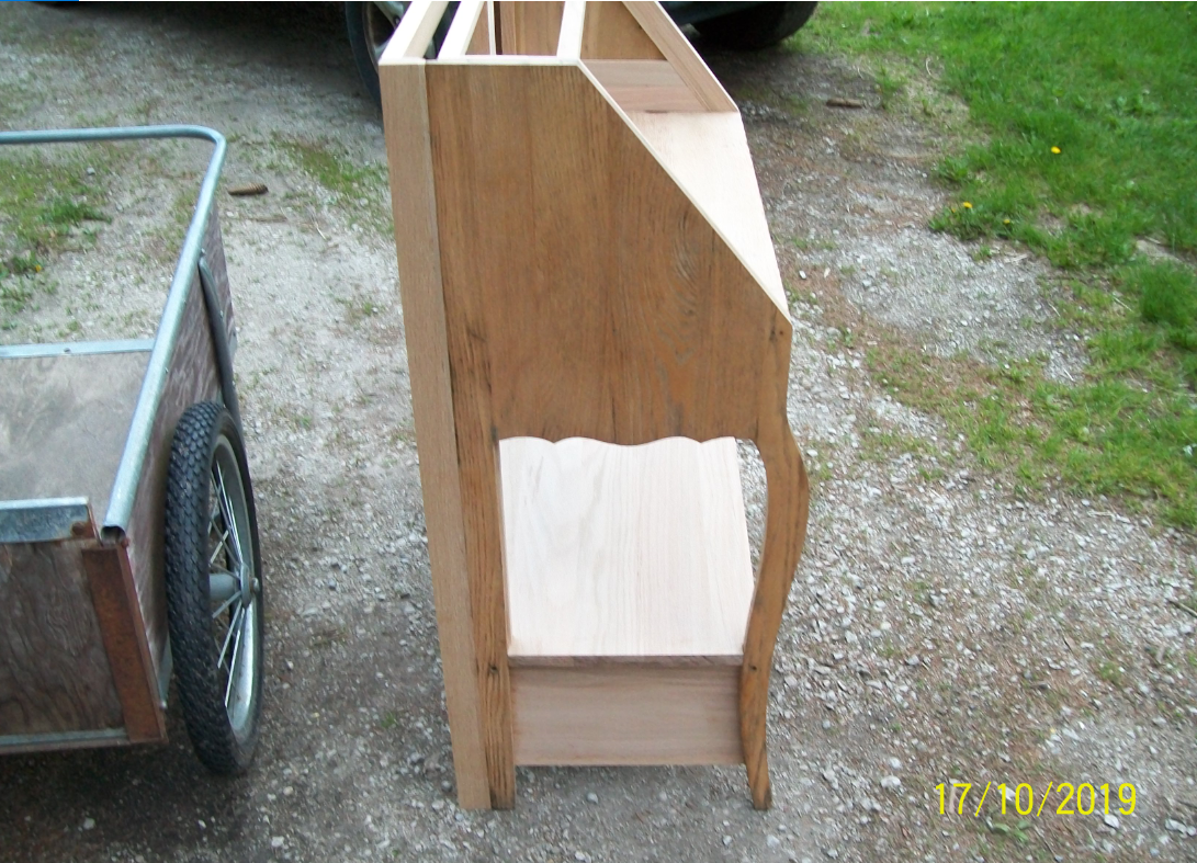

Here's an outside view of the left side.
And the right side.
And a bottom view of the completed lower section.
A view of the new shelf from the front. Notice the rebuilt upper drawer fits! :D

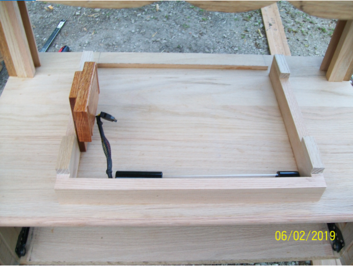

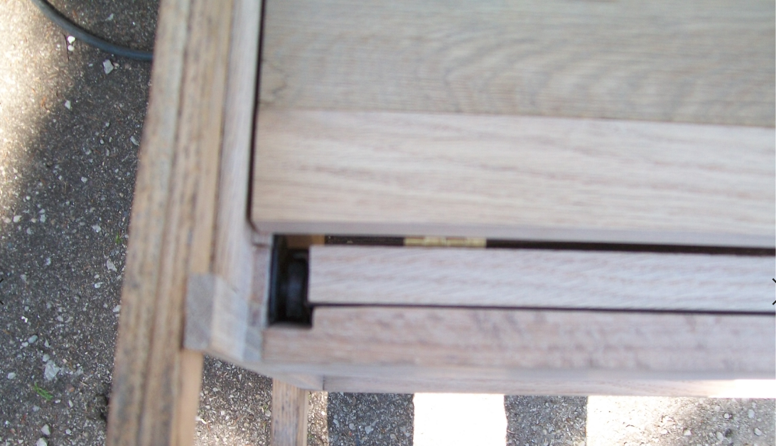

I've got a few days of progress to report today. Between playing hide and seek with Mother Nature I did manage to get a few things accomplished. Since I'm working from mental plans :blink: there were a few steps forward, and several steps back :BangingHead: along the way.
I started by test fitting the drop front printer drawer front into the opening. I ended up having to add the lower cross braces to keep the opening square. There was a slight bow to the front legs that pinched the drawer front in the opening.

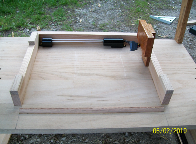

I then cut the bottom of the drawer to length, and installed the hinges.
Then went to work at installing the drawer slides. These were salvaged from some cabinet that the neighbor threw out.
This is where one of the steps backwards occurred. :huh:
I forgot to allow clearance for the ears on the cabinet part of the slides. :BangingHead:
So it was time to do a little surgery. First I clamped a piece of scrap wood to use as a saw guide.
I then used a hack saw blade to cut slots so I could remove the offending material.
I had to provide clearance at both the front, and rear cross braces. Thankfully this won't be seen when the cabinet is finished.

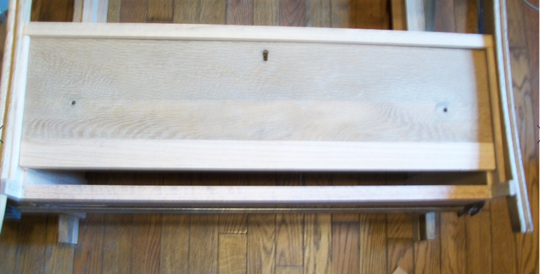

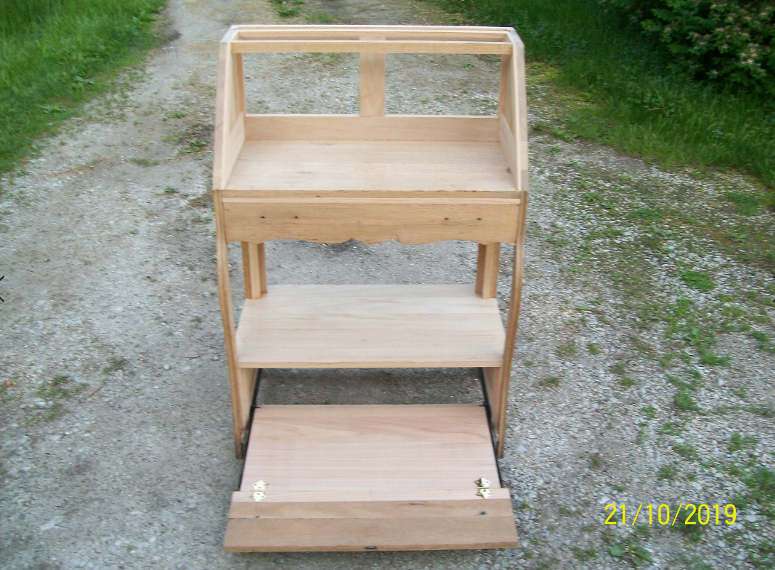

Here is the drop front drawer installed.

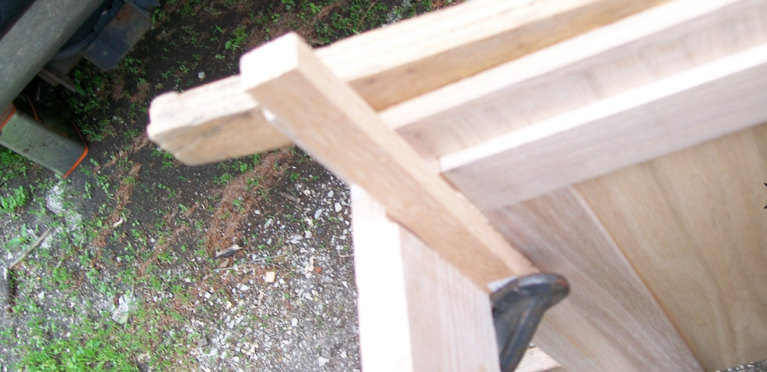

This type of drawer leaves a gap at the bottom that will have to be trimmed out. :ChinScratch:

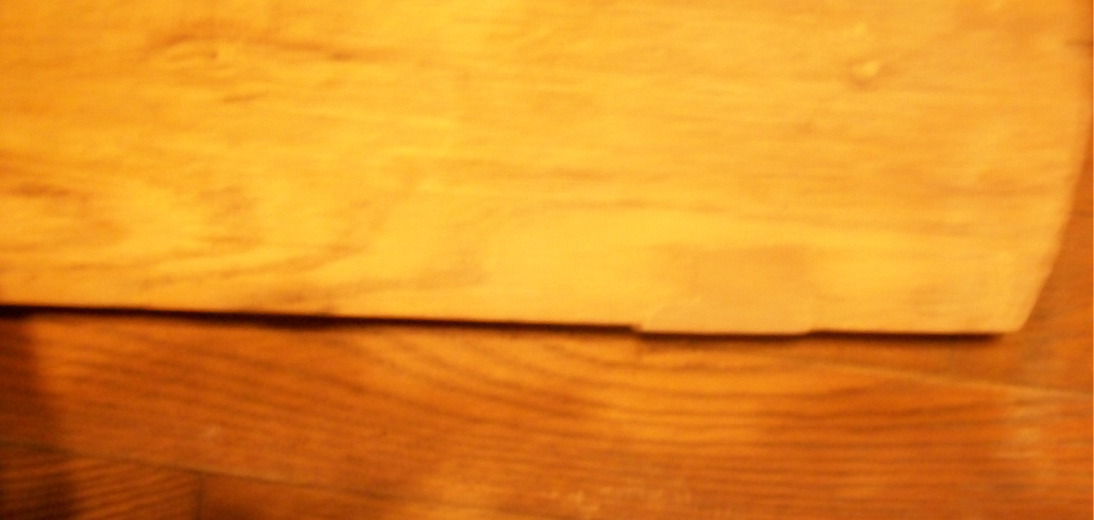

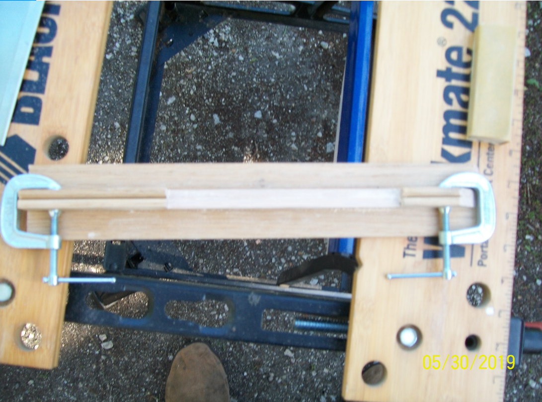

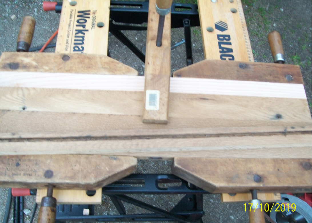

For this I'll be using the old desk top trim board. It had a missing chunk that had to be cut back. So I used the old clamp a straight edge as a guide, and removed the bad section with the circular saw trick.
I also had to trim the width to fit the drawer front, and ended up with this.
I then stripped the piece, and installed it to the drawer front. Here's a view of the drawers installed.
And a view of the drop front drawer in the open position.

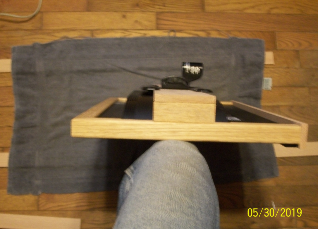

I decided to work on the frame, and mounting system for the upper 24.5" Acer monitor that will be mounted in the old mirror harp above the desk today. But how to go about doing so without voiding the warranty? :WonderScratch:
Well here's what I came up with.
First a look at the rear side of the monitor without the factory stand.
First I made up the top piece, and sides from some Oak outside corner trim I found a bunch of during one of our picking outings. Here's a look at the side pieces being matched up.
I also cut a bottom piece from a piece of 1/2" X 1 1/2" Oak stock. This view shows a trial fit of the pieces.
This view shows the frame glued, and clamped up.

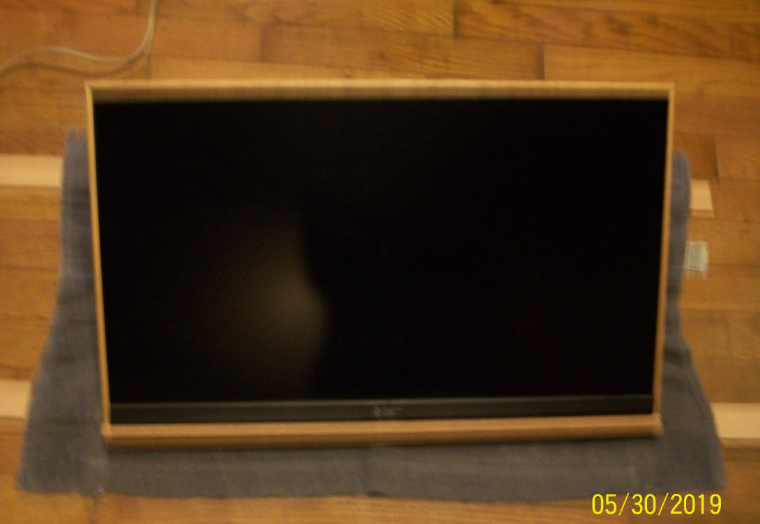

I then used the monitor mounting bracket from the Sanus TV wall mount kit that was also found during one of our picking outings, along with a piece of 1/2" X 3 1/2" Oak stock and some 1/2" X 1 1/8" Oak strip stock to attach the frame to the monitor. I'll be using the inner bracket holes to secure the monitor bracket to the Oak back brace.
Now for a view of the front side.
And now a side view. I'll be drilling a hole both sides through the 1/2" X 1 1/8" Oak blocks to mount the monitor to the old mirror harp with a 1/4" bolt and knurled brass nuts. The monitor will now mount just like a mirror would.
I do believe I succeeded at framing the monitor without voiding the warranty! :TwoThumbsUp:
