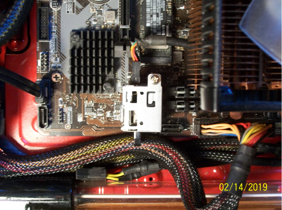

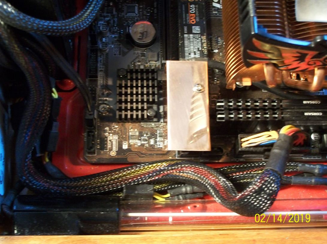

Here's a look at the first Copper Shield. It covers the inside USB 2.0 Port that I have the Bluetooth receiver plugged into.
The inside USB 2.0 Port before the shield was made/installed.
And now a look with the Copper Shield installed.

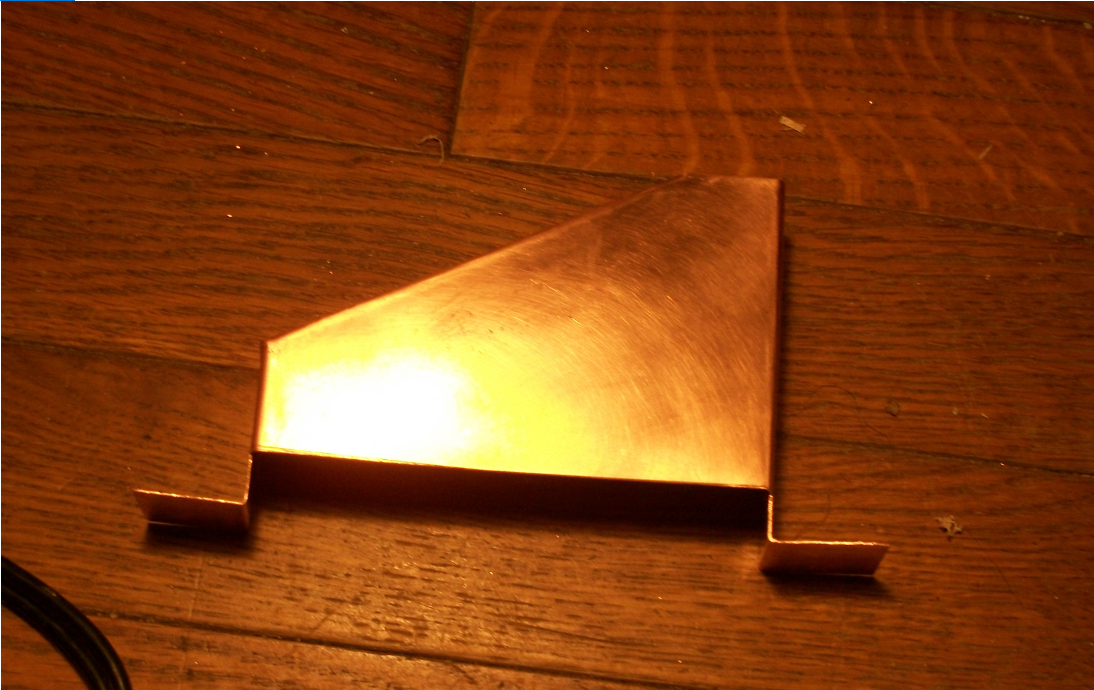

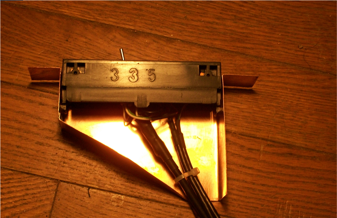

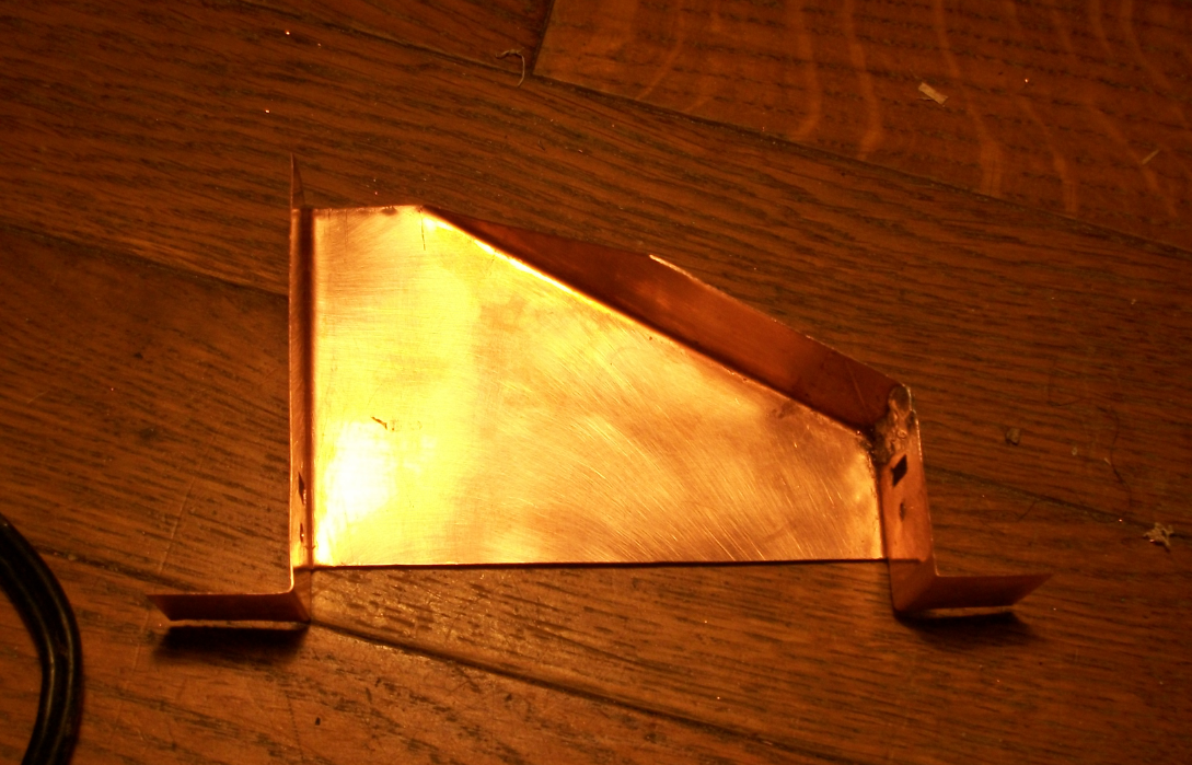

The past couple of days I've been working on Copper covers for the front panel, and hard drive. I also made up a Copper cable chase to keep the front panel cables out of the case fan.
First I did the front panel cover. That nasty looking copper cleans up really well.
Top view of cover.
Bottom view of cover.
Side view of cover.
Two views of cover installed onto front panel.

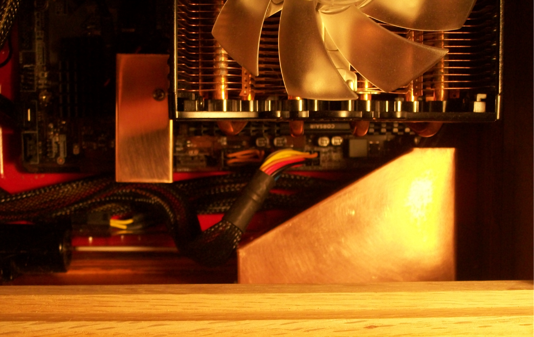

The copper pipe behind the CPU cooler is the cable chase for the front panel, and inside USB port cables.
And a view of what it looks like through the top of the case.

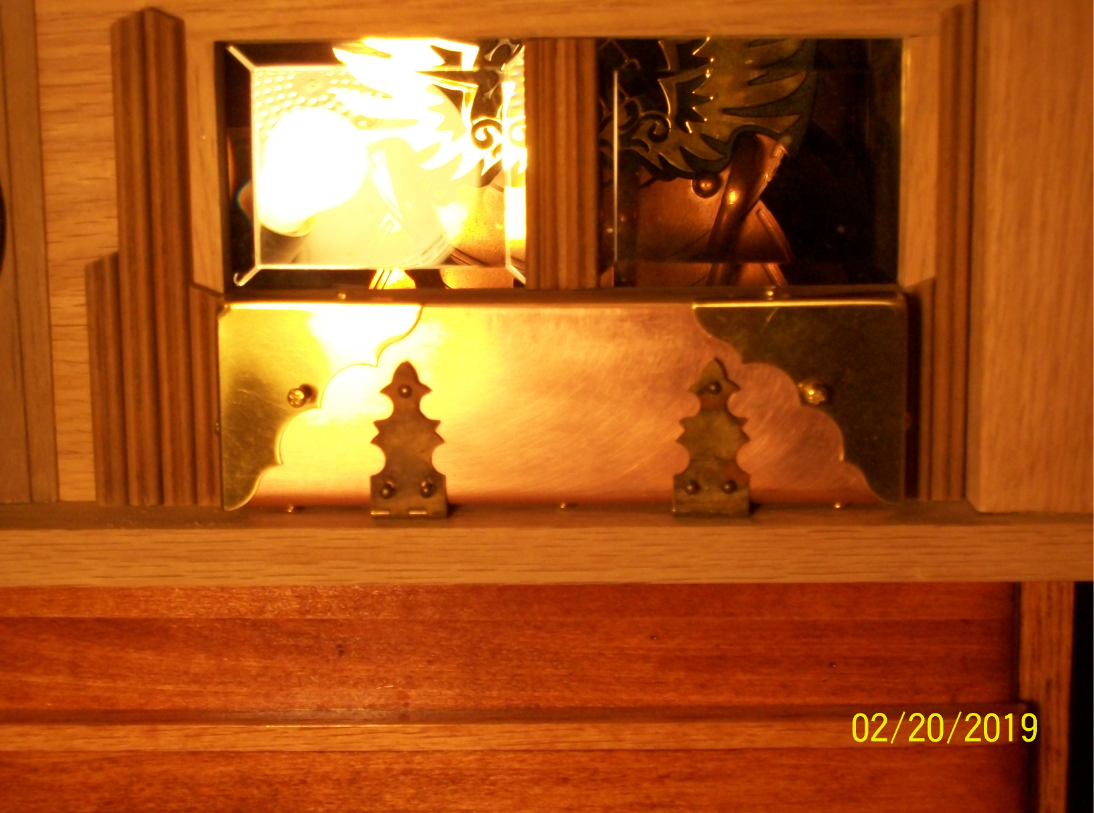

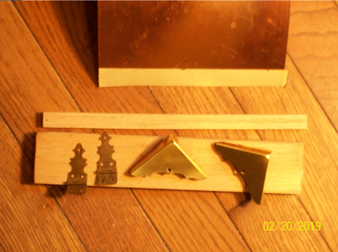

The neighbor found the Brass corners last evening, and gave them to me this morning when I went over to refill the water jugs.
The hinges, and other items I already had on hand.

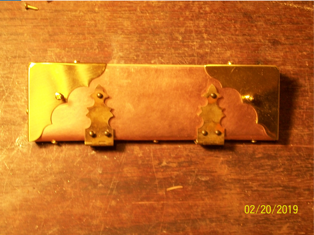

So I decided to make a door for the front panel. The concave area is to clear the DPST toggle switch handle.
And now for a front view of the door.
And the door set into place.
It still needs some more polishing work, but I think it's a good improvement.
