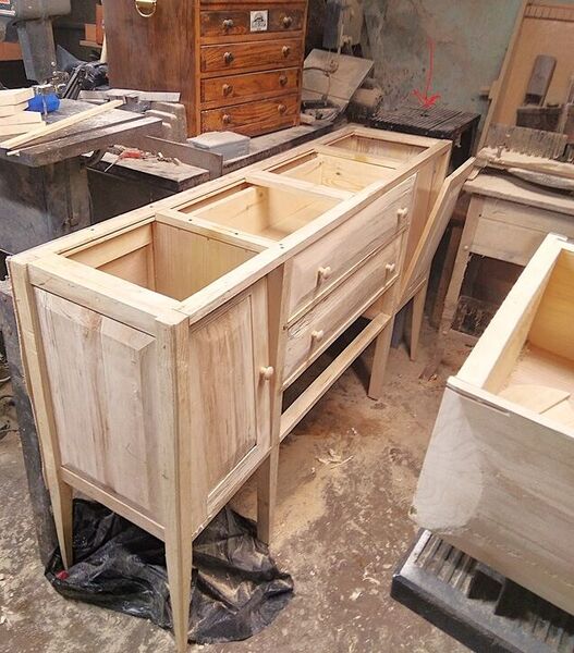

Ok..no room to set the case on to it's feet, right now...but....IF I rotate the photo 90 degrees..
Showing the top and middle drawers...will be working on the Top drawer and the bottom drawer next..

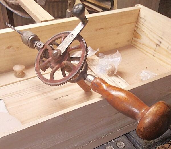

Drilled 2 holes for the knobs..this being a Monday....1 knob was no problem..the other one on the right?
Just decided to split..had to repair THAT...divot was feathered out a bit...

Sideboard...needs to be sat down on it's own 6 feet...so I can better fit up items...

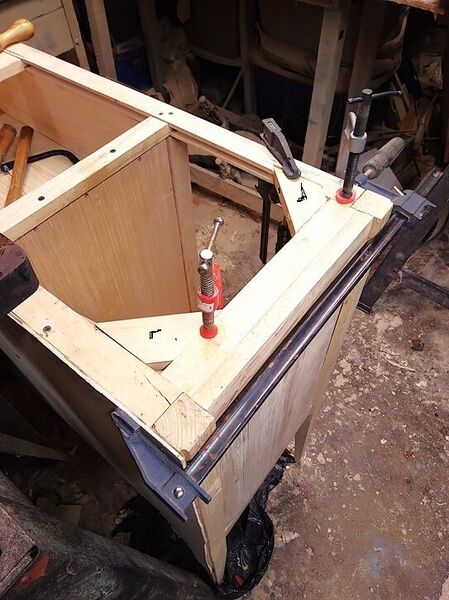

Corner Braces..have 2 done did..
Started out notching through that groove, but, that involved all of these..
turned out easier just to screw & glue the other brace....still need to install these at the other end.
