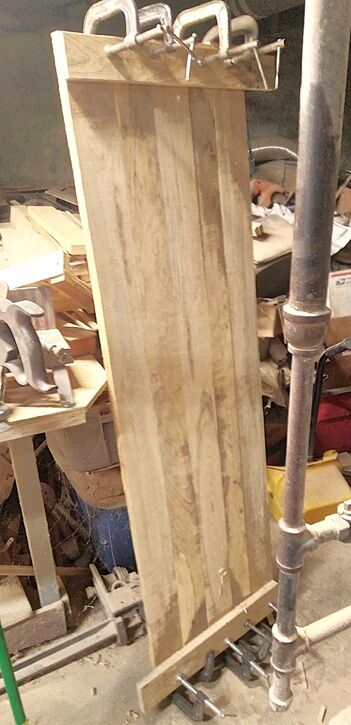

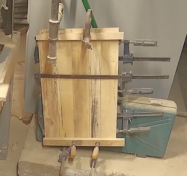

    2 panels in the clamps... Gonna be sitting there a spell... This board.. soon became this mess.. Stiles for 2 doors...when I can get back to the shop....needed to resaw a few other boards.. But..

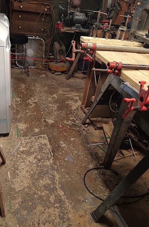

And, so I do not have to shuffle sideways through here...

Yep, the Pipe Clamps came off..
Then the "fun" can begin..
First a Beltsander with 60 grit to go at 90 degrees to the grain...to remove the dried glue and other dirt..Then, the Stanley No. 5c working the diagonals..looking merely to flatten out the high spots....this sort of work, you will never see any see-though shavings..
Goal was to get the top off of my tablesaw, and set aside for now..
It can sit here for a few days, until I need it again..

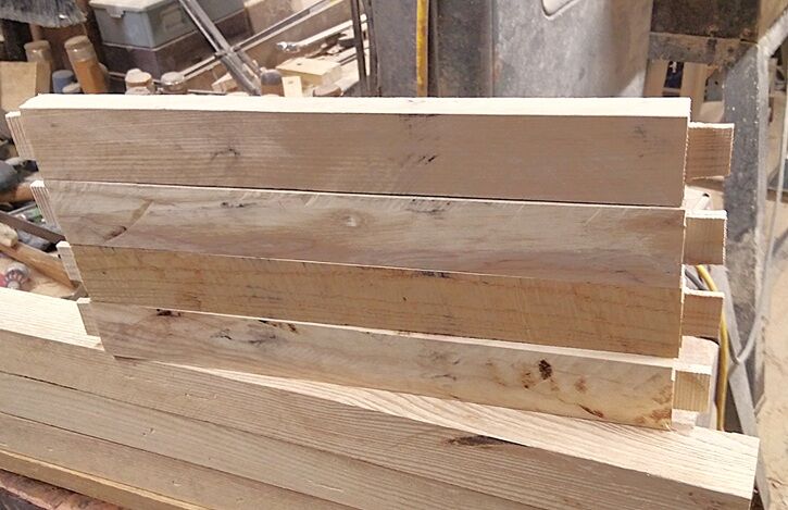

I only need 36" out of this thing...and see what I have...board is 8/4 thick...I only need 1-3/4" square...
Hopefully the second one of these planks can get a few better ones..?
Stay tuned...
Trimmed that thing down to 36" strong...and started to joint one edge

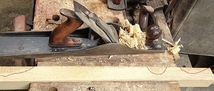

Plane is "only" 10 years older than I am...Type 17 Stanley No. 6c....
Goal being to flatten a curved edge until it was straight enough to slide along the rip fence...I chose this edge because...

So, set the rip fence for 1-5/8"....run the plank through, flip it over, run it back through to finish the cut.....repeat 2 more times....then, lay the blanks on their freshly sawn face, run them through a 3rd time to make them 1-5/8" x 1-5/8" square..
Will clean them up a bit, clamp them into a unit, until they settle down...

Second set of 3 leg blanks are milled...I got bored sitting around....

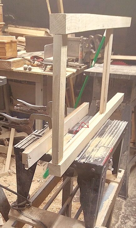

Clamped together so that they will stay that way....I hope..
2nd set of legs?
and has 4 rails sitting on them....
that have their tenons milled.   Still need a groove to house the Raised panels..

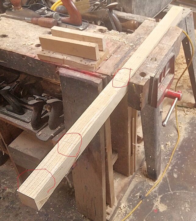

I also cleaned up the ROUGH face of one of the 2nd batch of legs...since the plane was already "warmed up":ChinScratch:
These legs are 36" long, BTW...had a couple spots to clean up..
A few more passes took care of those...

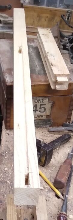

Ok...Laid out a mortise..
Chopped out the waste...
Dry fitted.   Repeat for the lower mortise..
Next the tricky part...mill a groove between the 2 mortises...

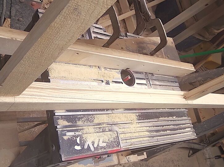

Tried the Stanley #45...it was not doing it...so..."We have ways"...
And, since the rails also needed a groove milled...just reset the fence a bit..

Zero Clearance Overlay....Tilt the blade about 15 degree to port...first trip through all 4 edges...checked the fit...was off about a blade thickness, reset and try again...
Sits all the way down into the groove, now...

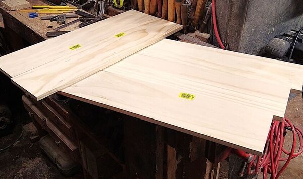

Went and bought a few sticks of 1 x 3 x 6' Pine.....need to start laying out web frames...and what does not show will be pine, those that will show will be more of that Spalted stuff...
