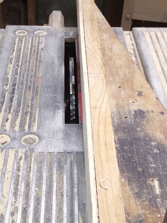

Yesterday, although it was a Monday...needed a plank cut down..so it can get used to the shop...
But...1 x 6 x 58" plank was a bit curved...and I needed a straight edge to press against the Rip fence...
Other edge had bark still attached...this edge had a bump about half way down the line....Tried the No. 7c...was having issues once it got over the "speedbump"
No. 8c?   Had no such issues..
Took a bit, but..
Speed bump is now gone...then over to the tablesaw..1-5/8" widths

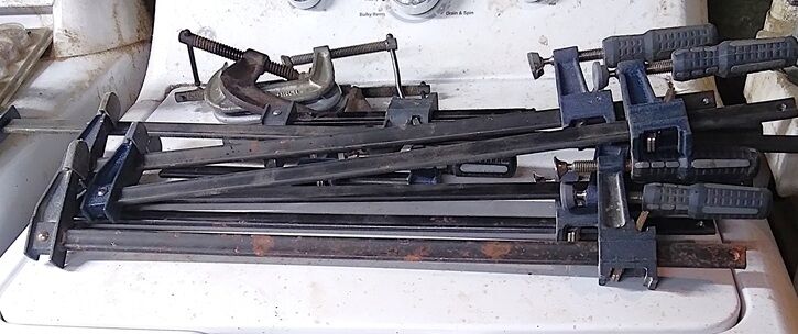

Removed all the clamps that were in the last post...but, kept them handy..
That 6' pipe clamp is elsewhere...
