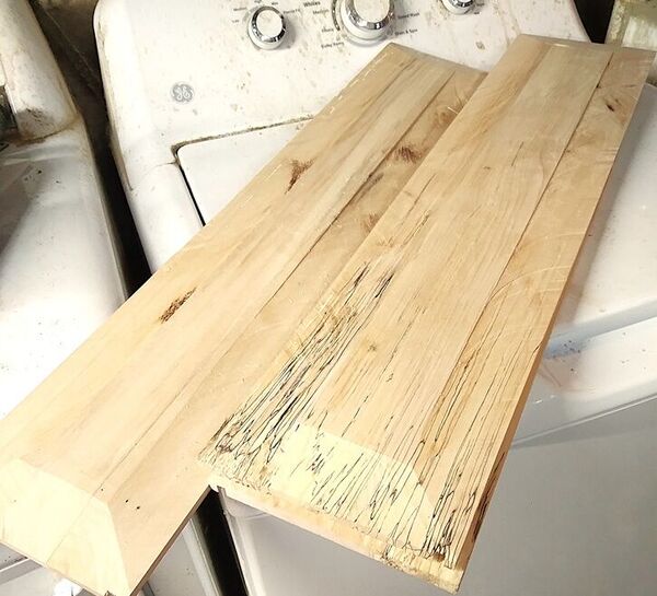

have parts to cut for length and ripped for width...

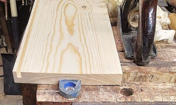

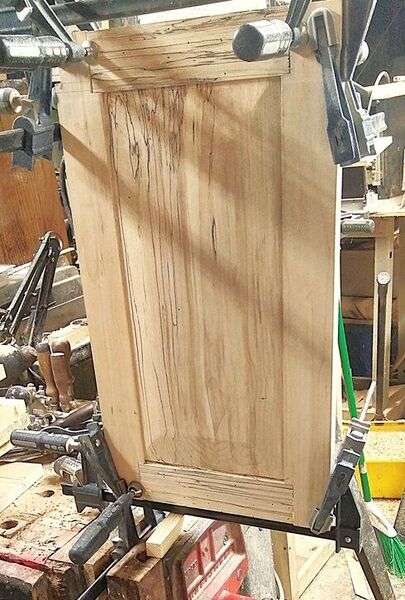

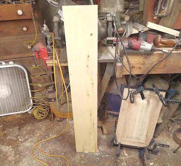

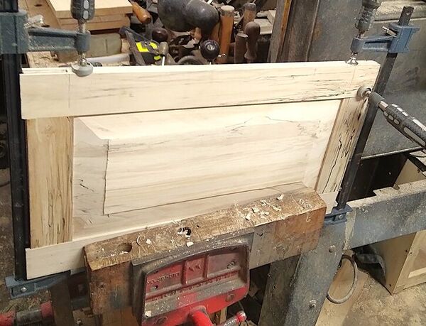

    2 panels in the clamps... Gonna be sitting there a spell... This board.. soon became this mess.. Stiles for 2 doors...when I can get back to the shop....needed to resaw a few other boards.. But..

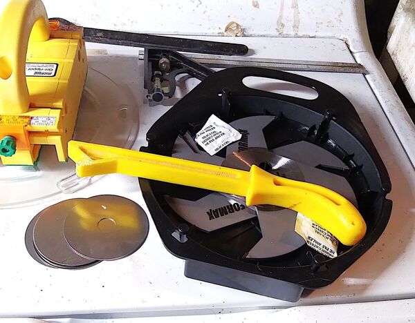

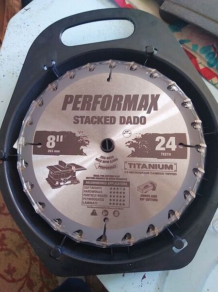

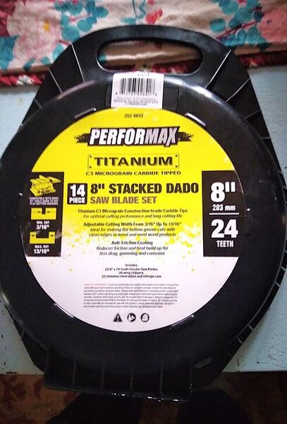

Stopped at Menard's this afternoon and picked up a performax 8" stack dado blade set..carbide tipped..$60 + tax. The old Craftsman 6" was getting dull, and was just steel teeth...and was very hard to install...we'll see how this set does...
I bought that set a few years back. IIRC it was around $45-$48 then plus the 11% Rebate. Haven't used it a lot but I have been very happy with the results. I've used just one of the blades (1/8" thickness) numerous times to make 1/8" finger (box) joints; works great for that too.
@steven newman This is the Dado set I have. I got it when I worked at Lee Valley. I have never had a better Dado set.

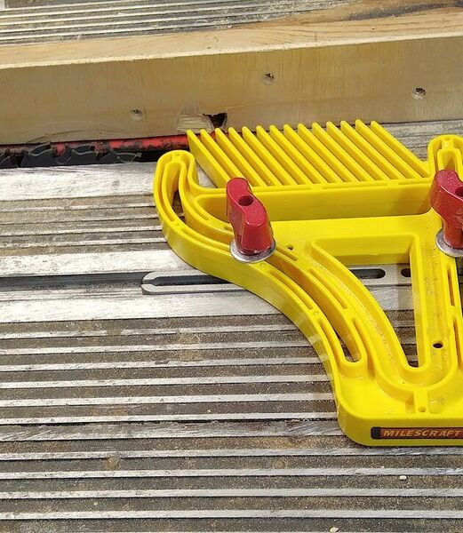

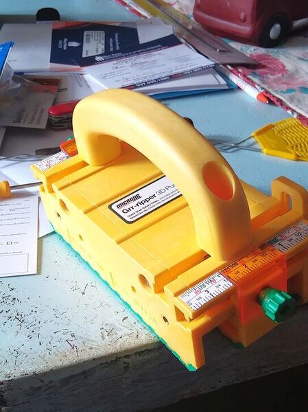

Just spent the last 15 minutes, assembling a Grr-ripper GR-100 "kit"....may give a try out later this week...along with the new dado set...

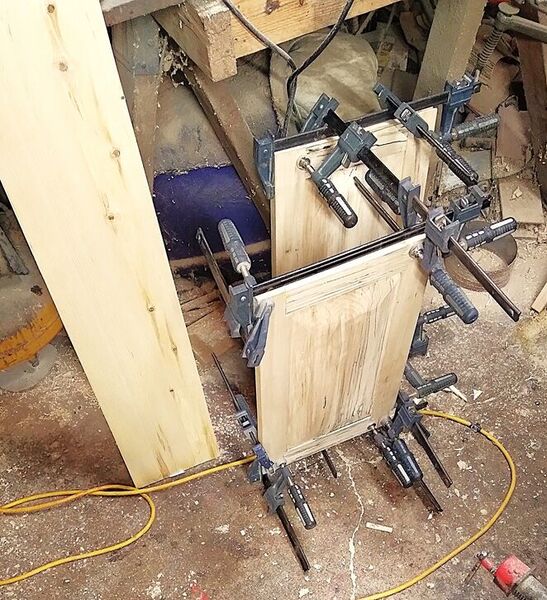

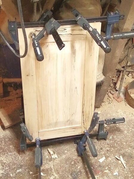

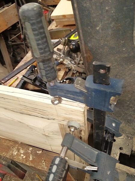

Door #1 is in the clamps, and glued up..
Have already raised the panel for #2 Door, needed to trim the rails and stile to length for #2 Door..

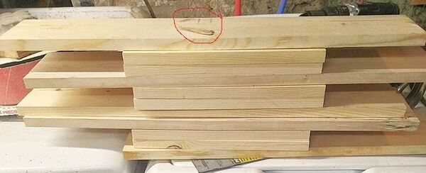

Couple of fronts ripped for width, all the drawer sides(6) cut to sizes needed for each drawer..and 3 backs..not sure IF I keep the back up on top of the stack..tis just a drawer back....however, I do have enough left over 1 x 8 to replace it..
1 x 8 x 44" Yes, the shop fan was running, set on high, in fact.

Assembled, and ready for work..
I have a couple Grippers that I've used for many years. For me, the extra time it takes to set them up is worth the safety plus that time is helpful to not allow me to rush with a cut (the old if it feels wrong, find a better way). I also use Bench Dog push blocks for other cuts that are farther from the fence as they give me more control thanks to the pads/grip.

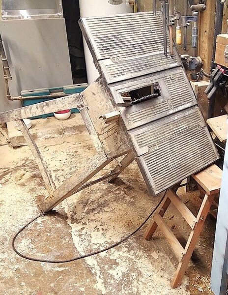

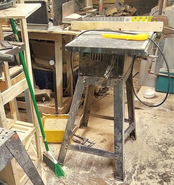

Easy way to change saw blades, on my tablesaw...

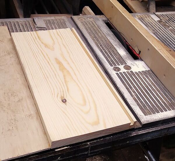

Grooves were needed..
Both sides of each drawer, and the 3 drawer fronts...

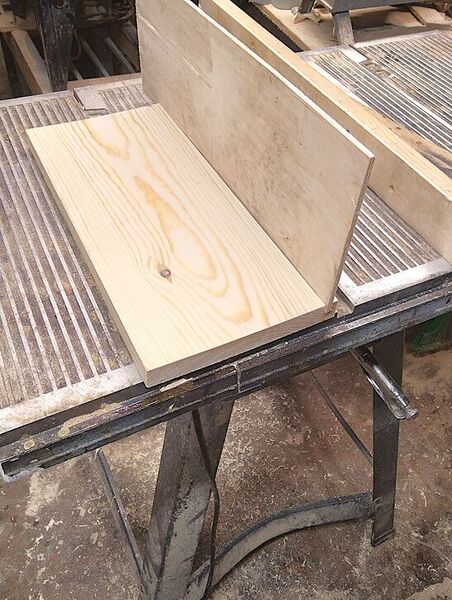

Grooves are to house the 1/4" plywood drawer bottom panels.

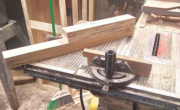

Next, involved a miter gauge, and the fence, with the fence getting adjusted once,,
To mill a dado to house the Drawer's back...

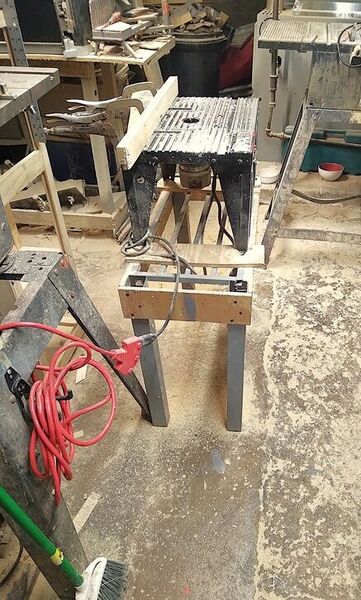

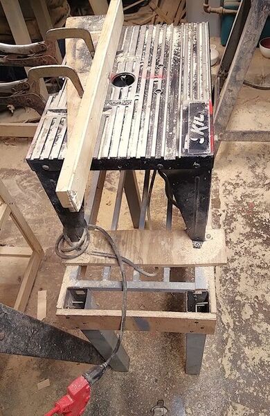

Then....drag out the Router Table..install a 1/2" dovetail bit in the collet....
Set the fence a few times, and mark a couple Start/stop lines...first fence setting..
Mainly so the bit will align with that groove, and hide it...
I also used the same fence setting for the top sockets...12 cuts, so far..then adjust the fence away from the bit, and work towards the center of each drawer front...

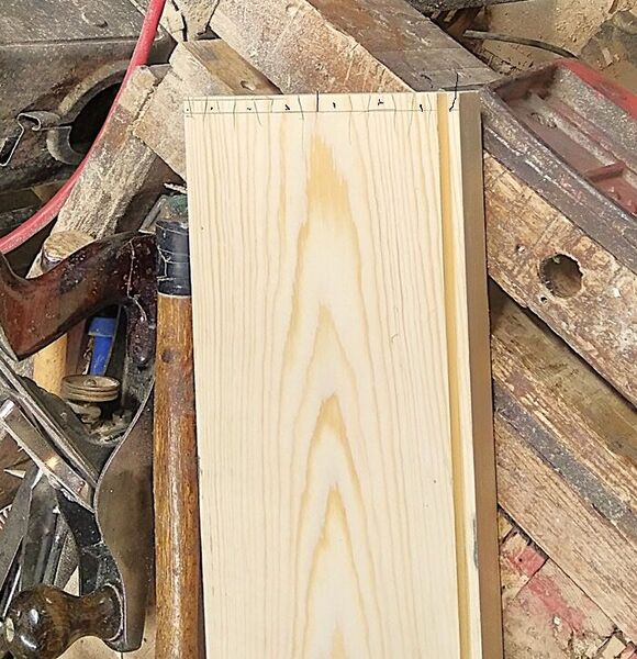

Then, it is a matter of stand the front up, trace around each "pin"..

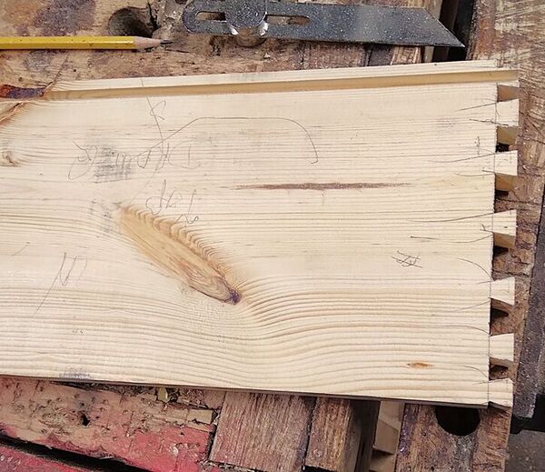

I had changed out the 1/2" Bandsaw blade for a NEW 1/4" blade...and saw on the waste sides of the lines...

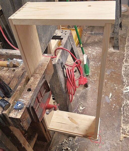

Do a dry fit..

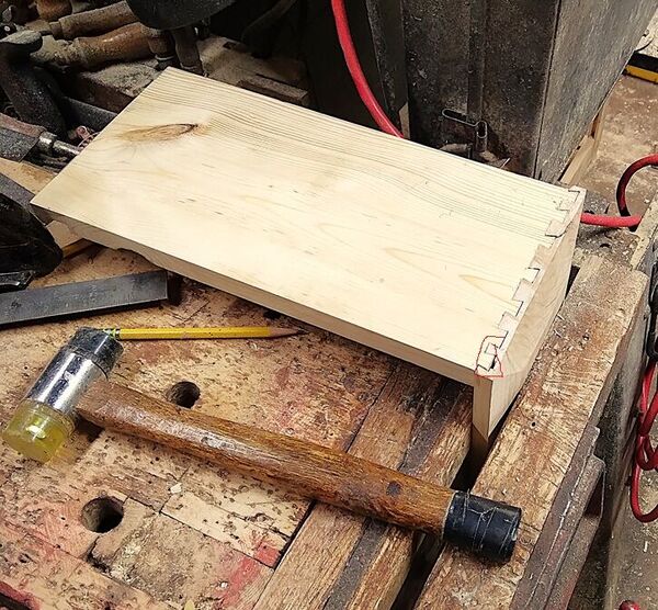

Once this fits, do the other end the same way..

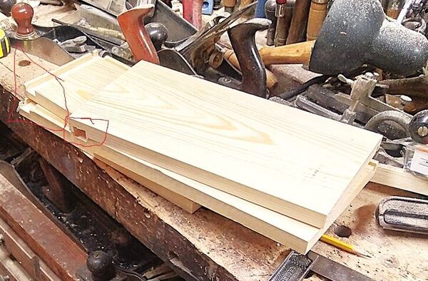

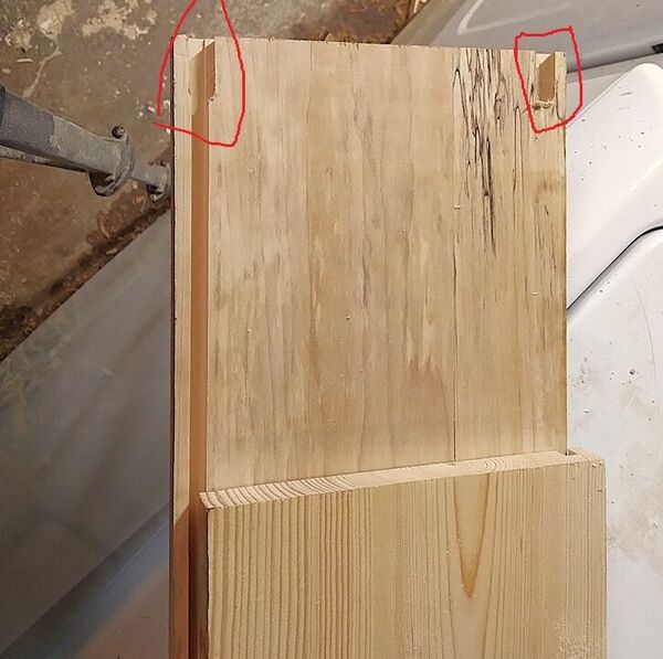

And also dry fit the back...which turned out to be a bit too wide....need to rip about a 1/4" off one edge.

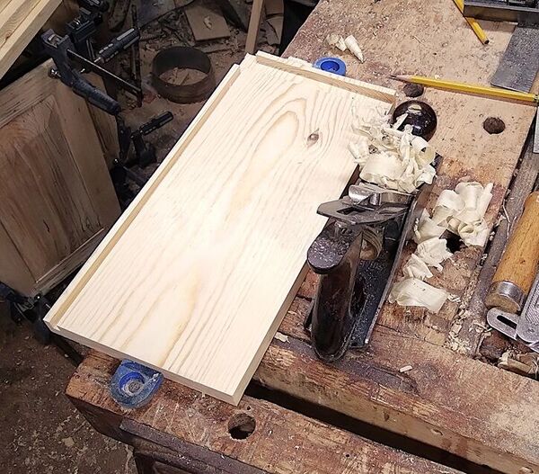

While starting on Drawer Side #2...there was an issue to try to fix,,
We have ways...
Been how long since I was even able to USE a hand plane? Had to do both faces, trying to get this flat enough to fit..
Figure by the time I glue and screw the drawer back in place, it should pull it down to flat...front, where the dovetails are, is already flat.
