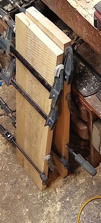

    2 panels in the clamps... Gonna be sitting there a spell... This board.. soon became this mess.. Stiles for 2 doors...when I can get back to the shop....needed to resaw a few other boards.. But..

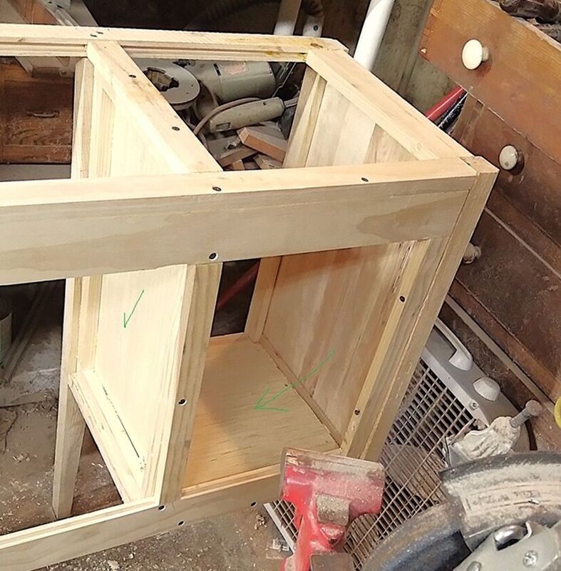

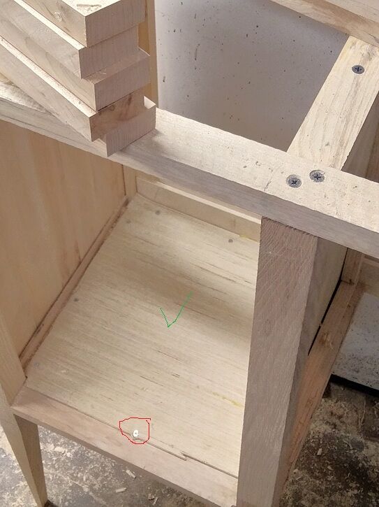

Floor board was installed,....

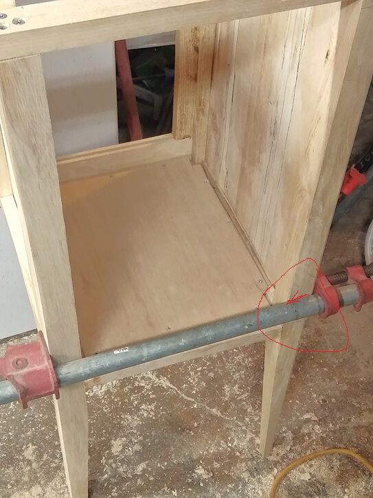

Other end was repaired, and the wall was installed...
The ONLY thing I changed....went from plywood to Plywood in the file's name...strange.

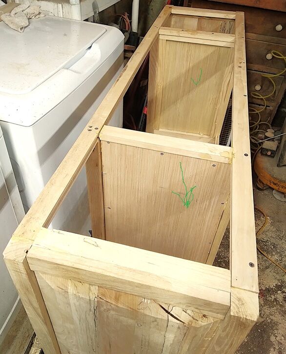

Need to cut a floor board for this end....and start working on webframes for the 3 drawer to ride on.....on a Monday? What could go wrong?
Second floor board is now installed...
Need to build the drawer dividers/ webframes first ....then install the back of the case...then install the dividers..
That is/was the plan...for tomorrow..we'll see..

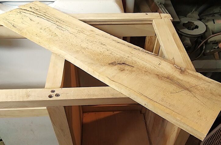

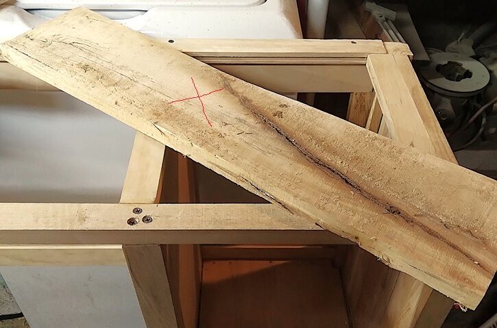

Some boards, you just can't get to work..
And...this was the "Good" face..

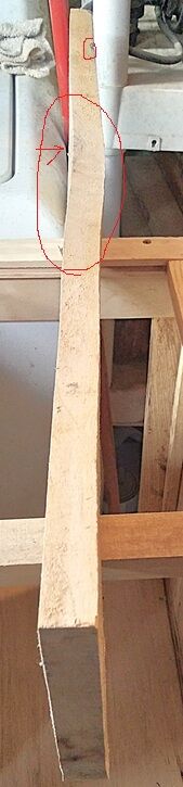

The look down along the edge..
Like looking down a County Road...( as soon as I figure out WHERE the Fire Pit is in the back yard...that will be this board's new home...

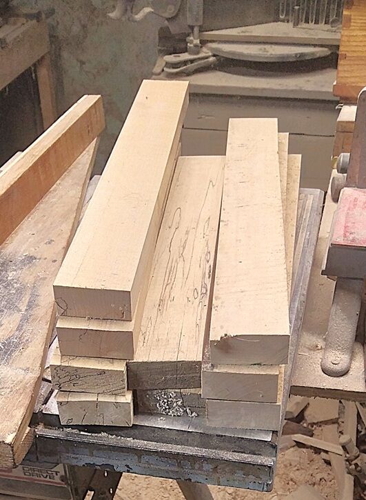

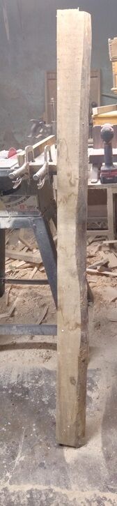

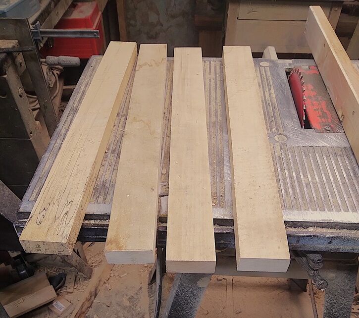

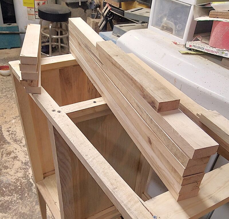

2 planks to the shop...needed cross cut, and ripped ,and resaw...

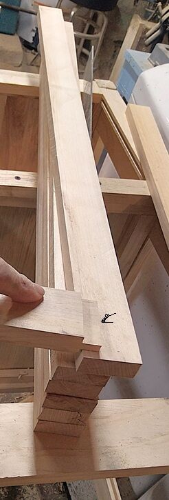

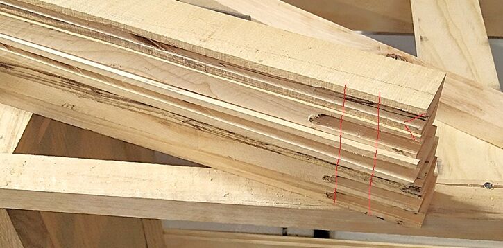

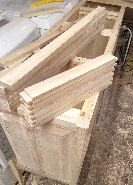

6 stiles, and 6 rails...the rails connect to the stiles..

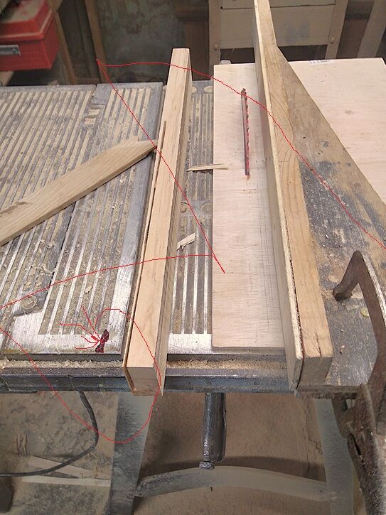

With a tenon into a slot...so..

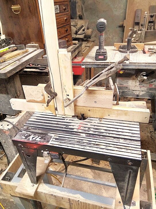

12 tenons...I was going to use the tablesaw to mill a groove...did not work out..so..
Set this up to mill a slot...
Sideboard Proj., Monday, slots for Tenons  .jpgI also have to allow for a Dovetail "tail" on each end...I think THAT will wait until tomorrow...

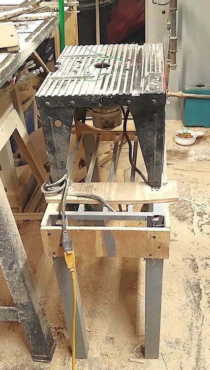

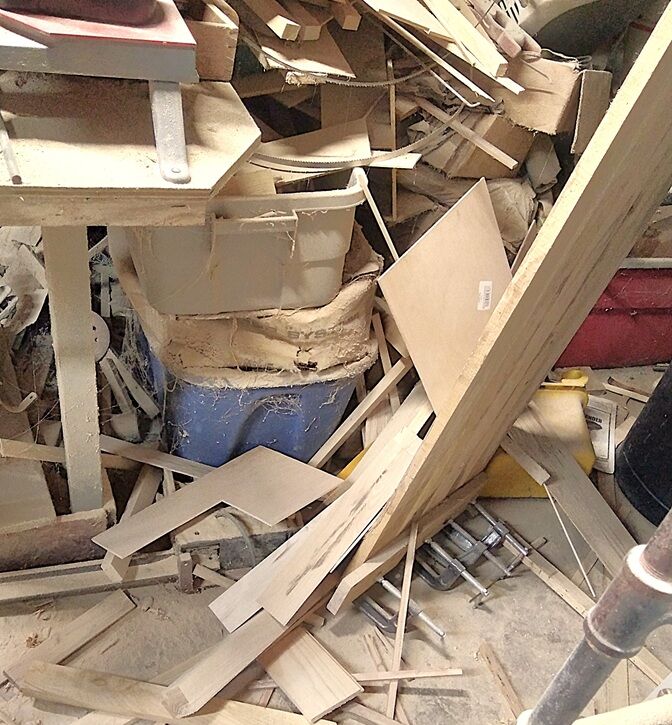

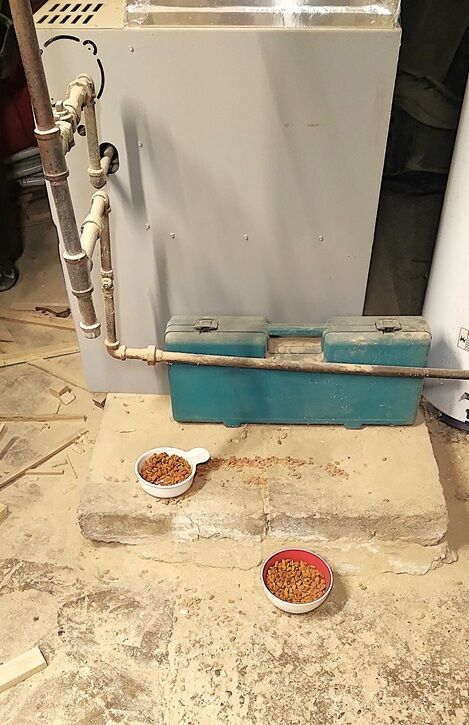

Seems the outside cats have taken up residence in the crawl space under the house..as the Casa del Chatto is rather ice covered...so..
And, in their rush to get here...their fat bodies knock a few things over..

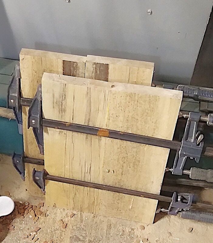

BTW...that panel with all them c clamps on the ends...is to be the Top of this Sideboard Project....

Changed out router bits...tried to get the slider jig to move...was a bit too tight...
dovetail bit is buried halfway into the fence...The front 3 stiles get a dovetail "Tail" on each end...the 3 for the back do not...

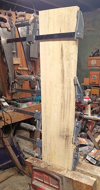

have 2 panels in the clamps at the moment...they are to be the Raised Panels in the 2 doors...
Not sure IF I have enough Ash to build the frames around them, to build the doors....
Also need to buy a few 1 x 8 x 8' Pins boards...drawer sides and backs...3 should be just enough?
This board..
