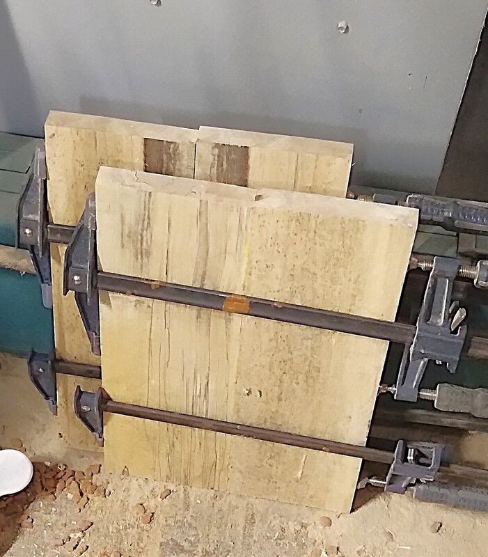

    2 panels in the clamps... Gonna be sitting there a spell... This board.. soon became this mess.. Stiles for 2 doors...when I can get back to the shop....needed to resaw a few other boards.. But..

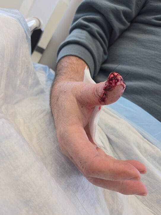

son got photos after the stitches were in...
3 stitches in the tip of the left thumb..and ...
this is the right thumb. it did get a tendon..

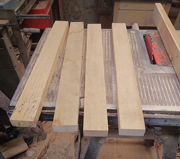

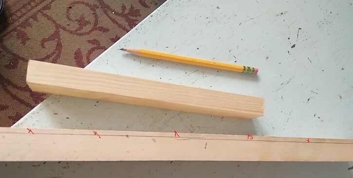

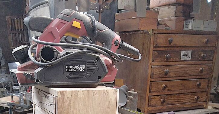

OK...Reason for the resaw...was to slim down the fat boards..

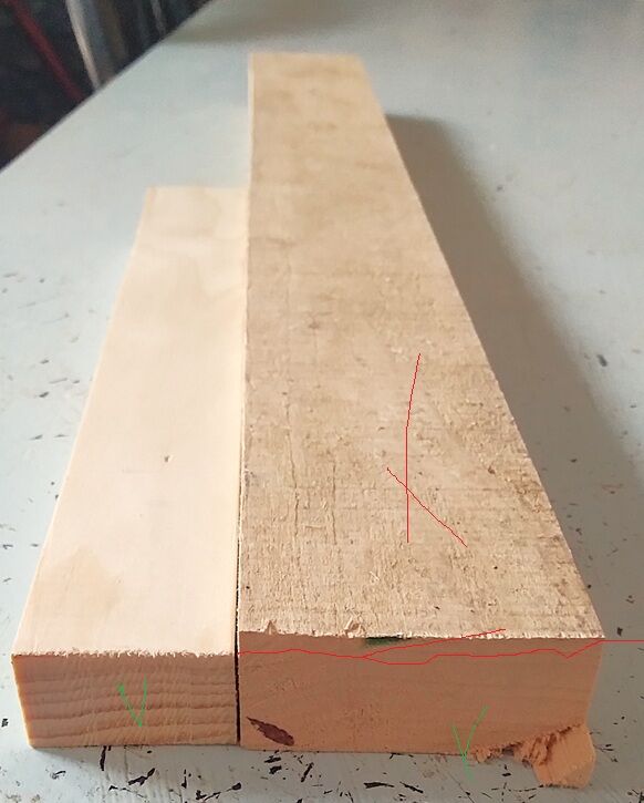

Board on the left is 3/4" thick...which is where the one on the right is supposed to be..had already resawn a few parts without any issues..

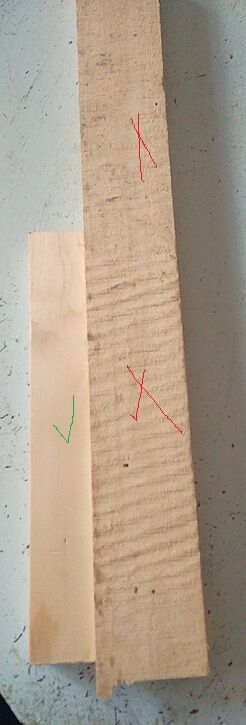

So, a change of plan...need to decide which face looks the worst...

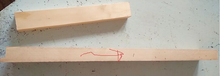

Which way the grain is going..
Something like this..mark a line...
Then, clamp the part in the end vise on the bench...use this...
To remove the excess wood down to that line...then the No. 62 to smooth things out, taking just the line.

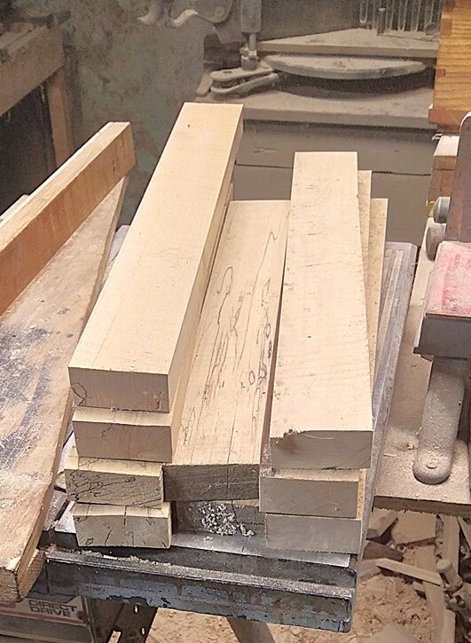

need the best 4 out of this pile for the door's top and bottom rails...then..
these 4 to be the stiles for the 2 doors...have not decided on these 2..
Msy buzz these 2 flat...as they will be the raised panels for the doors...same with the panels to build 3 drawer fronts with..

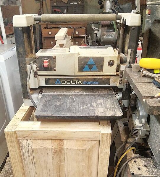

Can't use the tablesaw, so..
Light passes...pushing with the left hand only...
ALL parts are NOW 3/4" thick..even the webframe stiles and rails...

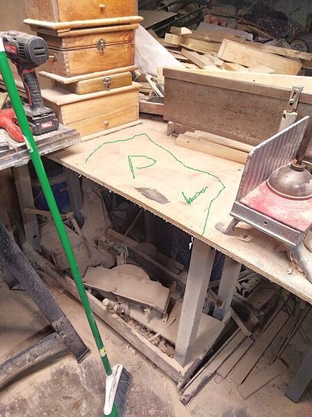

need to move a few things around...that planer can go sit over here..
Until needed again..

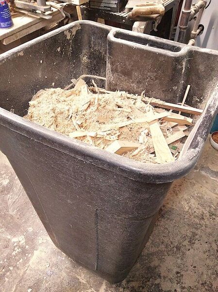

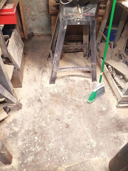

Have swept up the shop..
Almost filled a trash can...

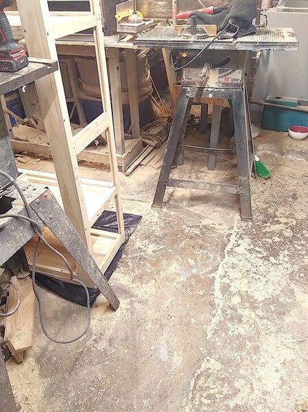

Re-organized the work area, this evening...
Old tablesaw blade was taken out of the saw, and turned into a Frisbee to sights unknown...
Once the new blade was installed, the tablesaw could be moved here...then..

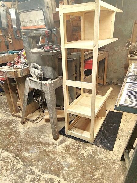

A plastic trash bag was laid down, then the case was set on it...to protect the wood from any wet floors...and turned so I can work on the front of the Case.

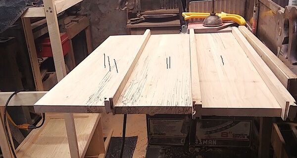

Dug out the 3 drawer fronts, squared one end, then cut the length to final length...2 needed a curved edge rip off...and they were ripped to 6-1/2" width. Tested with the drawer dividers, to see if the "unit" will fit in the required space...
Right on the money...at 21-1/2"...numbers are backwards...should read 1, 2 , 3 left to right...top drawer is about 1" shallower than the others.

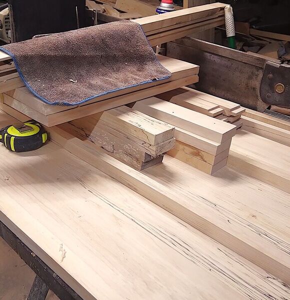

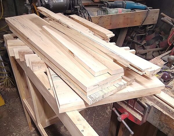

Took the time to sort through the stack of parts....to find all the parts for the 2 doors...and laid them out, for now...

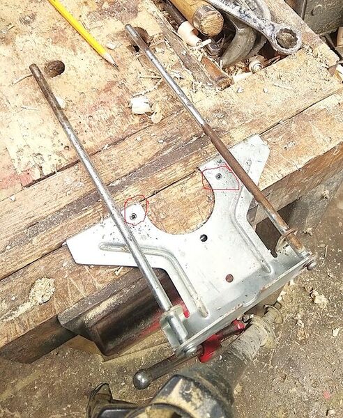

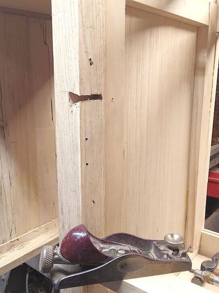

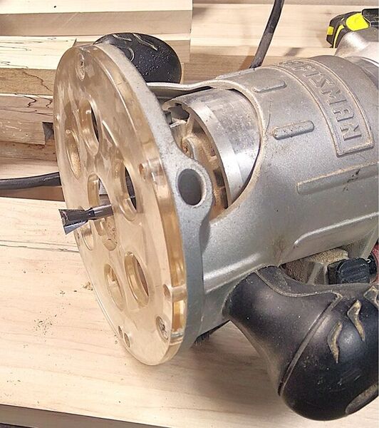

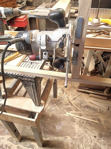

Drawer Dividers...have a dovetail "tail" on each end....means I need to mill a socket for each one...
Lets try this..
This needed flattened a bit, and a couple more screw holes drilled..
Yes, it does stick out a bit...had to allow for the guide..
Tied to use the top of the tablesaw...legs were too tall. So, router table was used,,
Added a clamp...burnt socket was from the router bit set too deep, that the shaft was also try to make the cut..
Clamp the guide in place with a c clamp or 2...add the screws..slide the router on to the guide rods..
Shove the router to make a cut
Clean up the fuzzies with a block plane...that only needs one hand to use...

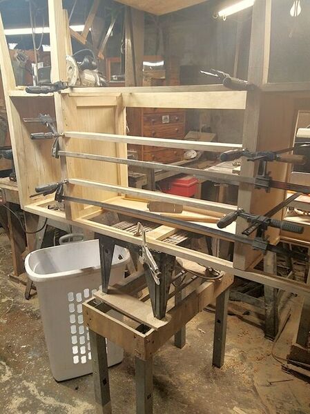

Took a few trips to the shop...and a couple Laundry Details...to get all 6 sockets milled...might as well get out the glue and clamps..
Plan for today...is to remove all them clamps...then we'll see what happens next..
Stay tuned cowboypistol1

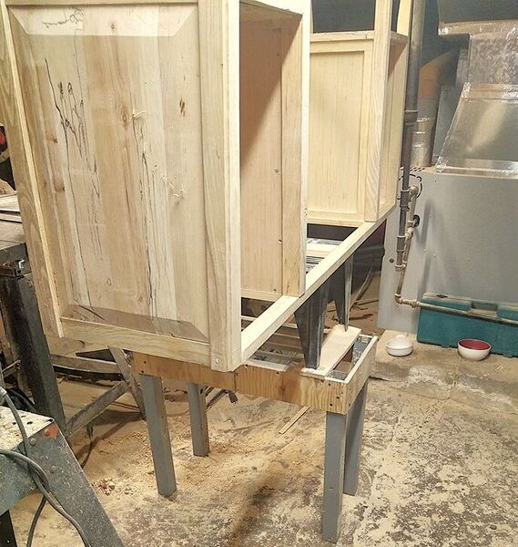

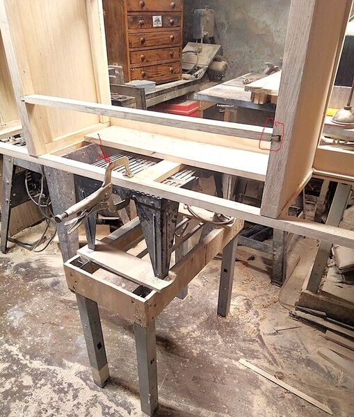

Busy Sunday...drawer runners installed, along with the back of the frames. Rotate the case a few times...plywood back is now installed, and a sabre saw to trim that to final size.
Today: Set the case back down onto the shop floor. on one of the ends, with a trash bag underneath. Trip to Lowes on the way back home this afternoon...three 1 x8 x 6' pine planks = $23.10.....will be the backs and sides of three drawers.
